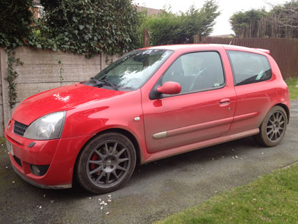

She's been to Hell now shes coming back.... and already putting parking noses out of joint

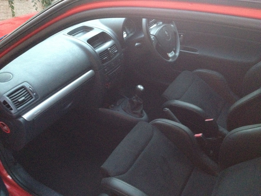

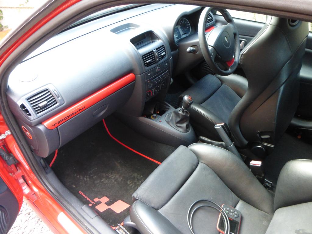

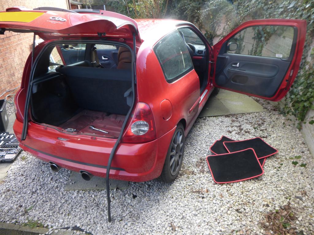

Spring cleaning comences early..
I'm 6ft2.. so that only 4 head cracks off the boot today..
Red on the outside only please... this is all going to have to go eventually.

looks a good base to start with! i agree on the red on the inside going, the renaultsport mats with the white trim/badge suit them quite well thats what ive got.
  Ex 182 owner
Yep, many do mate and I know why as its an obvious personalisation with little irreversible damage done.
was going to give my red strips away free but the drivers side is numbered. So I guess its a box in the loft for any other owner one day.... not that there is any plan for that.

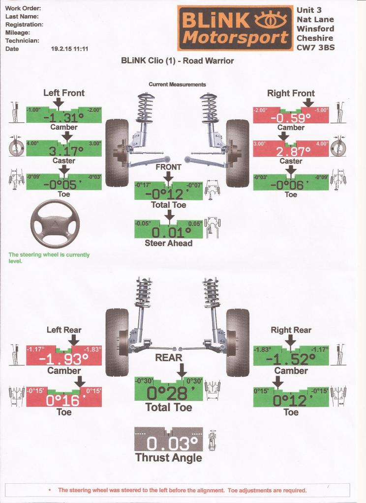

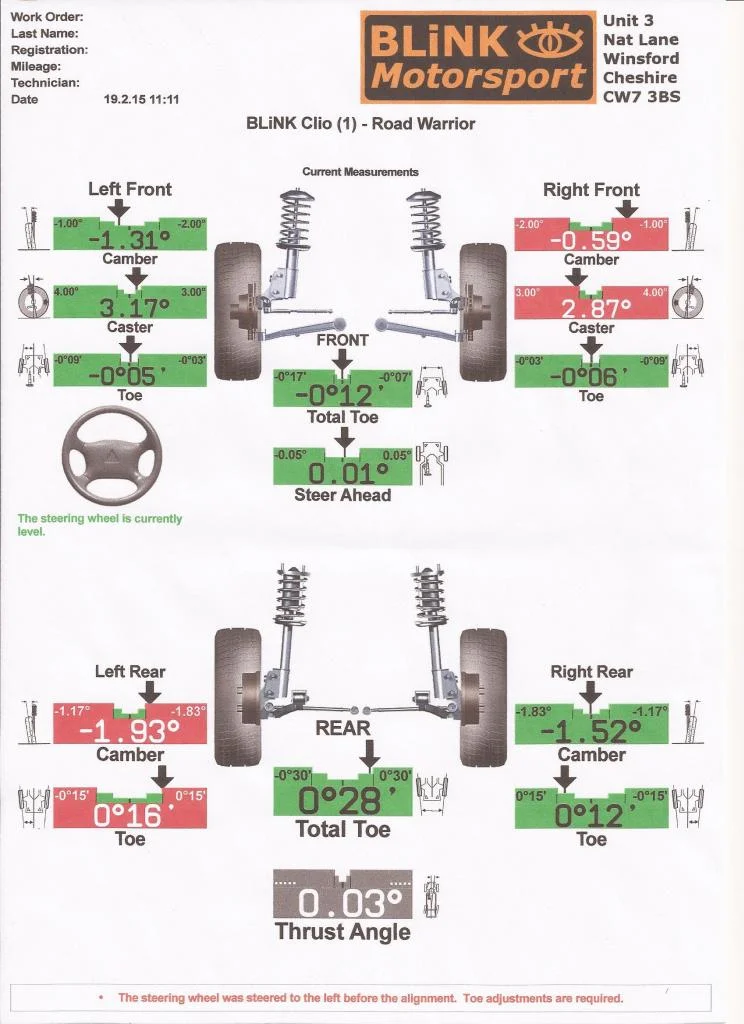

Inital check up with Blink went well. She isnt that bad. This was only a starting point. Got plenty to change on the car before we get things bang on.

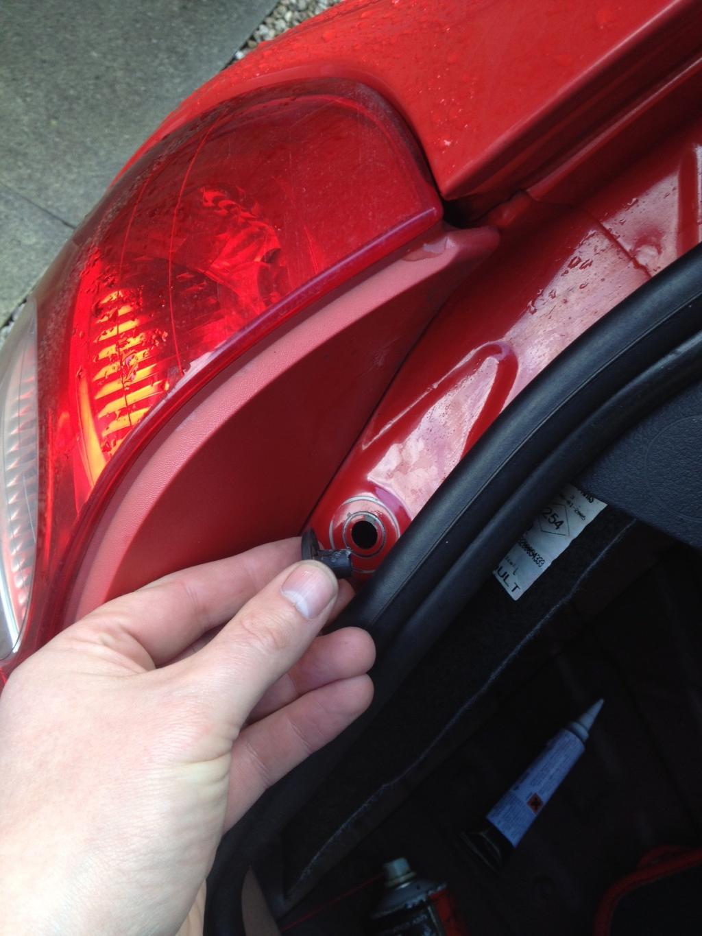

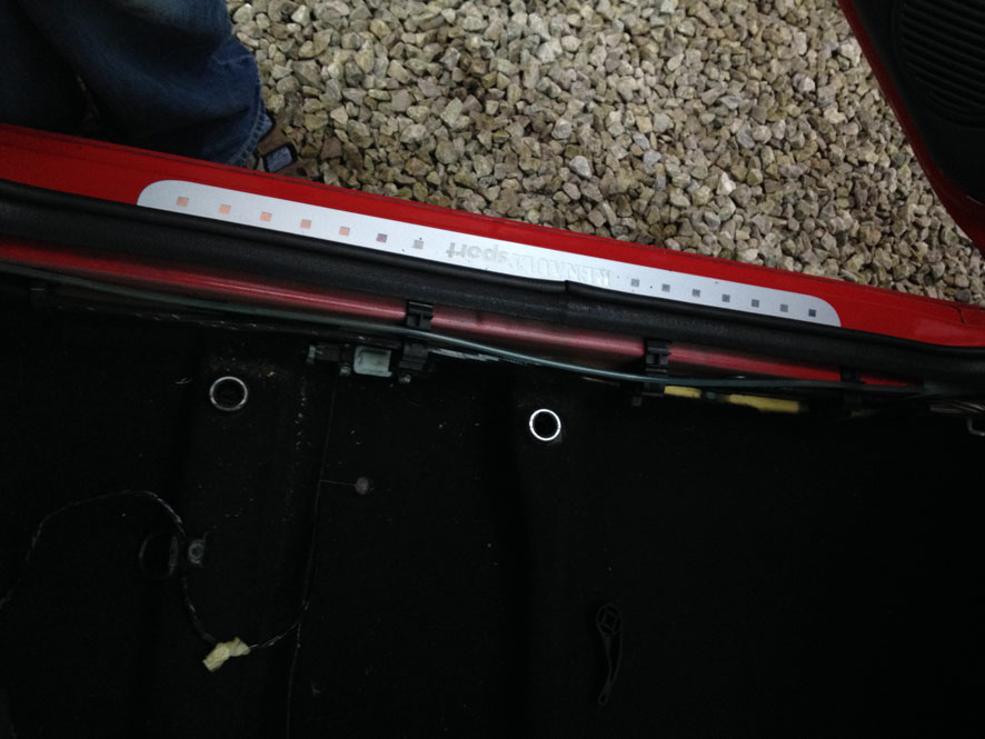

Leaky Boot. Hopefully traced to the damn 57p boot stop gromet. Two order from Renault. Will probbaly add my own sealant as well to make sure next time. As i am taking the seats out anyway and refurbing the side mounts. i may aswell look to remove carpet and wash/dry it properly.
Order in with @G 172 for the rear end and the list for @Renault Wolverhampton grows so will have to be split up into stages lol.

I had wanted to take T120 north with me for a get together run but not knowing the car long enough (3 days) it seemed like a bad idea in the end. So after the trip to Blink. T120 was parked up and the 182 was rolled out for one last big run. And what a couple of days.. Stirling, dukes pass, Glen Coe, Oban and so much more. The rest and be thankful was just one of many amazing photo op. A freash set of shocks and some Eibach prolines.. the 182 non cup is equally brilliant. The 182 was almost poking me as to why it was being replaced.. TBH for 2 days. I didn't have an answer.
  Ex 182 owner
whoops repost that Blink geo.
Lets hope these do the trick. 57p each from Renault. part no.7700423111
TBH they should be on your annual service item list for the amount of problems they can add. I found breaking the rear prongs inwards to get the old one out the easiest way. Added a tiny amount of extra silicon too.

Boot apears to be still dry... However the boot, cv type has exploded. Think it's just a clip so it a trip to the shops for a jubilee. It's also developed a speed related ticking sound from the passenger side. More investigation planned.
New cat gasket for a Milltek sports cat which I had kicking about. Rest is a piper system, it's pretty loud TBH.
I wasn't going to do the boot struts till much later but the boot leak has lead to plenty of access need to the rear end so an SGS BMW items have been swapped in.

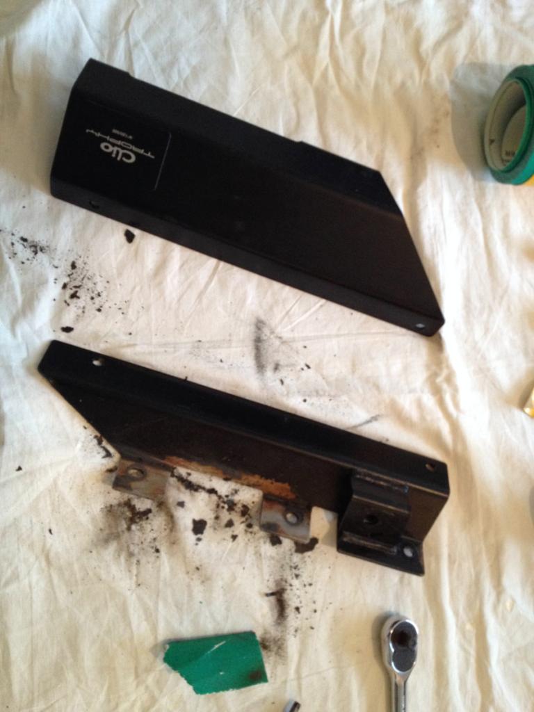

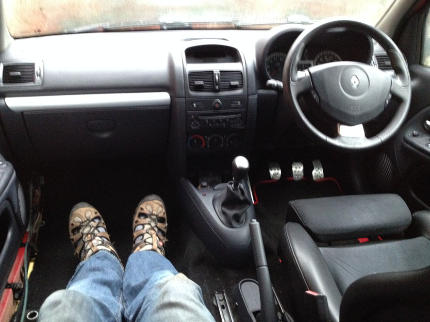

Sat in car with hoover today.. but then the sun came out so we got to crack on..
easiest way to hoover..Take it all out
Cleaned and ready for the loft..
Touched these up for now, will get a pro job done one day.
As the sun came out and I needed the space in the house...
Just getting dark as the sun was setting... very happy with the result.. the 182 which these should have been going in is probbaly a little dissapointed.

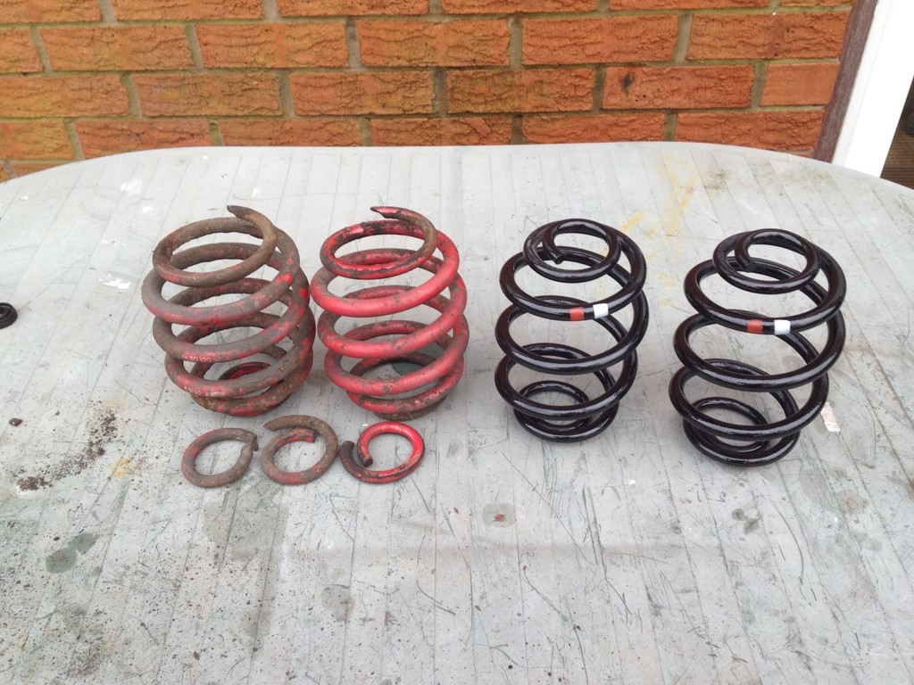

Cracked rear eibach sportlines springs pointed out by Steve. Have some Cup spares here going on anyway for back to standard.

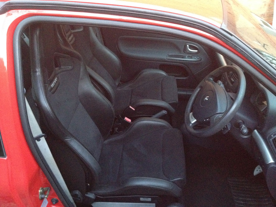

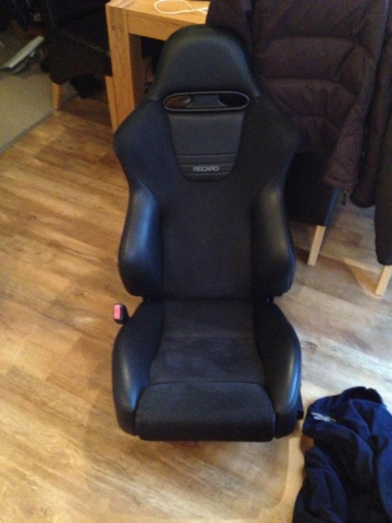

Hi @Davyy ,
They are Recaro Sportster Cs, picked them up s/h a few months back. Would have fitted them to my 182 but then the trophy came along. Might be slightly too high on the trophy subframes so will look at other subframe options
  Ex 182 owner
Thank you,
Yeah was suprised to se a s/h set TBH. As these are the ones you would buy from recaro direct. Not the ones out of Megan250/clio197's which have the renault subframes, are almost impossible to fit and are much easier to find second hand. They where actually listed on ebay as lotus seats, not sure if lotus seats are identical but these had the part numbers visible on the advert which confirmed they were the recaro supplied version and would fit straight onto Recaro subframes...such as in the Trophy.
The trendlines which came in the trophy have gone into storage. Although i always plan on keeping the car so will keep the new seats in long term. You never know and I dont need to make a quick bit of cash just yet on them. Plus would be selling without the subframe. They are very expensive unless you do somthing yourself. So i wouldnt ever get the £700-£900 you see them going for.

Up shot is after Steve from Birchdown spotted the rear coils were snapped, I brought forward sourcing a set of cup rears, when Johnny said mint, he ment it. I am buying new Eibach fronts From Renault mainly as quality used ones are much more limited. The rears however I didnt mind going second.

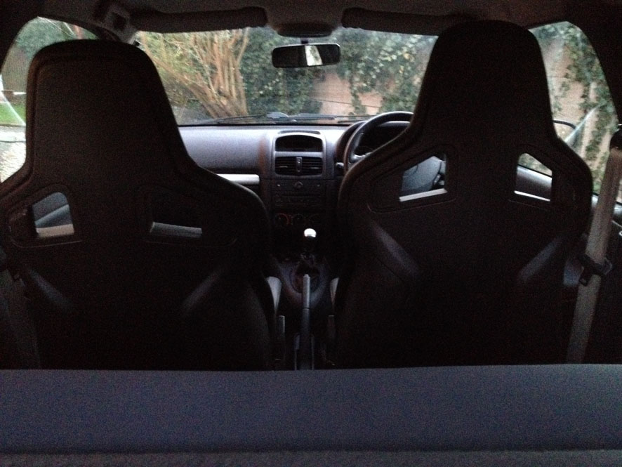

Halfway thru an @The Fatty setup which I got from @deadmau5 that little strip of rubber for the metal edge mate is a god send. Airbox removed, loads of room now.. infact not 100% there isn't more room behind my headlights to fit a bigger filter. Pics later, I am nto a zip tie type of person so working out a proper mounting system.
Still working on drivers seat height with the new Recaros. It's fine but not ideal.

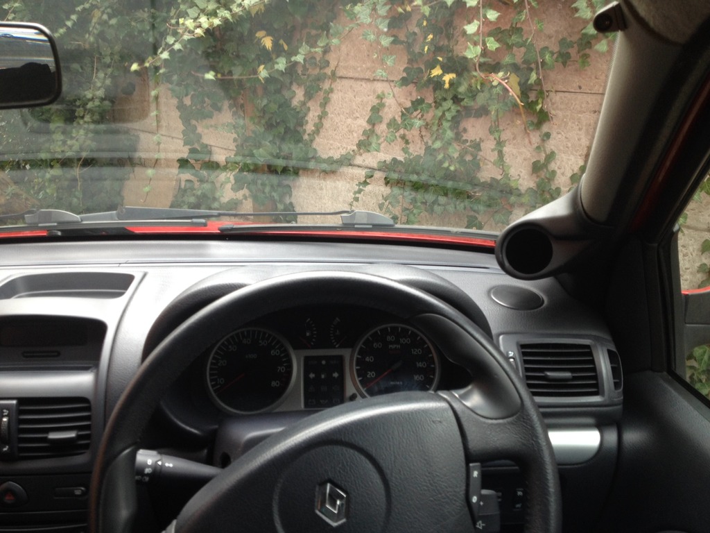

So still working out the gauge plumbing but it's coming along.

Gauge wiring plumbed in. Just need to fit the sandwich plate which may aswell be done with an oll change. Job for tomorrow hopefully.

What's was the SPA gauge like to wire up? I've been looking at the same one
  Ex 182 owner
Hi @haimsey, electrical wiring isnt too bad. I was suggested piggy back fuse err.. thinginy. to save cutting into the looms somwhere.
by another member, with the added bonus of a sperate fuse for the SPA (it actually has its own one apparently). So i wired it over to a switched live in the passenger side internal fuse box.

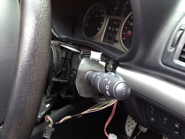

120 decided to join the technological elite today.
Not as easy as swapping the boot bump stops but a simple and rewarding 10 mins of modding.
