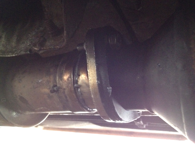

Thanks to BCS in Haydock. I dont have to worry about the damn olive joint anymore!

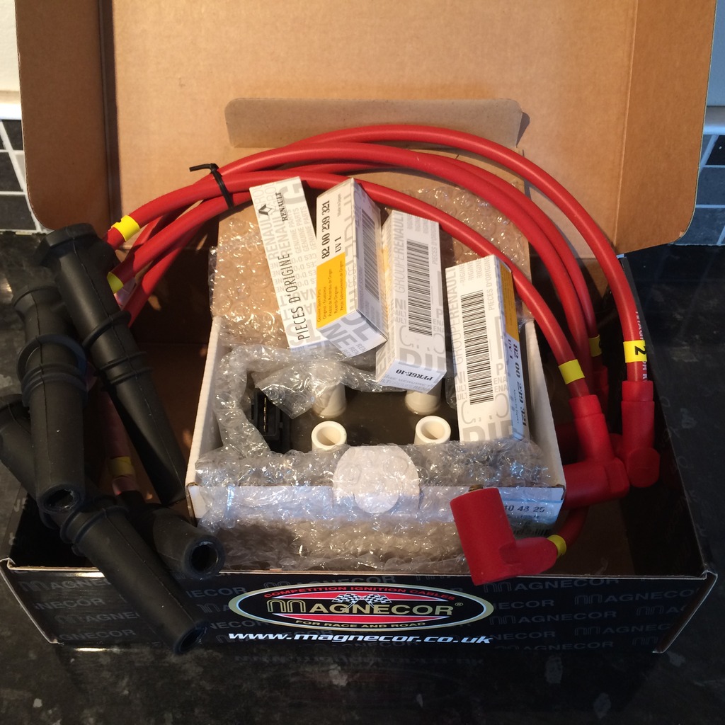

New plugs, Magnecor leads and a new coil pack are now in, with a new map sensor due to the mishap.
Also found a bit of oil on top of plug No.4 and around vvt solenoid. New seal replaced along with upper inlet manifold gasket and egg shaped gasket for good measure.

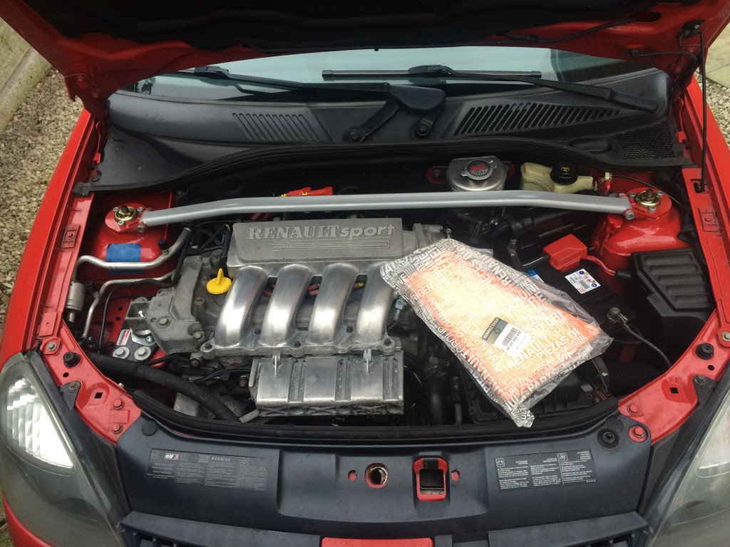

So after the trip to @MicKPM for nice new belts and real revs. A few bits to sort. New stupid clip under the bonnet that holds the water pipe was broken after my windscreen jet swap. Clip which holds the a/c pipe to the drivers light area had to be sacrificed for the belts last week. Sorted. Front lambda re clipped to the subframe to keep it away from the exhaust on Micks advice. And what a pig that was to do. Missing heat sheild sourced and mounted.

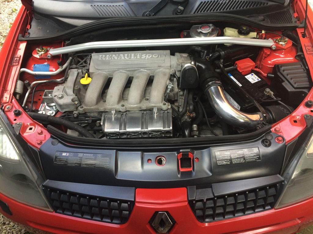

Thanks to Megan and Jamie @M172Cup I picked up a set of air box brackets and remounted the original box with a nice new filter. The Fatty was fun but just decided I wanted a proper box back in the car. Megan, I hope Jamies build is coming along.
Nice new standard filter for starters, Perhaps think about exotics later.

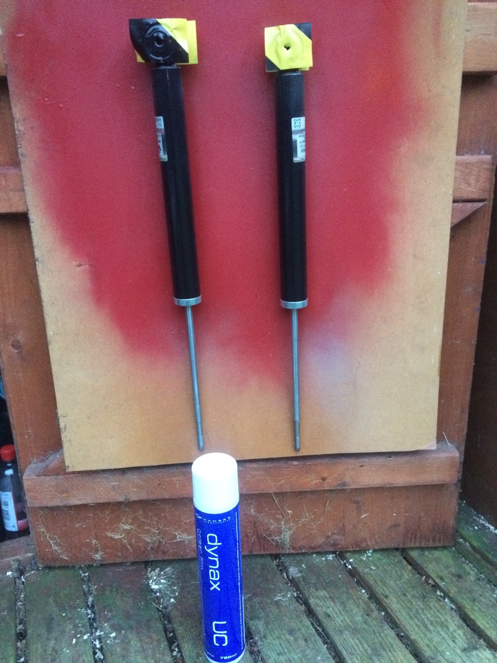

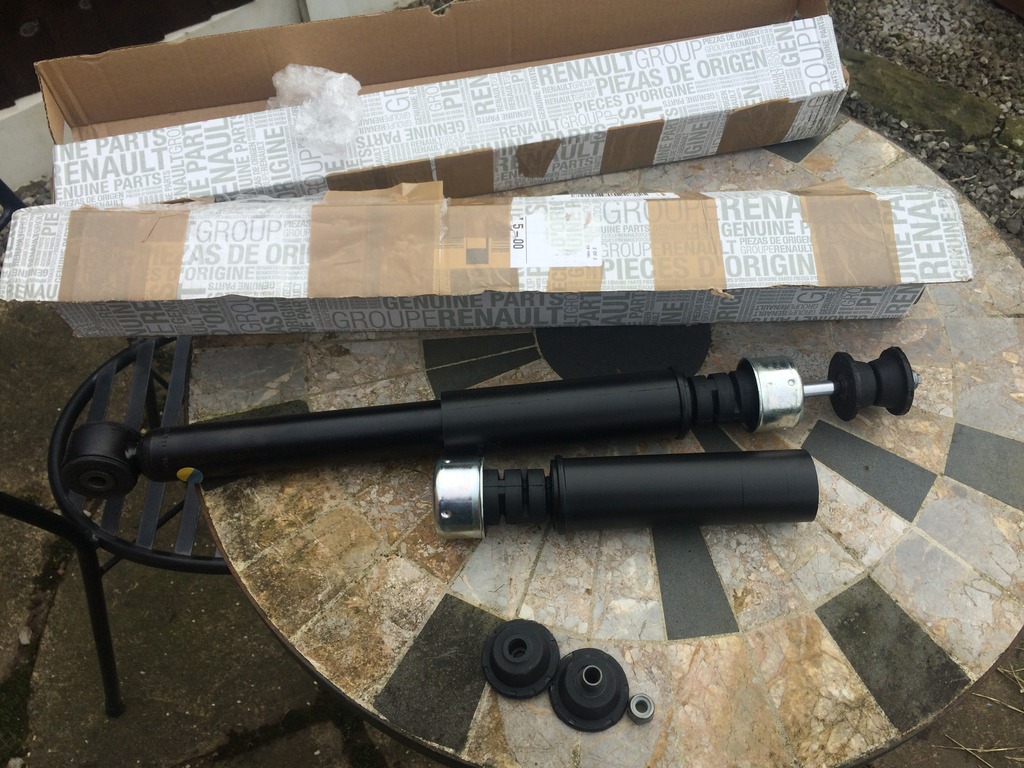

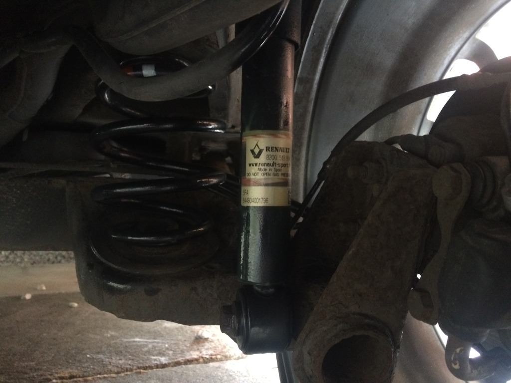

Finally on @Tommo. advice I sprayed the new sachs rear shocks in some wax spray from Bilt Hammer as I had noticed that for some reasons the shocks from Sachs seem really suffer from rust. Again my hyper clean spray booth was used.
The Trophy Sachs dont come with any new mounting kit so I picked up a set of unused 182 cup rears to nick the bits from.
So finally at last.. 120 has sachs all around..
