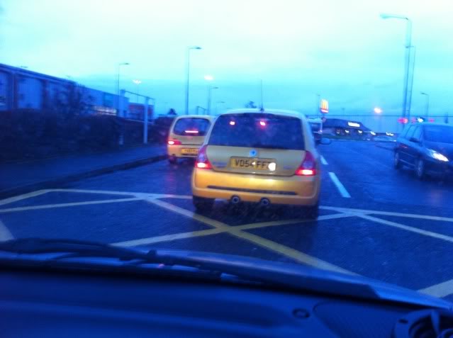

Looks like its been bought, seen at the fort in Edinburgh
  04 Clio 172, Meg 250
I remember it being on gum tree back in may in Edinburgh. Was about £5000 they were looking for it. Looked quite nice at the time though.

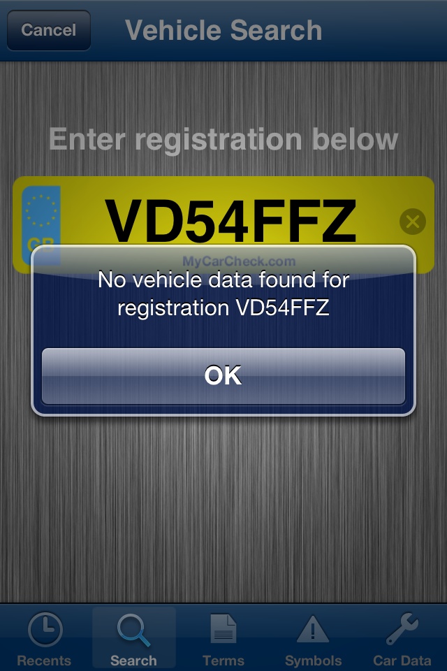

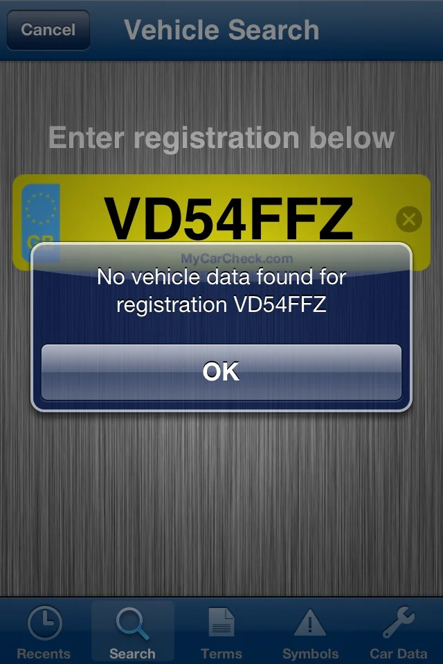

When I looked back at the photo when I got home I thought it was VD54, it wasn't though.
Some old boy was driving!

Seen this driving up morningside the other day and its an older gent with specs that was driving.
