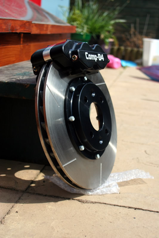

Compbrake 4 pots.
  205Gti,HondaCBR600RR
How much are they? Do they come with the callipers?
Just looked on shed motorsport and they are £799 for callipers, discs, brakets, bolts, pads and braided hoses. Is that a lot?
How are they from cold? Do they squeal?
