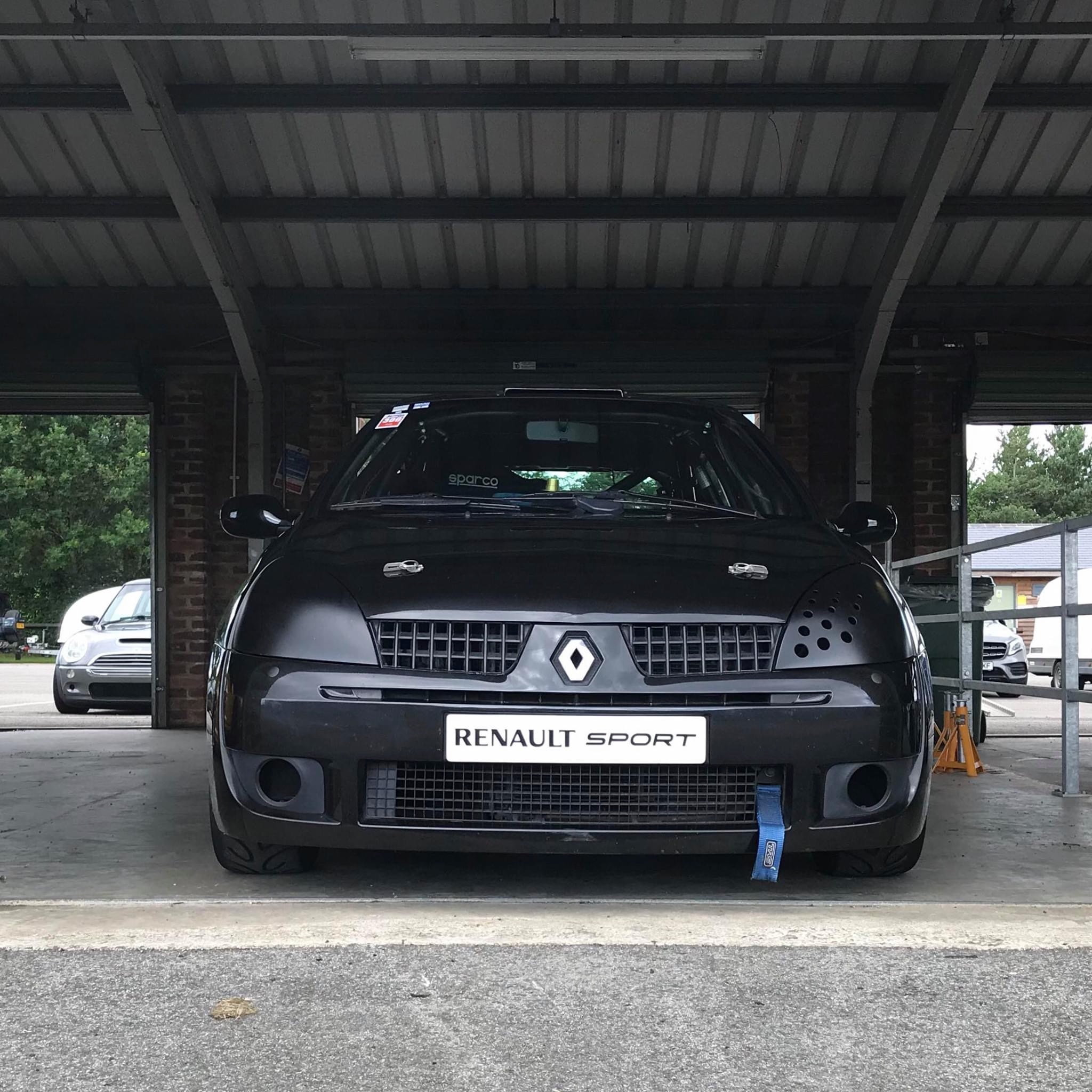

This is my hill climb car,
you can get away with a bit more camber on a full blown track car but I need my tyres to work from cold temps which limits my options

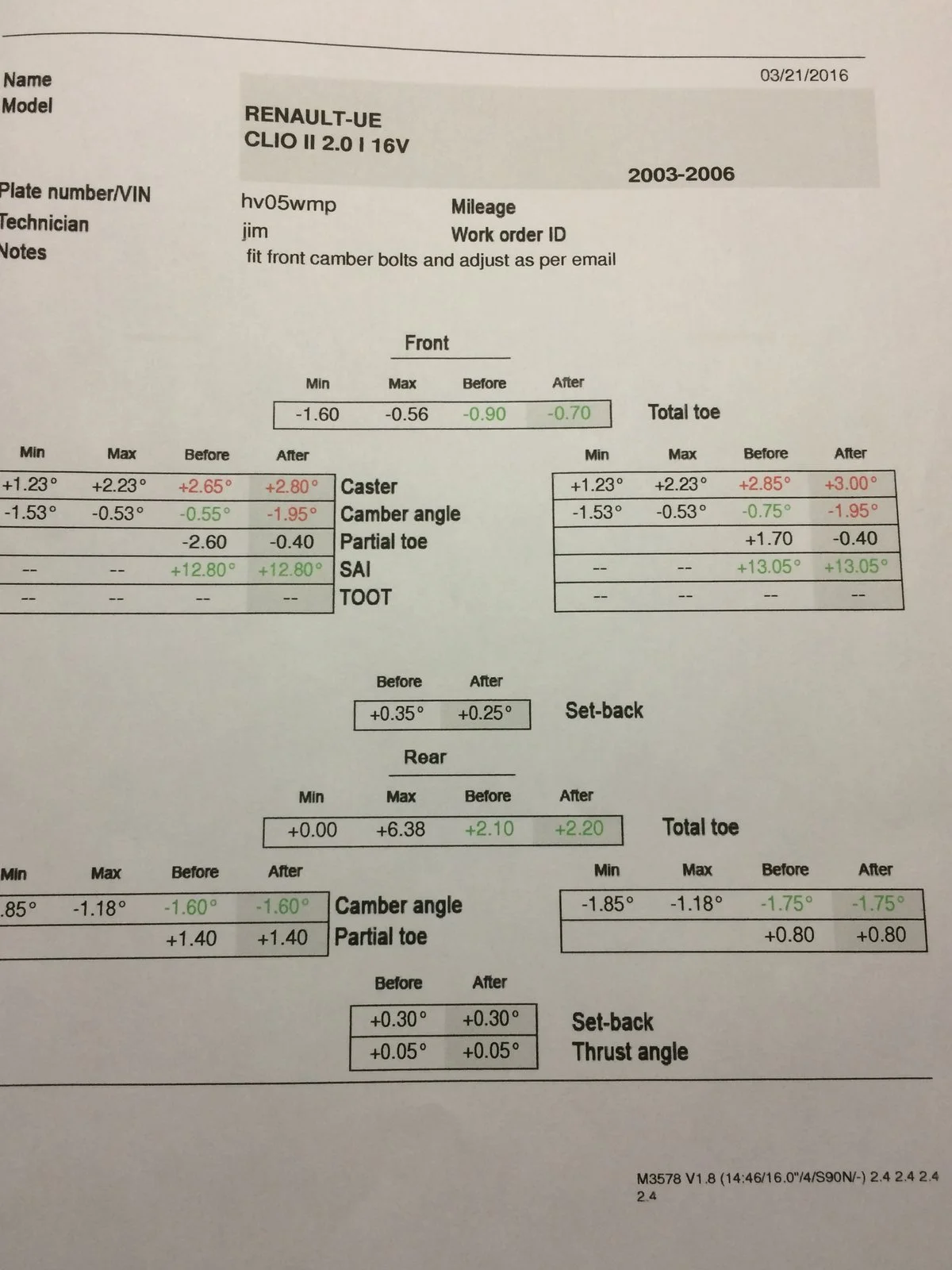

  Clio Sport 182

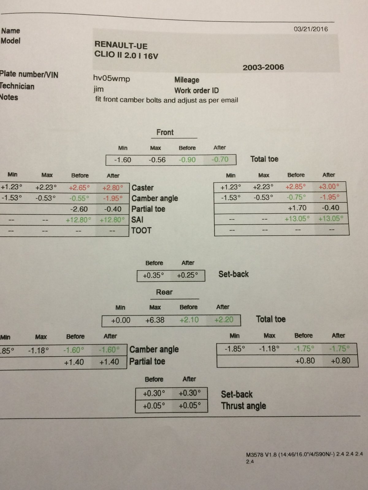

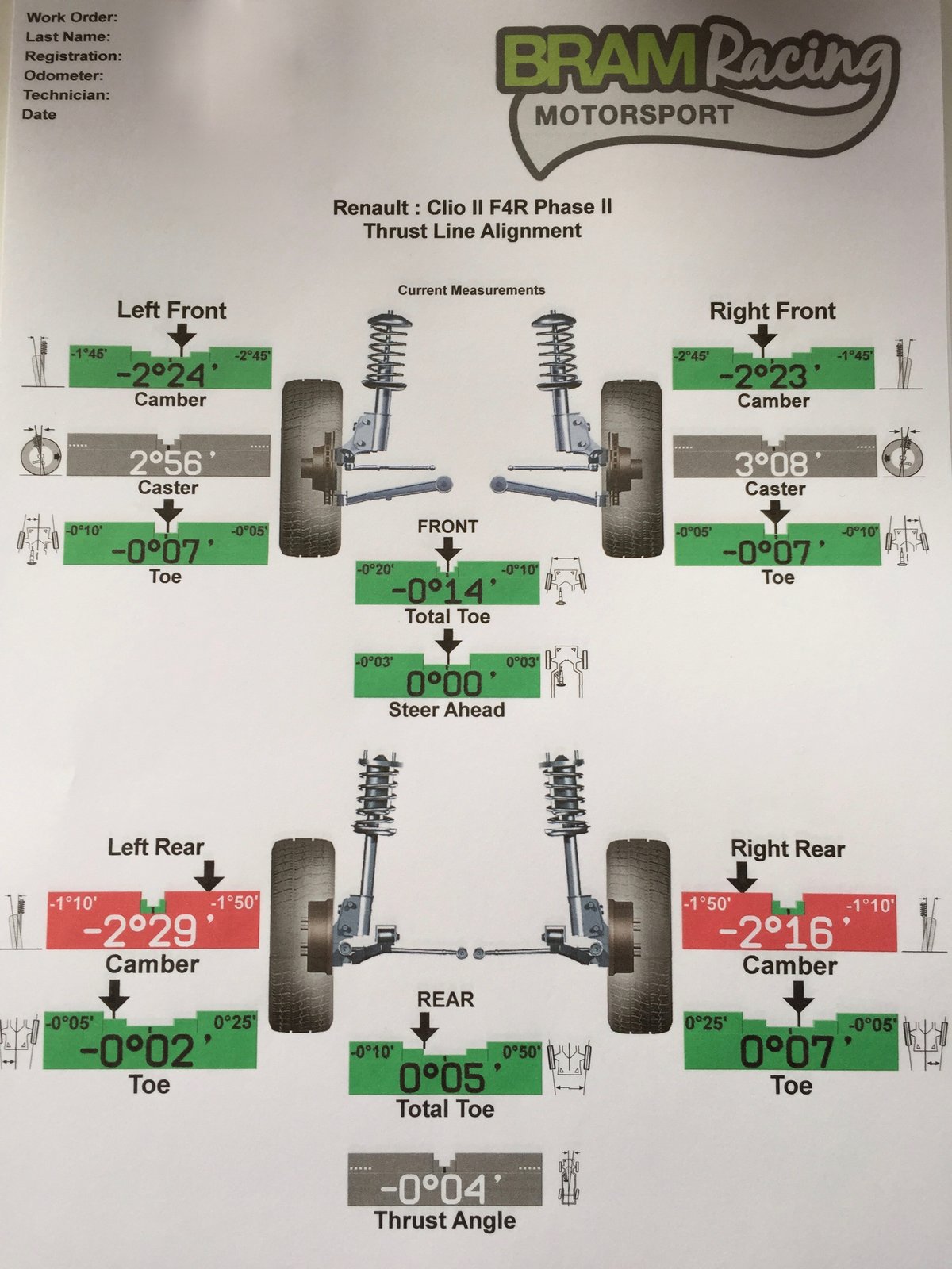

I did my alignment today and the camber bolts fitted. The results are:

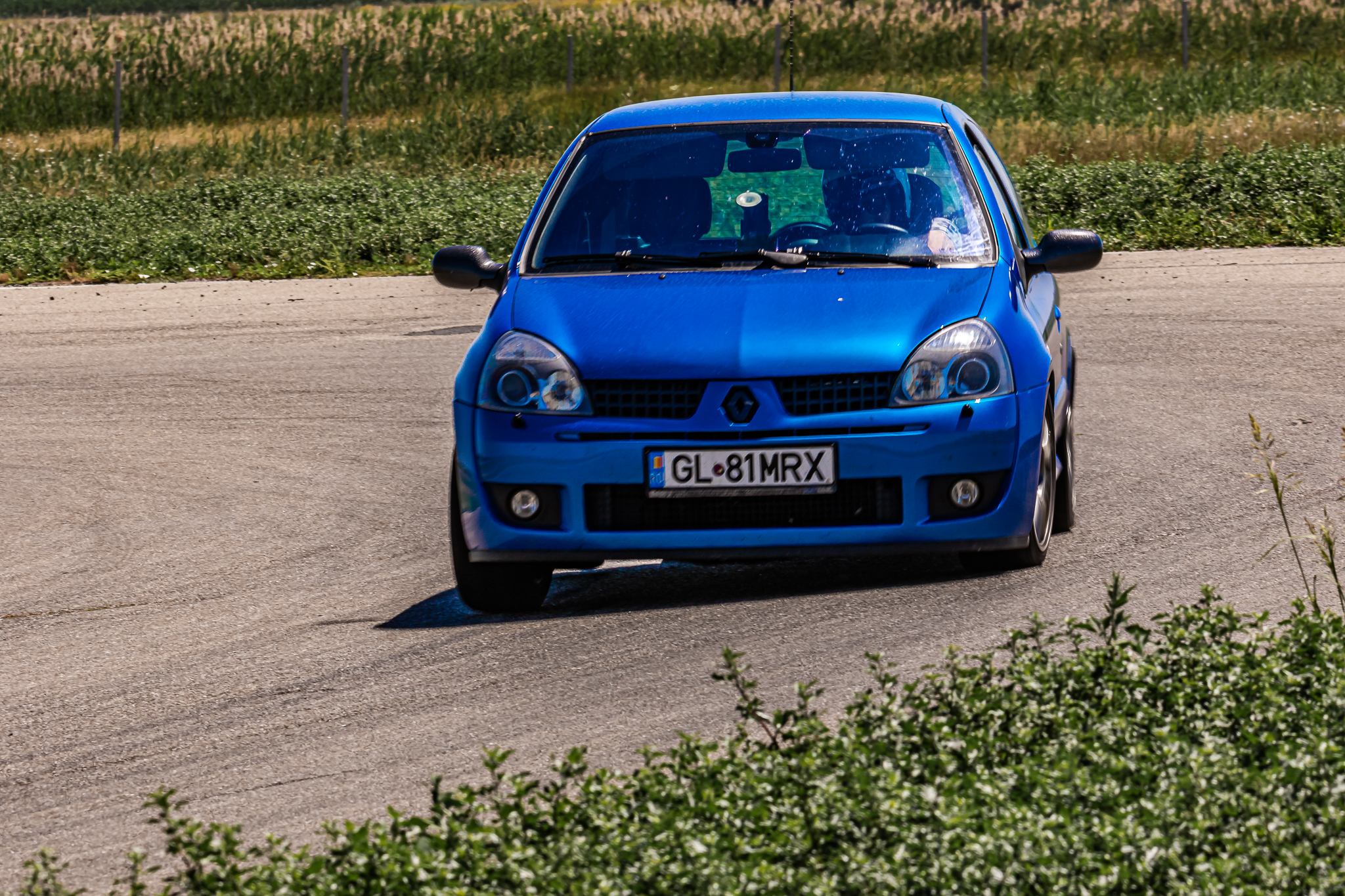

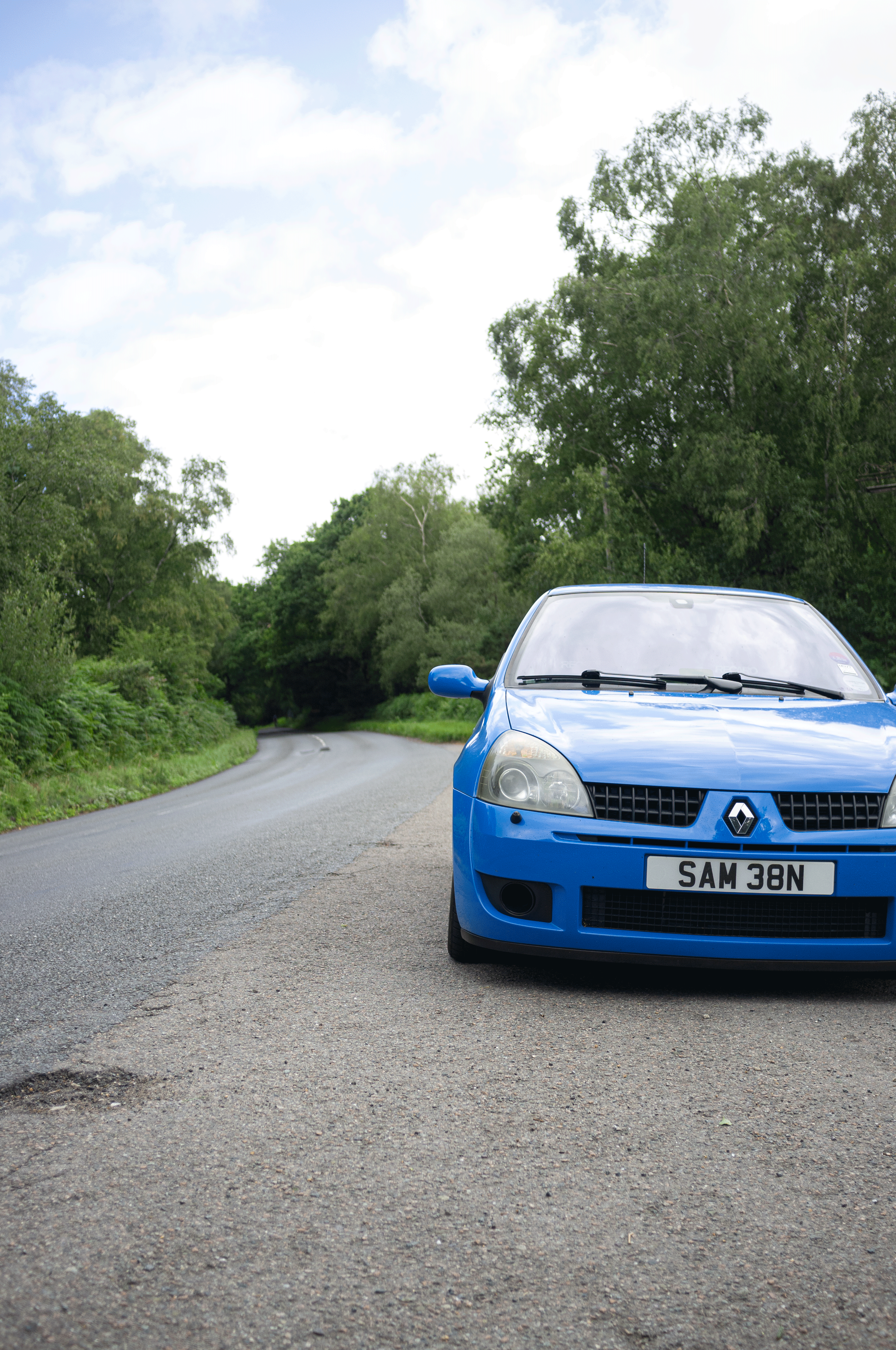

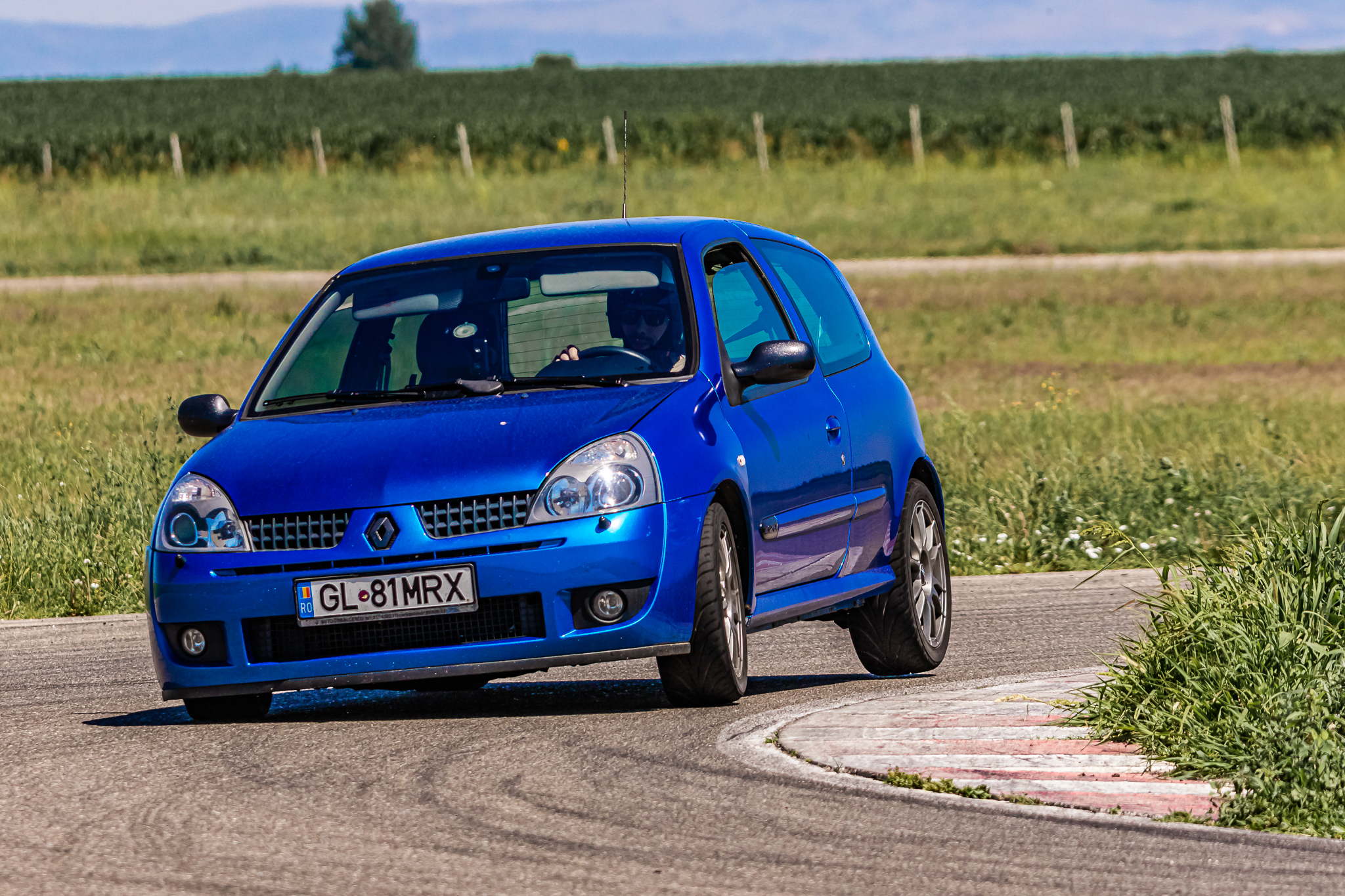

here's how it looks in action, she has some body roll and likes to lift a wheel here and there :)
