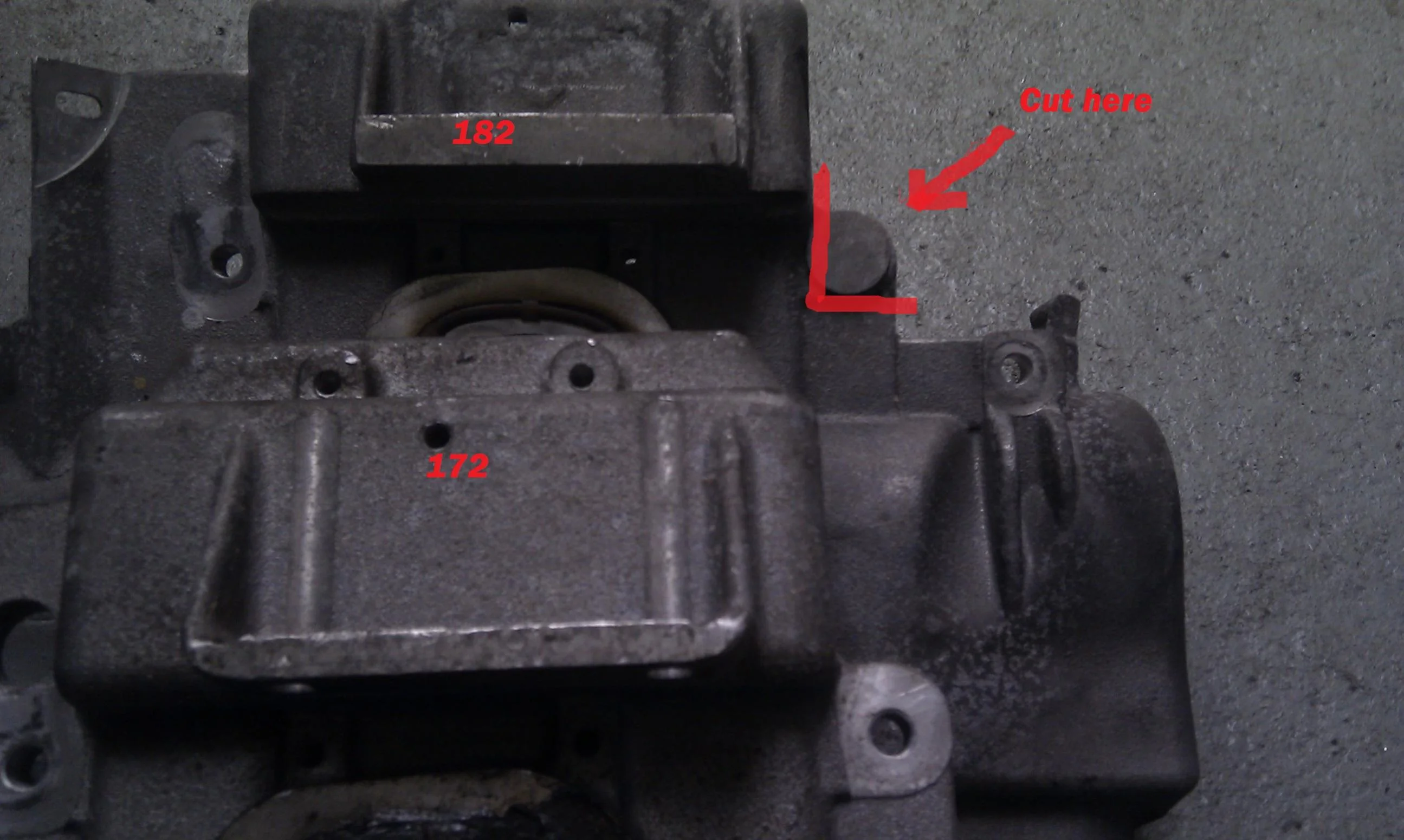

As the title says really whats the difference exactly between a set of 182 and a set of 172 inlets? Have searched loads and the best thread I could find was the below but it's not exactly a clear answer.
I've got a 172 ph2 and just want to know if I buy a set of rs stamped inlets from a 182 will they fit. I'm sure I read somewhere the throttle body is different so would it just be a case of taking the throttle body off my existing 172 inlets and sticking it on the 182 inlets.. In the below thread DAnny says a pipe needs blocking off, anyone know which one and how exactly you block it off...

The plenum is different (the bit with "RENAULT SPORT" cast into the top) the inlet maifold is the same fitment

182 plenum only fits 182 engine
inlet manifolds fit either 172/182
you use your ORIGNIAL plenum all you change is the lower inlet

not quite true actually. You can get a 182 plenum to fit a 172 engine quite easily. A 172 plenum however will not fit a 182 without a lot more work
I've done it 3 times now. Although one did need a small piece cutting off the plenum

Ahh right well I'm looking at a 182 plenum for my 172. When you say it can be made to fit quite easily could you explain what's involved. I'm not really in a position to be cutting up the plenum or grinding bits off it so if it's anything that drastic I'll just leave it till a 172 plenum comes up.
182 plenum only fits 182 engine - WITHOUT MODIFICATION

More than happy with your responses Fred, but then Danny says 'You can get a 182 plenum to fit a 172 engine quite easily' all I'm asking really is what exactly is involved. Without that info I can't make an informed decision about whether it would be 'quite easy' for me and whether it's worth the effort.

I'm not sure how easy it would be as the ph2 breather plate has a huge hole in it. Presumably welding something over this, putting a small hole in that, and fitting the plenum would work. Only guessing mind :)

Sod that for a game of soldiers I'm not welding things to make it fit, I'd have to hire a welding kit for starters.
From the post I linked in my op I thought it was just a pipe needed blocking off 'Re: 182 inlets to fit 172 - will fit, needs a pipe blocking off' which sounded fairly simple, rubber gromet or something straight forward like that. But if welding and drilling etc is involved then it's just not worth the grief.

2 out of the 3 I've done bolted straight on, with a pipe blocked off. One needed a small corner cutting out with a hacksaw

Awesome cheers Danny, no drama with a bit of hacksaw action. Where's this pipe you block off then or do you block a hole in the plenum that a pipe would go to in a 182?
