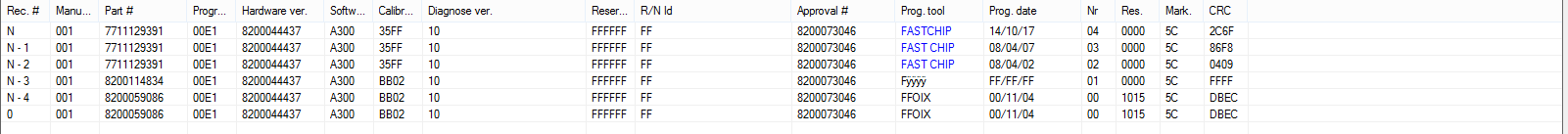

right I'm a bit confused here.
Can somebody who knows for a FACT what the 98ron map does reply please.
ive just taken my car out to get some fuel etc and while on a long dual straight I planted it in 2nd gear and hit the limiter at 7.5k done the same in third, planted it and hit the limiter at 7.5k.
ive got an RS tuner on order and was wondering if it will show any other map that could have possibly been done?
The bloke who had the car before me said it had been mapped but couldn't remember where or what map (he had no reason to lie I bought it from a car garage, I just got his number off old paperwork - I'm only the 2nd owner from new)
Will whatever the ECU is running have a distinct code to a version of a map? As in a standard ECU version has a certain code?
I did plug bobs rs tuner in at oulton but it didn't show any maps, just the same code as his standard ECU but that could of been because the module is locked to his ECU I guess.
I will find out when mine arrives but I'm just curious if every map has a distinct code so I can cross reference it and try and find out what it is and who done it if there is one. I don't want to be putting the 98ron map on and then finding out it has actually been properly mapped somewhere else.
I can save the current ECU file anyway cant I and revert back to it of I wish

If you're revving to 7.5k then its been mapped in someway.
When you connect the RS Tuner you should see a history of when calibration files were changed etc.

hmmm. Cheers guys. Will I only see that James if the tuner is unlocked to my ECU as I plugged in bob the builders and it didn't show anything previous.
LeeRS
In the list at the top where it says programming history, will it tell me what map has been put onto the ECU previously?
so for example, if it is already running the 98ron map it will say fastchip in the "TOOL" tab.
If its just standard what should it show?
I'm not sure mate to be honest.
@McGherkin will know more than me about it. Its been a fair few years since I've messed about with one

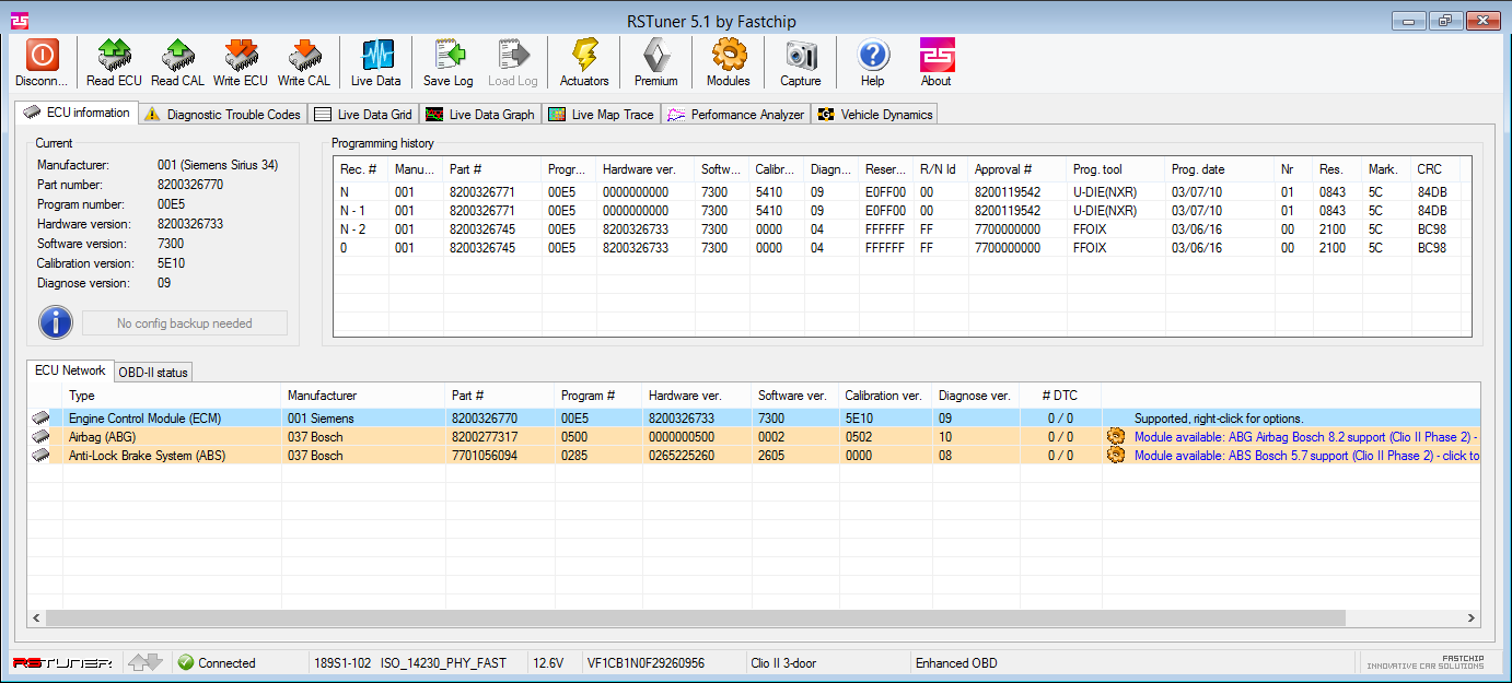

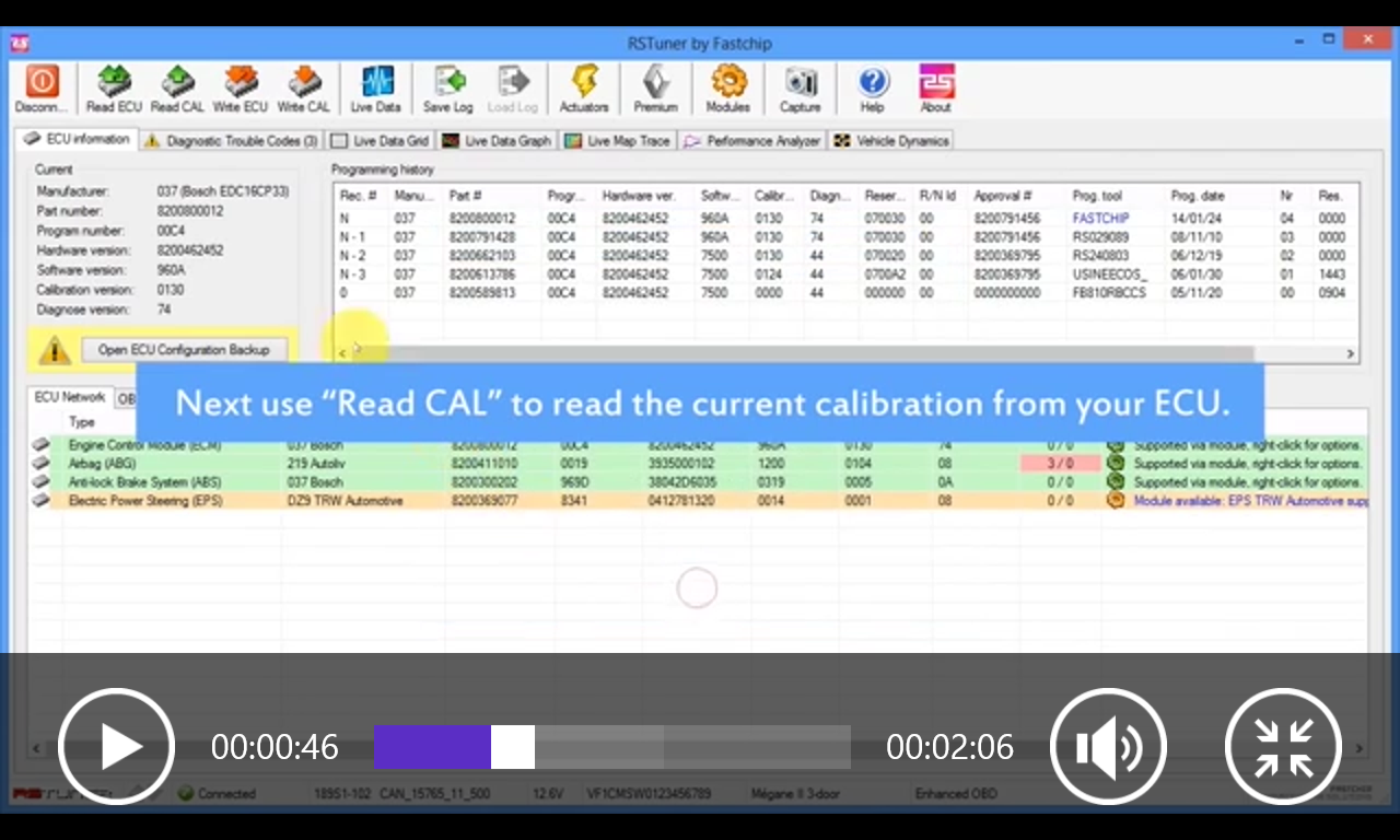

IIRC if the RSTuner isn't unlocked, it won't show anything in the top right, but it still shows the calibration in the bottom list (below where it says 'calibration' on the caption in the above screenshot, in this case 0130)
If the car has an RSTuner Map then it will say Fastchip. I'm willing to put money on it being RSTuner'ed already.
I thought mine was unmapped, but so did the last two people who put rstuner maps on it.
Mine still gets the 5k kick too.

cheers @McGherkin. I will just have to wait and see then. So I just unlock my ecu with the code Henk gives me and see what it says in the top right? Anything to do with fastchip will be the 98ron map?
Pretty much.
i take it FFOIX is the standard ECU software that the car comes with?
On mine yes. Yours may be different.
this is strange mine says fastchip on screen but no 7.5k limiter odd
What is it limiting at? 6800rpm?
BoatNonce
Is it listed twice, or anything listed above the fastchip entry?
You've got the standard map, so it could be an unsuccessful write, or it could be that whoever programmed the car took the map off for some reason.
ADS_V6
  Seat Leon
hi no i remapped it ,henk said i probably read the standard ecu cal,he said even though it says fastchip doesnt mean the right map file was usedgoing to retry tomz got new license and map again 2nd time lucky lol
BoatNonce
Sounds like you've backed up your standard map then accidentally uploaded that rather than the 98 ron one then.
The fastchip entry on the ECU history is related to the software used to load that cal, rather than the cal itself. Theoretically you could create a custom map in RSTuner and it would still say fastchip.
