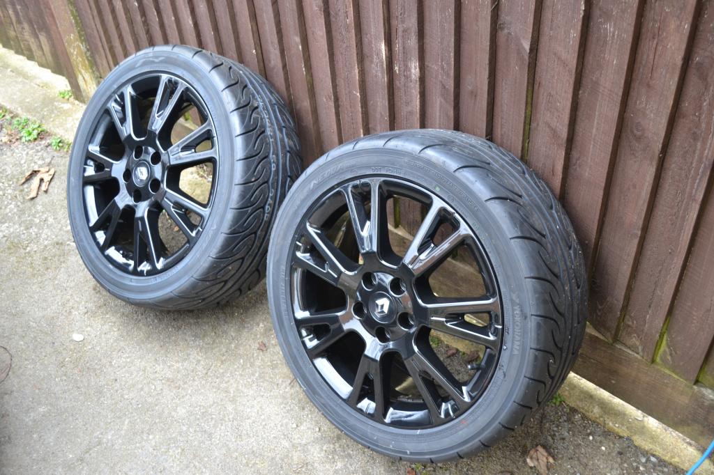

Can you go wider on standard alloys? Noticed a lot of the tyres available for the 200 were lower profile. Like I need that in my life, with potholes and cup chassis it hurts enough as it isYokohama AD08's in 225/45/17. JD.
I got v12 Evos on my 172 and they are a cracking tyre. I have had contis before and they were s**t in the wet.215/45/17
I have Hankook V12 EVO on the front of my 200. £70 a corner. Definately not half as good as the Contis as the price reflects...but...they arent as good thats for sure
I would be putting Pirelli Pzero Neros or AD08s on it.
Dont go for 225s unless you have 8j wheel. Stick with the 215s on 7.5j. I put some 225s AD08s and they looked silly big. Im currently running 215/45 AD08 on 8j Oz Ultras and the fit is much better. AD08s are the best tyre i have ever used in the dry, not so good in the wet. [/IMG]
