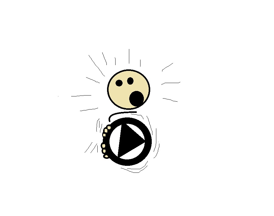

Had a whiteline fitted a few weeks back. Finally got to test it this weekend. Since I am known on here for vague drawings, I drew one describing my experience with the RARB in the wet this weekend.
I've never had an issue in the wet with my Whiteline set on hard, maybe I don't drive daft enough lol
On track however it's brilliant, really makes the car feel flat/neutral in the corners.
