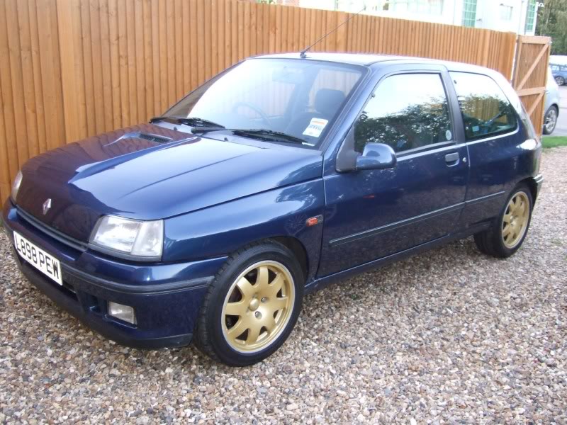

Here is my project for my new toy.
She is Williams 0161, currently with 109000miles on the clock.
The Williams is in superb condition, it has very little rust on the arches, it has a tad on the drain holes on the boot lid and a tiny bit on the front panel, but its nothing that is a major issue, yet.
She is completely standard, bar Hill Power Plug Leads & will be staying that way for now, for the very least.
Plans for now are to keep her maintained to a very high standard.
I want to give it a good service, including a ITG air filter and some decent plugs. It probably needs a timing belt change, its done about 10000 miles since it was last done, but that was ten years ago.
It has a Clifford thatcham alarm, which is very sensitive, i want to get it either fixed or replaced. Also want to get the radio sorted, it has door speakers, but would like to get Williams 3 door cards, so i can have proper speaker inserts.
Also want new seals for the drivers door windows, they have started to corrod on both sides and the weather strip too.
I also want some decent tyres on there, ideally PE2's if i can get hold of some in 195/50/15 fitment, i ain't too bothered about keeping the original 185/55/15 size.

After spending a while today pricing bits and pieces up, i am gob smacked, price of parts are stupidly cheap.
I have ordered a set of front indicator units for £5 + vat each. The trims around the doors are £58.75 a side, which isn't too bad at all, about what i was expecting. A genuine rear lamp is £17.62!
Also had it up on the ramp, and its largely very clean under there, one of the rear brake pipes looks like it probably won't make it through to the next MOT, but apart from that its all ok. There is a slight seep from the sump gasket, but thats part and parcel of ANY renault engine!! Looks like there is a bit of a seep of oil from the bottom of the box, but the fluid level looks all ok.
The Front Discs and Pads could probably do with changing sooner rather than later, gonna see if i can get some Brembo HC discs for it and some DS2500 for it.
Largely though, its very very good underneath:approve:

Jonni, cheers for the advice about the oil filters. We have plenty of sump sealant at work, fiat stuff and it's really good.
I will check the o ring under the dizzy, it's not a major leak the box actually appeared to be dry, it was just the bottom of the subframe. The rear crank seal has been replaced fairly recently too, so that's out of the equation too.
I have also ordered the rear lamp today from Renault, as gsf can't get hold of the drivers side anymore. Also ordered some plates from craigsplates. I also fitted a spare set of clear side repeaters to it too, although I ain't still 100% convinced they look right.

You can't put clear repeaters on a willy, they never look right!
Orange FTW!
Daz.
  Clio 200 RS EDC
Good ones are lots of pennies though.
Infact I've never seen a williams I would be truely happy with - my own included - I can pick a fault with the very best of them :eek:
