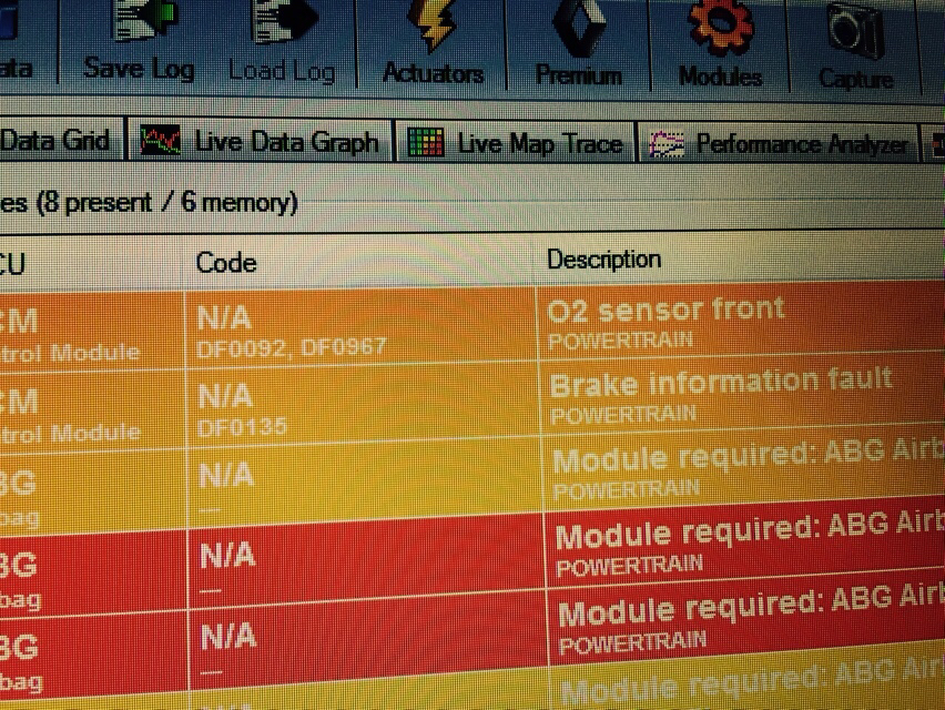

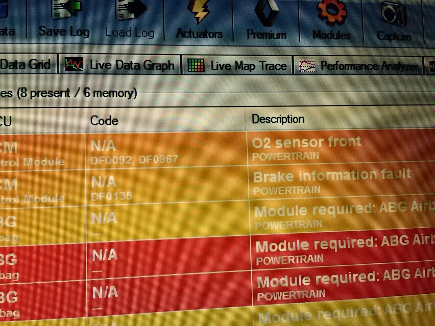

I checked the usual, leads, plugs, tdc sensor, nothing obvious. Plugged in the RS tuner box and there was a front 02 sensor in the Orange memory, deleted and it's gone. Would this cause my hesitation?

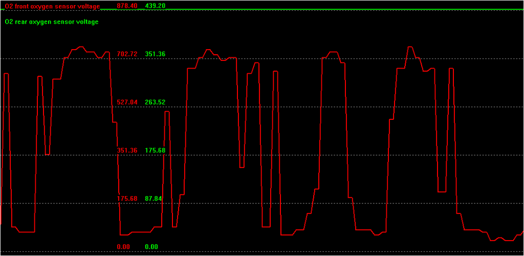

I know the voltage should fluctuate but this seems a bit wild, low of 48mV and up to the 700s
Is this normal?
U/S voltage is normal but you didn't give us a large window to see it working in and without graphing the data, you will struggle to see if there's an actual fault there.
I'd say your misfire will be something else.

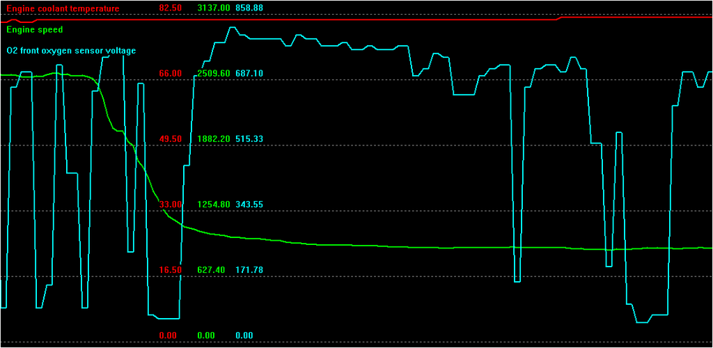

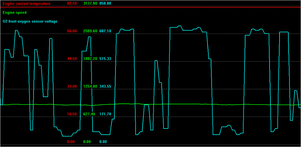

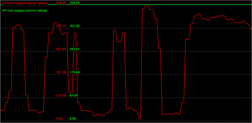

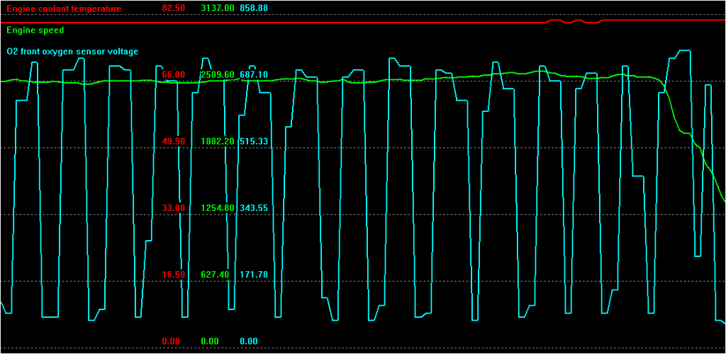

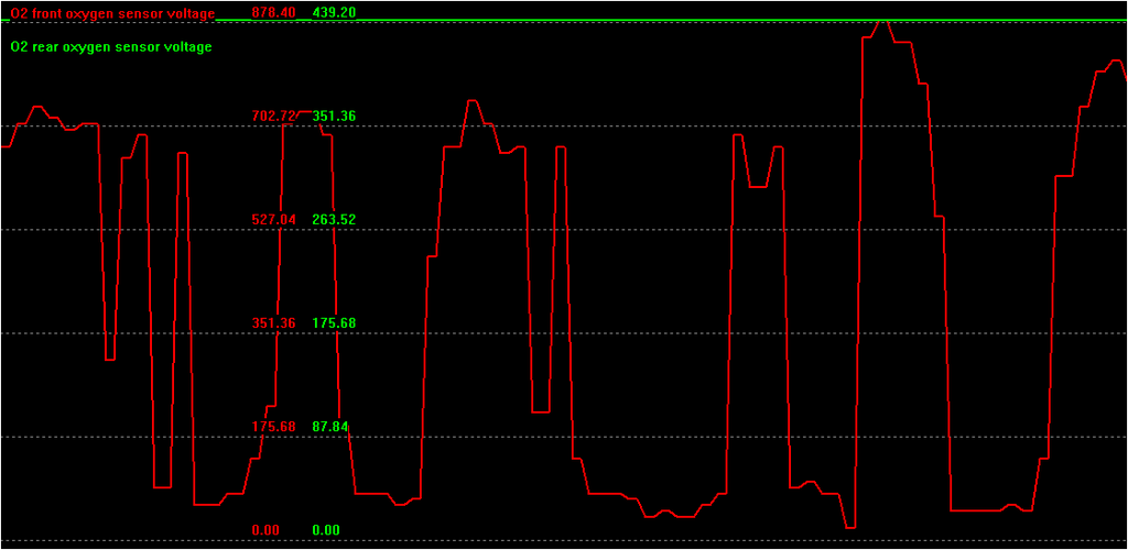

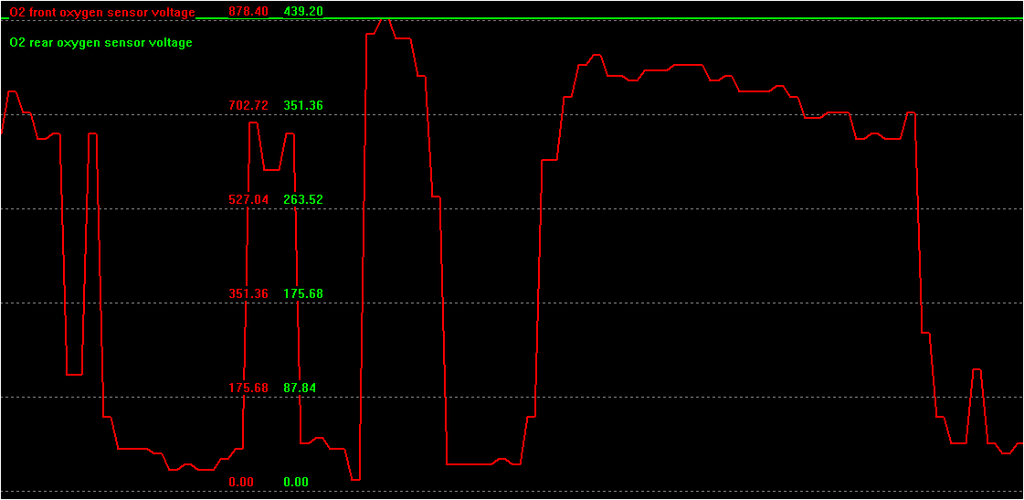

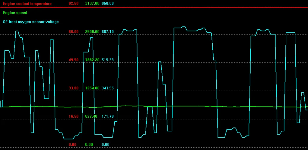

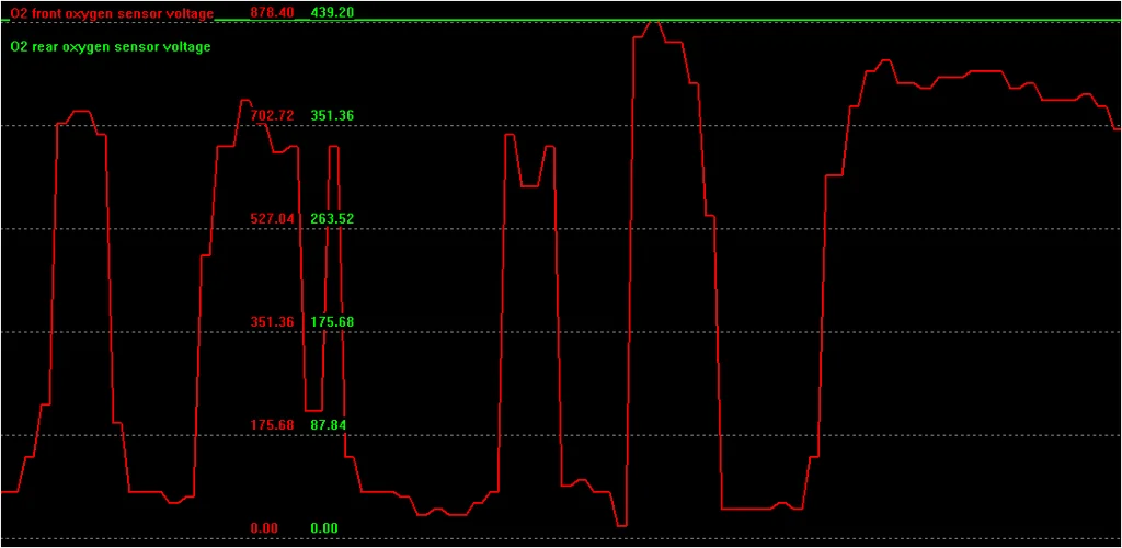

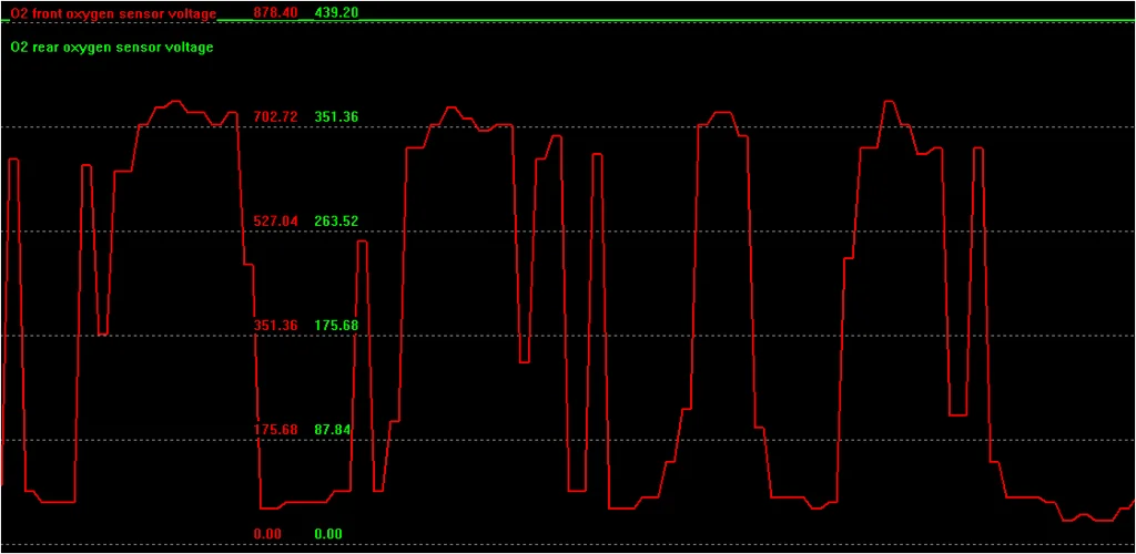

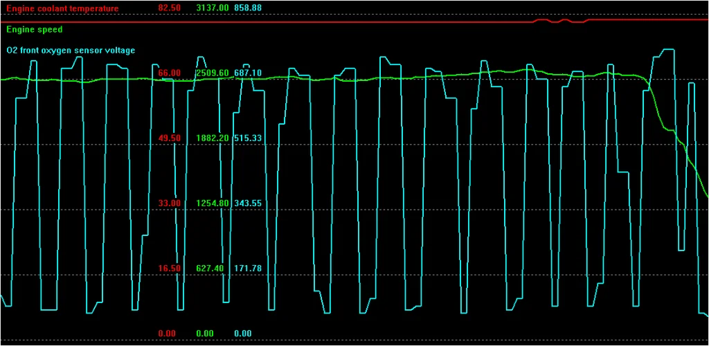

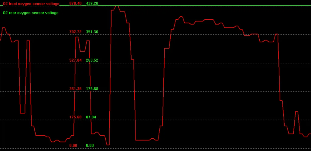

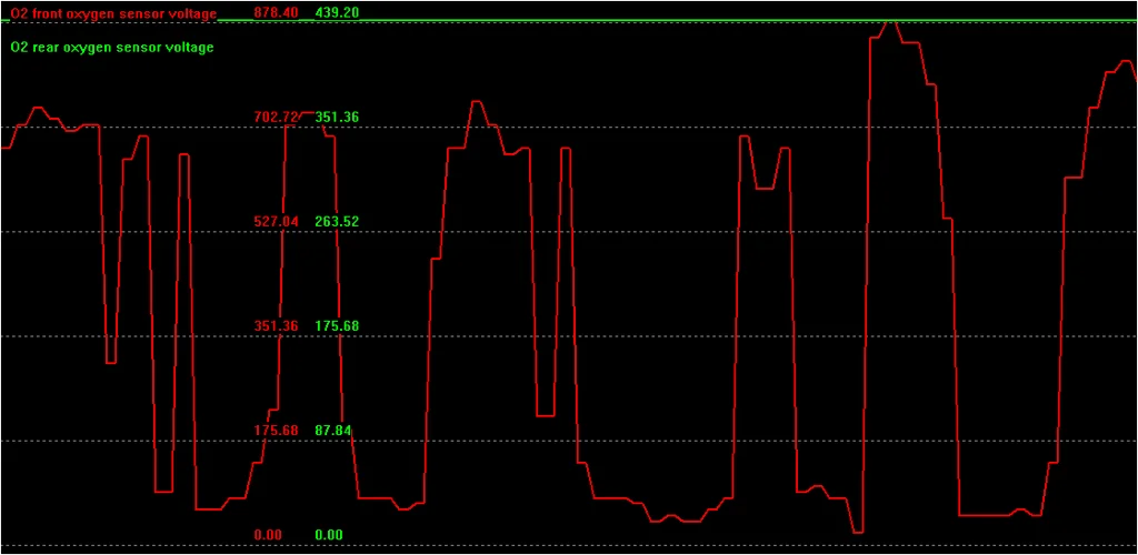

Just took some screen shots of the oxy sensors, I'd appreciate your opinion!
Assuming that's at idle and the car is up to temp(?), there's definitely an issue there.
Could be sensor but could be other things also. Can you plot another graph showing H02 vs engine speed and CTS?
Idle and fast idle please (constant 2.5kRPM)
Looks to be a faulty sensor trace to me but it could be poor injector(s) to. If you've really got 30 Ohms I'd guess these but I'd also test your meters accuracy to.
