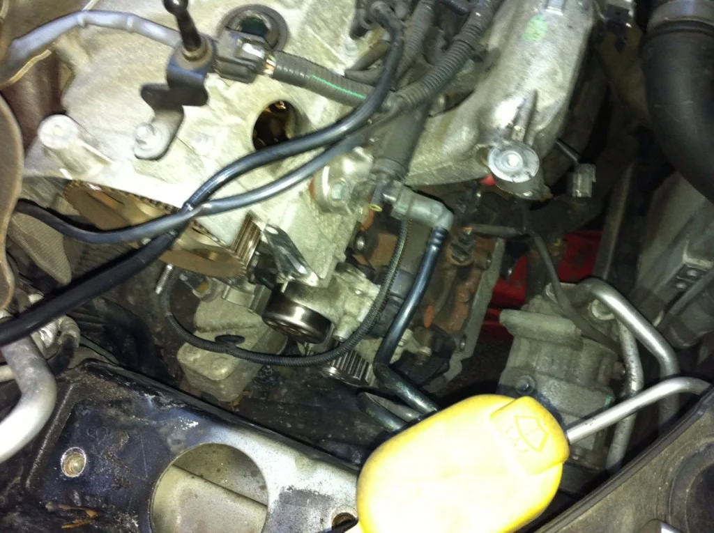

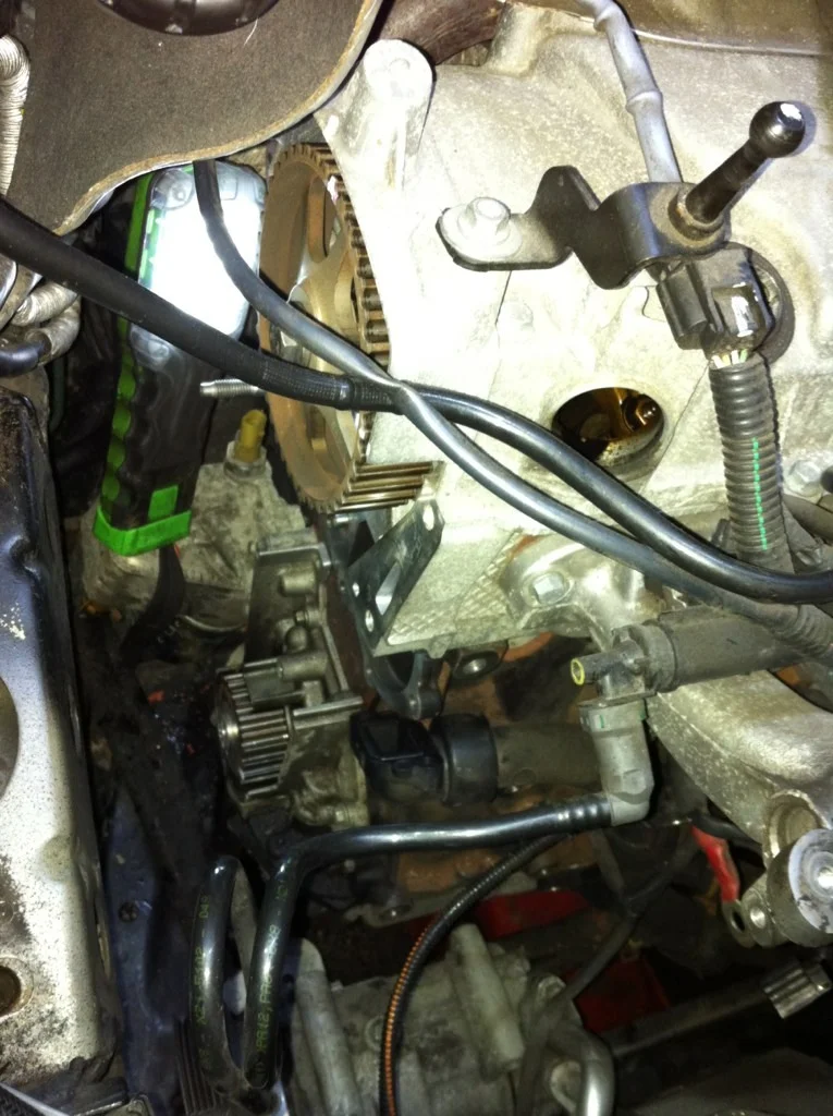

No single, I got mine cheap from a mate who had one spare due to the company who was doing his stating they supply their own parts, but was genuine. So can't really help on cost of parts I'm afraid but time it took me was about 4- 4.5 hours including pump change (timing belt itself is easy just the pump that takes time) these probably wont help but here you go anyways ImageUploadedByTapatalk1360019415.771957.webp ImageUploadedByTapatalk1360019436.172664.webp
