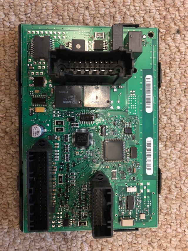

WIth regards to the UCH. It looks like the relays are soldered in?
I've attached an image of the internals if thats of any use.

I'm sure there are some more smaller fuses and relays attached to the black box on the UCH. Your UCH doesn't look to be water damaged though which is more promising haha

Everything looks very clean, whcih is a bonus - was expecting a corroded mess!
UCH wise thats all I can find - I assume the relays are solderd in (the black boxes either side of the top socket).
