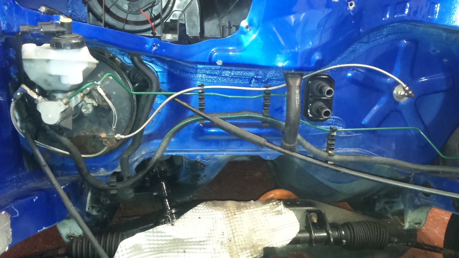

Mine when I built it.
Looking at that pic its m12 to rear, m10 for fronts

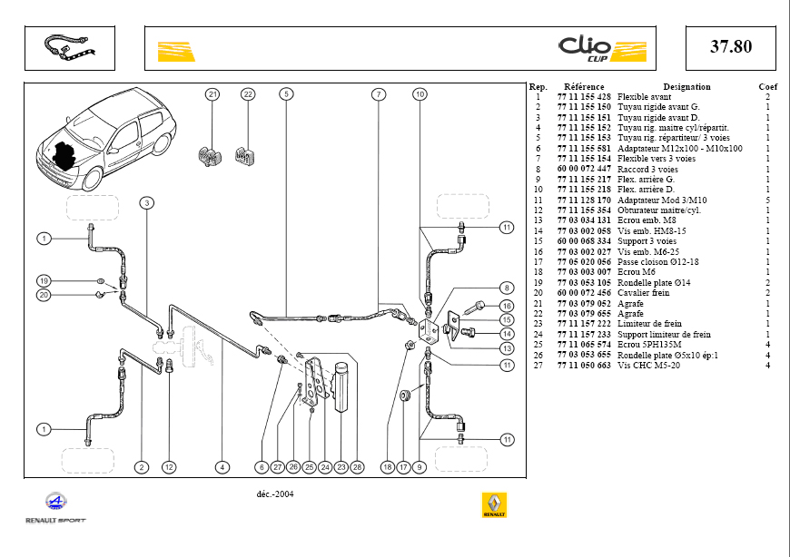

This is what I found last night on another thread from years ago.
Is that the cup racer setup?
Not sure mate. I've since been told it works 100% though.
2x m12 unions furthest from servo to the fronts
2x m10 unions closest to the servo for the rears
Blank off 1x m10 and go to the rear via an in car bias valve and then T off at the rear
