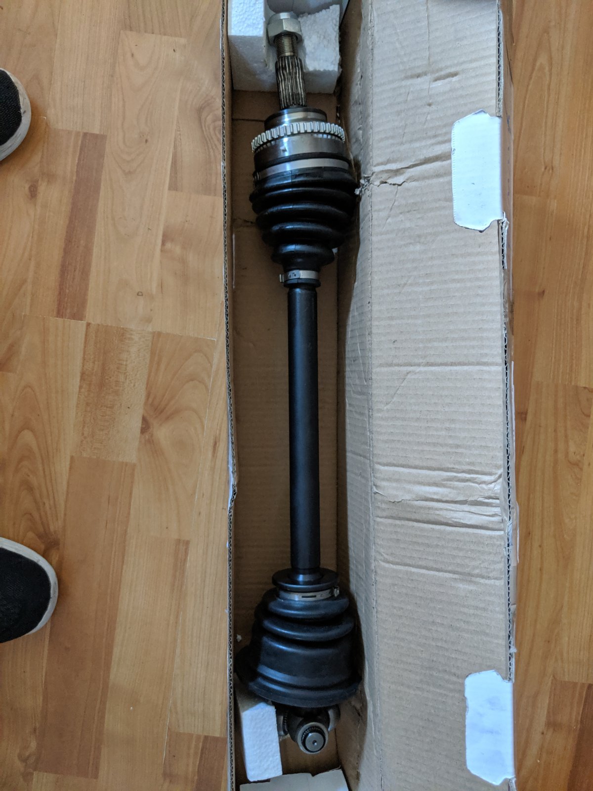

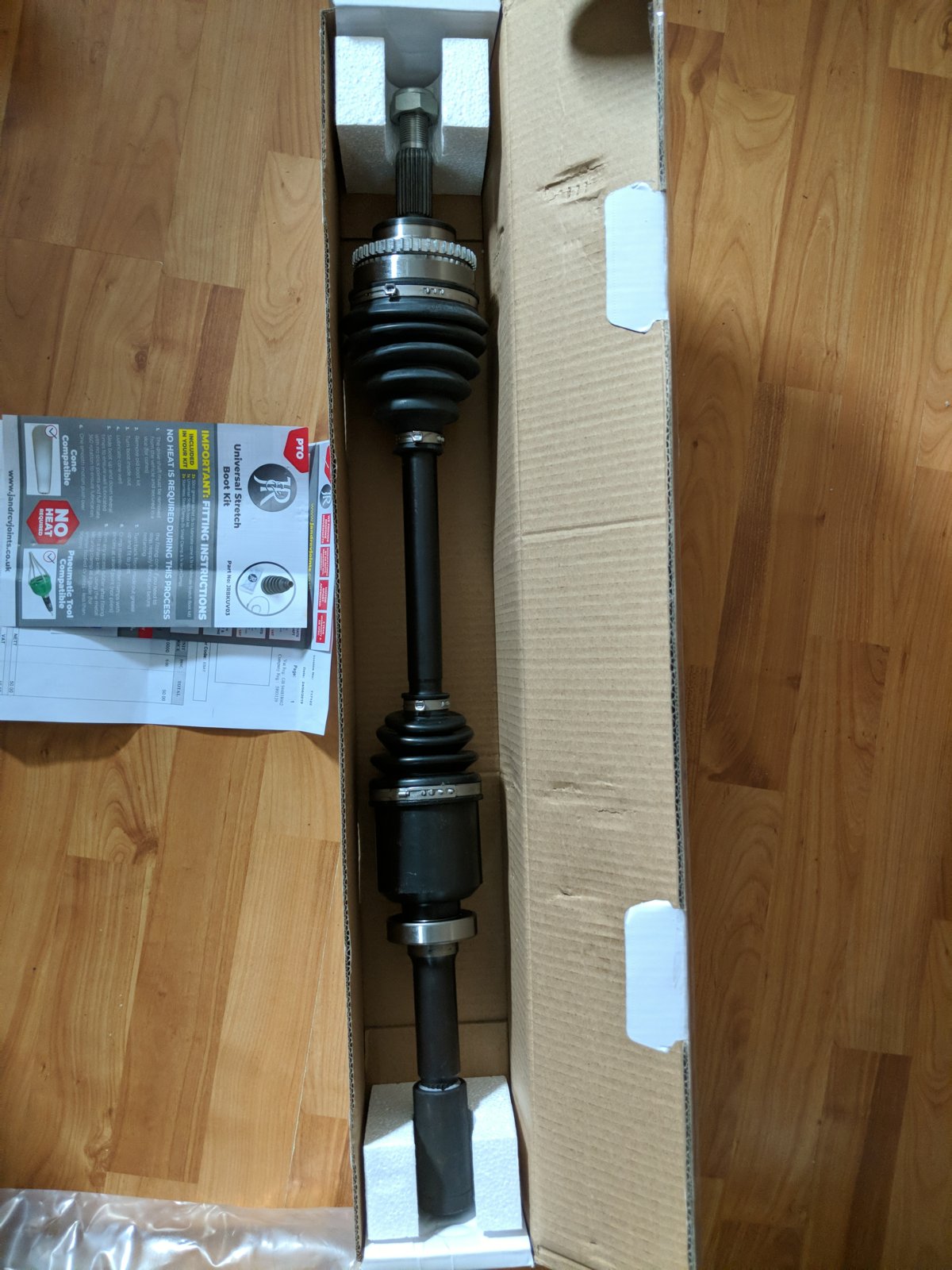

This is the part they sent me DS248 but my original has a pressed on rubber seal at the gearbox end and this doesn't. Still haven't had an answer back from them to confirm if I need to source a seal or if this design doesn't require one

The seal is seperate from the shaft iirc, it is fitted to the gearbox.

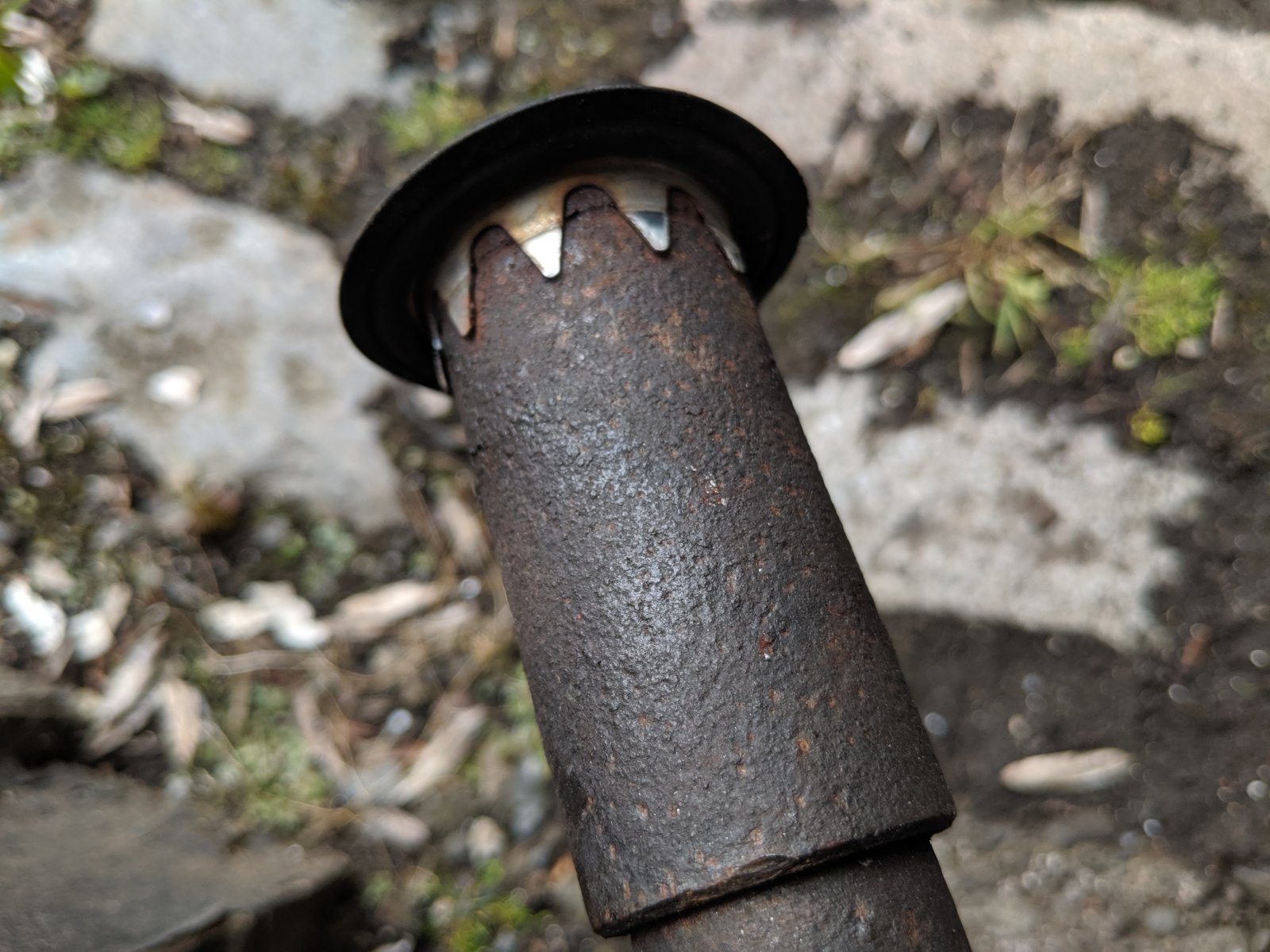

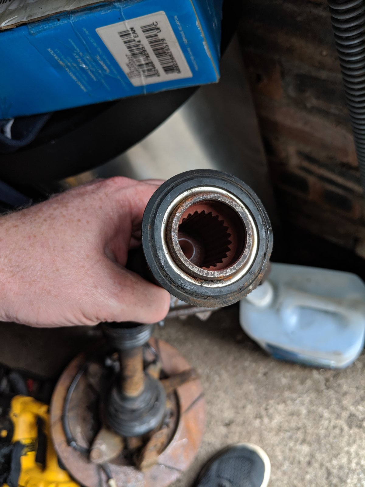

Yeh it's weird my original shaft seems to have some sort of dust seal pressed on during manufacture that aftermarket replacements don't have.

I just swapped mine over from the old shaft.
Couldn't budge mine but it's been on there for 18 years I suppose. Think I've found the correct part anyway and it's only £2
part no. 8200117465
if anyone else needs a new one.
