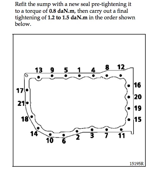

172 Sump Bolts Tightning sequence and bolt torques
I cannot find my 172 service manual :(
Does anyone know the tightening sequence for a 172 Sump Gasket ?
Am i correct in thinking the torque is 12-15 Nm ?
  HBT 172 Cup
Ahh maybe i should use that method next time, i normally just go clockwise round the sump until all bolts are suitably tight, usually takes 2-3 goes round before it get theres.

Does anyone know why there is an empty hole? I thought I had bought too few m7s earlier until I realised there wasn't meant to be one in the top left.
