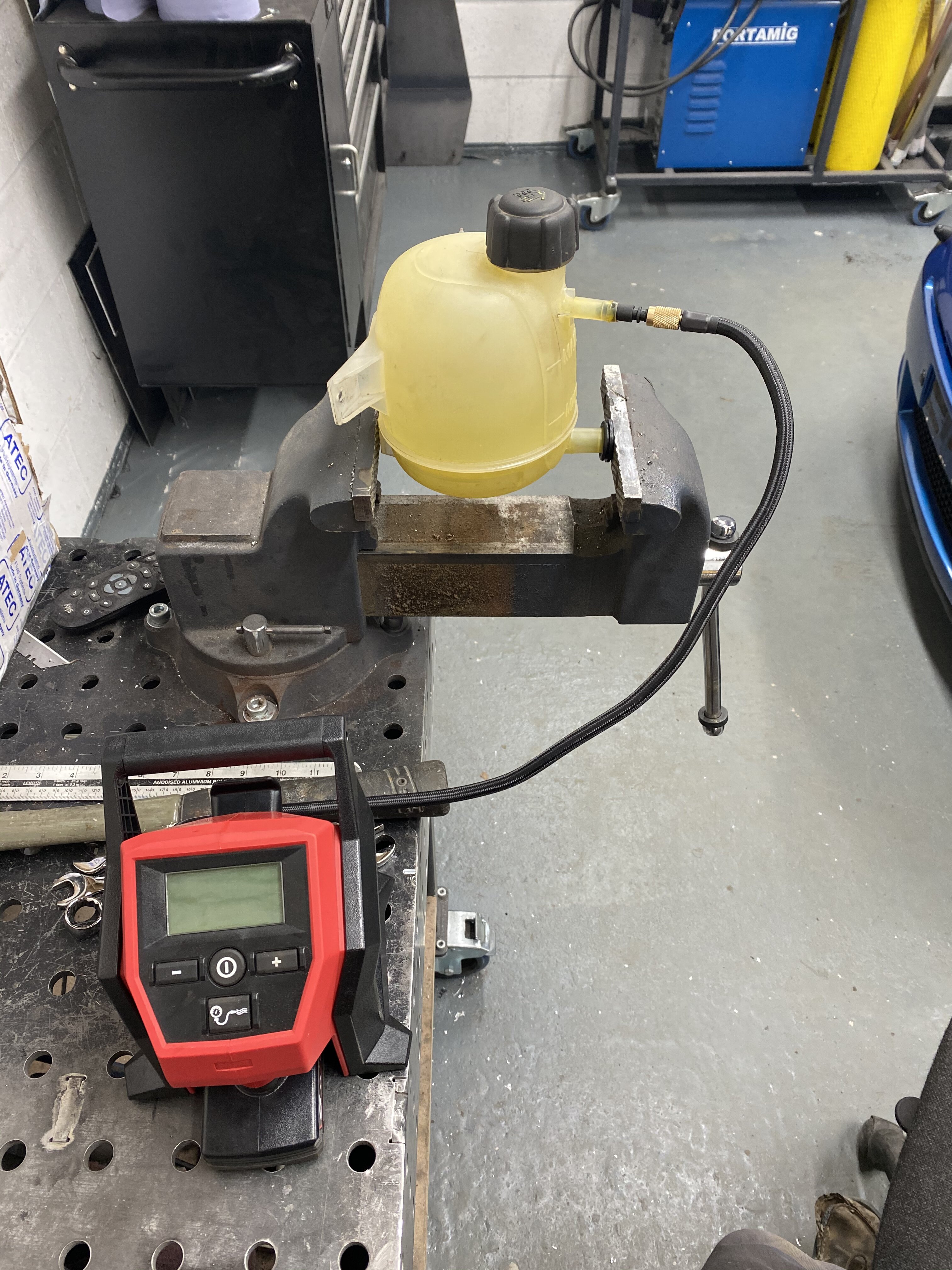

182 coolant cap pressure?
10psi was lower than I thought it would be so decided to pump the coolant tank up and see what pressure it got to.
Seems like it’s 20psi and is more like what I was expecting.
Bit of water in the tank so I could tell when it’s coming out of the lid.
