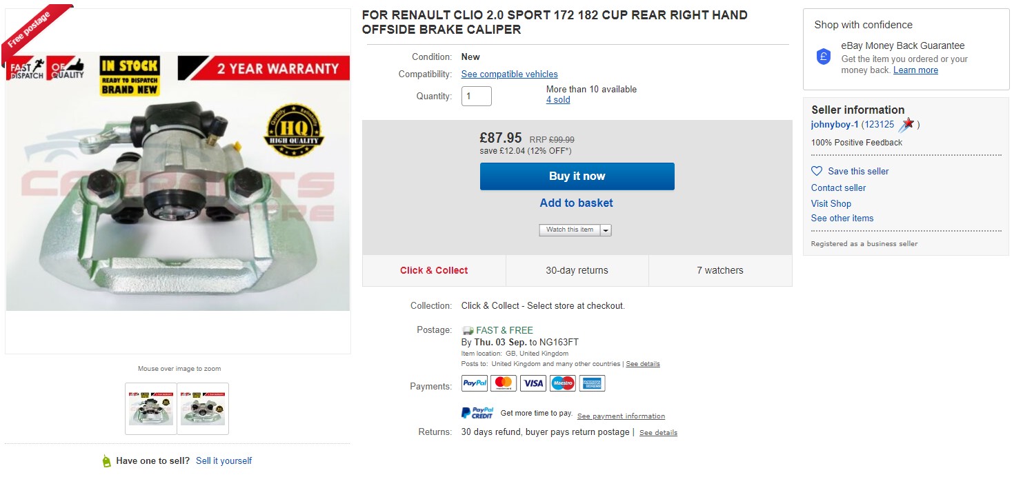

Looking for a little advice. I've just noticed my handbrake isn't working for the drivers side wheel. I've taken a look and it seems the swing arm is knackered (doesn't move back to position and doesn't do anything when the handbrake is up.
Is the below the correct part to replace the caliper? Is there a better place to get these?
https://www.ebay.co.uk/itm/FOR-RENA...+Sport&hash=item25884c2555:g:oloAAOSwAvFcbYQz

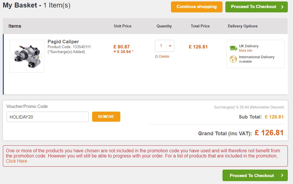

I have just tried the code on CP4L but it said it was invalid on the caliper.
Using code BANK70 on ECP gets it down to £127.06 with the surcharge so not too bad. Ordered some fluid too as I assume I'll need to flush that through?
