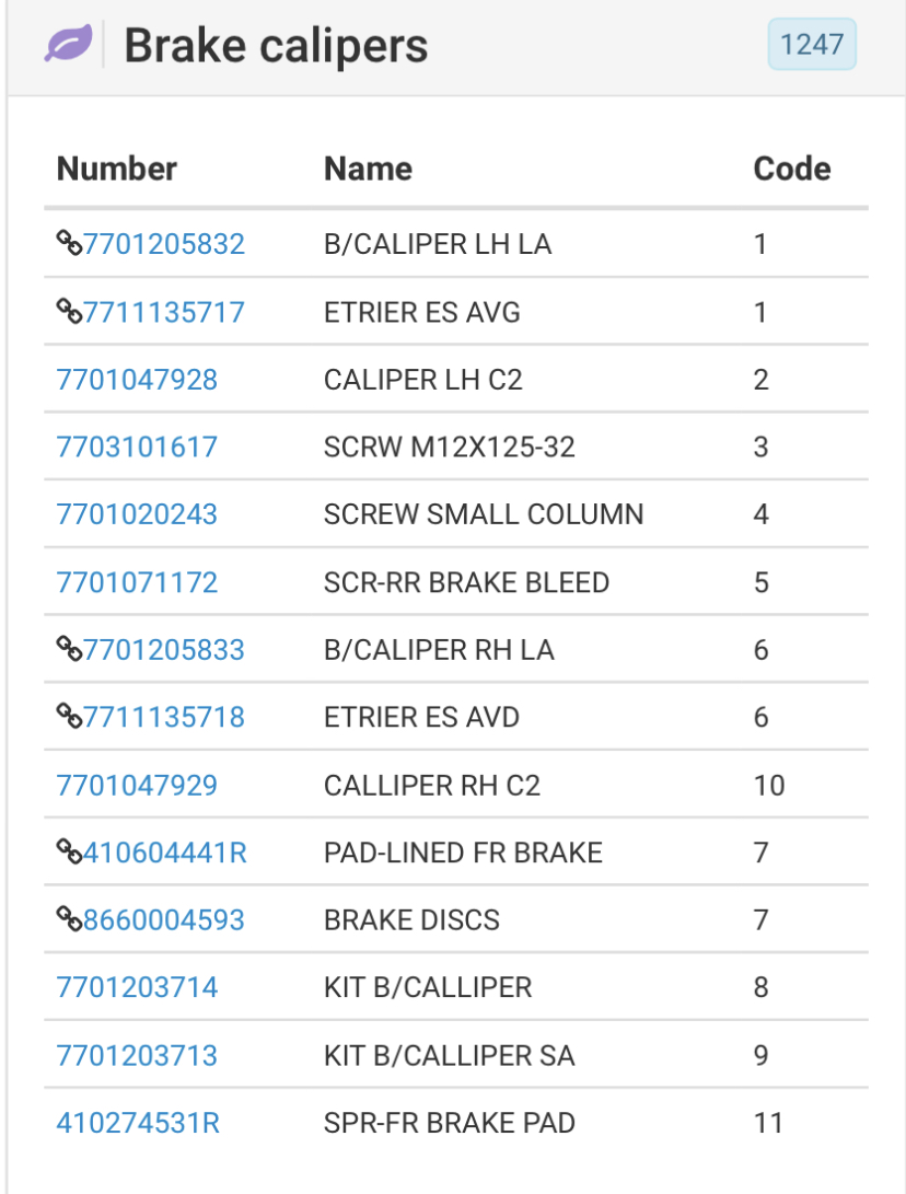

LH side is 7701047928
RH side is 7701047929

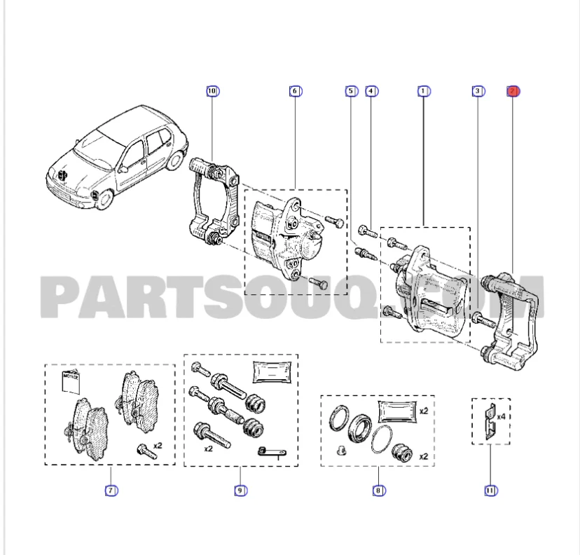

The calipers and carriers were made by TRW-Lucas for Renault.
Here’s what you need if you’re going new. 182 CB22.
RH Front Caliper - P/N (7701205833) - OEM Mfr. TRW-Lucas P/N (BHW242)
LH Front Caliper - P/N (7701205832) - OEM Mfr. TRW-Lucas P/N (BHW241)
RH Caliper Carrier - P/N (7701047929) - OEM Mfr. TRW-LUCAS P/N (BDA492)
LH Caliper Carrier - P/N (7701047928) - OEM Mfr. TRW-LUCAS P/N (BDA491)

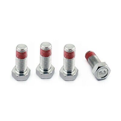

If anyone needs replacement bolts and doesn't fancy paying Renault £9+ per bolt I found these to be a solid replacement.
