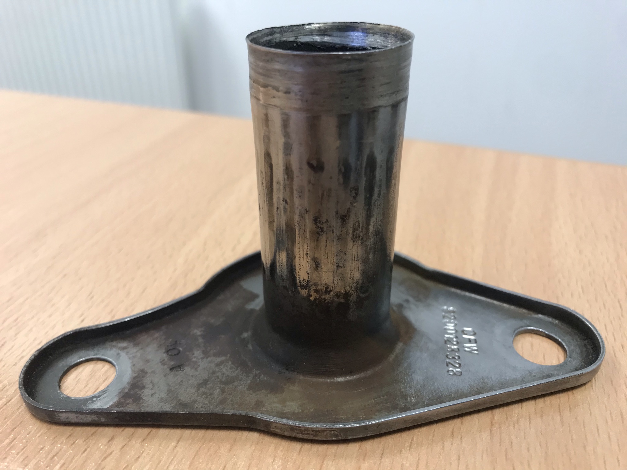

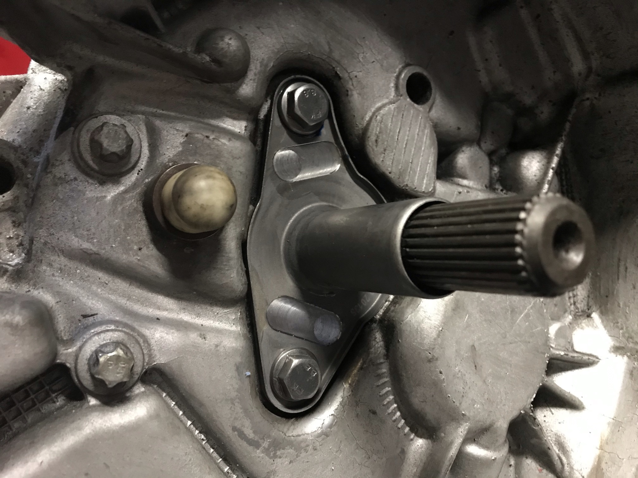

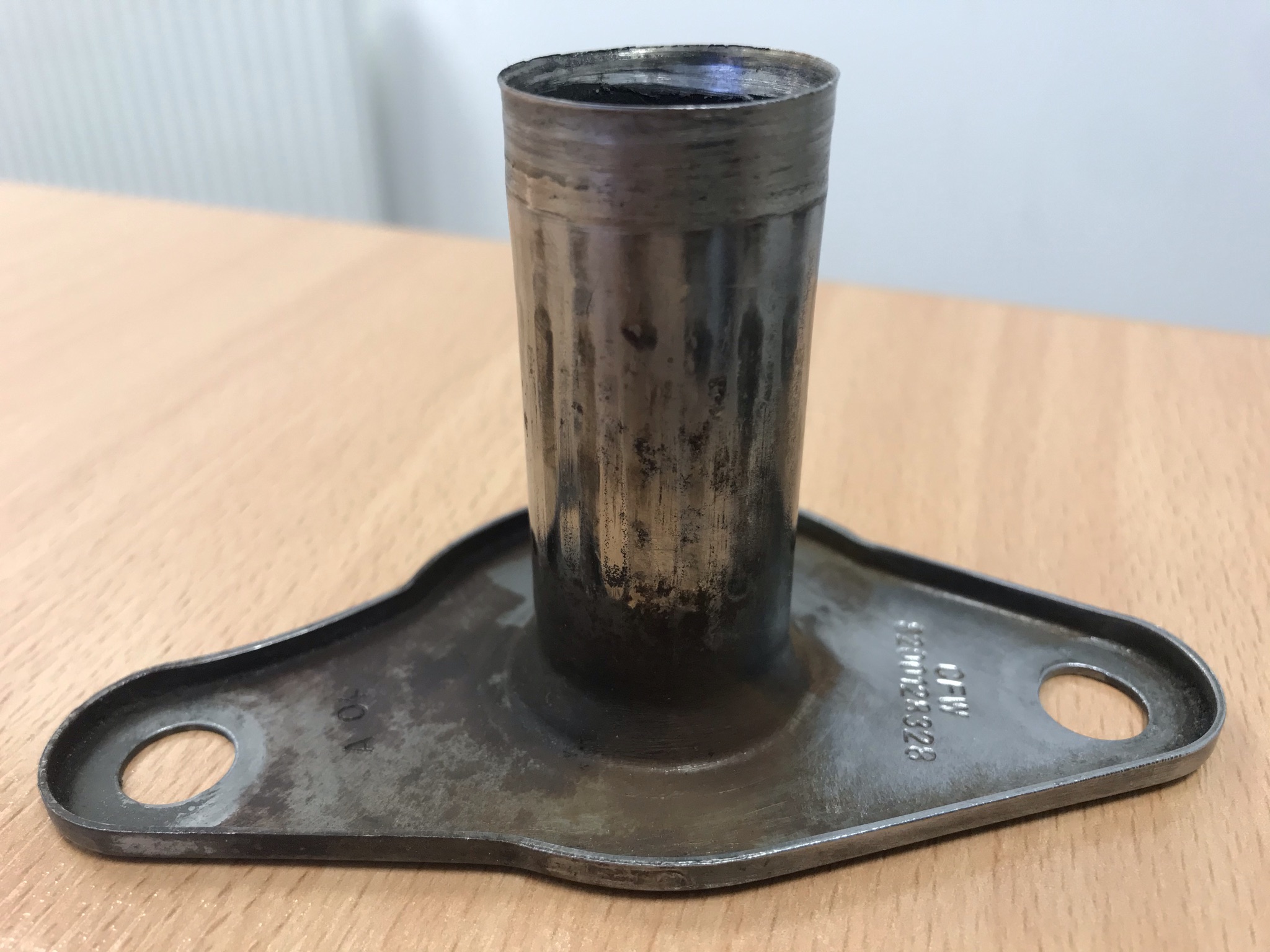

I would’ve thought the opposite would happen. I.E when the clutch is pressed in, the noise goes away as everything is under load.
With that age and mileage on the original clutch, I’d bet it’s the bearing thrust guide.
When mine went it rattled when you pressed the clutch in, not when it was disengaged.
Worn guide
New guide
Worn guide
New guide
Could well be.
Either way it's a clutch job 😅
