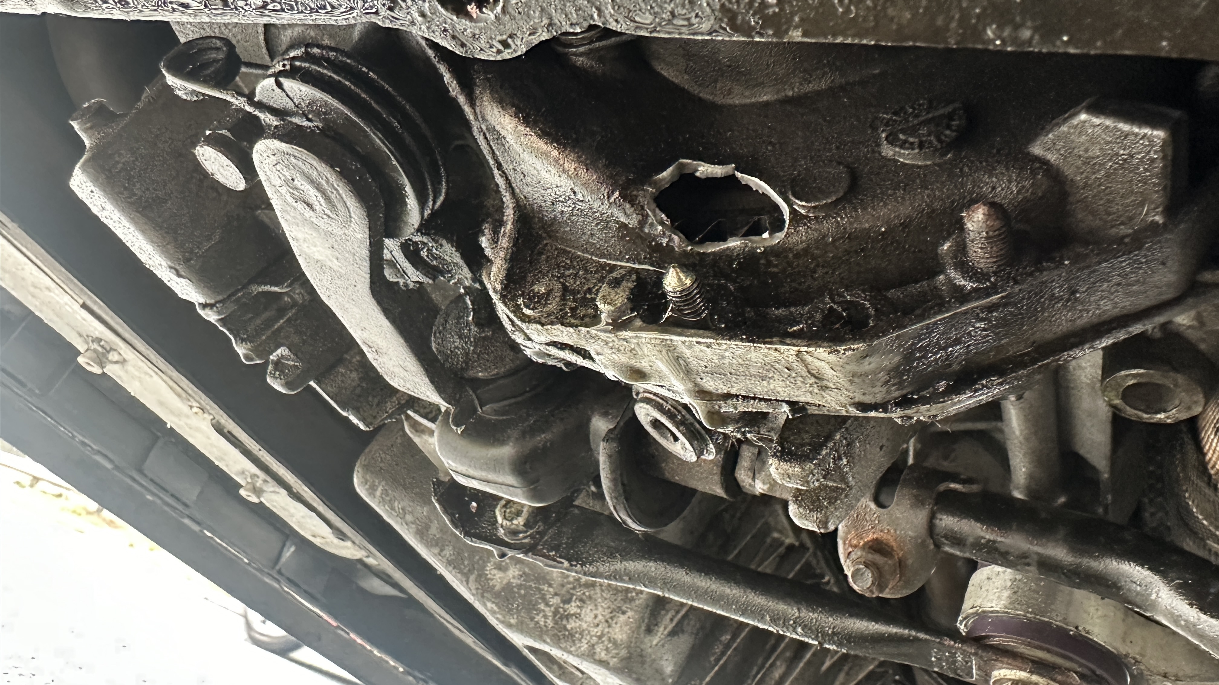

Get under and see where it’s coming from and post a pic.

Tried looking underneath and from the top but I can’t see anything without lifting it. The oil is all over the bottom of the gearbox.

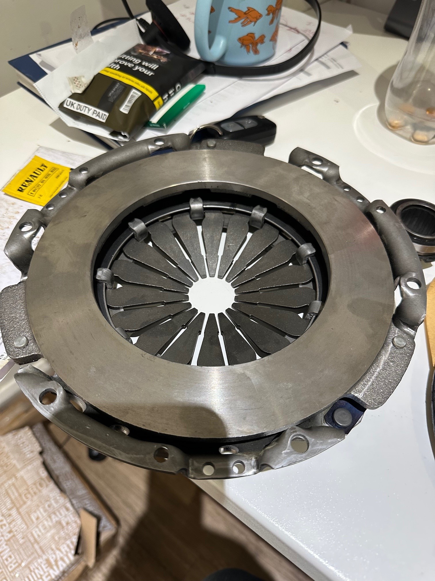

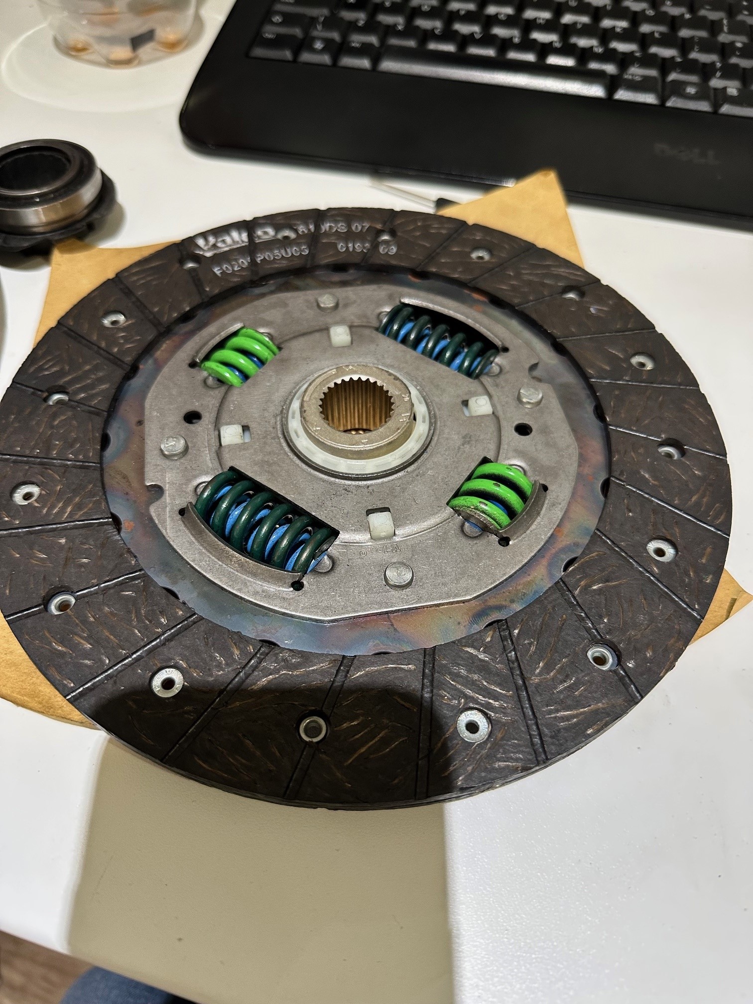

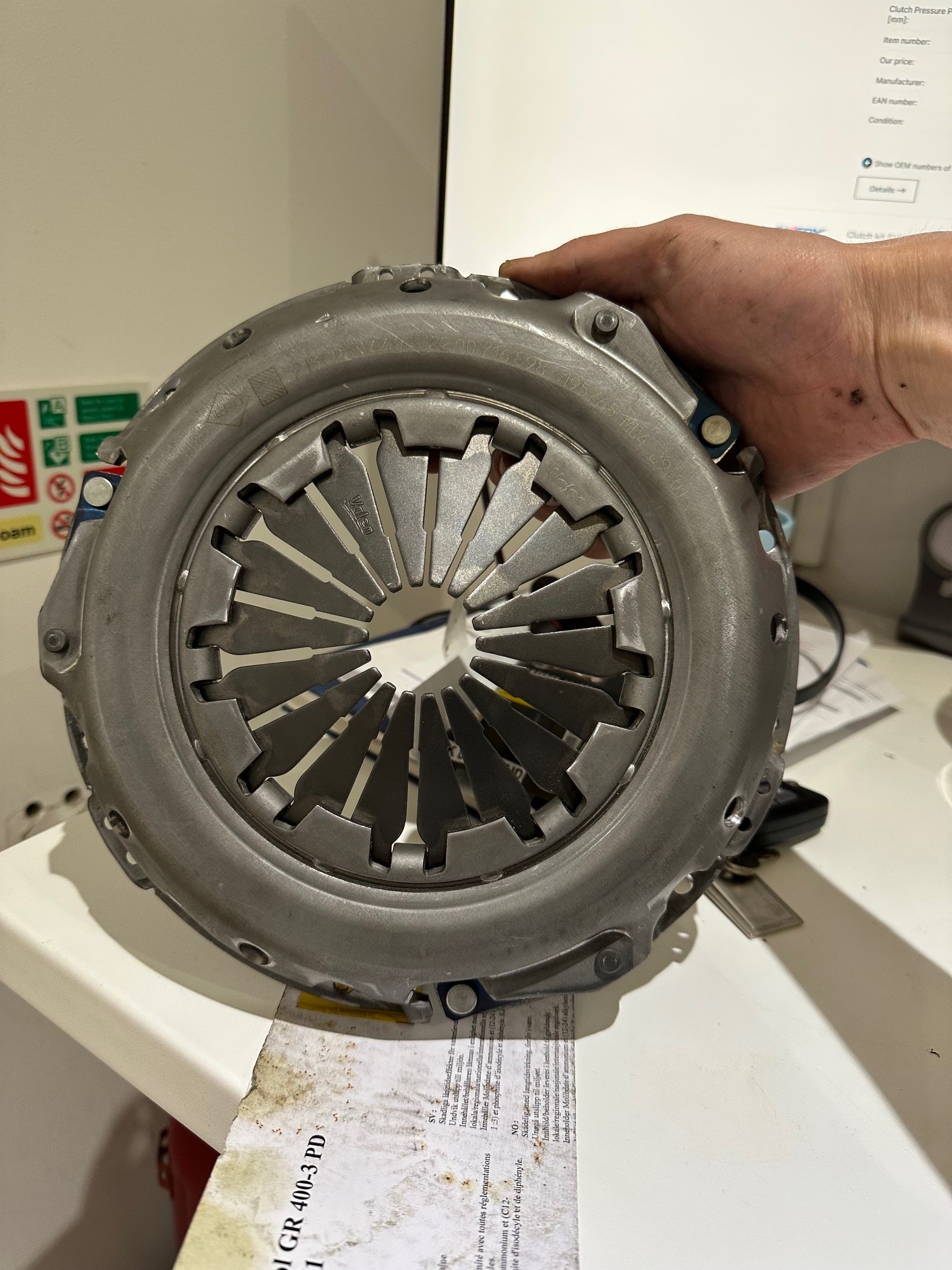

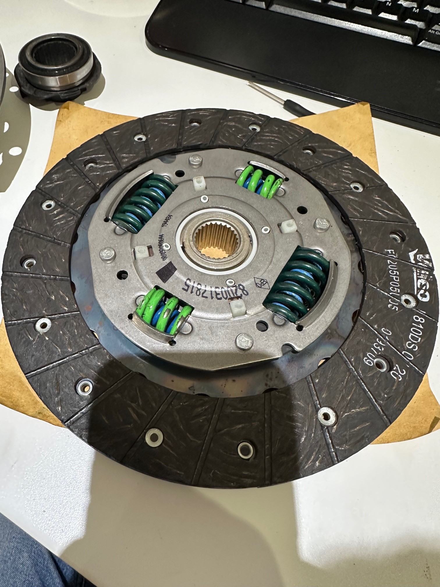

Just been looking at the genuine Renault clutch that I have and noticed something a bit strange - the part number that I have 7701478115 listed the Clio 182 from the place I got it from, but upon further inspection the commonly stated part number is 7701476557!
When studying photos the 2 kits look almost completely identical, I can only spot a small rivet in one of the bolt holes missing in this kit, but I am assuming something must be different with the pressure plate strength?
Looks like 7701476557 / 7701478115 got amalgamated into the one for the aftermarket as the part numbers are interchangeable when looking. Perhaps that is why the aftermarket Valeo / Luk clutches are of lesser quality?
After what has happened above I really don't want to screw around this time, can anyone confirm if this clutch kit is indeed different?
Many thanks...
Many thanks...
7701476557 was listed as a clutch kit, which included the plate and cover.
8220317815 was just for the plate and sold separately from the cover - 8200417854
7701478115 was also part of a kit but isn’t listed for a 182, but several parts websites seem to think it’s fits a 182. Probably ties in with your theory.
7701476557 was the correct one for my 2005 182 FF CB22.
Many thanks...

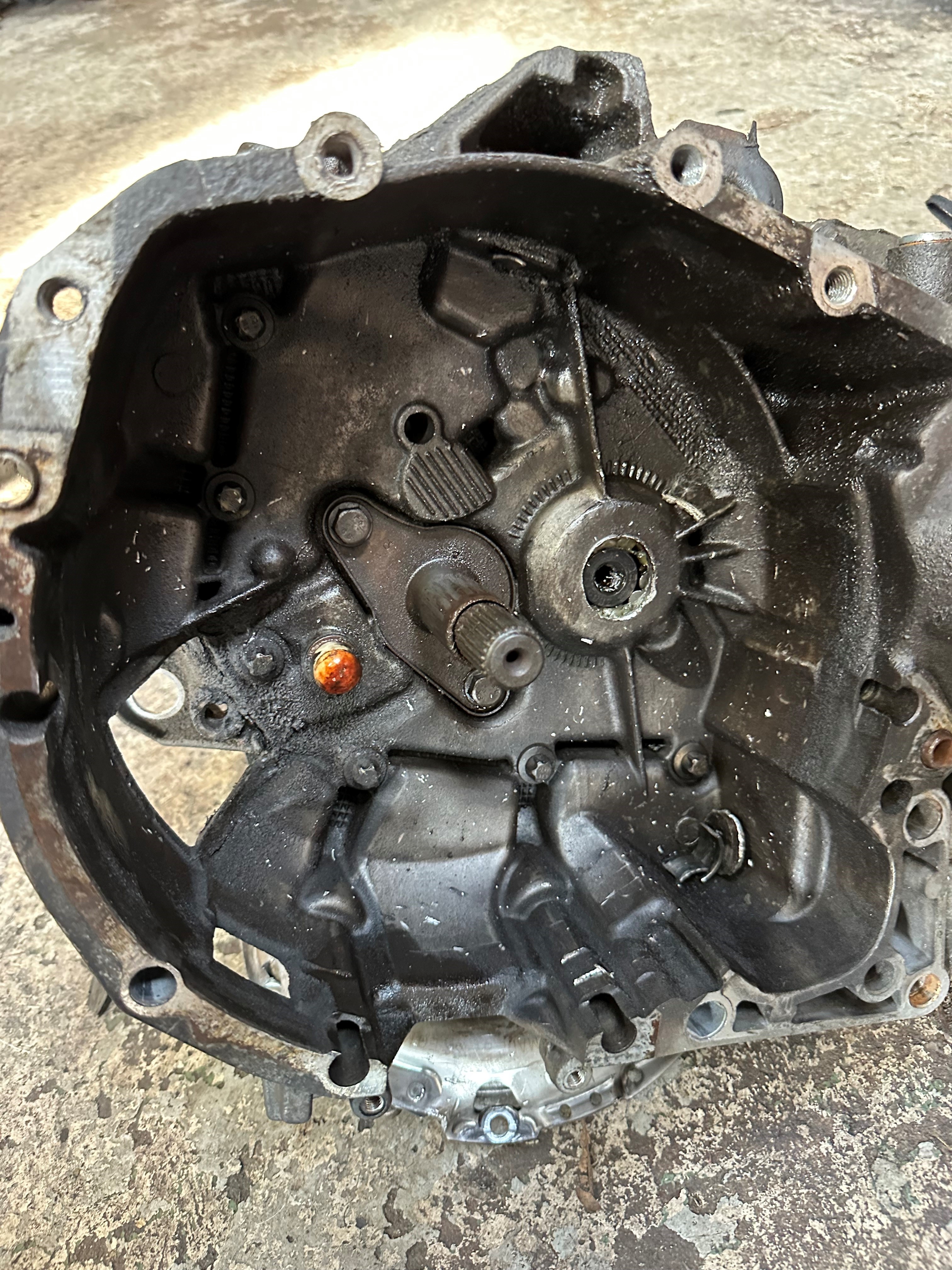

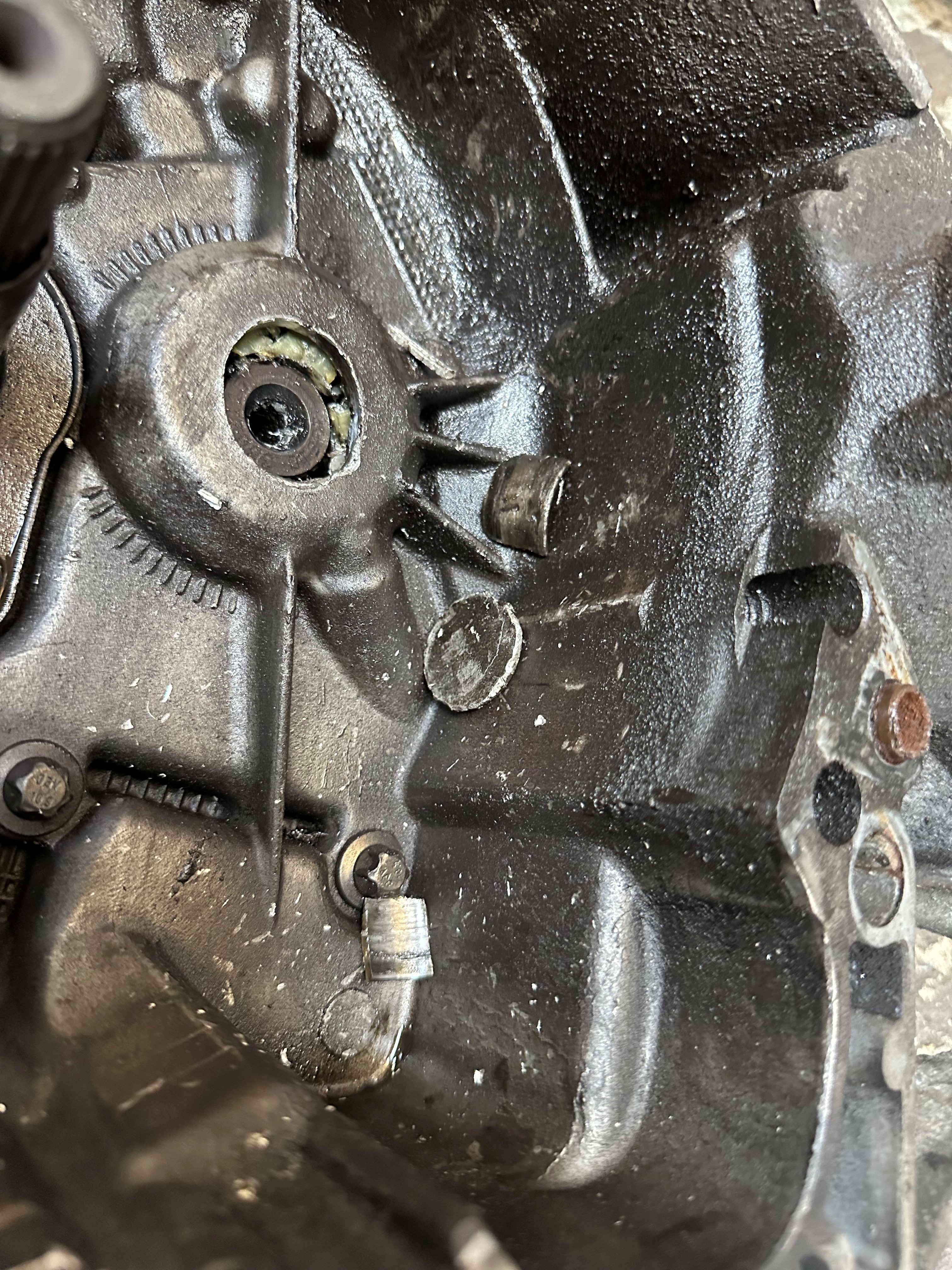

Clio finally back on the road with rebuilt gearbox and genuine Renault clutch kit. Thanks to all involved...
For anyone interested in what happened. Please see pics below:

That bearing is the mainshaft bearing. THE single most common failure point I see on the jc5 pretty much.
Age and oil degradation will be the main reason. But make no mistake, you will be able to hear that bearing when it’s failing.
Ohhhh yes.
Thinking about it, mine had started to make a bit of noise for a good while. Then when it was just about to give up it was unbelievably loud. Then bang. Probably should have stopped instead of sending it to see if it would go away 🤣
