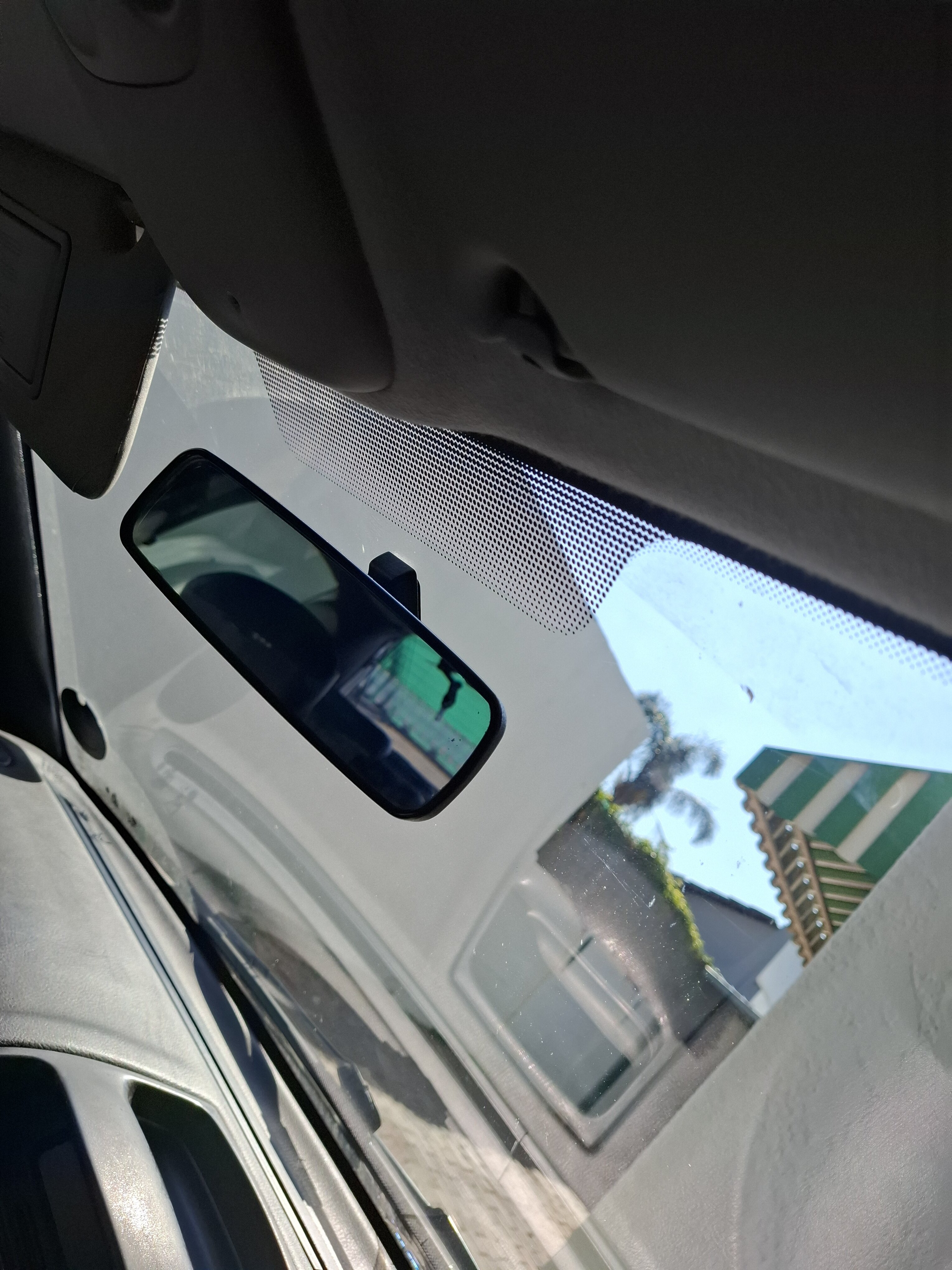

Well, it looks like I don't have auto lights or wipers! How is that even possible? My 182 has the Cup suspension (I know because I had to install the 84mm wheel bearings myself, it has climate control, half leather seats and cruise control.
My windscreen isn't original, so I'm guessing previous owner must've had it replaced and maybe the whoever replaced it got the wrong windscreen and decided to leave the rain/light sensor module out☹️

You defo have the sensor for auto lights etc?
Just edited my reply, this windscreen is probably not for my model, there's no rain sensor module here despite the car definitely being a 182FF.
No light sensor either....
I know based on the half leather seats that this isn't a 182 Cup, it's 182 with both Cup packs, so was it even possible to spec a 182 with a trip computer, climate control, cruise control, cup suspension, spoiler and rims but no auto lights/wipers?

Has the screen been replaced at any point that you know of?
My old 182 CUP track car had the bonnet put through the screen, and Autoglass couldn't get me a factory replacement.
Well given the brand is 'Shatterprufe' I assume it's a replacement windscreen, because I remember my old 1.4 having a Renault branded windscreen. I wonder then if the wires for the sensors are still present and if I get another module will it work again🤔 ah well, it's not that important so I probably won't bother going to those lengths unless I find a scrapped one.
Again I can only guess, but the bonnet and front bumper are both littered with stone chips, but the windscreen looks unmarked, so it's likely a recently installed one too.
