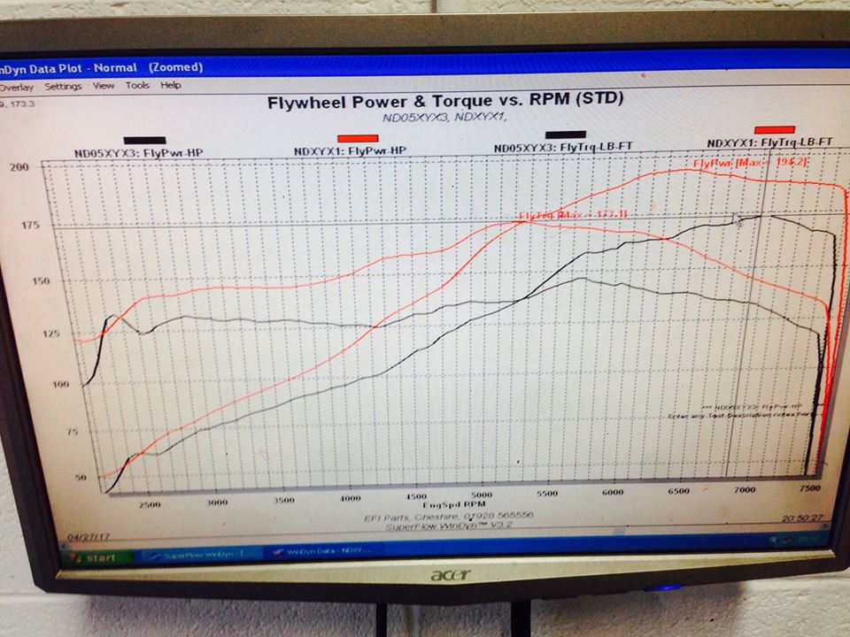

  dan's cast offs.
three different cars on the same graph.
the red one with the torque of a honda is a 182 with 197 pistons, rods, head, cams and inlets.
the black is a 182 with 197 pistons, 197 cams, 182 head and 182 inlets.
the blue one is a standard 182 with group n timing (wasn't meant to be on there but look at that torque!!!!!)
Right, because of the CR when having 197 pistons on 172 head is like high comp pistons...around 12.2:1

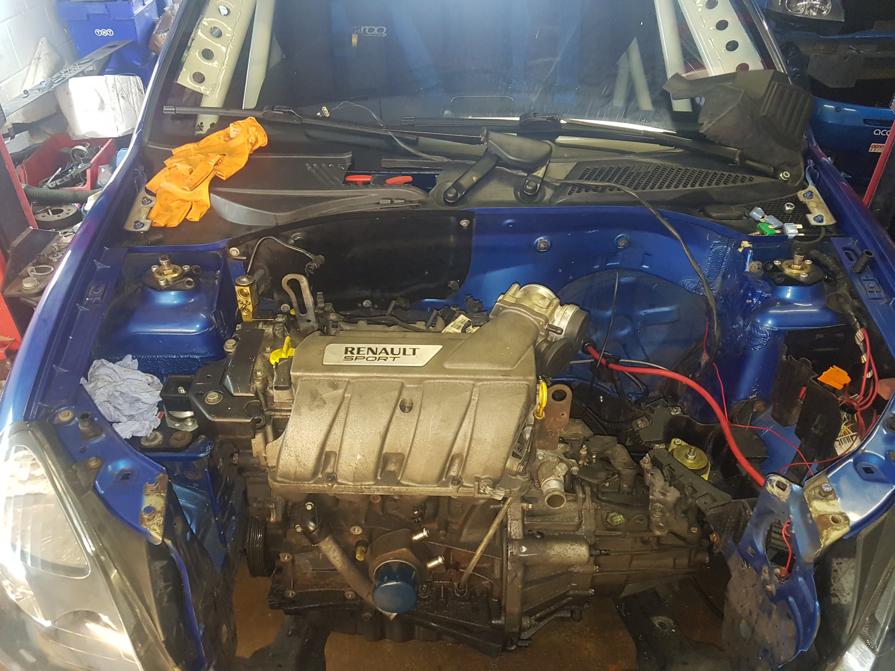

Hi Again Guys and Happy New Year
Well, my Frankenstein clio 182 with 203 engine is finished.
I made another post, but also I want to put here the data.
Data:
All parts F4R832 engine into block F4R736.
Modified F4R736 block for pulley tensor.
182 parts used;
Dephaser, flywheel, clutch, OEM exhaust system complete, included CAT and OEM silencer and reprogrammed ECU.
Ported head with OEM valves.
95 Ron fuel.
I hope this can help.
If some people want info, the engine was made by vgkracing.
I want to thank all the people with their advice and experiences have contributed to it and which I have been able to convey to the tuner of this engine.
Comment that we did two tests one on the 10th and another today with different cams and the ones that worked best are the OEM.
Thanks and all the best
Vicente

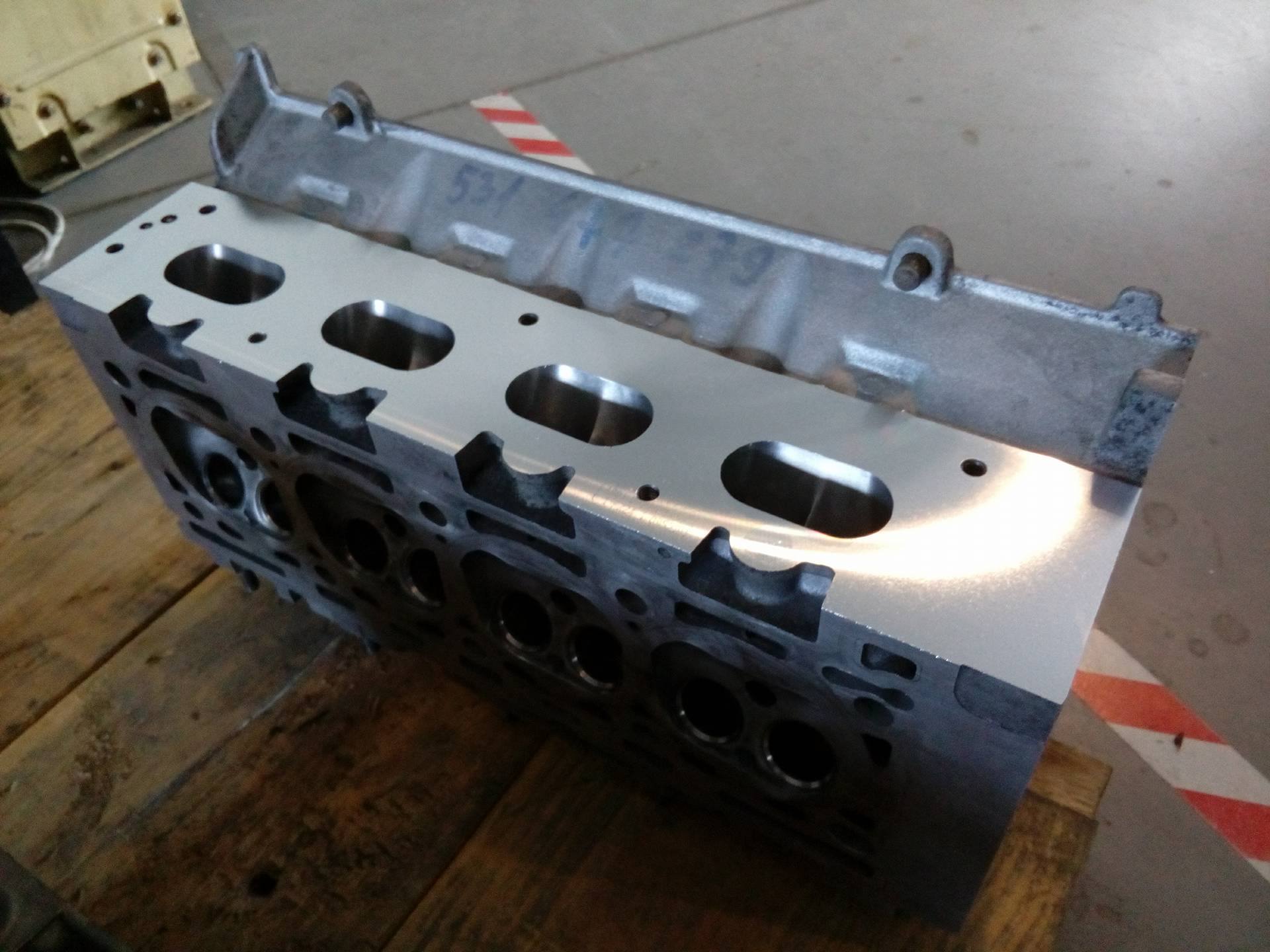

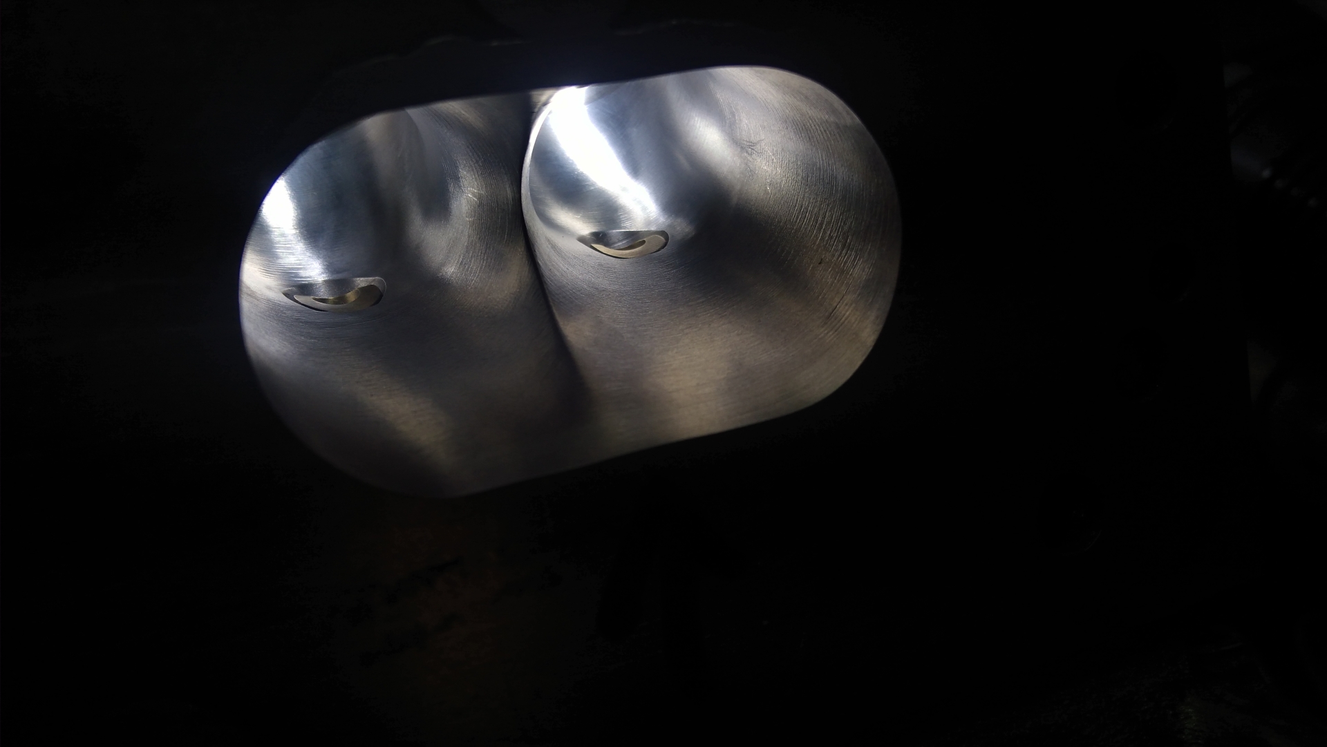

  Clio Sport 2 172
One of engines with my cylinder head setup for RS197 intake manifold.
Engine setup:
- RS172 cylinder head after full porting, with intake port with new design for RS197 intake
- RS197 piston, forged conrods
- RS197 cams with individual degree setup (second dyno run 220km@222Nm)
- RS182 exhaust manifold, 2,5" exhaust with decat
