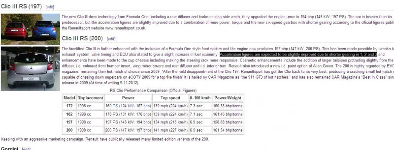

As the prices of 200's seem to be dropping a little recently, I was just wondering if other than the visual things there is much difference between the 197 and 200. I think I read somewhere the 200 has more mid range punch? Not sure though

200 has slightly more torque mid range, suspose to slightly better on mpg too, the 200 cup/pack suspension is stiffer than 197 cup/pack but the 200FF suspension is softer the 197FF.

200 was given a quicker steering rack, the cup and cup packed (ff) cars were given stiffer springs and dampers and there was a map for slightly more low down torque.
Apart from that (and the ugly front end) they're the same.

You forgot the gearing is shorter and more aggressive in the 200. And Knuckles the flat spot definitely isn't as bad.
