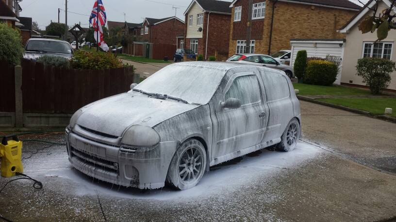

1st things 1st i started off with a snowfoam with Autobrite magifoam and Autobrite snow lance
Once rinsed off i then shampooed it with Autobrite Purple Velvet and dried it with a uber blue towel

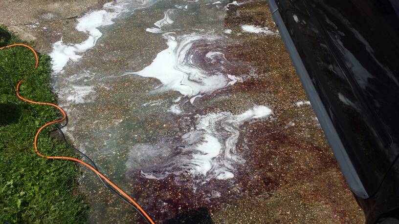

Then next i started the decontamination with Juicy details bleeding iron & auto finesse oblitarate and megs claybar

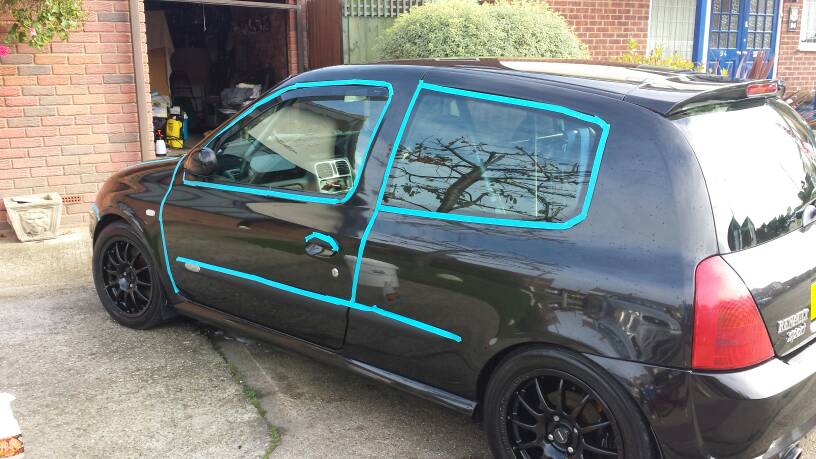

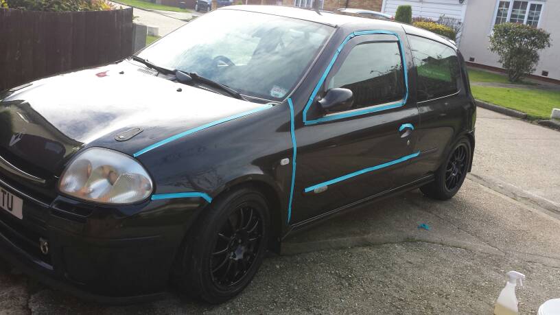

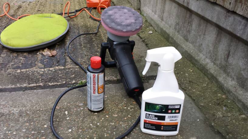

1st things 1st on day 2 was to get her masked up ready for a heavy machine polish with my DA used with menzerna IP 2100 and lake country pink pad

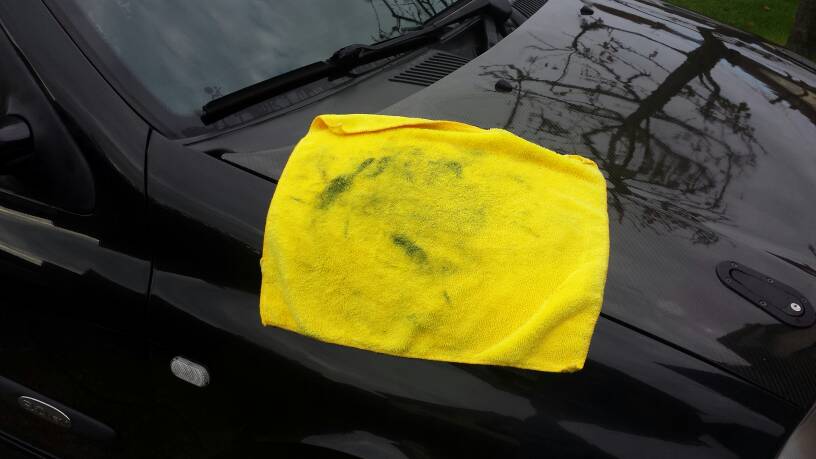

Swirls were rather bad
So i cracked on with the machine polishing and straight away you could notice the difference as the paint was looking very flat. At this point i havent even glazed it

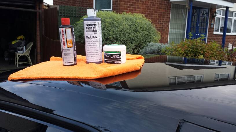

Then i cracked on with the roof

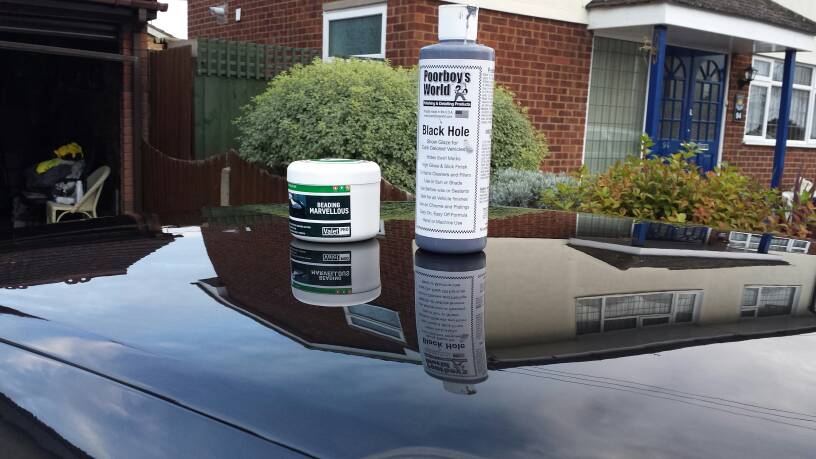

Then glazed with poorboys blackhole and waxed with valet pro beading marvellous

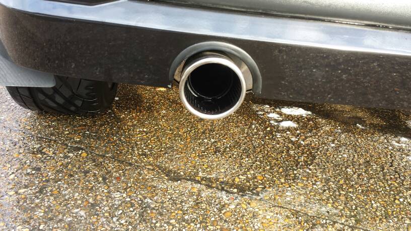

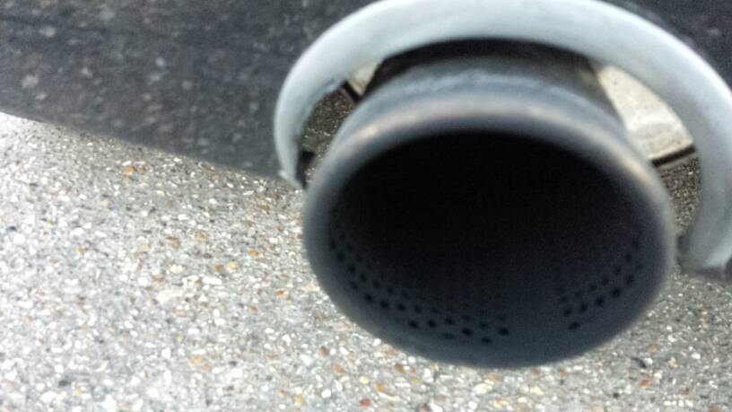

Then i got to work on the trims and exhaust before finishing off

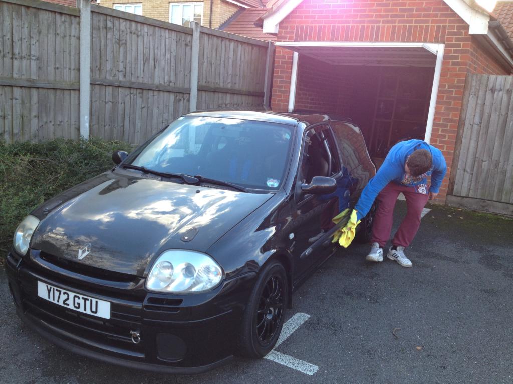

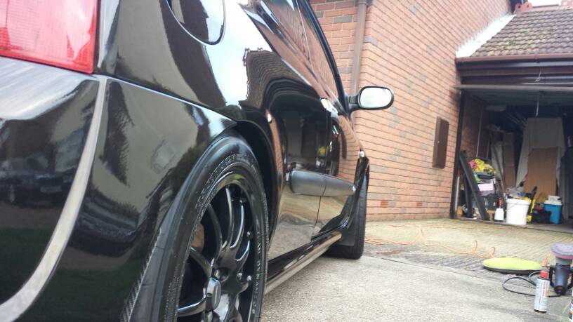

So im pretty much there now. So i finished the rest of the car with PB BH and VP beading marvellous and heres a few shots on how she looks
Then i finished up with cleaning the windows and then sealing with angelwax H2go
Im pretty pleased in how shes come out. Im sure rob will be very happy with it when he sees it. It really is an epic car and now its a very clean glossy car
