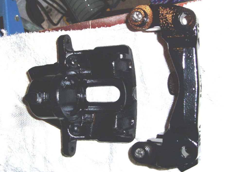

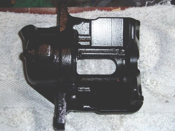

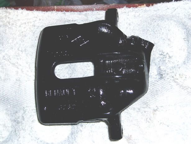

You should have used these wire brushes in a drill , a piece of p*ss , only takes minutes not hours . I have a spare set of calipers so it was easier cos i could do em off the car . I opted for black hammerite smooth in the end .

Miles easier off the car . Also stripped the calipers down , took the pistons out and greased inside the caliper cos my 172 failed its MOT on brake imbalance ,ASSH*LES at NATIONWIDE AUTOCENTRE . The insides of the piston will start to rust over time so i used Rust Remedy and sprayed em up with Zinc cold galvanising spray to stop em rusting again .The main reason i painted the calipers was more to stop em getting brake dust and sh*t baked on and going rusty but also they look better.
