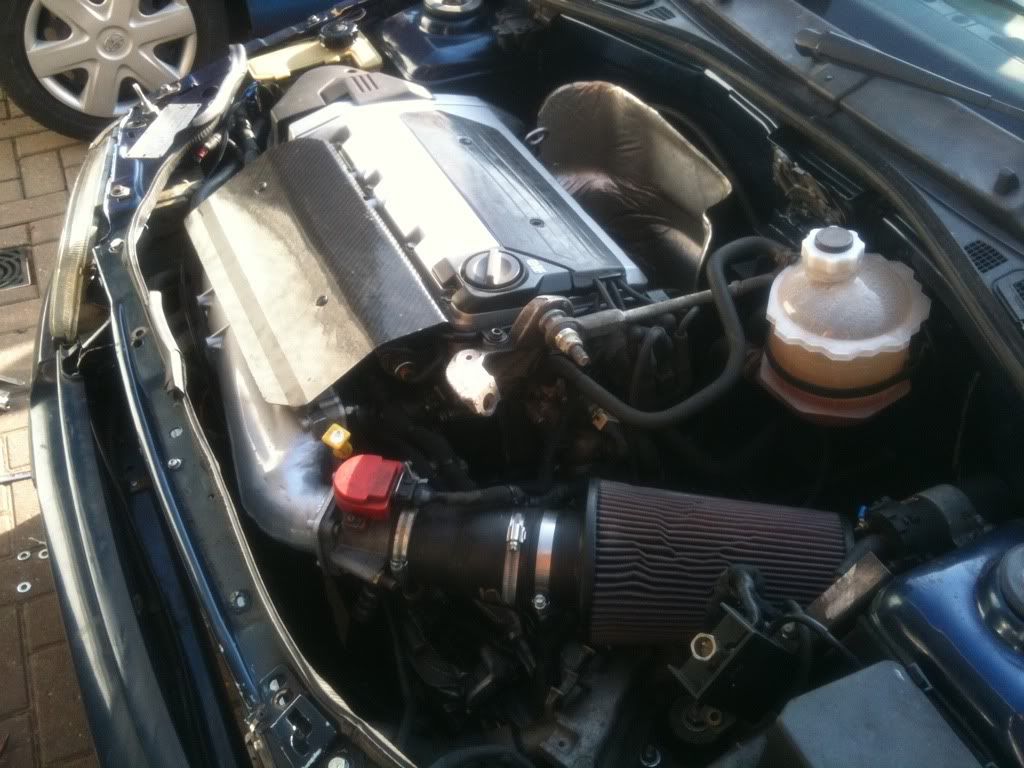

They don't fit on a 172 head no. for reference this is how it fits in the engine bay. Plenty of room.
  Clio 16v 'YOJ'
Thanks for the pic :) do you know if it sticks out further than the fuep rail guard as thats a few mm off the back of my radiator - its all in a mk1 shell and the rad is alot closer to the engine than in a mk2

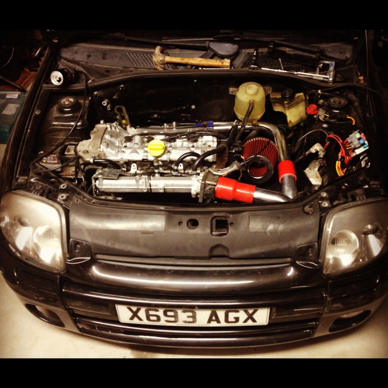

I might be able to lend you my pulsar setup for the F4R possibly (if I swap the manifolds over I mean), not sure how well it would work compared to say an RS2, but it would definately fit.
Depends if i decide to bodies the F7R in mine for a bit or not, still toying with the idea as they are just say there and they will give more power marginally and im on aftermarket anyway so it will not mean any other changes.

It uses an ITB manifold for an F7R head.
I have a set of F4R bodies
I am thinking of putting the F4R bodies onto the F7R engine, so would end up with a spare F4R ITB manifold and a plenum designed to work with an ITB manifold, so yes it would fit, the worst that would be required would be making a new backing plate (not hard, its only ally)

Not sure how the throttle would work with the ph1 172 management TBH, not tried, might be a case of adapting the sensor to fit the cosworth throttle body.

Yes my inlet if you look is pointing right where a group A scuttle kit would want it to be, but Ive decided not to cut my shell for one as its going honda powered at some point anyway!

What does the plenum cover have to do with intake length though? Ive got more intake length on m pulsar plenum setup than I have on my RS2 car in fact.
Its ONLY the cover that has been used from a pulsar, and its spaced out from the backing plate (spaced even more now than in those pics too as Ive added another 20mm spacer since and also gone for longer trumpets inside it).
And if you wanted to you could easily run it even longer but putting extensions between the manifold and backplate, you are limited on length only by running out of space at the front of the car.
