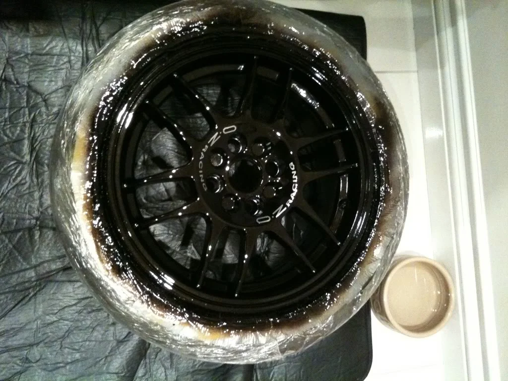

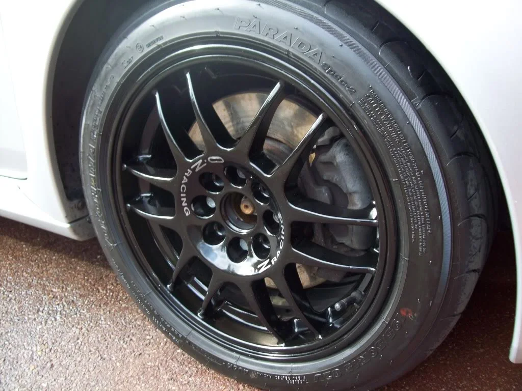

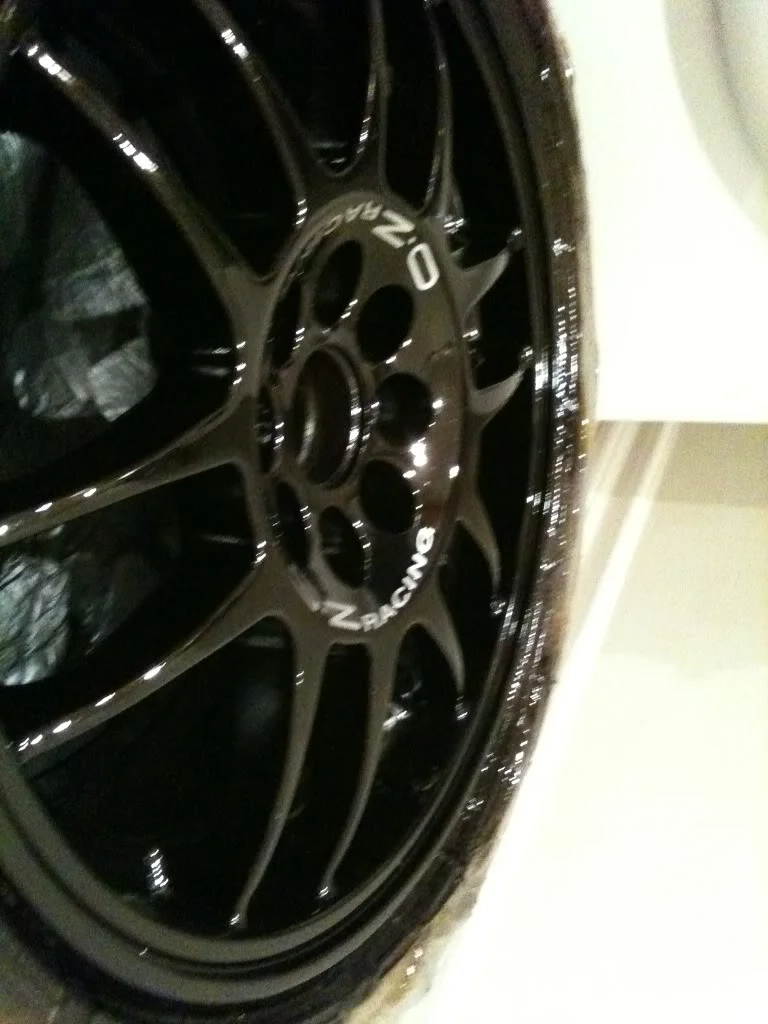

This is what i used on my wheels mate. Same stuff as Chris has posted up there^^^.
Difference is night and day from halfords lacquer. It goes on so well and is really hard to mess up tbh. One coat and it comes out great. One can does about 3 wheels (2 coats on each). Or two coats on mirror covers, bump strips, rear wiper blank and centre caps.
^ Very nice finish, Anyone got any cheaper links for the 2K?
