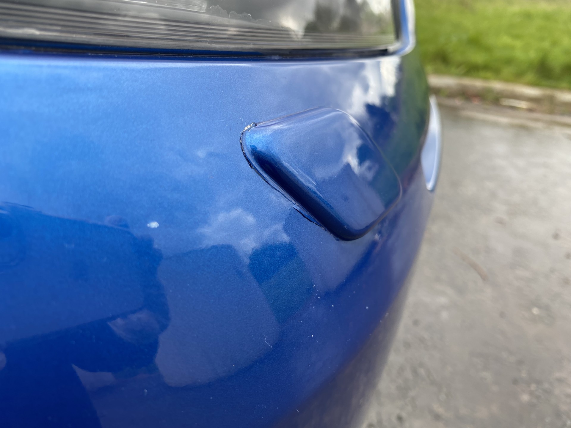

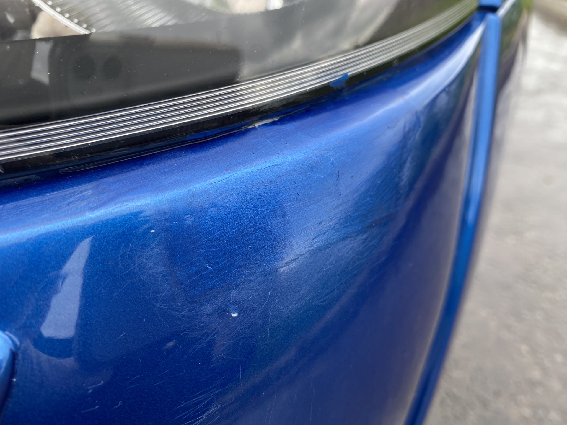

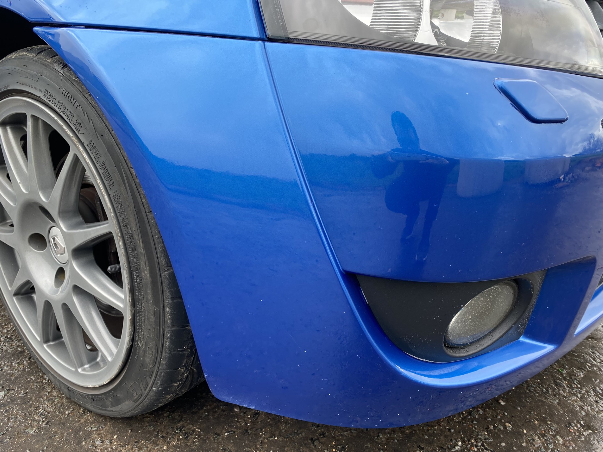

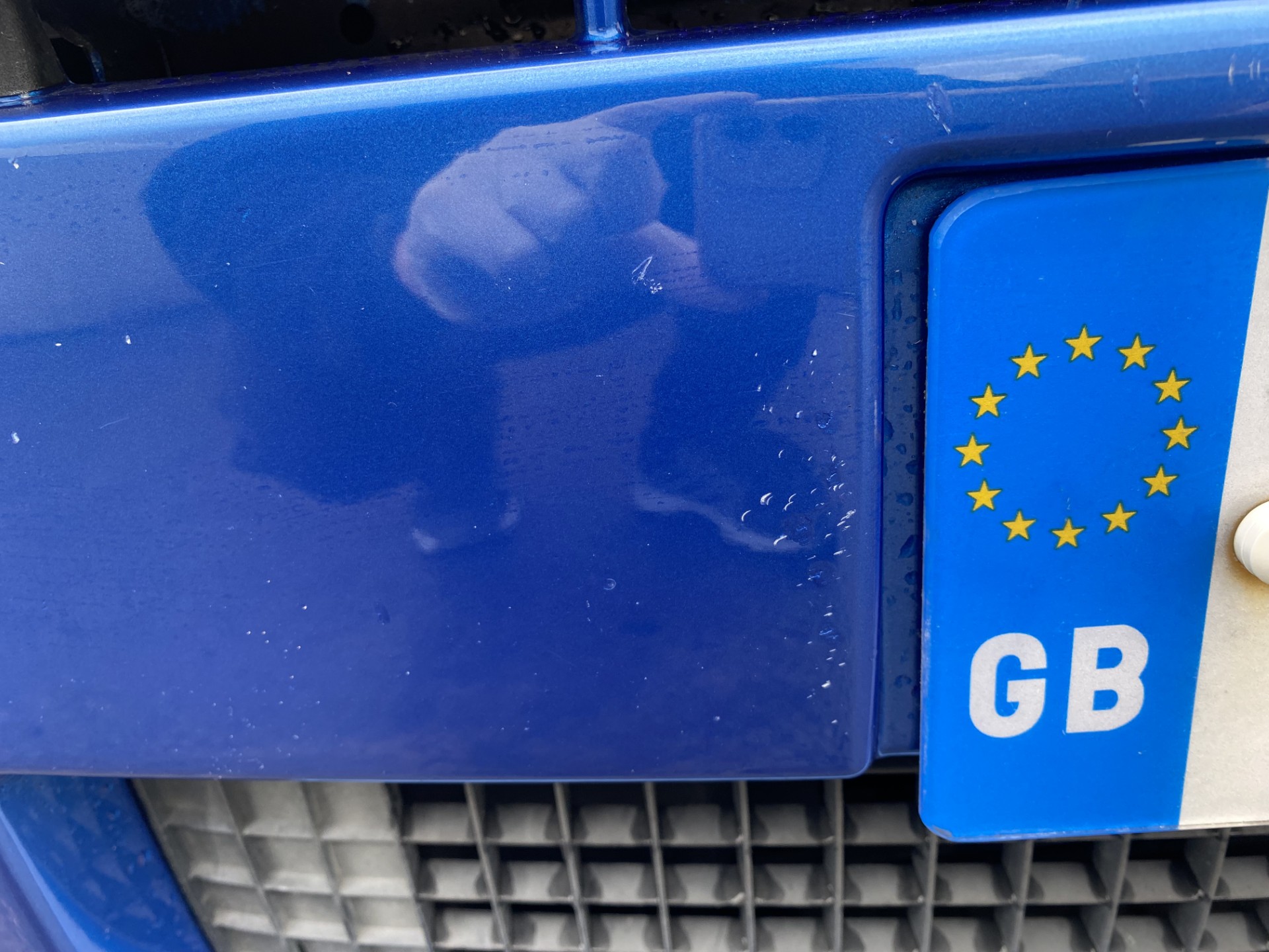

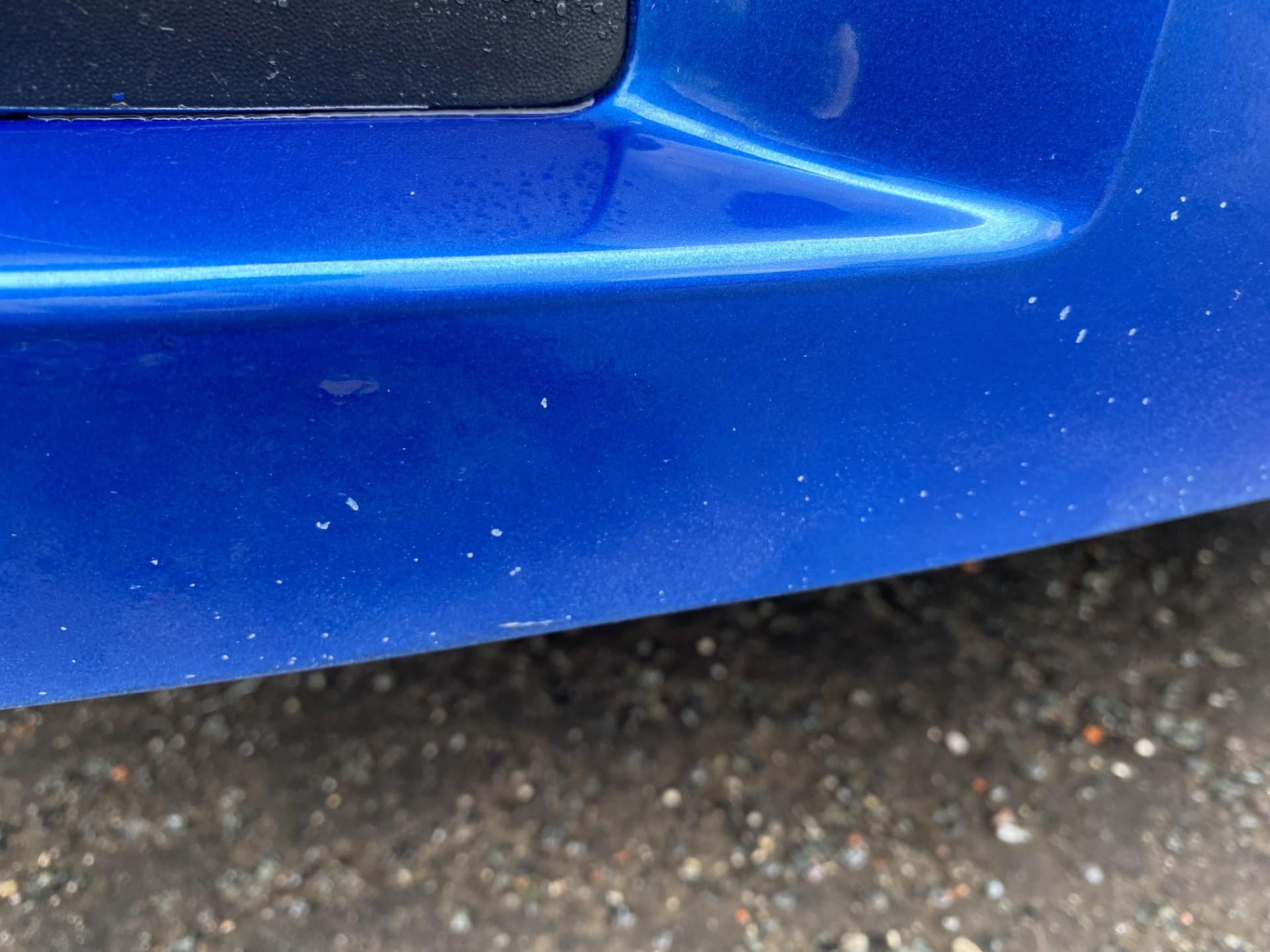

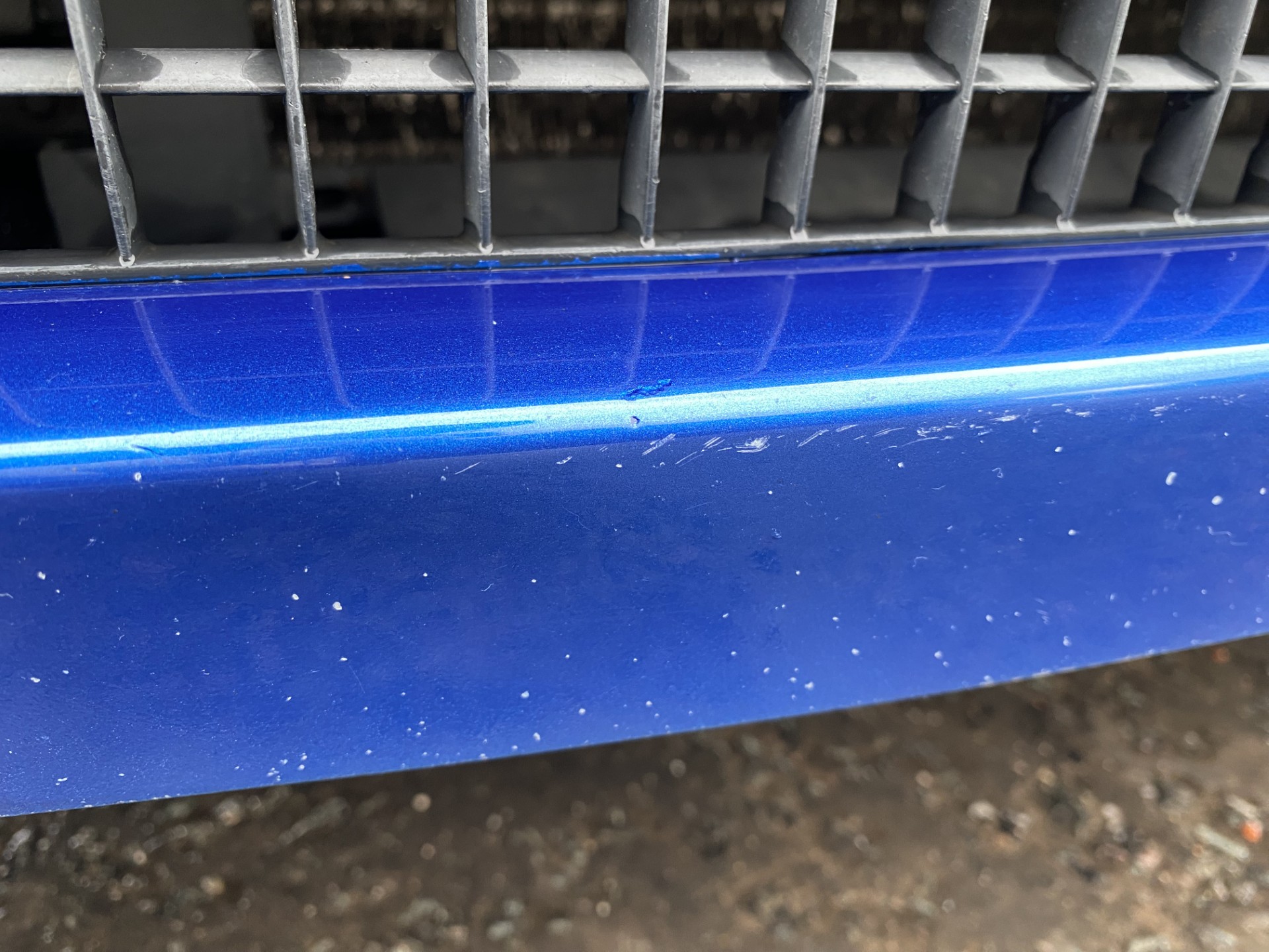

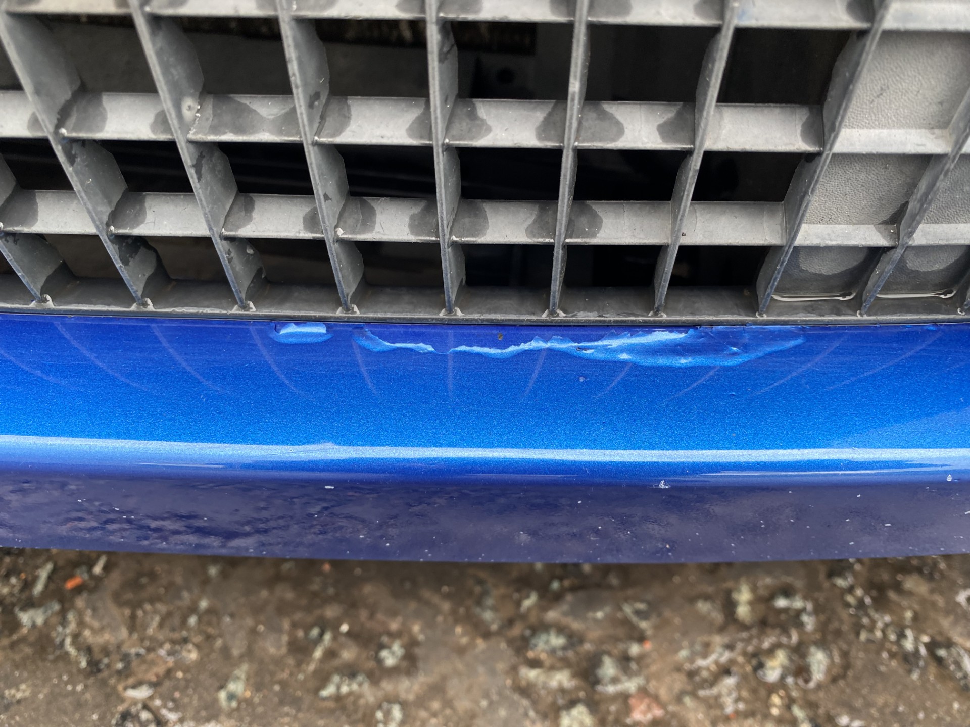

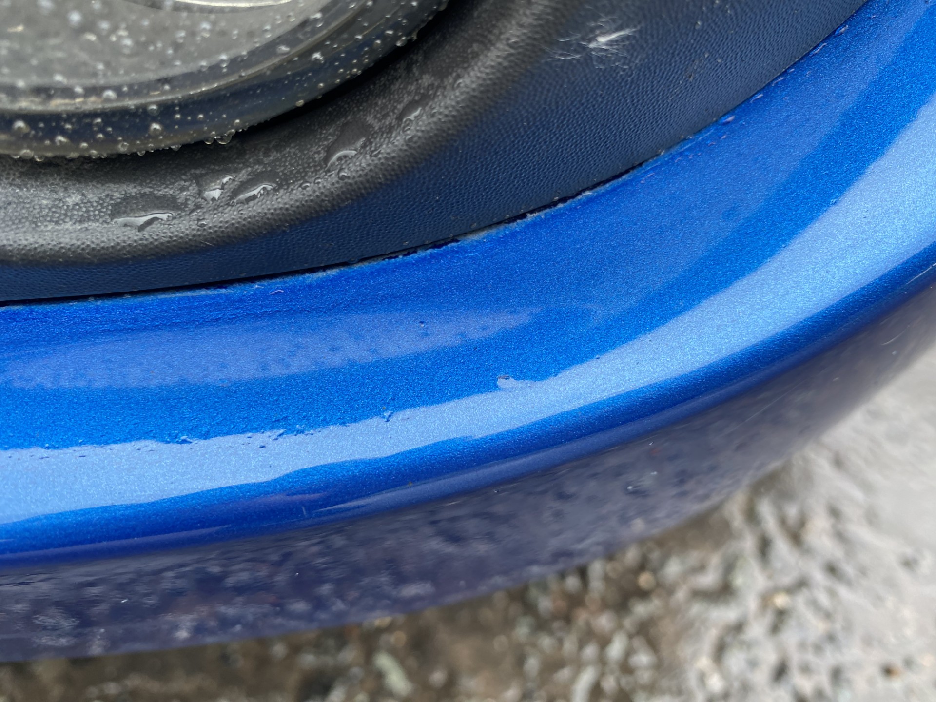

I had a real close look at my bumper today and got a few photos. It's clearly been painted in the past and the worst part is under the N/S headlight which is cracked again after a crap repair. I actually noticed some overspray on the rear seat upright (I kid you not!) which suggests to me that someone was in a rush to put some paint on this car or bought some bits from someone who doesn't know how and where to paint!
There are obviously too many individual chips and marks to touch up each and every one so it definitely needs a full respray. This has got body shop written all over it!
thumbnail_IMG_3288.jpgthumbnail_IMG_3289.jpgthumbnail_IMG_3290.jpgthumbnail_IMG_3291.jpgthumbnail_IMG_3292.jpgthumbnail_IMG_3293.jpgthumbnail_IMG_3294.jpgthumbnail_IMG_3295.jpg
Flob
PS - to add, that would be a proper nightmare to prep properly mate. I have hobo painted a lot of stuff and I genuinely wouldn't want to be doing that. Because they have done no prep you would need to remove all they shite paint/clear which would be a real pain even with a da.
If it were me I would just shelve this idea and keep an eye on ebay for a front bumper in the right colour. The risk is that a cheap body shop wouldn't remove all the old fucked paint and would just do minimal prep, which would look good for a year or so then fail again.
