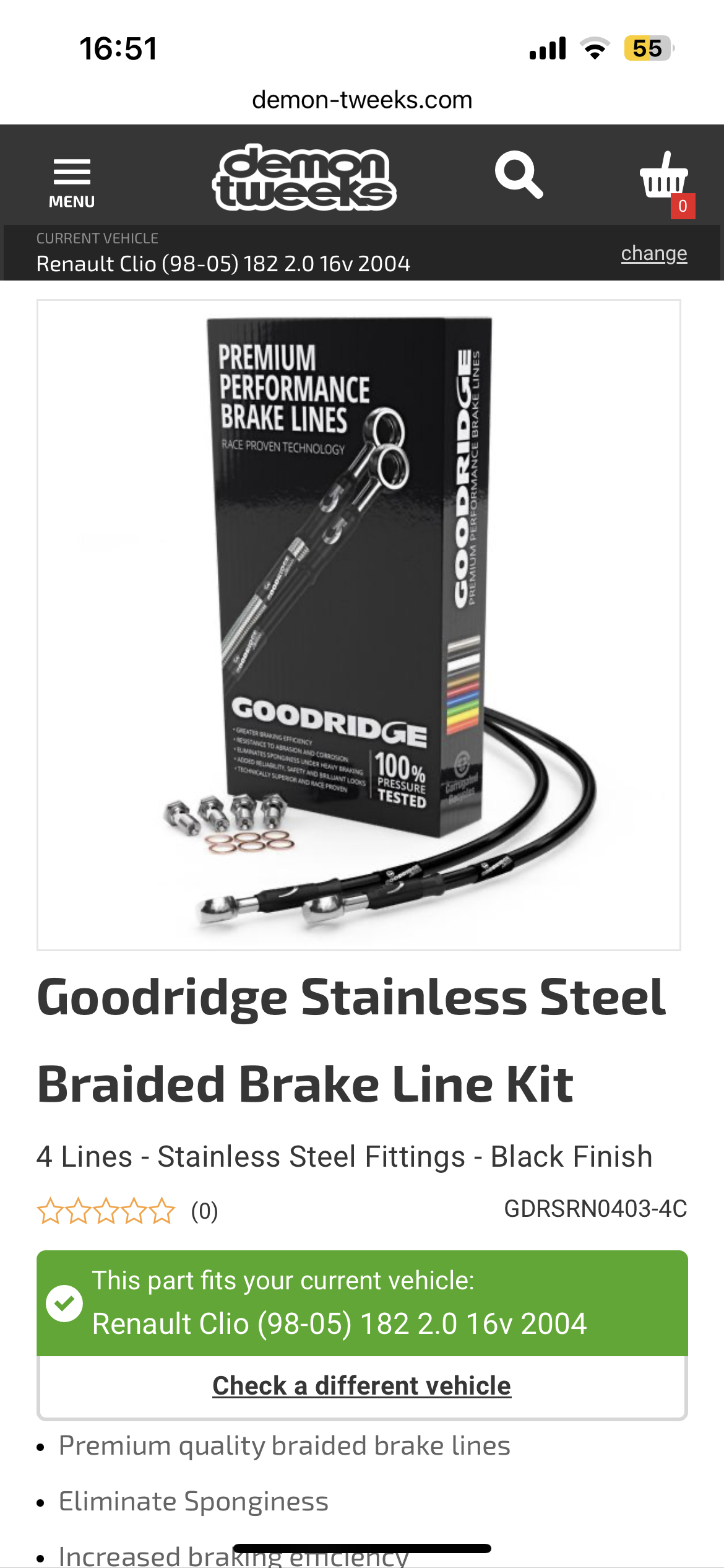

Hi there what braided brake lines are people using on the clio 182 with 4 pot callipers I have found the ones pictured below but not sure if they are compatible
Many thanks
