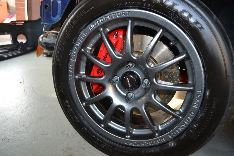

I've got AP 4pots under my 15" pro race 1.2, with 300mm rotors and alloy bells which also act as bit of a spacer. Got about 3mm clearance

If you want an equivalent braking effort from Wilwoods you need 300mm discs and more aggressive pads than you need with Brembos and 280mm discs. That made the choice for me quite an easy decision.

My HiSpec R114 kit with 300x32mm discs fits under OZ f1's and 2118's with no spacers and plenty of clearance. if you want something that will definitely go under with no messing that kit will. But bear in mind they are a race calliper with no dust seals.
Here is a pic of the Brembo's under 15" pro race wheels with standard 280mm discs.
