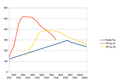

Oh rly.
Here is a graph against a Cosworth YB. Peruse it at your leisure. (When the YB line is above the Honda one, it's accelerating faster. The Honda can hold the same gear for longer, but it doesn't matter because the YB simply shifts gear and f***s it a second time.)
The honda dyno is essentially guesswork but we know it can't make over 297lbft and 500bhp so it's best case scenario given those figures.

The f**k sort of graph is that lol? What do you mean its accelerating faster? If the YB has for instance 400hp and 400lbft and the honda has 500hp and 300lbft the honda will be a f**k ton faster all other things being equal.

It’s Torque Vs RPM. Torque directly influences acceleration (f=ma).
The YB has 500bhp, the Honda has 500bhp.
The YB makes 500lbft, the honda makes 300lbft.
As you can see, honda gets fooked by the YB, easily. And the same with most other boosted engines. If you don’t understand the data being plotted you shouldn’t really be saying it’s wrong.

Gonna swerve that graph.
My Evo has about 300ft/lbs, and about 350bhp. Put this K in anything and I’d simply watch it walk away!

Well f**king obviously? What on earth point are you making lol? The car with more torque and same power is faster? No s**t...

The same point I've made since day 1.
It's cool in its own little bubble of 'this is a lot of power for a nasp 2.7 litre 4 banger', but in terms of 'this is a 500bhp engine' it's pretty slow. Most other 500bhp engines are turbo/supercharged and will happily make 4-500lbft and will eat this thing alive. It's probably more equivalent to RS3 performance (aside from car weight) than it is something with a 500bhp 1JZ, 2.2 4G63 or YB or EA888 etc etc etc etc etc etc.
You’re the one that first compared a 500bhp K20 with a 330D. Then drew yourself a pretty graph.
Simple.

It's not as simple as 'they both have 500bhp therefore they will both be just as fast'. Peak figures are mostly meaningless but they do give us some information. The most important 'number' you can get from any dyno graph is to measure the area of the space under the torque curve - An engine with more area under the graph will always outperform one which has less.
You are correct in that the Honda will be able to carry more speed in a lower gear (and therefore benefit from higher torque multiplication), but as you can see in the graph above, selecting a higher gear means that the torque curve essentially moves to the right (RPM x difference in gear ratio) and down (torque/difference in gear ratio). We can plot that on the graph as a second line for that car, which give us coverage of all the speed ranges available to the higher revving N/A car.
As you can see from the graph above, the advantage a boosted engine has over the naturally aspirated one is enough that it still outaccelerates the N/A one, even in a higher gear.

Regardless, arguing over a graph is pointless ?

  406 V6, Race Buggy
It's pretty easy, one is making 400bhp, one is making 500bhp, so for a given road speed, the 500bhp one must be making more torque at the wheels.
If they're both 500bhp peak then the graphs must converge/cross at some point.
So what your graph is showing, I don't know. But it's not torque x rpms and it's not wheel torque against road speed.
Of course, it's also going to be lighter and need a less beefy gearbox, clutch, etc, than a YB is for the same power.
And probably competes in an N/A race class, making it a moot point anyway.

Read the legend. Red and yellow are the same YB, the Blue is the honda.
The ‘400bhp’ (it’s Lbft, not bhp) is the same engine in the next higher gear, superimposed onto the same graph (see above for how to do it) as the YB must make an upshift to reach the same roadspeed that the Honda achieves at 11000rpm. Both engines make 500bhp.
It can be a bit confusing if you’ve not worked with these graphs before.
