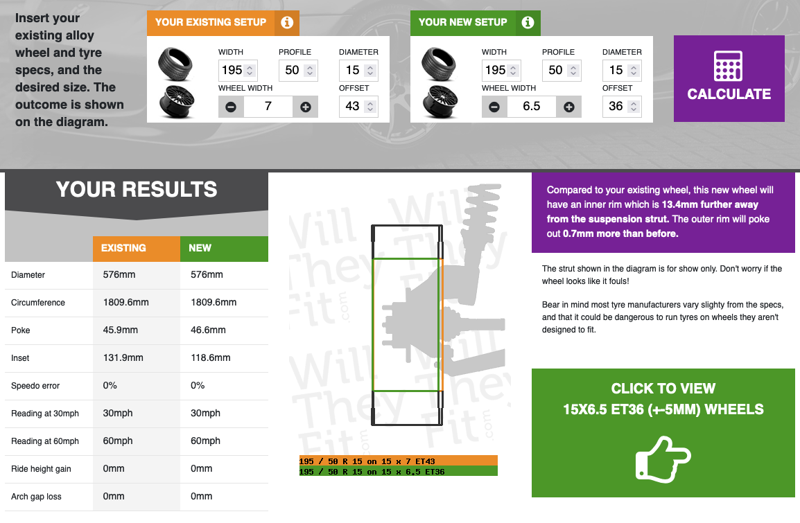

Seen a set of wheels that are local-ish I could be tempted by to use as track tyres for my Ph1 172, probably run a set of AR1's. They are off a Renault 19 and are 6.5J wide with tyres 195/50/R15.
Being slightly not as wide as the standard Oz F1's I currently have this wont be too much of a problem will it considering they are the same tyre size?
What is the offset?
ET36, I was more concerned with it not being wide enough kind of thing seeing as the standard wheel is a little wider. But if it runs the same tyre size then in my mind it shouldn't be an issue?
I've run 6.5 and 7 on my mx5 on the road, both with 195/50/15 tyres. Made little difference if any
