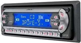

Wired in a 7" Roof screen 2 day. screen works perfect got picture gets power nice. lights up, i have a xbox wit 3 wires ( Yellow ) (Red) white) i connected the yellow up to the screen, ( xbox now is playing fine on the screen) i then connect up the red and white. to the cd player audio in but i cant hear nothing??? is there a setting i should look for on the cd player to select audio in...

Sony CDX-F5550 i looked every where on settings cant find nothing
i got there manaul on my pc as well and it dont seem to help
  Golf Mk3 Gti 8v
maybe it becomes an new option like, how to explain, on my kenwood if i have no cd in there thn i dnt have the cd option just stanby and if i press againi it goes to radio and back to standby, when i put a cd in then it lets me choose either cd radio or standy by dunno ho alpine work maybe it is the same maybe it ain, try the manule lol

that what i was thinking that the option might only show up if the wires are working and s**t. maybe there not :( im going try hooking it up to a DVD house player to day see wat happends

Has it actually got audio in? I've just looked up the specifications on a couple of sites and I can't see it listed.. it's got 2 pre-outs..

well on the back it has to rca plugs for BUS AUDIO INPUT is this right?

Get a RF modulator. I have one for sale if you want it. It uses the aerial to input the audio through the stereo.

the BUS part might be a downfall
as this may be the audio input from a cd changer and not part of the control plug

YES i read some wher eit was for CD / MD changer?? so it wont work for my thing ?

not likely
you'd need to fool the hu into thinking you had a changer
o umm do you think this "RF modulator" will help my problem then mate ?? thanks for ur help man

an rf modulator is something that turns audio signals to FM so it can be picked up by the radio part of the hu
