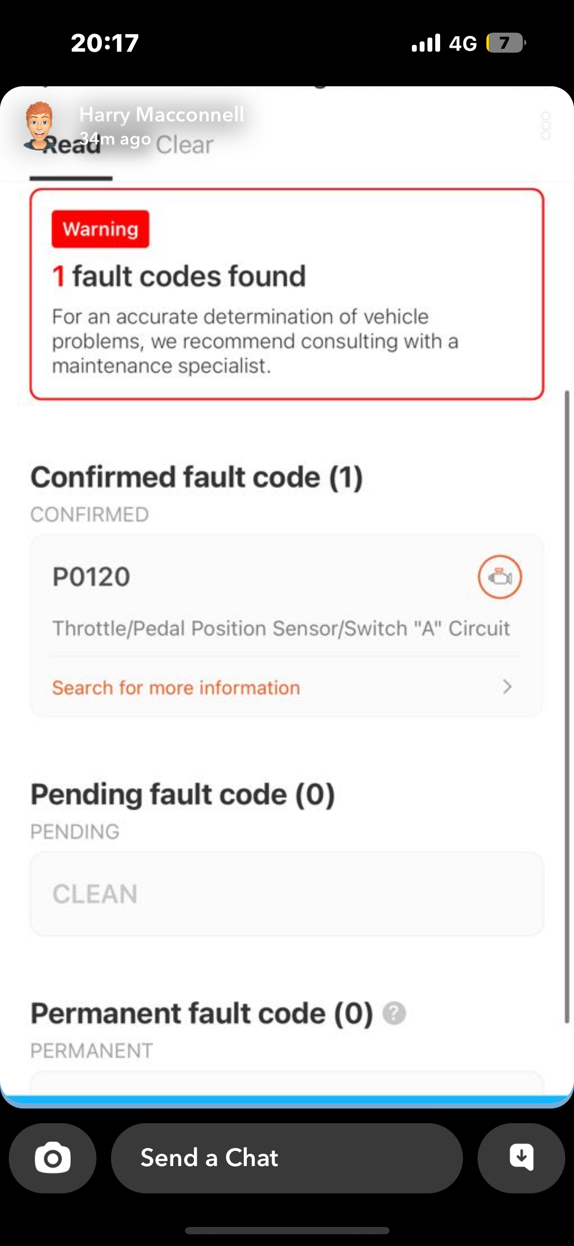

I’m having issues with the EML light and the coil light (under the fuel low light) coming on, and loosing power.
It’s scanning as throttle position sensor track A.
