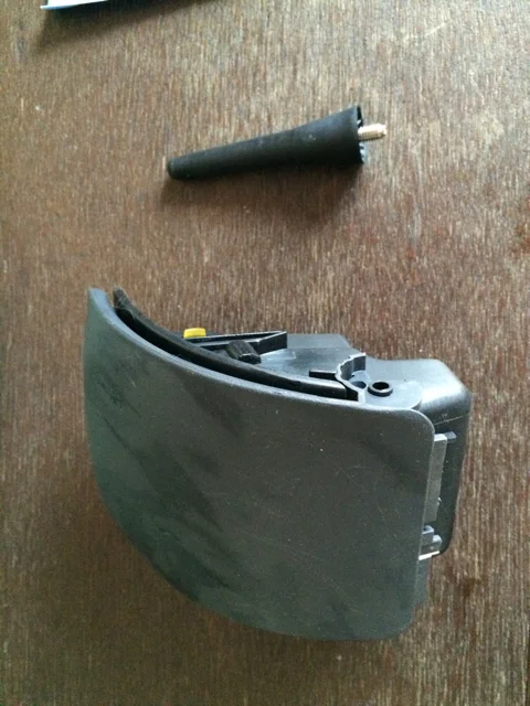

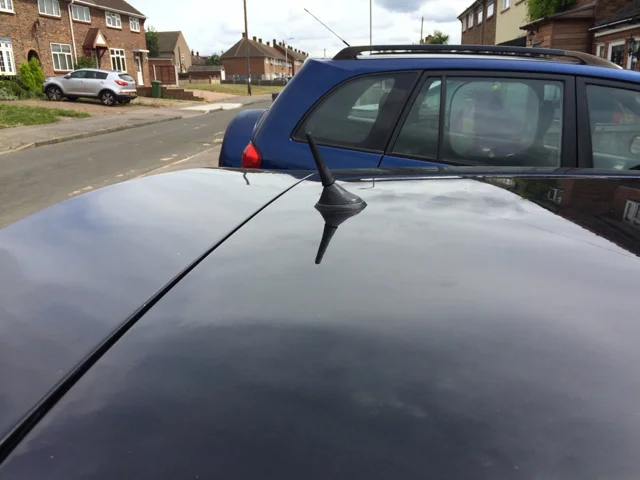

Aerial base is relatively easy to change but needs headlining dropping slightly. It connects behind drivers c pillar.

Changed a broken mirror today

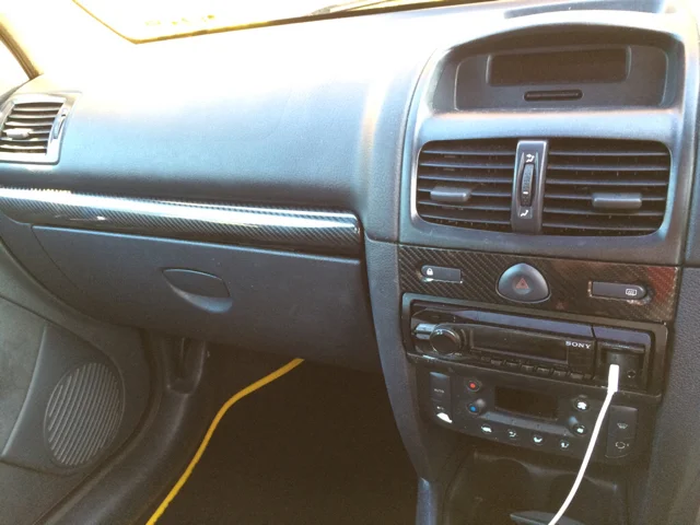

Changed some LEDs and carbon fibre interior inserts. Might get the interior handles hydro dipped as they have seen better days.

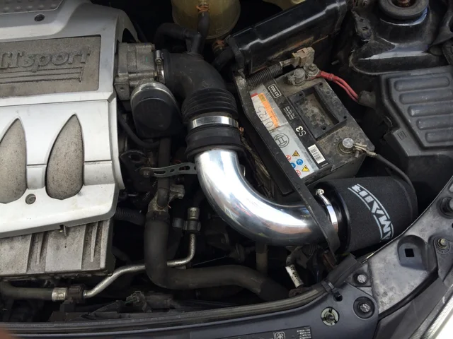

Fitted the fatty kit today. Def sounds better than the $hit universal cone the previous owner had on it.

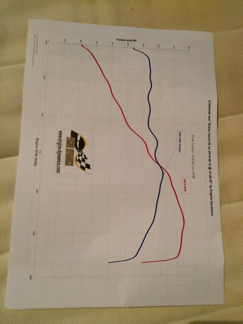

Had it dynod at engine dynamics Friday. Made 169 a bit under powered tbh. Phaser a little noisey so will get that and timing done and hopefully hunt down some 197 cams before hand.

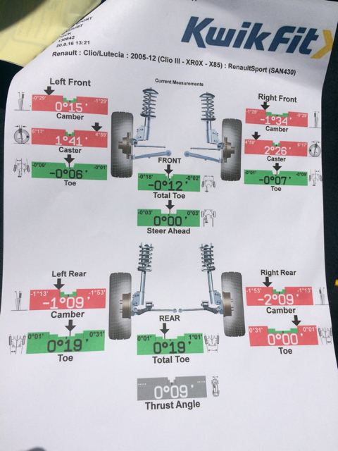

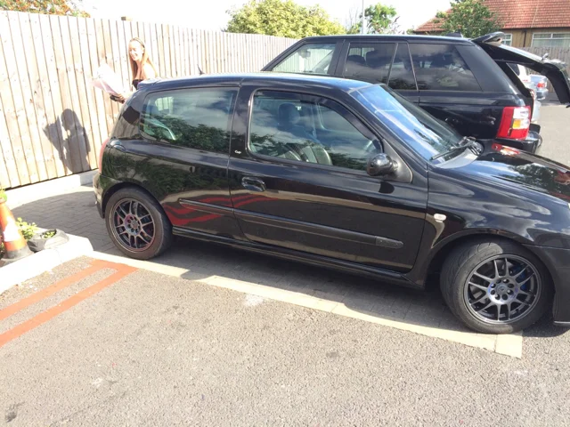

You need a shim on the passanger rear, 1 degree.
Your front camber should be more equal too.
imprezaworks
  Mk5 Golf GTI :)
The rear camber front and back should be close together.
Either the rear hub is slightly bent, or you need to pop a camber shim in to level the rear out.
The fronts I would get camber bolts, I have but not had it set up yet. Front camber for both need to be anywheres from 1 to 1.5 negative for better turn in.
imprezaworks
  Mk5 Golf GTI :)
If you feel it drives well then not really. You may find depending on how many miles you do the driver side tyres will wear quicker.
