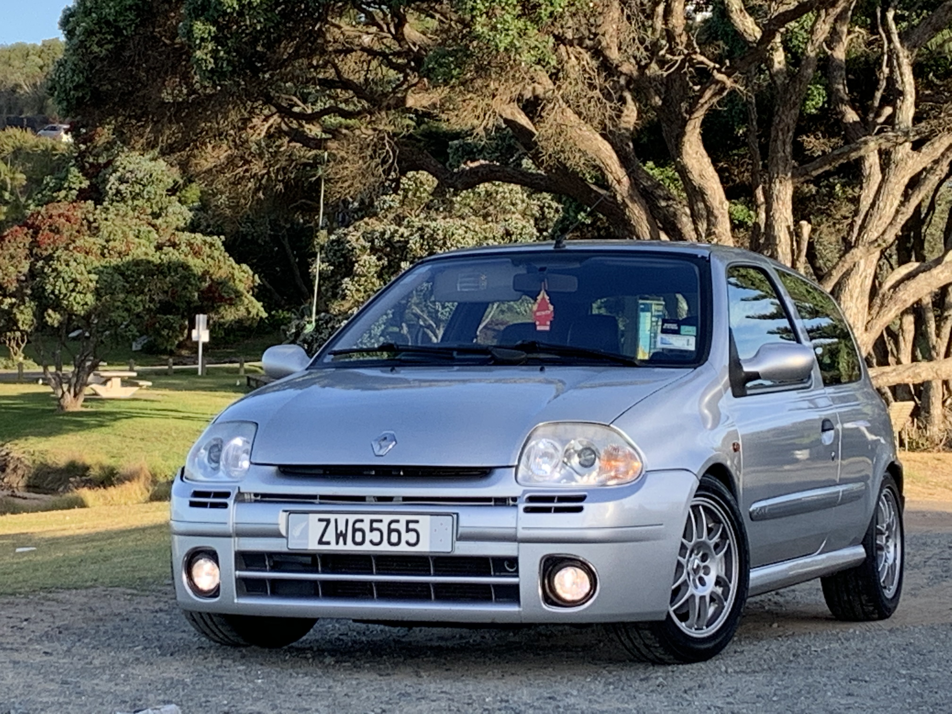

Hey guys
Recently returned to ClioSport after 11 years, I live in New Zealand and this is my fun project. This is my 2nd car, my daily is a 2018 Mazda 3 Sp25
Recently purchased this car and given I have heaps of plans have already begun some, I thought I'd start this project build
The plan is to create a really clean road OEM looking example, something I hope to keep for years.

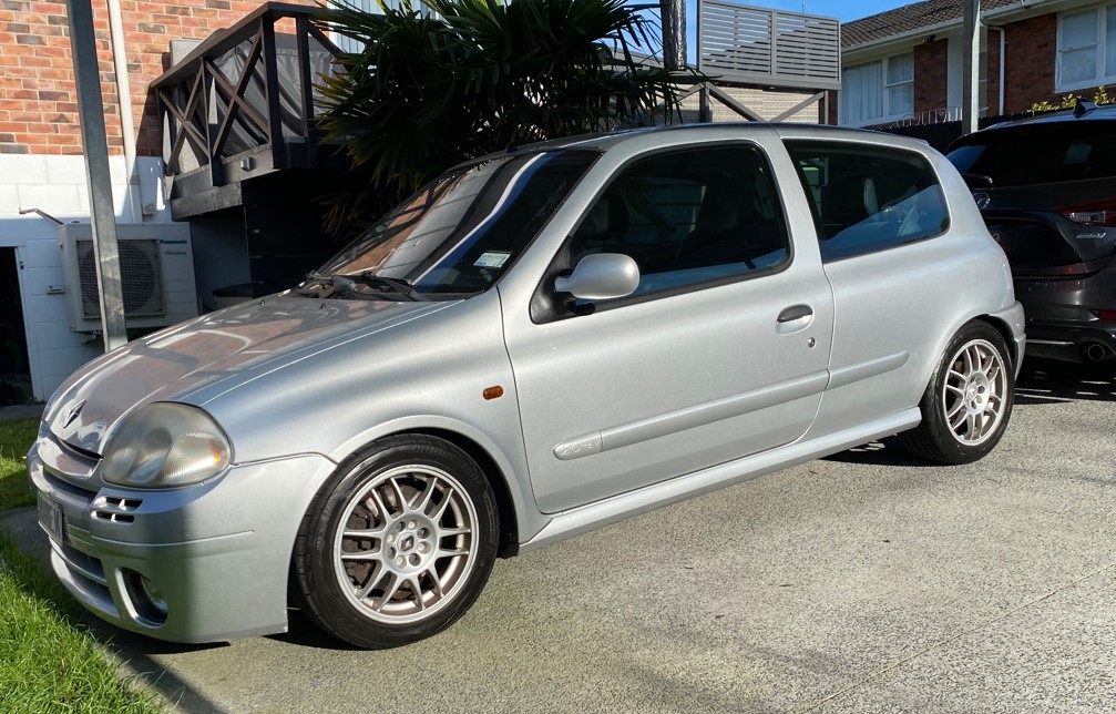

I'll use this first post to capture the car condition & spec when I picked up the car
The Car
  • 2001 172 Phase 1
  • 90,000 miles
  • 2 Keys, heaps of service history (Credit to previous owner for his service work & maintaining the service/paperwork etc)
  • Engines runs & pulls well
  • Body condition is - fair
  • Interior condition is good
Existing upgrades / Bits
  • Powerflex Dogbone & Upper Engine Mounts (mods I would have done myself)

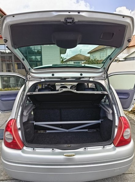

  • BAF Motorsport K-Brace rear strut (Nice addition actually)
  • Coby Resonator (Probably a bit louder than I would like)
  • Sportline Steering wheel (not to my taste - also had the original)
  • Phase 2 Rear lights & Door strips
  • Lowered on Apex springs
  • Renault Roof Racks (Jeez, has anyone seen these?)
  • Driver seat spacer removed
Short - Med term plans
  • Remove the roof racks (Key lost)

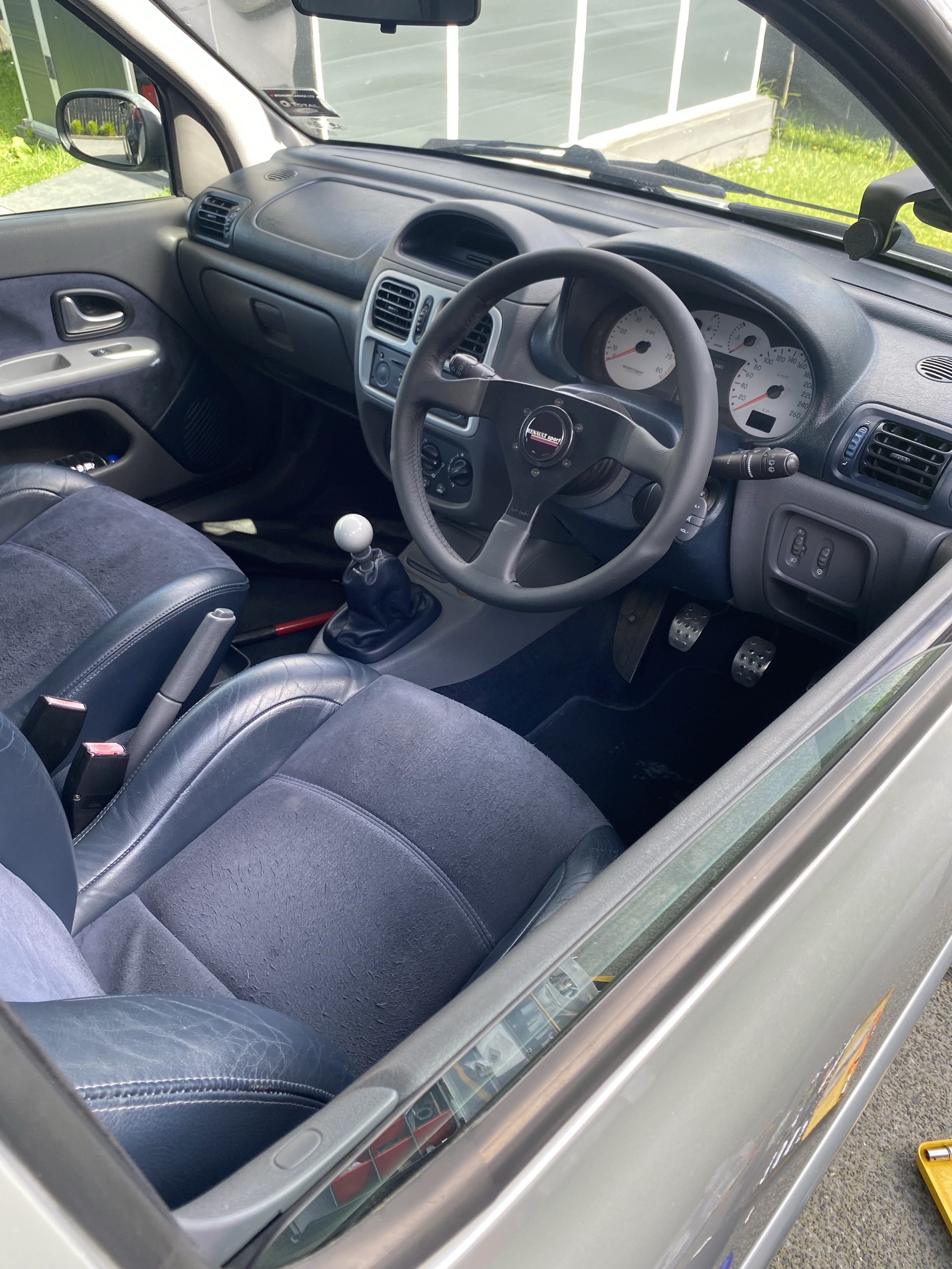

  • Replace Steering wheel with something less 'Pink slips in fast & furious'

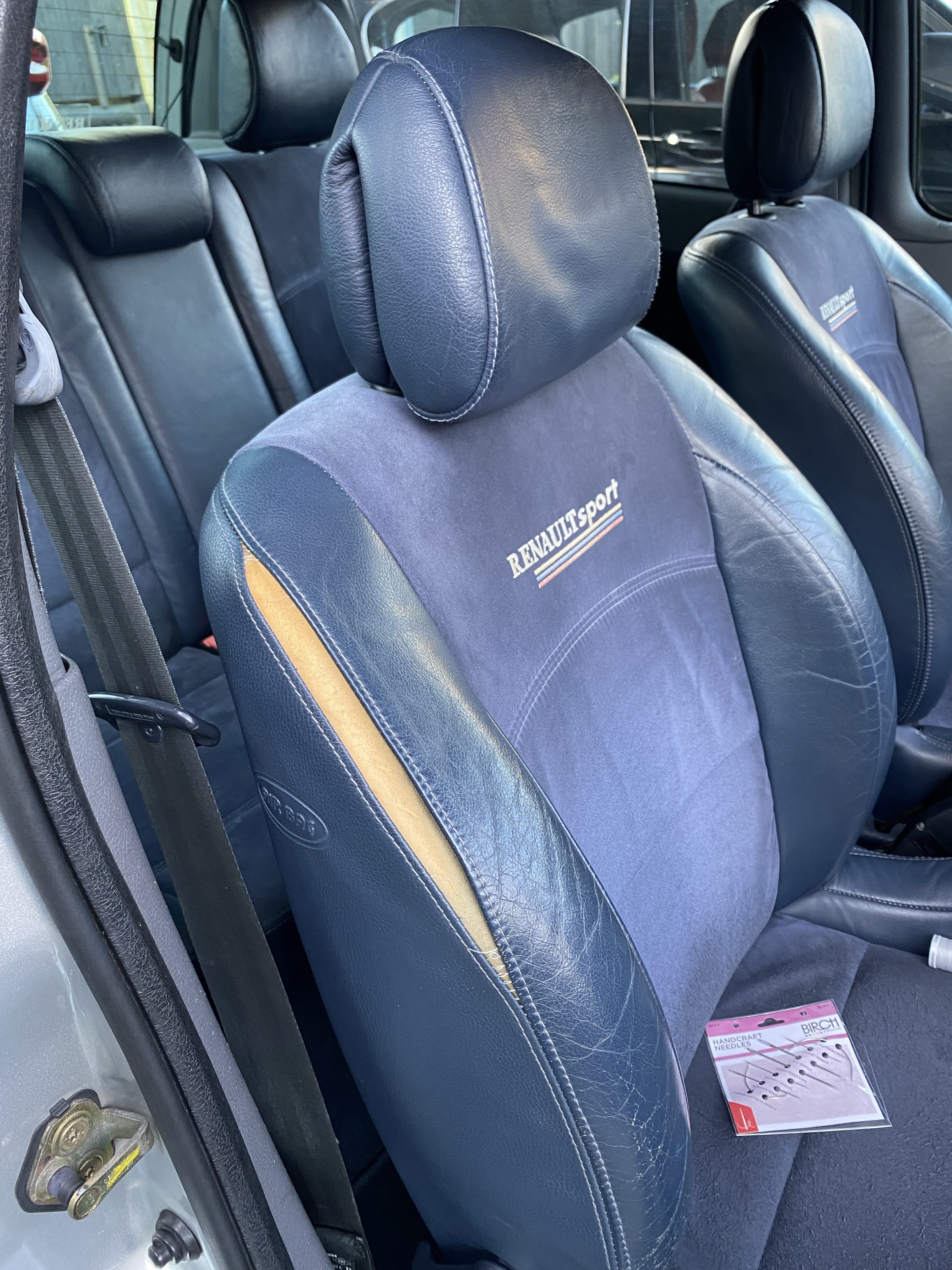

  • Repair seat bolster stitching
  • Repaint the Roof, Mirrors & spoiler
  • Full Service
  • Replace Engine Cover, Coolant flush & Replace the coolant tank to freshen up the engine bay (Ordered - Waiting to arrive from UK)
  • Deep clean, Wheels, bumpers, door seals etc all off.
  • Review my suspension options - naturally i'd go for some coilovers but they require a bit more work here in New Zealand (need certifying etc)
  • Review the exhaust options
I'm a bit of a dog with a bone, so you can expect to see this evolve quite quickly.

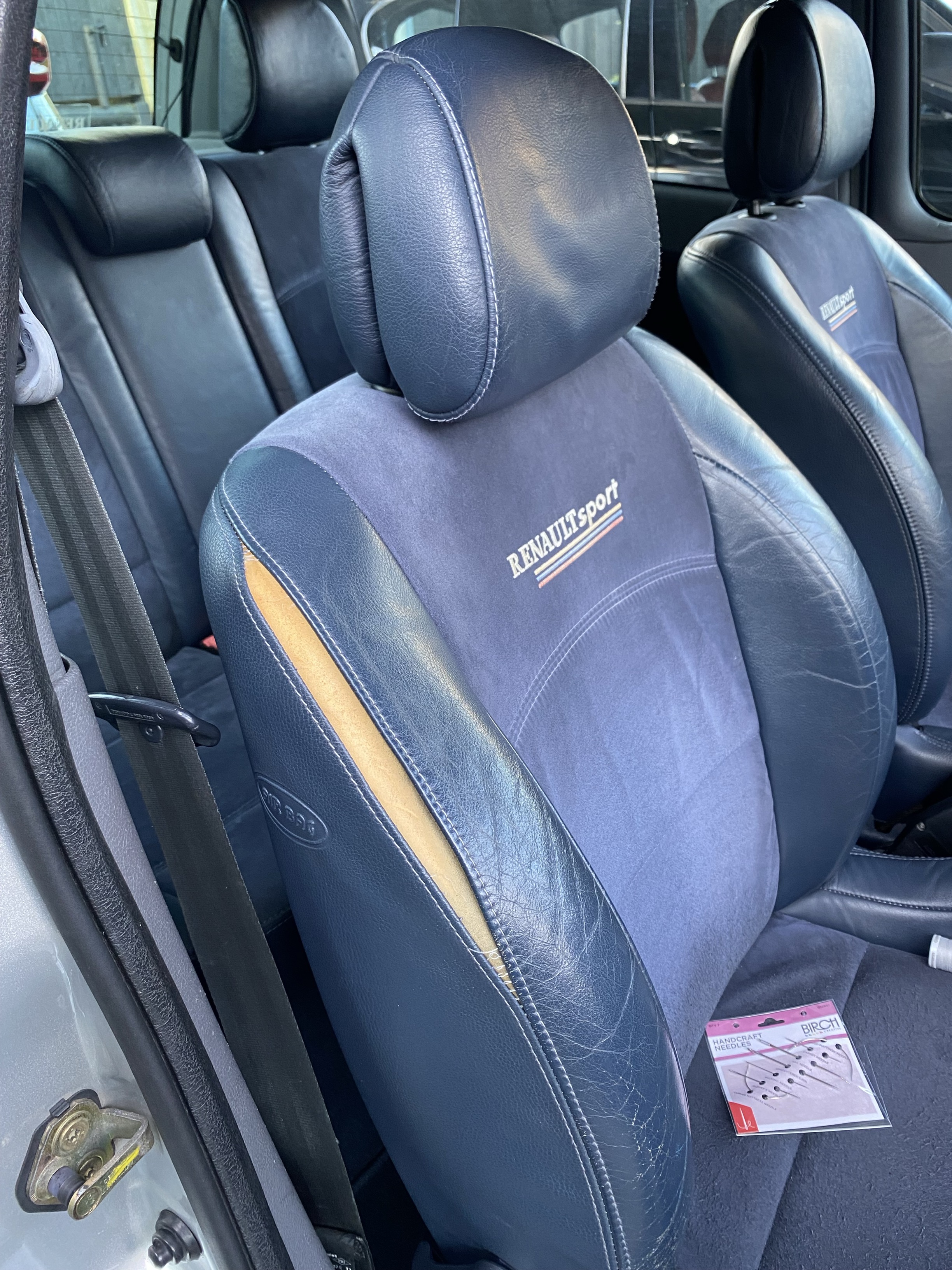

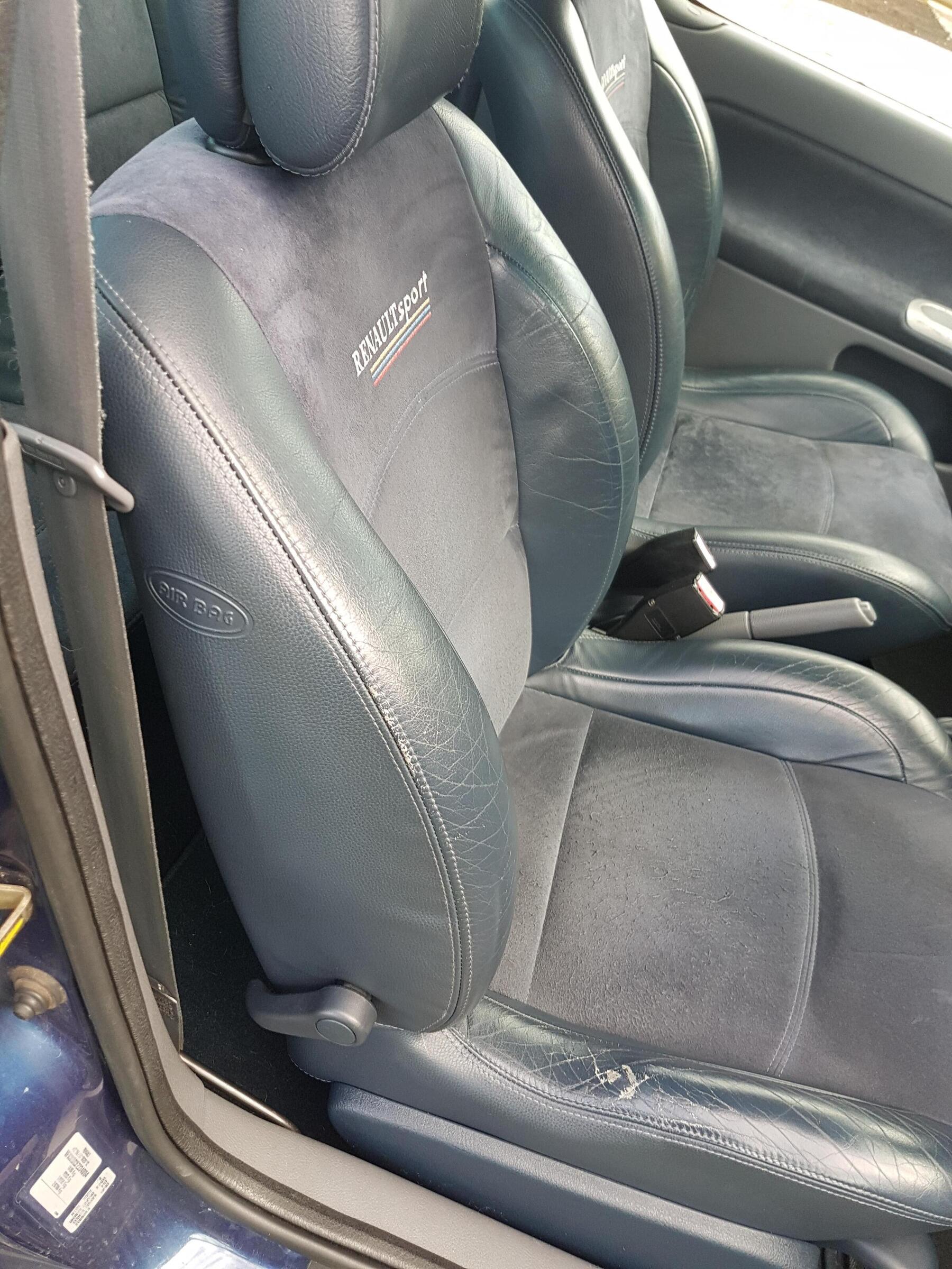

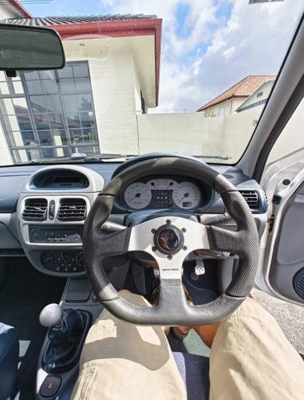

First couple of tasks was to remove the roof racks & replace the steering wheel
Replacing the Steering Wheel
Old SportLine Steering wheel
New Momo Monte Carlo 350 Steering Wheel in leather, I then purchased these cool Renault stickers that follow the same Renault sport logo colour scheme on the seat.. to offer that more OEM+ vibe and I think it came out great. (I didn't fancy a big MOMO horn button!)
I also have the original steering wheel, but as we all know.. its big enough to steer a double decker bus!

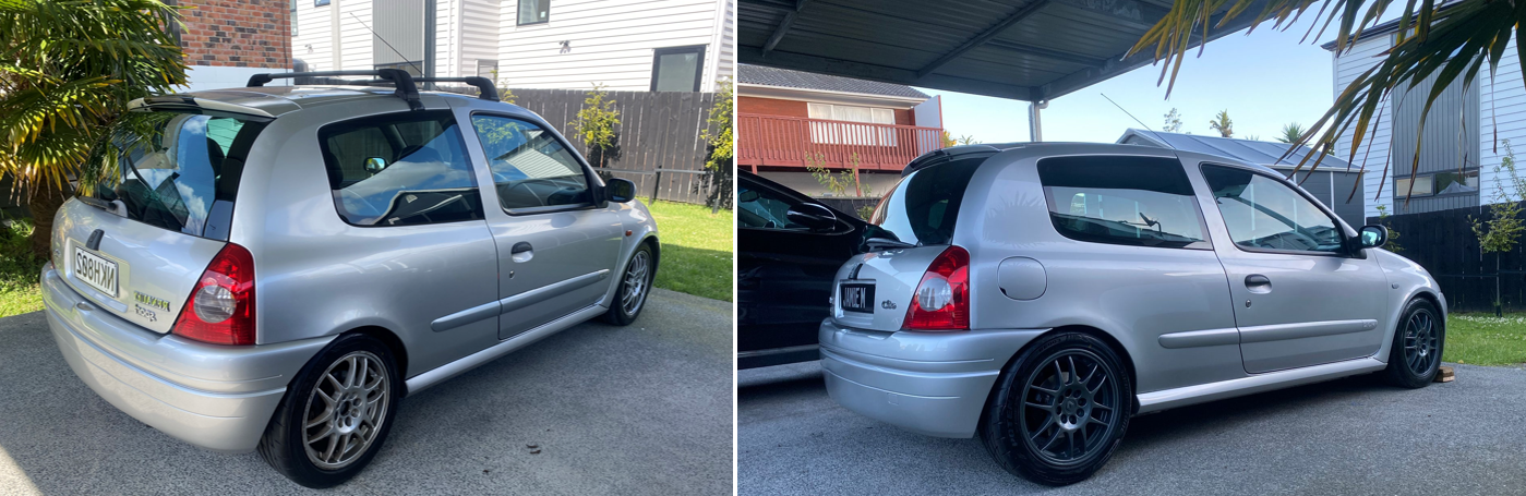

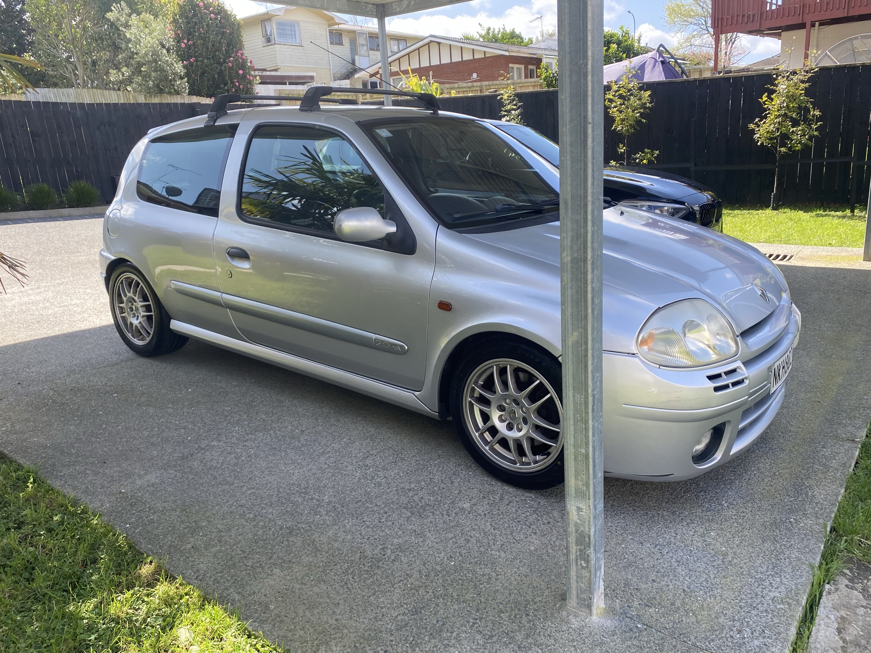

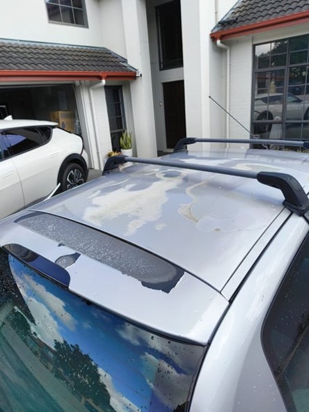

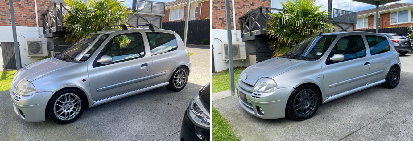

Roof Rack Removal
Although I think it's kinda cool that the car had original Renault roof racks on, they had to go.
The locking key to remove them was missing, so I got creative to remove them.. but It worked out well and I think it looks a lot different already!
That is looking much better already. Great project and look forward to seeing you get it back to its former glory.
I fixed a car seat myself a couple of years ago with some thick thread and a curved needle. Was quite relaxing sitting doing it and saved me paying a trimmer to do it.
Hey @PP200t, thanks! Yeah it's going to be fun. Yeah I seen a few tutorials on youtube that mentioned the exact same technique!

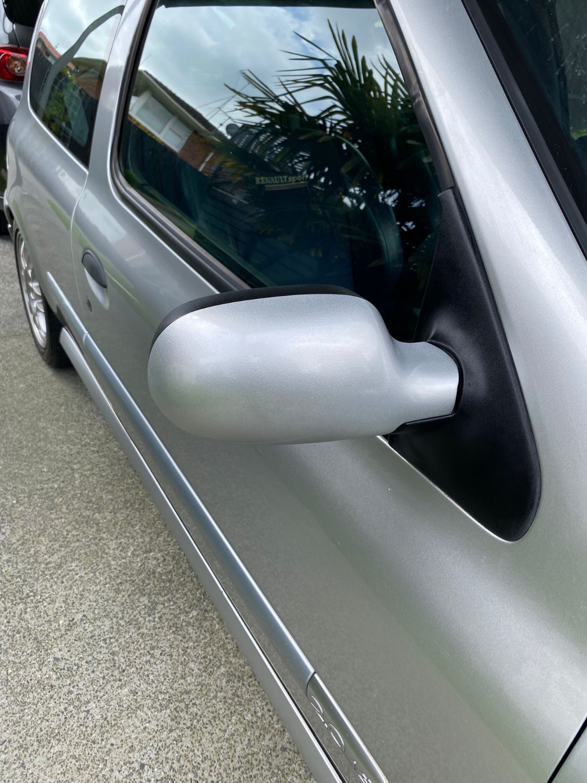

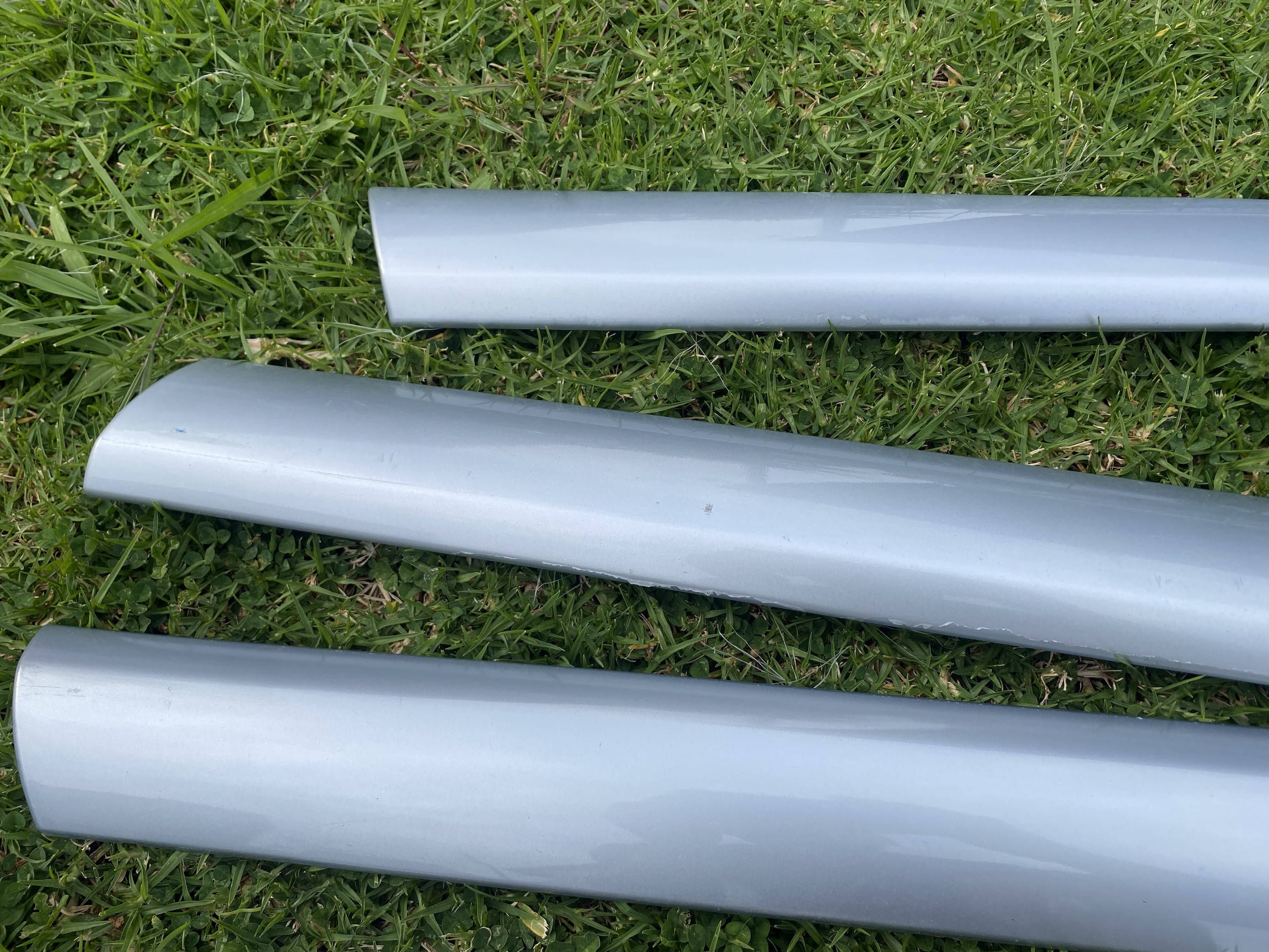

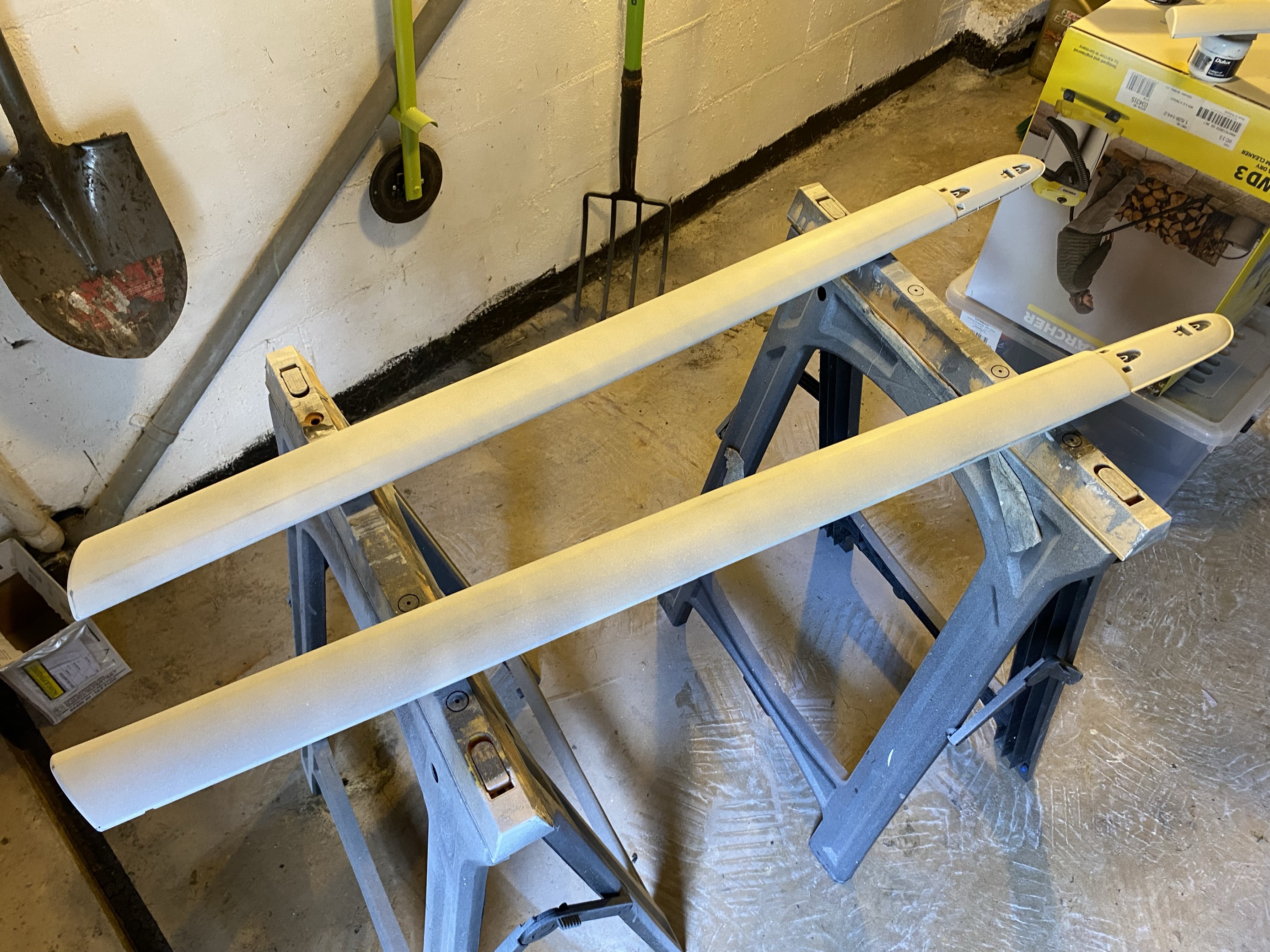

Update

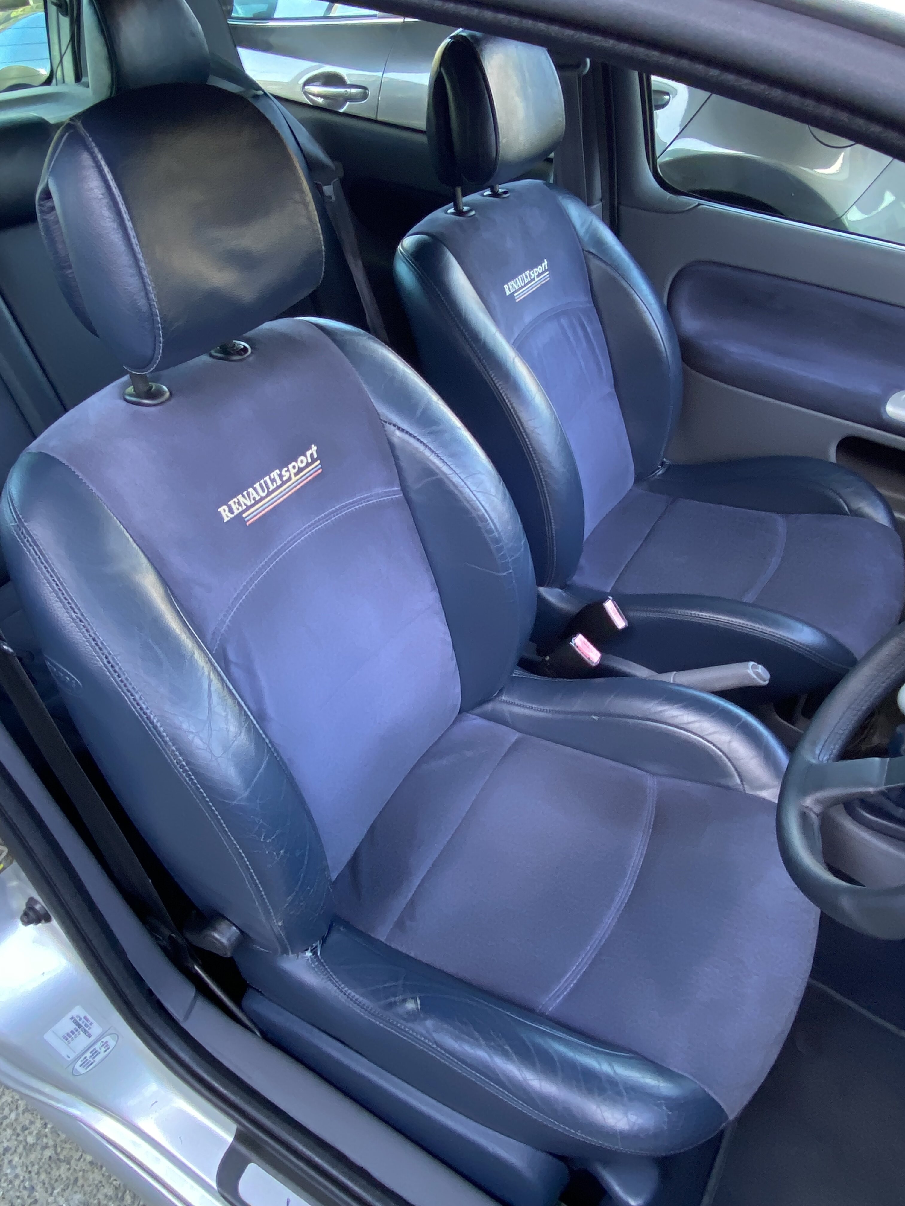

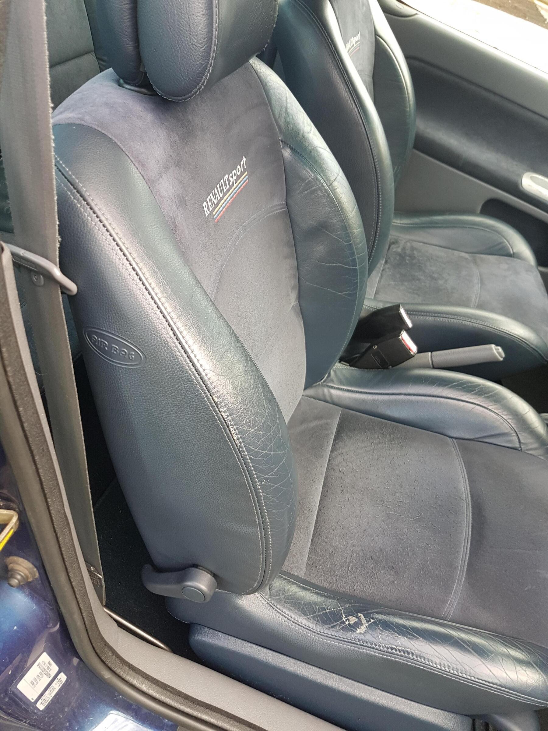

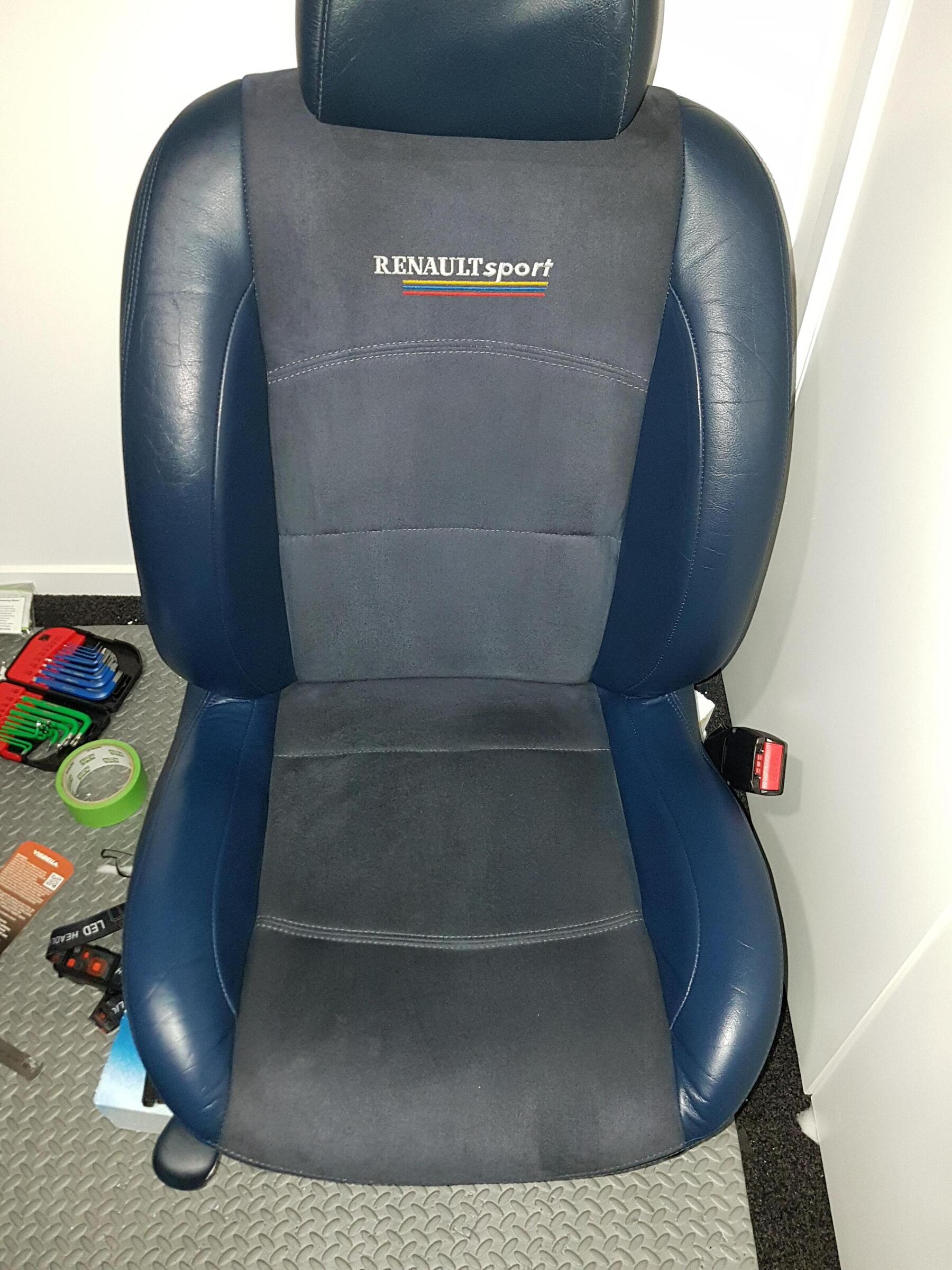

  • Drivers seat stitching repaired. As @PP200t mentioned above. Curved needle, strong upholstery thread & some patience and it came out nicely.
  • Interior clean & shaved the seats, I did use a razer blade first but resulted in using a fabric shaver in the end, just faster and less effort!

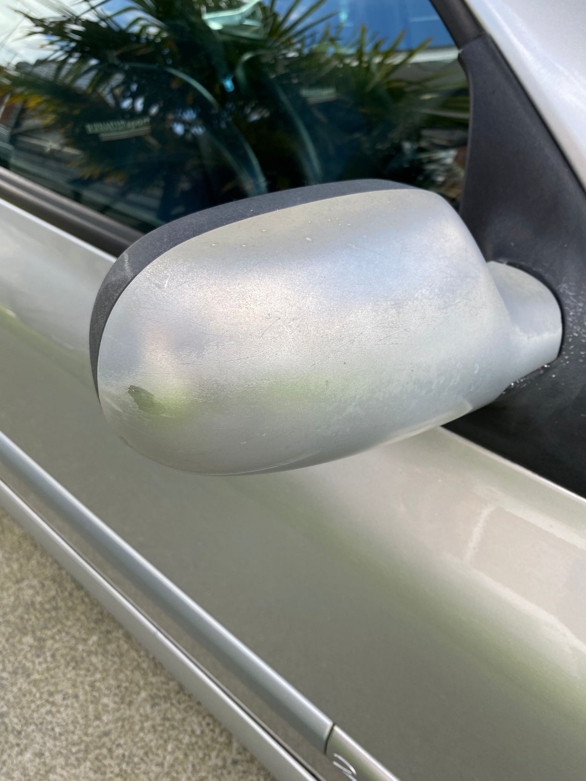

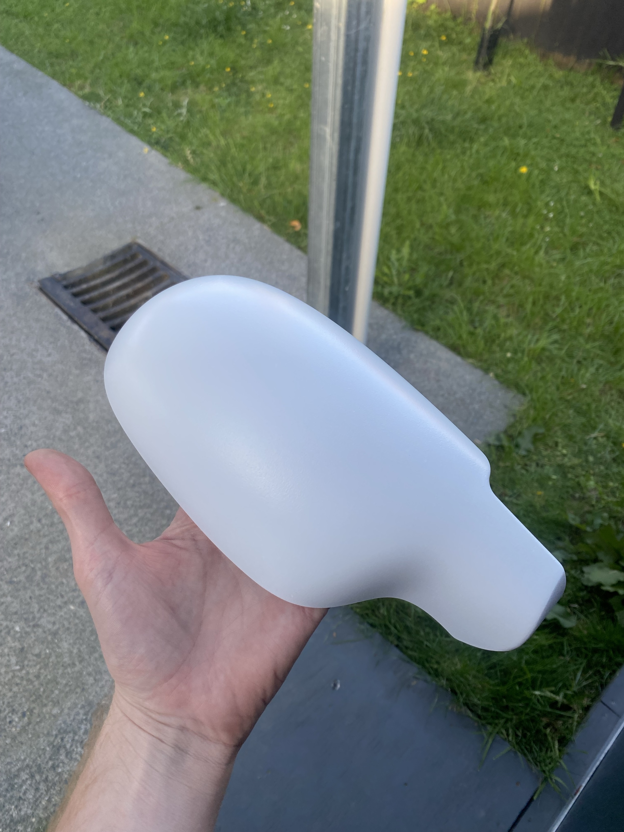

  • Mirrors & Side strips repainted.
    • Mirrors were just tatty
    • Side strips were pealing, and given they are off a phase 2 the silver was different which although not obvious, once you see it you can't un-see it! haha. I actually DIY'd the mirrors & side strips and they came out pretty good in my mind.
      Although I could have paid someone to do the painting, I'm trying to do as much as I can and just enjoying working on this thing. Anything I can do myself to 'improve' the thing - I'm doing :)

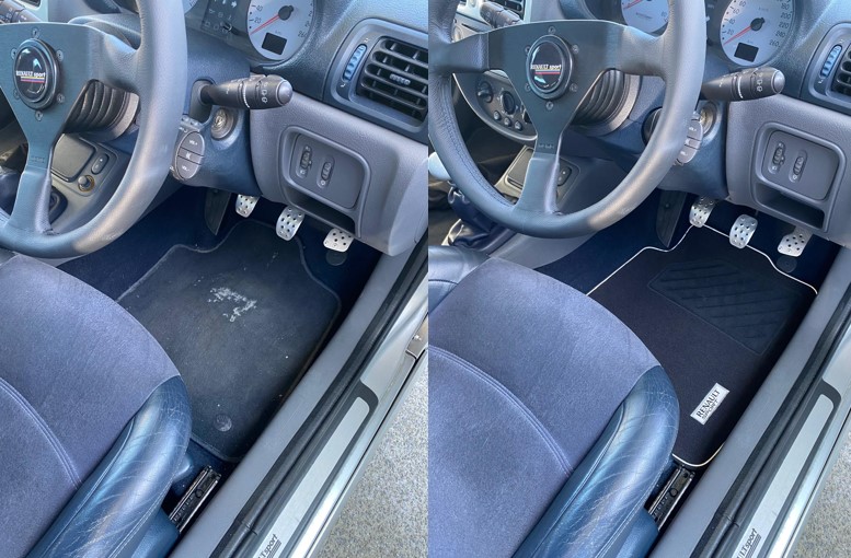

    • Original RS floor mats

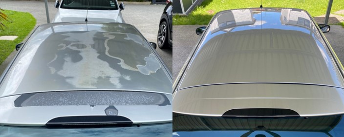

  • Roof repaint - Car was dropped off this morning, that's in really bad shape and is cracking due to a previous repair I'd guess

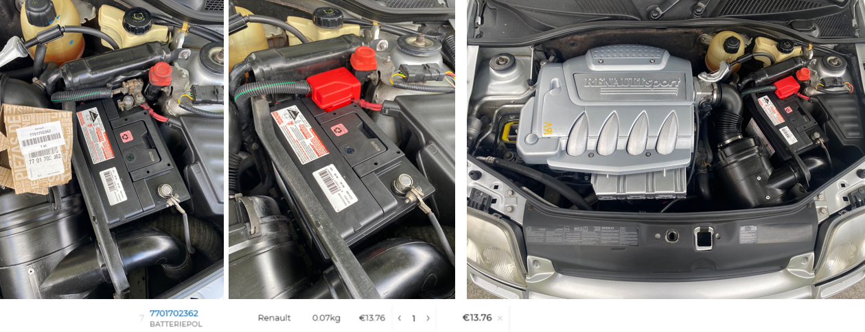

  • Replace Battery

Here's a different shot in the sunlight - showing the outcome of the side strips & the mirrors
It's still possible I might return to the black p1 black side strips depending how fussy I am about returning it to OEM, but if I keep these colour codes ones, I may get the door handles colour coded too. We'll see.

Is looking great, I repair and dye the bolster on the seats I use some products from the italian leather company and colorlock dye. and repair the under foam so it doesn't keep disintegrated.

Perfect on the stitching mate, looks a different seat now you’ve repaired and debobbled it.
The paint you’ve done also looks really good. I prefer the colour coded strips, think it changes the car personally.

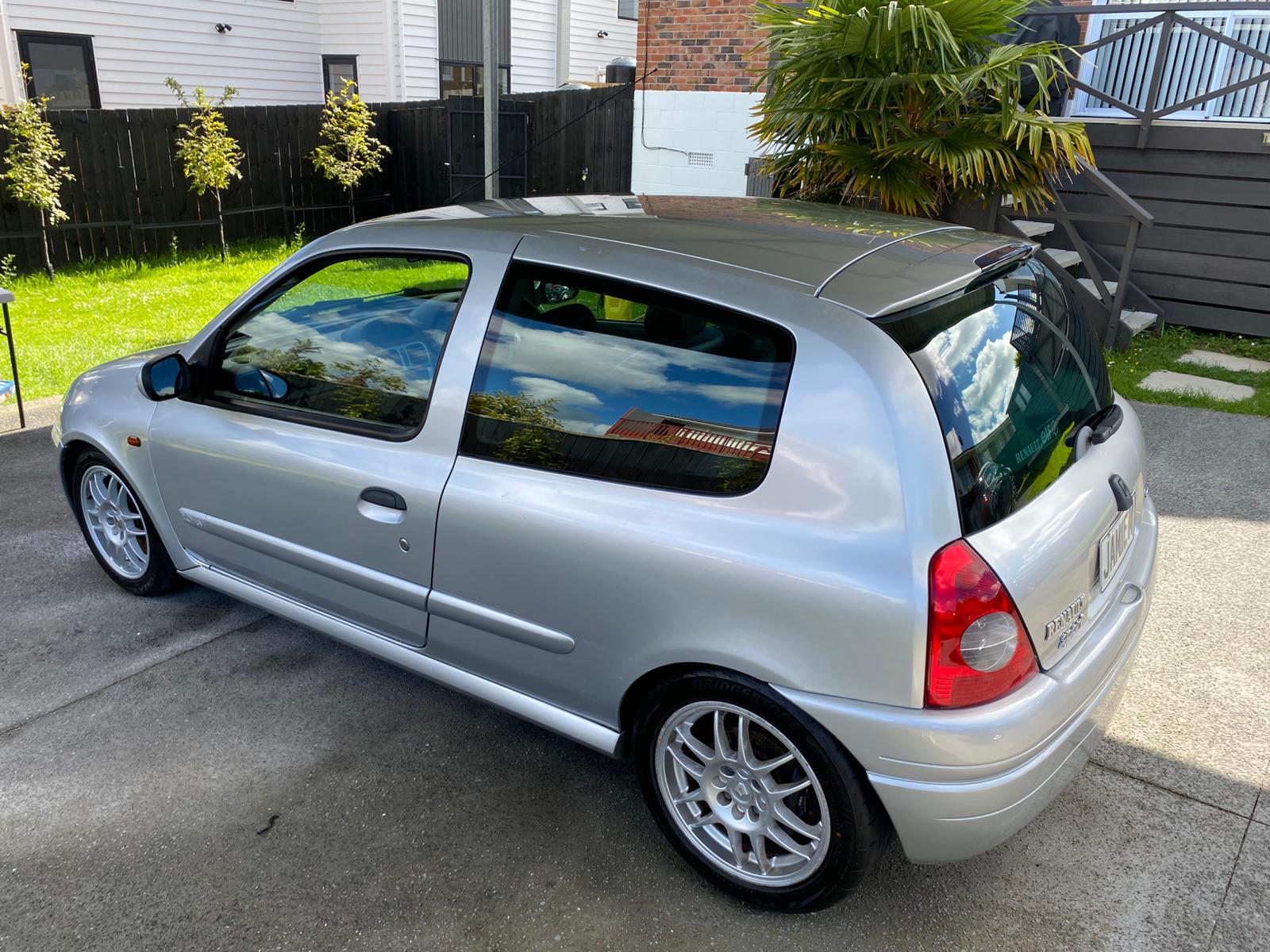

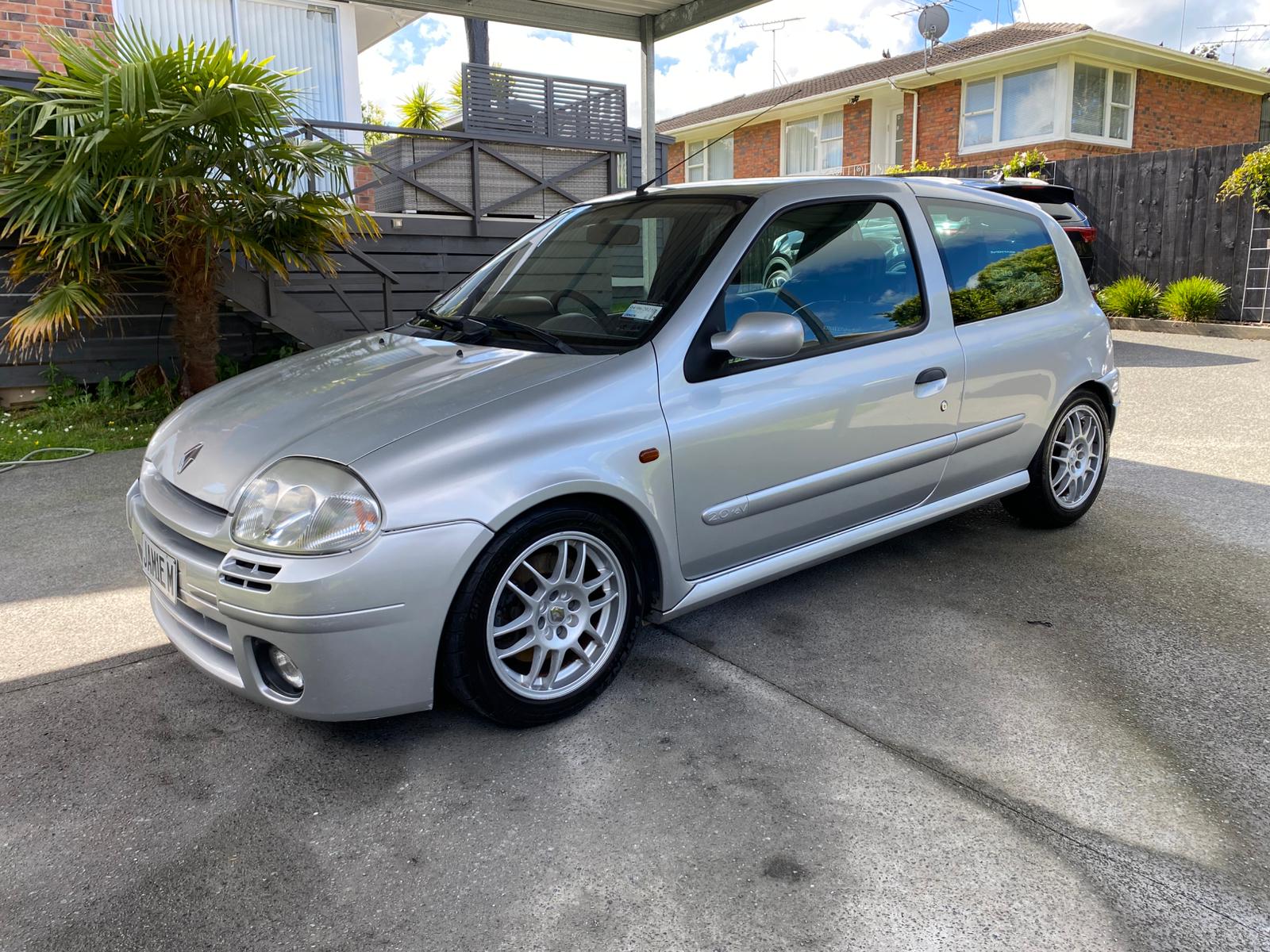

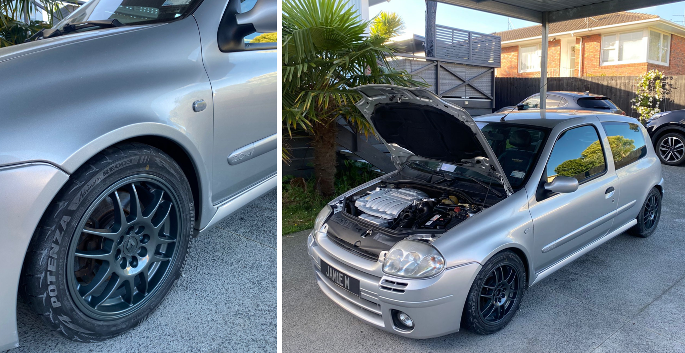

Alright legends, another update on the Clio - Piece by piece she's coming together :)
- Roof & Spoiler painted (This was badly damaged by NZ sun, but also was cracking pretty badly too!)

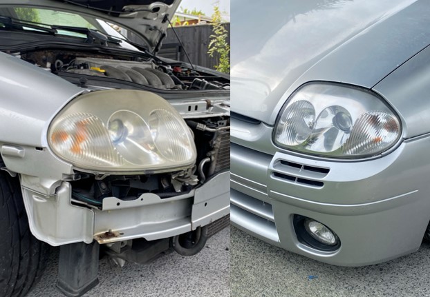

- Headlights restored
- Door Strap Replaced

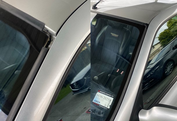

- Windscreen corner seal tidied up
- Removed front bumper, cleaned everything up. Used heat gun to push out a crease/dent that was causing the bit under the front grill to look all wonky!

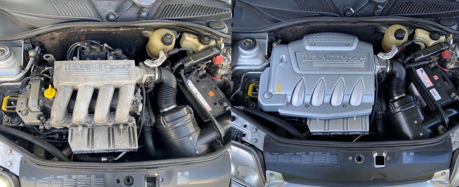

- Engine bay (New engine cover, paint some bits, new coolant expansion tank etc)

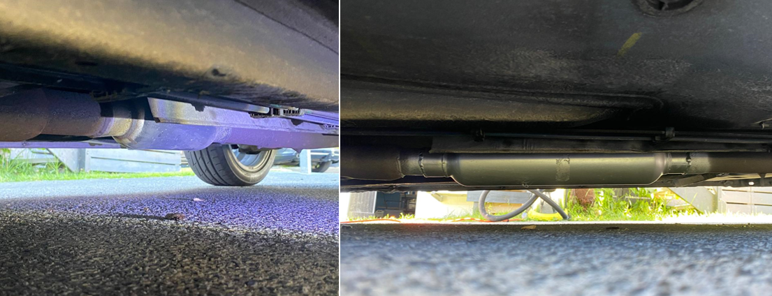

- New Exhaust (Likely going for the Ktec stealth silenced. Want to keep it stealth as don't wanna cut the bumper and these are one of the few sites that'll ship it all the way to NZ)

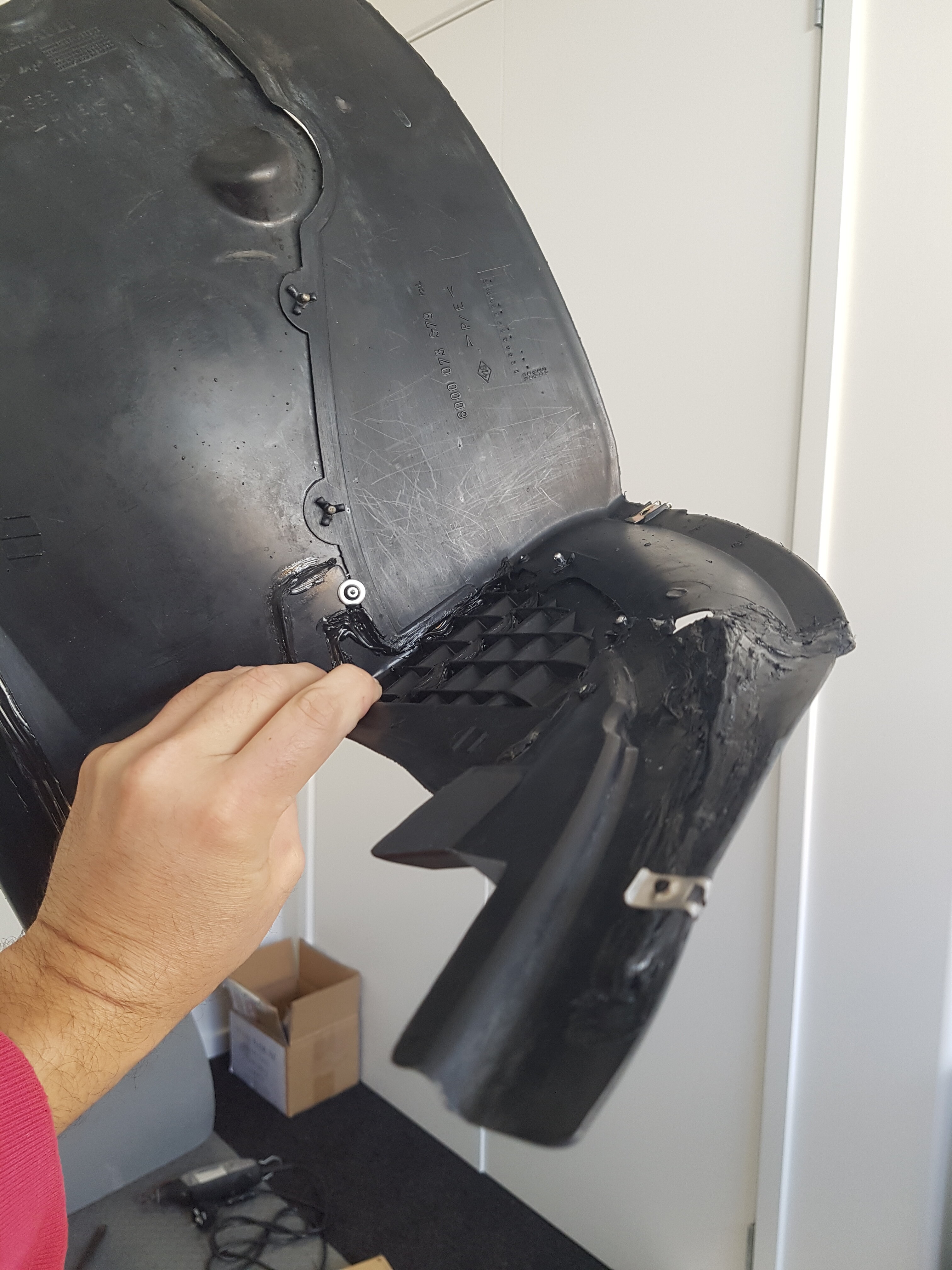

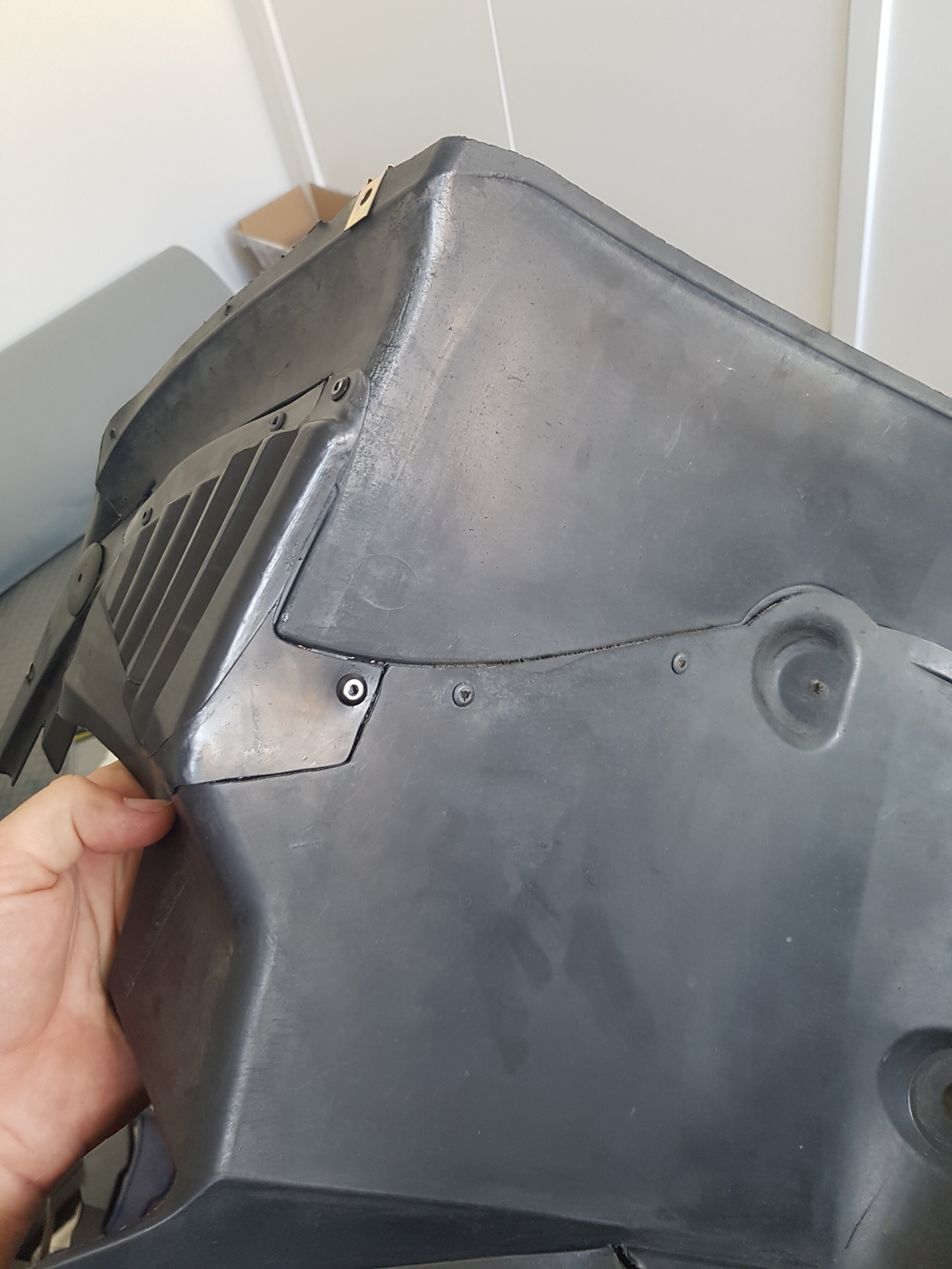

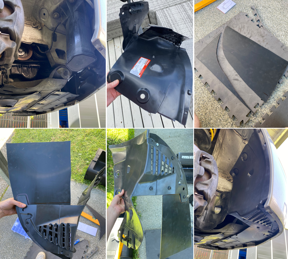

PS - Desperate for an inner arch liner for front right side if anyone happens to have one!

Is looking really nice, regarding the Exhaust I install a Ktec unsilenced with a decat and was loud and with a really bad drone, ( I choose that one because was the cheapest and I didn't want to pay custom duty's), last year I chopped and install a resonator in the middle, the drone improve but still there going in the motorway at 100km/h. Happy if you want to come to Pukekohe and you can feel the drone.

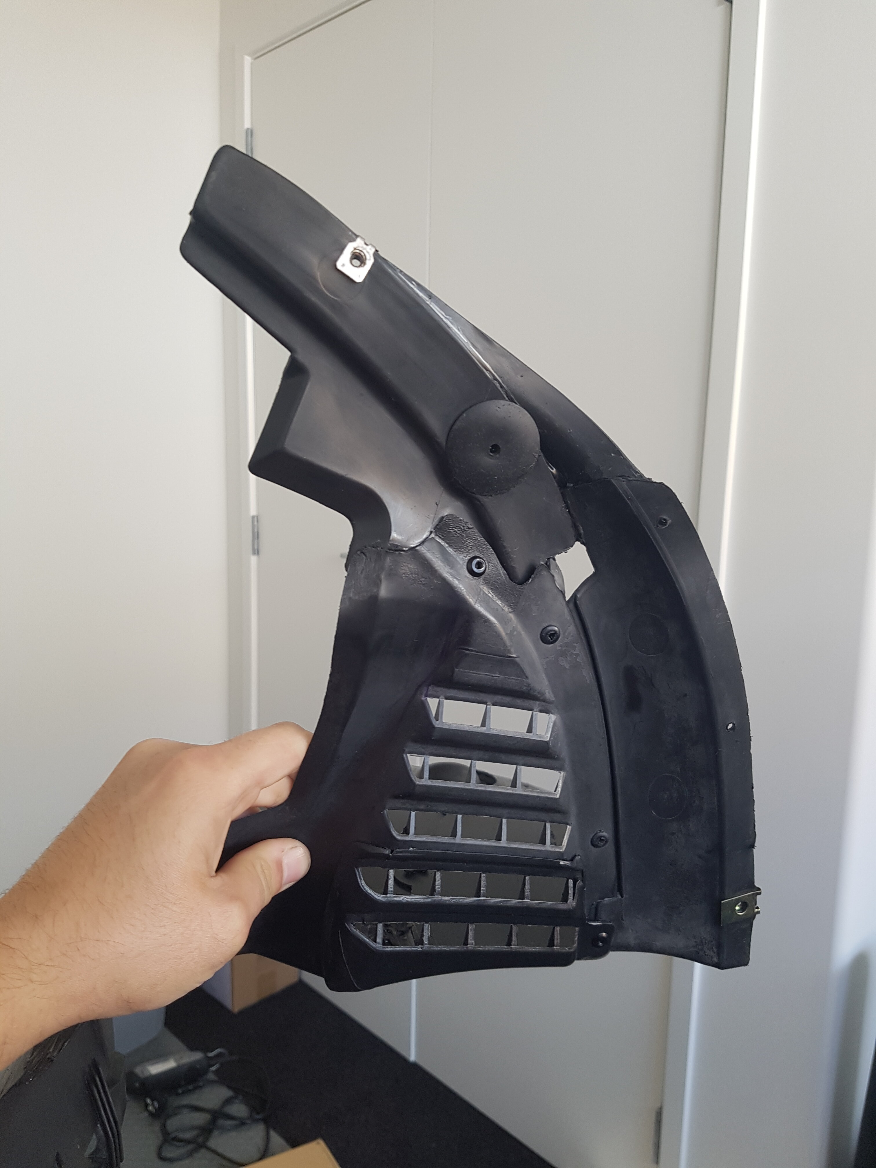

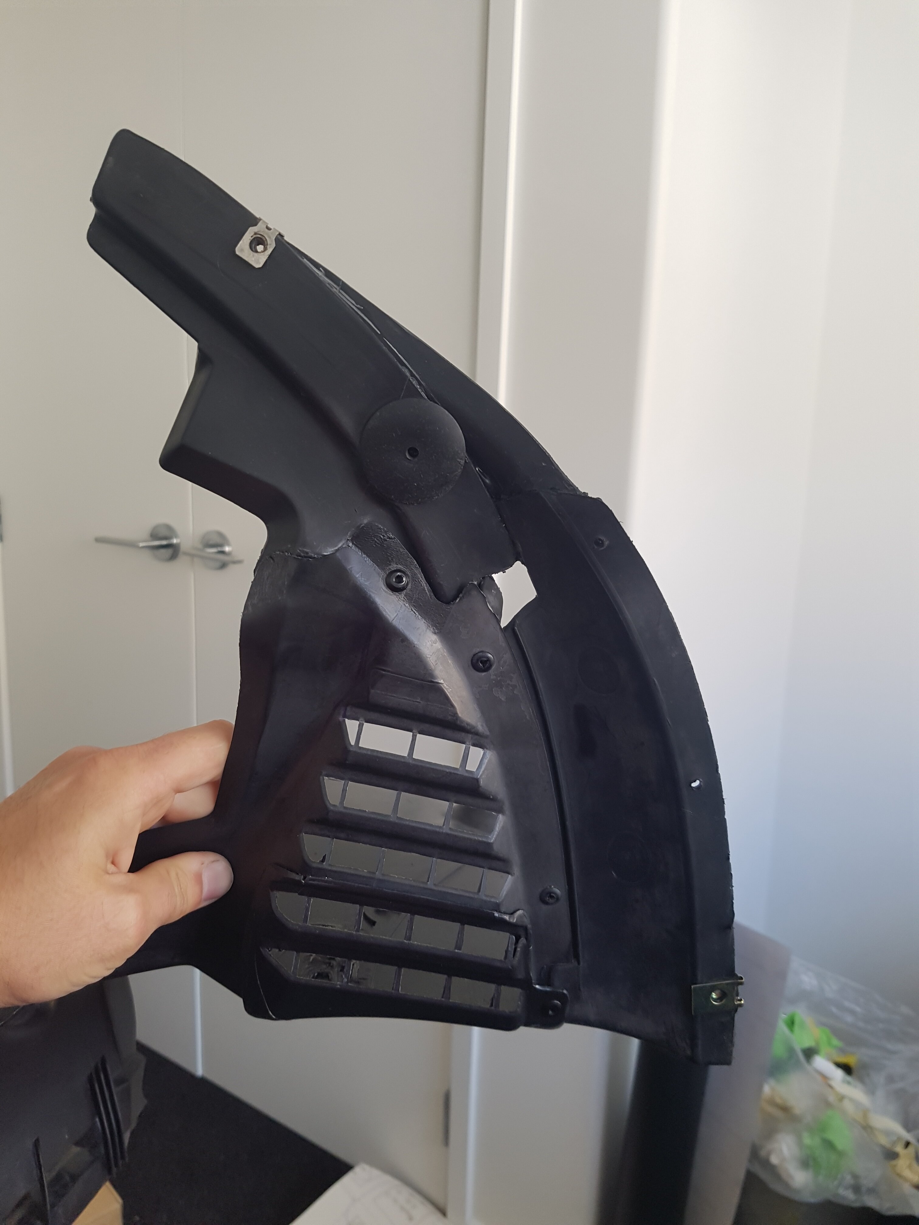

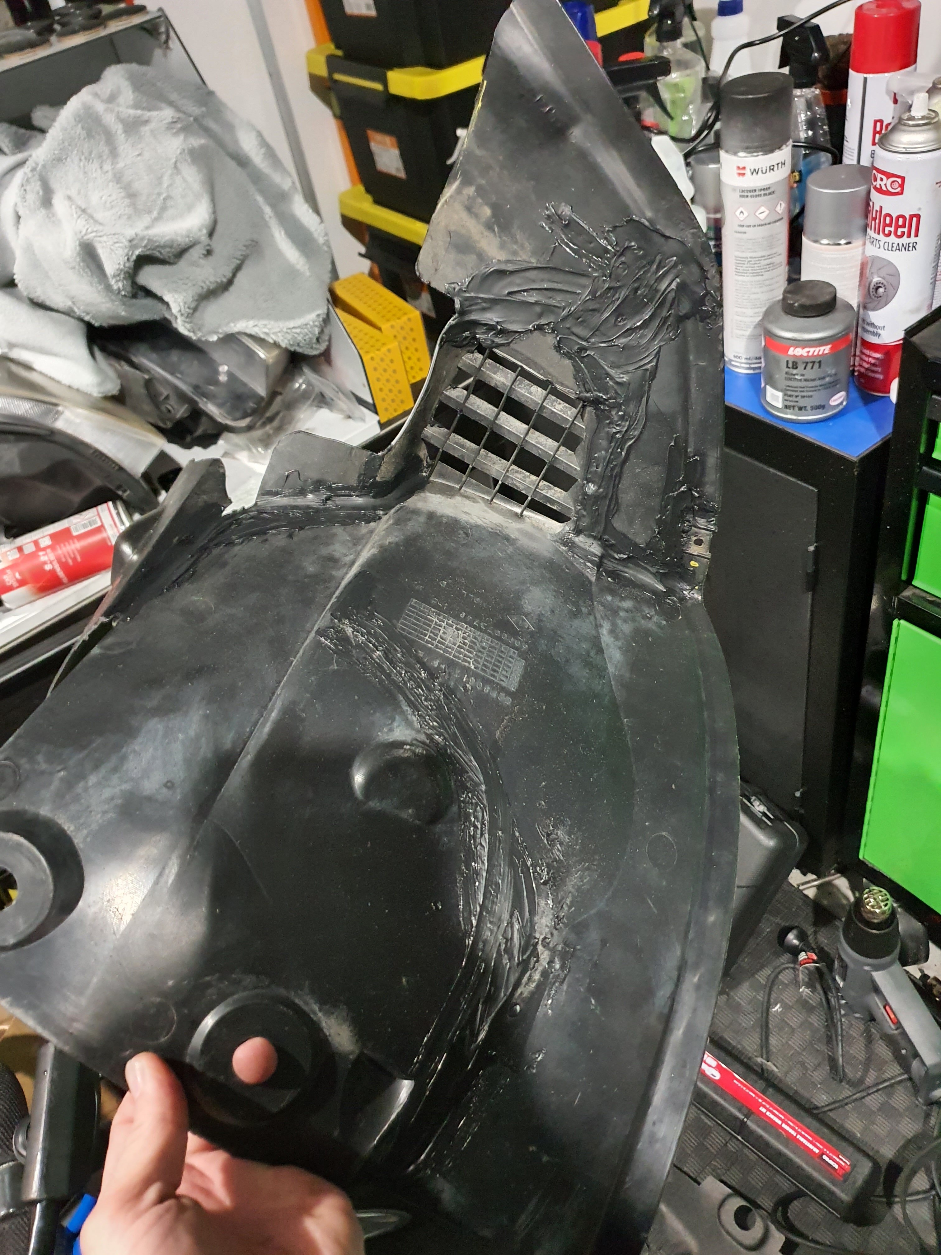

And I gave up trying to find a front piece wheel arch for reasonable price in NZ so I modified a standard one for now.

May take you up on visit to Pukekohe pal, good to hear you had some success modifying the standard front arch liner.. How difficult was that? do you have any pics of it I can look at? I sense i'm going to have to go down a similar route!
The arch liners were all there when I had the car, so not sure where one went?! I’m based in glendowie, so if you’re ever around pop by and grab those bits and pieces.
What I'm trying to do on my Ph2 2 is replace the resonator and Muffler for something else with out making it to loud but leaving the cat on this one. ( one loud Clio is enough for my age).
Due to prices of bringing things to NZ I will try first the spring on your current shocks and later you can get koni or new standards ones. ( Yes probably I will invest on new bushing for the front end that are pretty cheap from spareto.

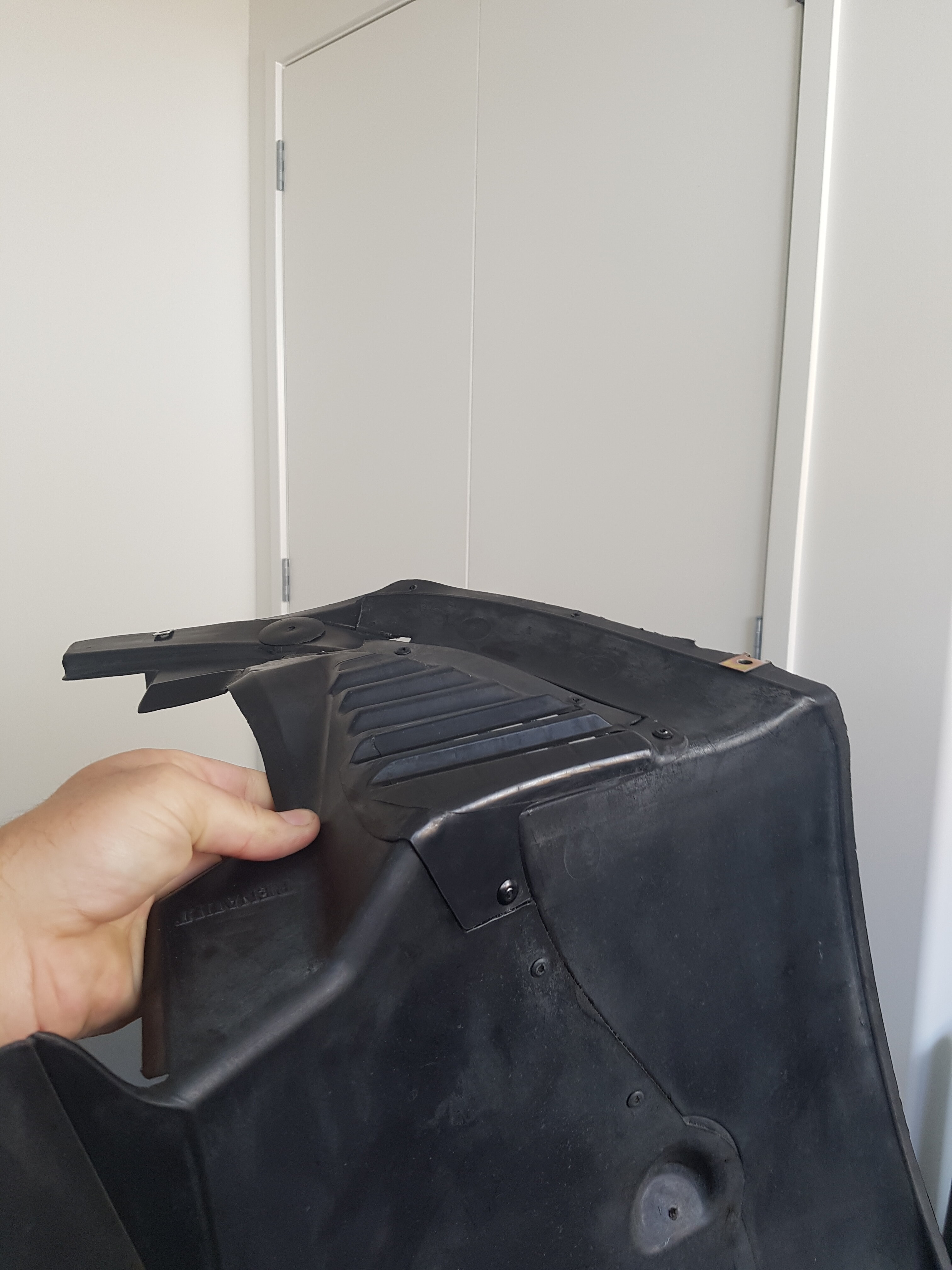

For the Arch this are some pictures is not pretty but does the Job. pretty much all the bottom part is for a standard Clio 2 ph. I still don't know what people do with the arch liners most of the Clio that I see they are gone or in half gone.
On the Ph2 was the same I could only found one of the arch so I grab one from another car on the pick a part and with some plastic welding and heat gun I made one is not pretty but its holding in there for now.
I will send you a Pm if you want to come for a visit
Ph2
Hey @Poonmobile - Yeah man, Leon remembers them being there too.. I suspect they were taken off when some timing belt/pulley work was done and not put back in!
Nightmare, because they're like fricken gold dust to find these days, and expensive as hell if you do
I can make a bee-line and pop by, I'll DM you on FB pal
@DLX - Thanks for pics on that arch liner.. good indication of what I'll need to modify if I go that route. Thanks man

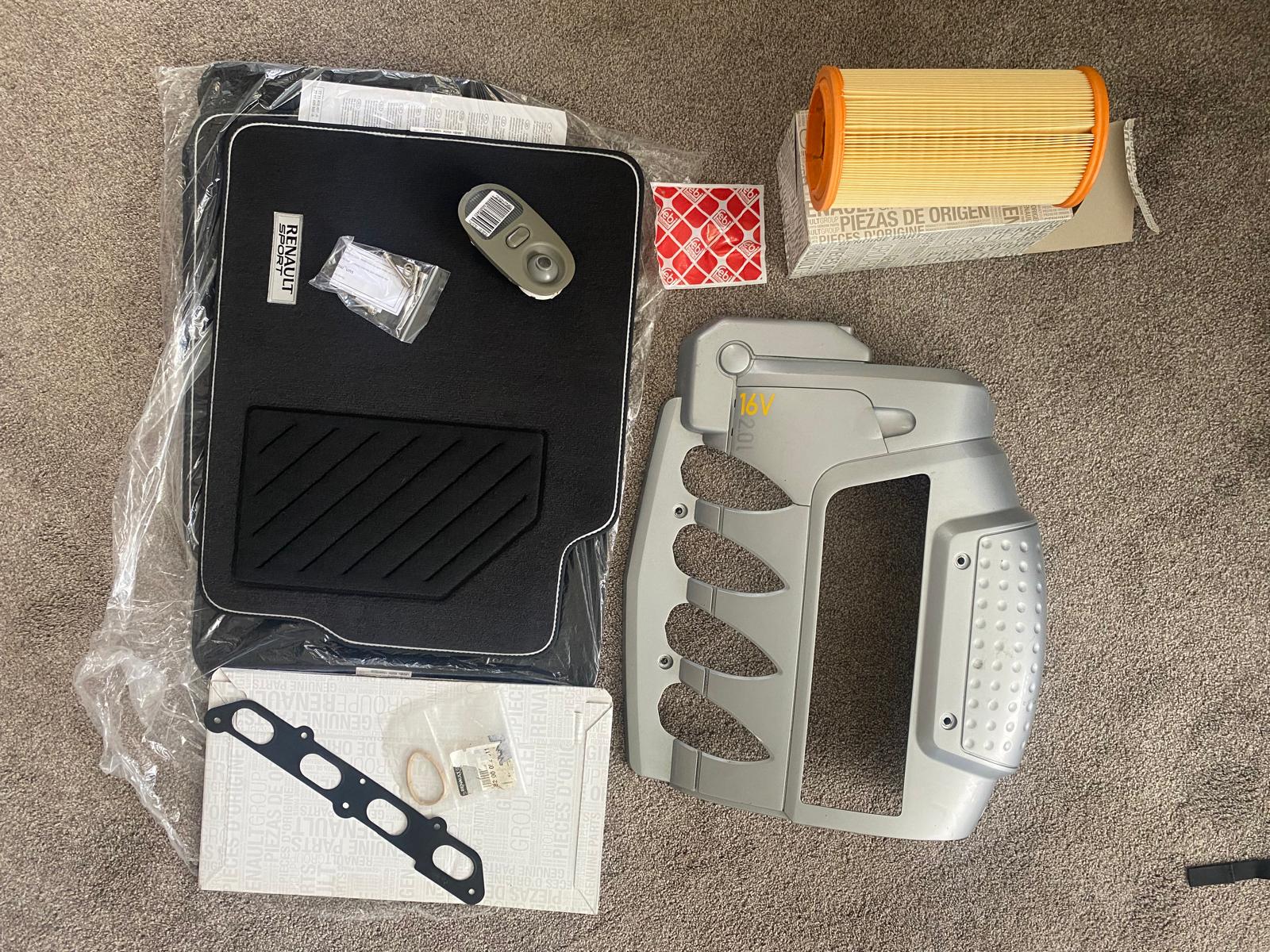

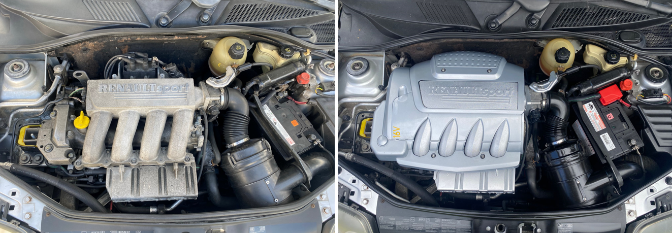

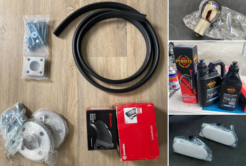

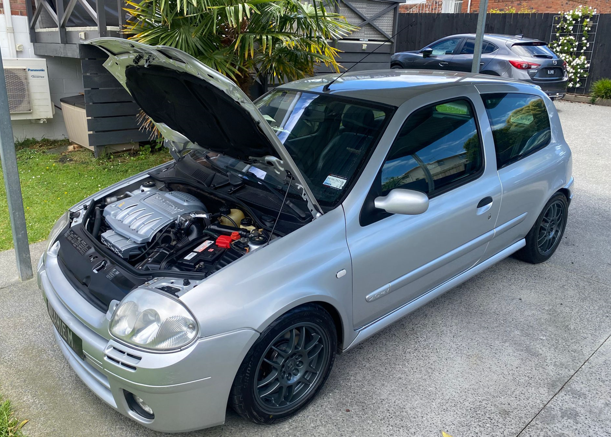

Hello :) It has been a minute since the last update - mostly waiting for parts to be shipped over to NZ
One box has arrived, still a couple more in-transit!
Engine Bay
  1. Deep Clean

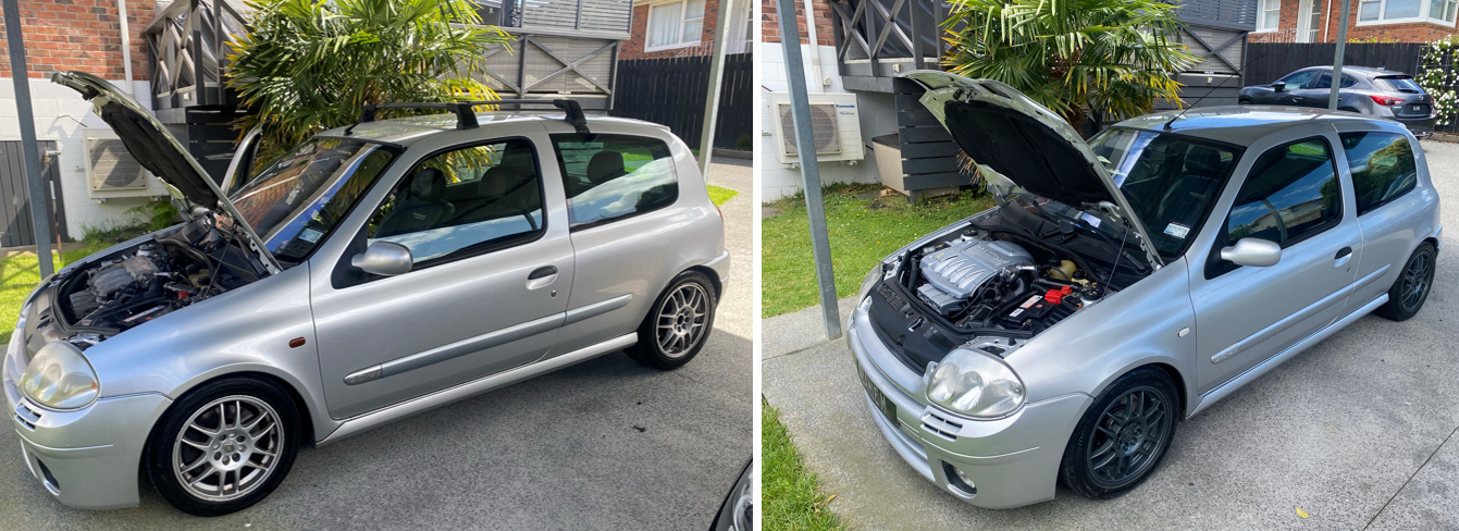

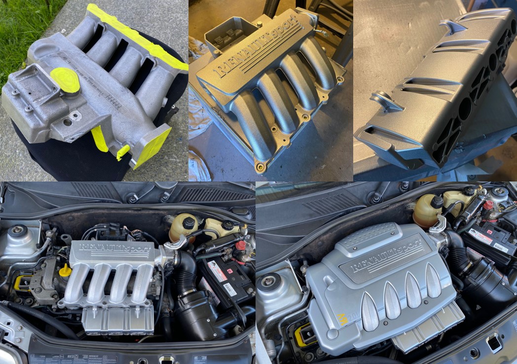

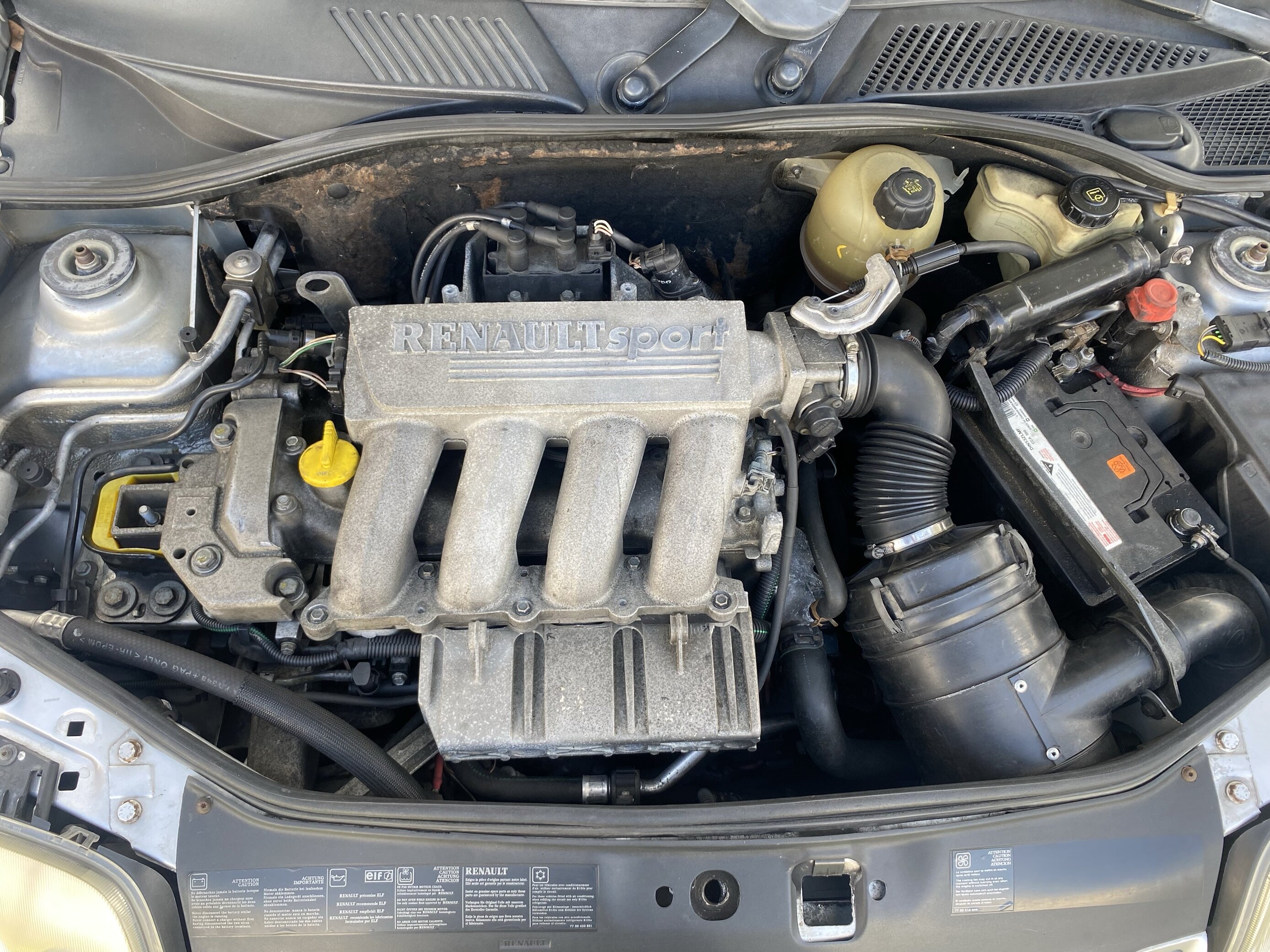

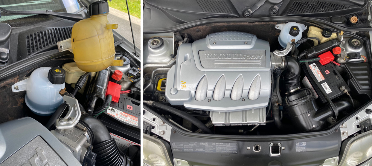

  2. Paint Inlet, Injector cover & Throttle body bracket
  3. Dyed the bulkhead carpet, marginal improvement
  4. Install Engine Cover

  5. Added some RS floor mats

  1. Got some dye to go over the leather seats

Some new parts have arrived
  • Brake pads, still waiting for the discs to arrive
  • Front Bonnet seal
  • 16mm Front spacers & extended bolts
  • 10mm Rear axel spacers (Waiting for discs to arrive to install)
  • Clear indicators
  • Silver indicator bulbs

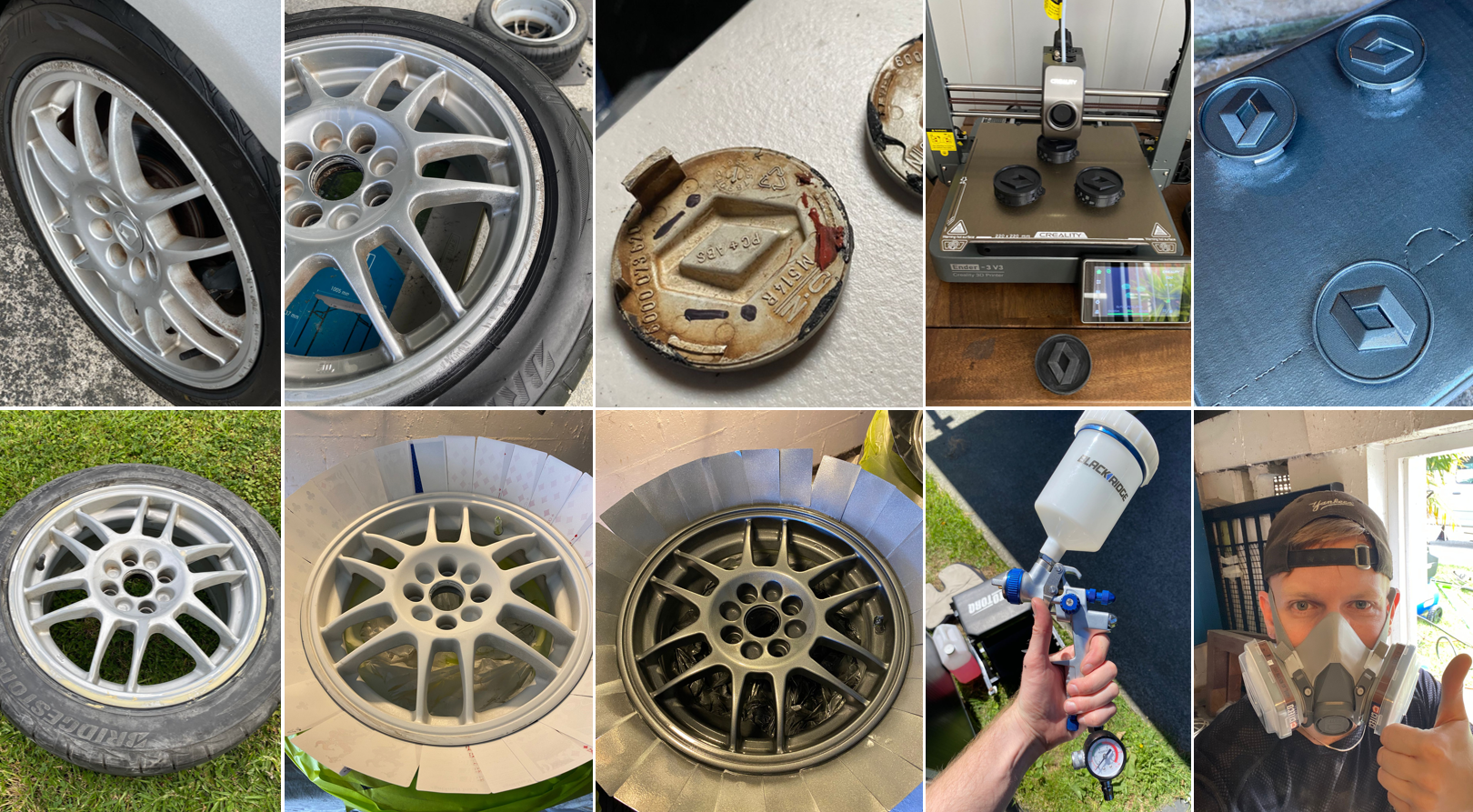

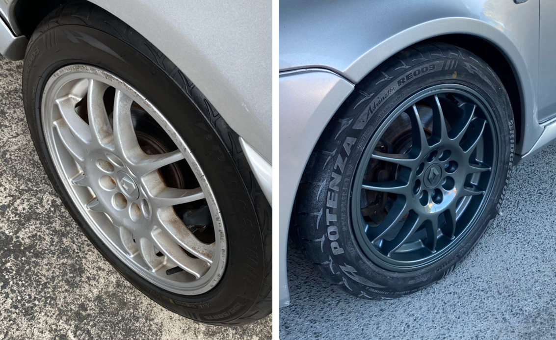

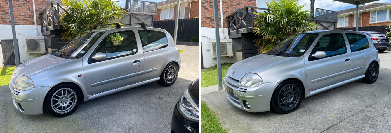

Wheels
In desperate need of a refurb, spent a good 6 hours prepping & removing curb rash and so on. Decided to go with 'Rover Stone Grey' (paint code HNR/690) for now and I'm really happy with how they come out. (Silver & Grey theme, with plate etc) I considered paying the $1000+ to get them done professionally but I'm all about having a crack myself as it's part of the enjoyment for me. So I purchased the paints/materials, air compressor & accessories for $750 and now I've added some extra tools & skills to the toolbox!
I need to clean the tyres, but i'm WELL chuffed with the outcome of these. :cool:
Centre Caps
Like many others, most the tabs had broken on ones fitted to the car (that weren't original anyway) so 3d printed from the file on here.

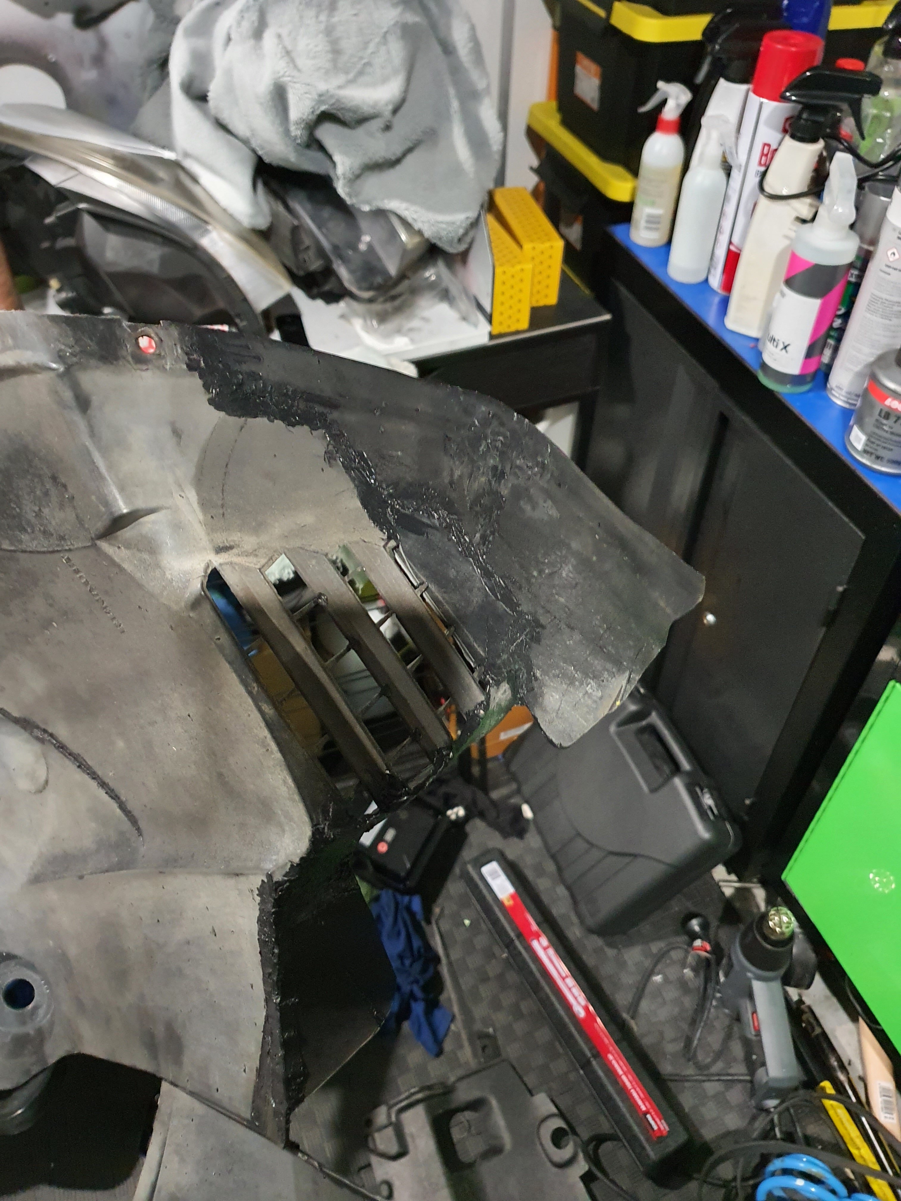

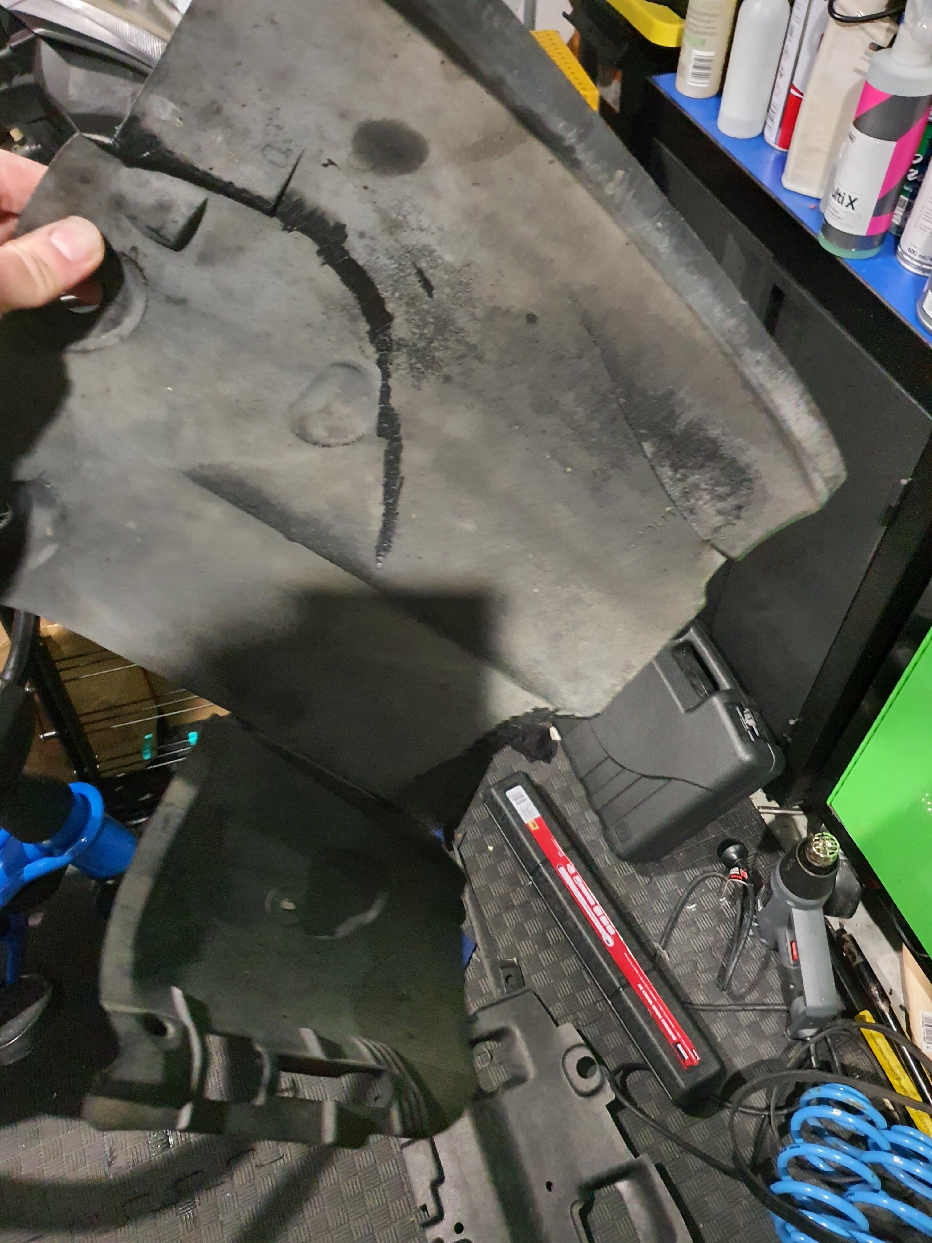

Arch Liner
Car was missing the front right lower Arch liner, leaving the pulleys/cambelt area exposed & helped fill the fog light up with water 😅. As you guys will know, sourcing a replacing is hard, if you can even find one they are mega $$$$. Took some inspiration from fellow member DLX and fabricated one from a Clio 1.2L. (Cost me 25 quid delivered to NZ from Europe which is madness!). I'll will eventually source a OEM one from a breakers but this will certainly do in the meantime, again - happy with how it came out and it's secure AF.

  • Remove seats, clean carpets & re-dye the leather seats

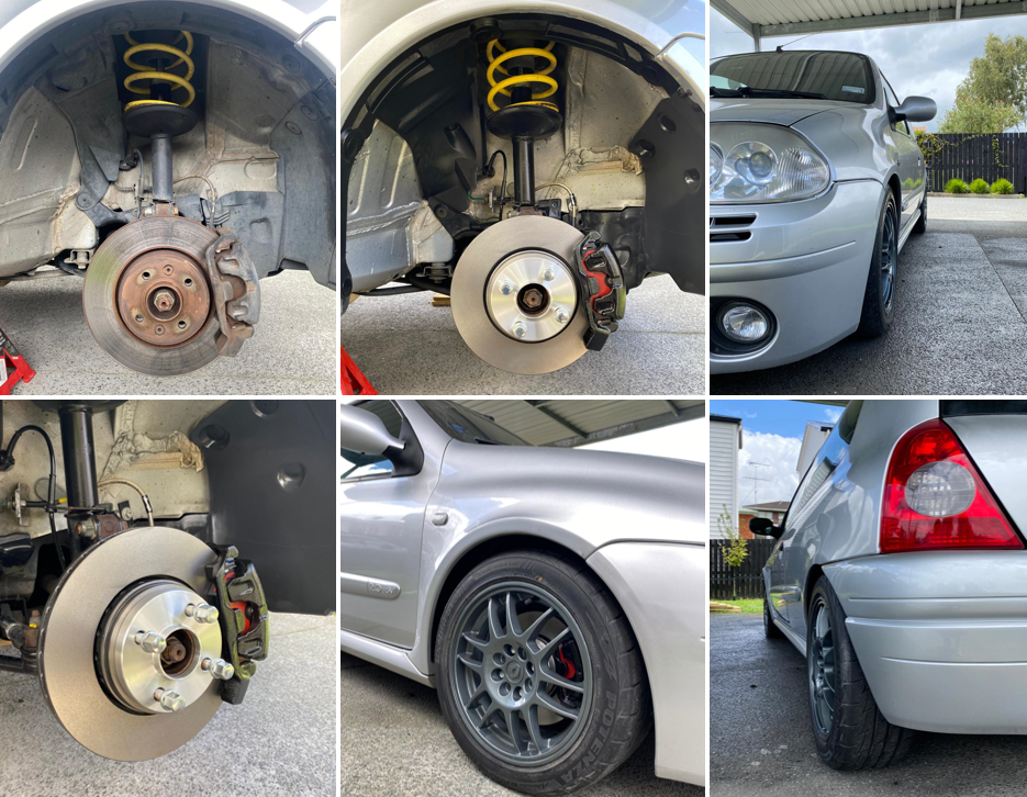

  1. Fitted Brembo HC pads & discs
  2. Fitted the 10mm stub axel spacers
  3. Deep cleaned inside the arches

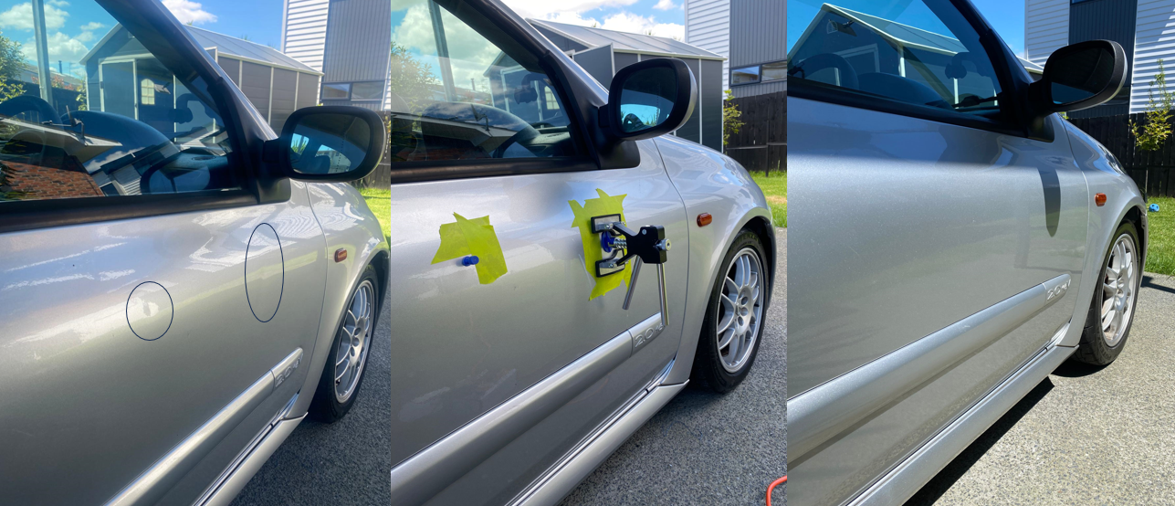

  4. Did some dent pulling, fair visual improvement on some of them

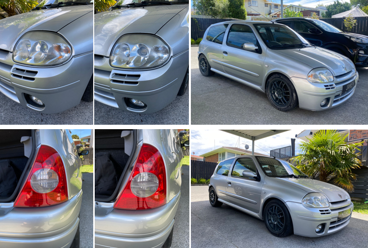

  5. Switched the orange indicator bulbs for chrome to remove that orange tinge
  6. Fitted OEM battery terminal cover (Renault part number - 7701702362 - Batteriepol)

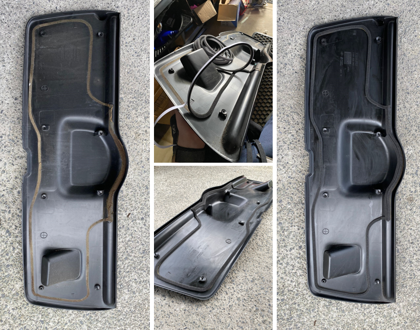

  7. Replaced the foam in the boot trim, 1 particular rattle was driving me bonkers!
  8. Tightened handbrake
I'll post some better pictures once the car is clean, until then.. here's a comparison from day I got it vs today

Exhaust Update
Hated the sound of the exhaust, it was loud, droney, it was overly raspy and crackled like mad to a point I was making the drive less enjoyable. (I'm also getting old!)
Long term plan is to buy a full Ktec/Piper or Pure motorsport system included Decat (This one's been butchered) but in the short term I changed the 10" resonator to a larger one and although it's a bit quieter all round, it definitely sounds far 'smoother'. (I drive it like your Nan, I aint concerned about impacts on performance if any)

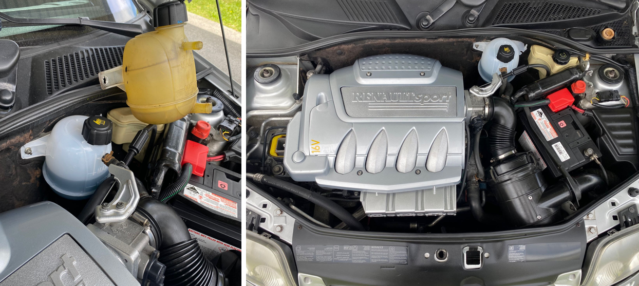

  • New coolant tank & coolant flush

Thanks Simon, appreciate the comments mate
I understand the preference for silver wheels & original side strips - I have the front side strips & will source the rears just to give it a try.
Even though I'm really happy with the grey wheels, there is no doubt in my mind they will be silver again someday in the future! (Easy to do, given i'm a professional wheel painter now - Joke! LOL)

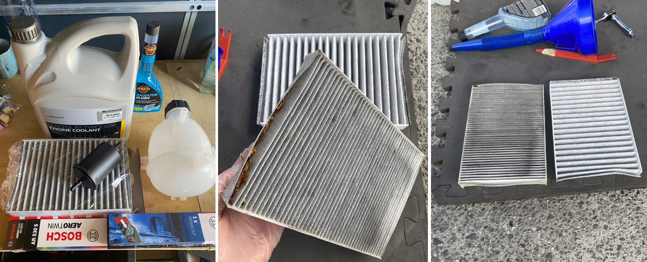

Minor service update

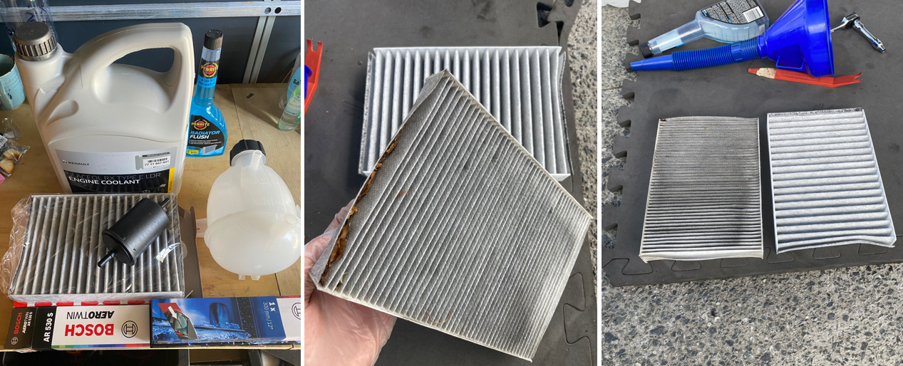

Last of the service bits done, changed the Fuel & Cabin filter along with a coolant flush & installed a new coolant tank
Essentially all the engine serviceable parts have been done now & really happy with the engine bay, some day i'll get to that black carpet heatshield but it can wait for now

PS, Coolant flush tip - There is heaps of information on here on which steps to follow.. but less common is mention of ordering yourself some 'Hose Clamp Pliers', not a must have, but they make all the difference! (Doesn't need to be an expensive set either, mine were $10 from aliexpress and they worked perfectly!)
