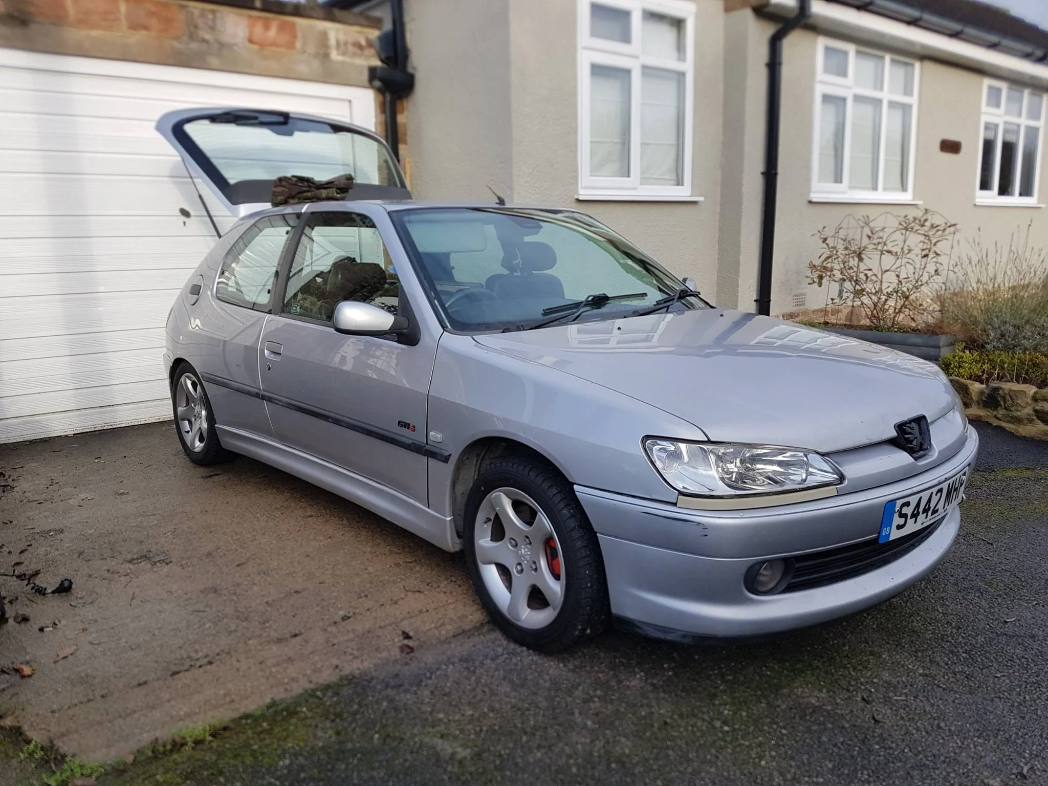

I sold the car in 2012 and for various reasons didn't see a way back into motorsport for some time and I was right. A few years ago I moved nearer to Leeds and to just down the road from Harewood's Hillclimb course. I'd been to spectate there several times and know some of the marshals so decided to have a look for a Clio 1*2 that I could run as a daily, but also compete in the road-going class in hillclimbing. I had just sold my EP3 (yes, the 1*2 is a better chassis, but I prefered the EP3 as a package). A really cheap Mk1 Focus came up locally so I snapped that up for a daily and in December 16 spotted a project car that I'd never owned before but always had a fondness of - particularly as they were out in BTCC whilst I was first getting into it in the early 00s (hence the EP3 ownership too!)

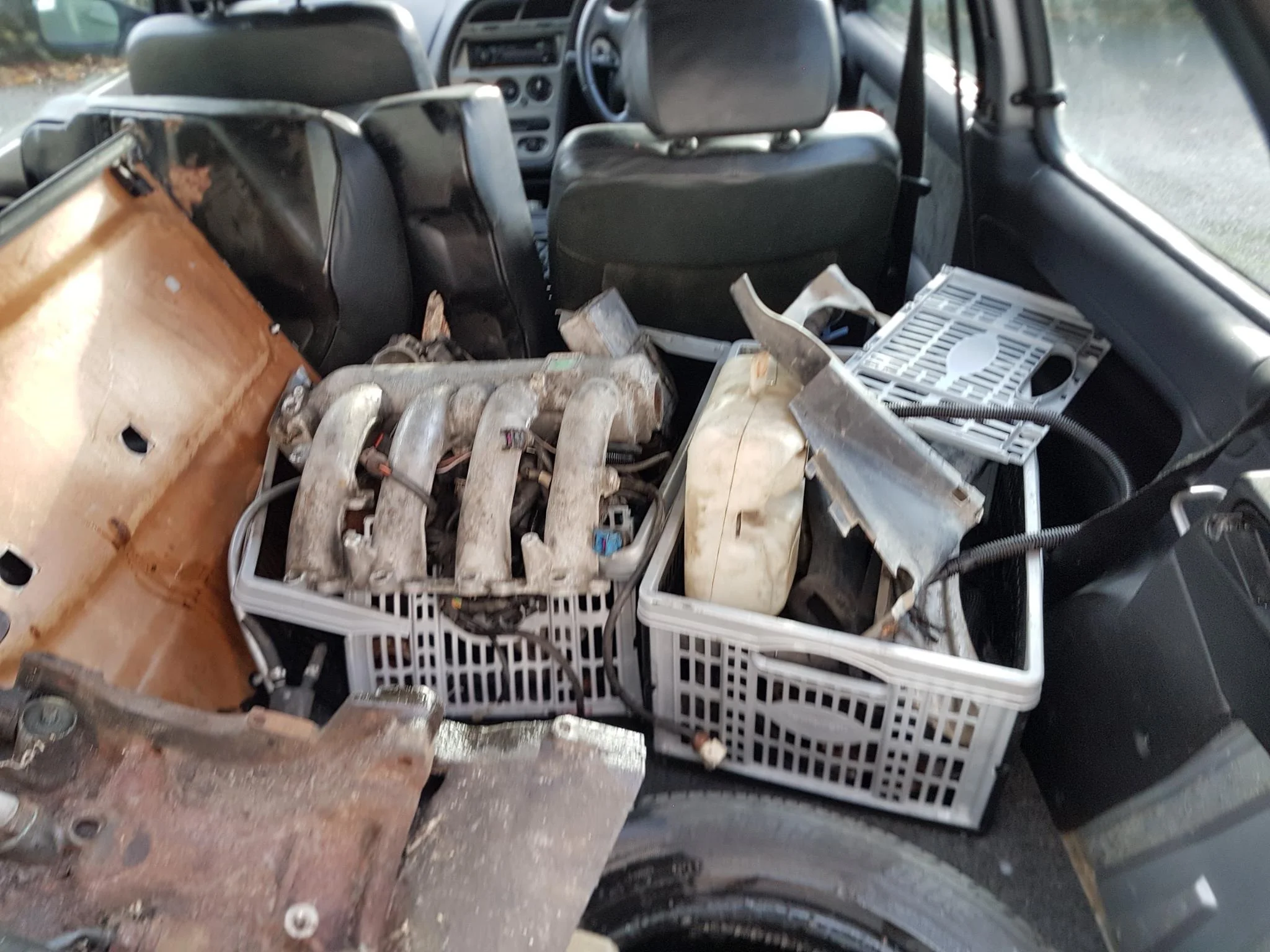

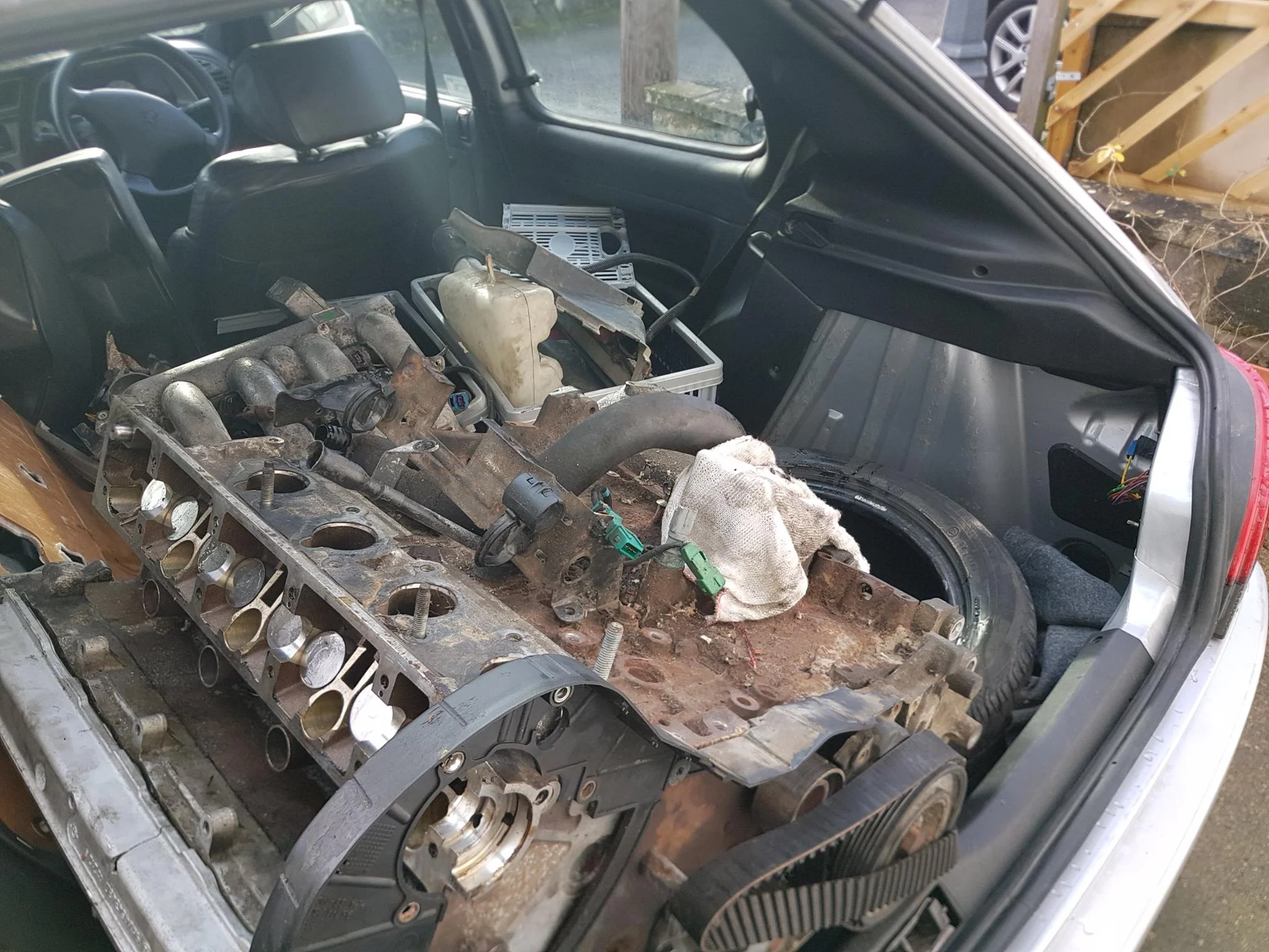

So I exchanged just a few hundred notes for an ok-ish-looking Peugeot 306 GTI6 from a local guy who had bought it as a project and ran out of time/money/enthusiasm (or had found everything that was wrong with it!!). It had stacks and stacks of spares that filled the interior, including most of a spare engine in the boot. I drove it the 4 or 5 miles home and it was sketchy as anything - the brakes were shocking, the suspension creaking and moaning and some worrying vibrations! I eventually got home after a pitstop for fuel as the fuel light was on and the gauge was at the bottom, so didn't want to risk running out. On fresh fuel, some of the vibrations were gone.

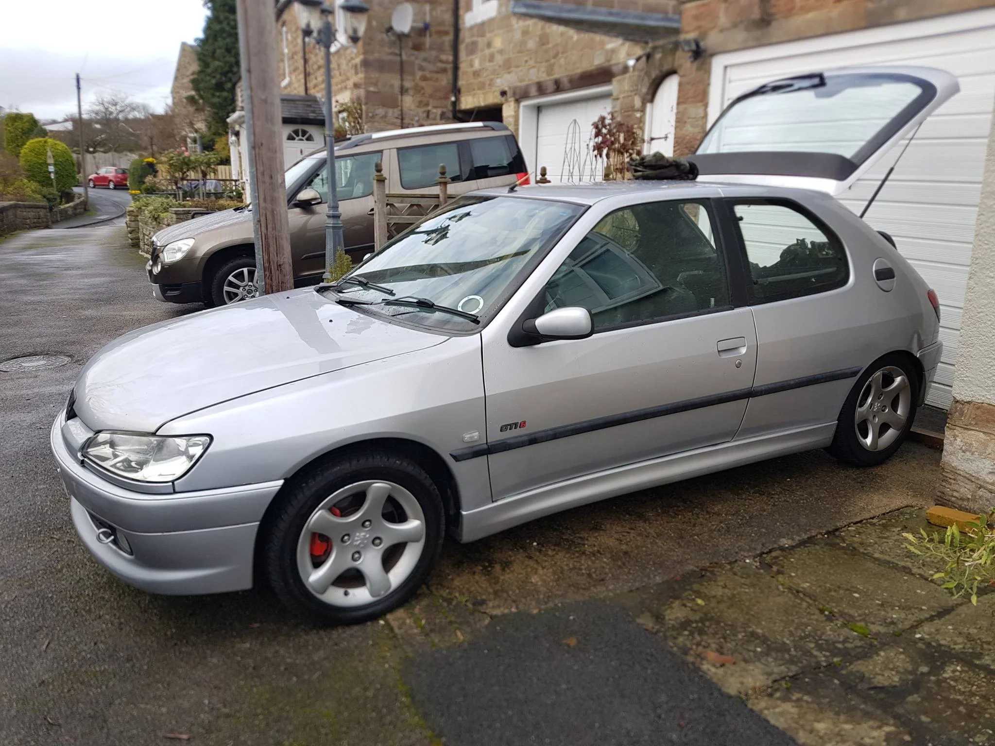

This is how the car looked after I parked it up on the drive and started to draw up a list of what was needed!
Lots to do, more to follow!

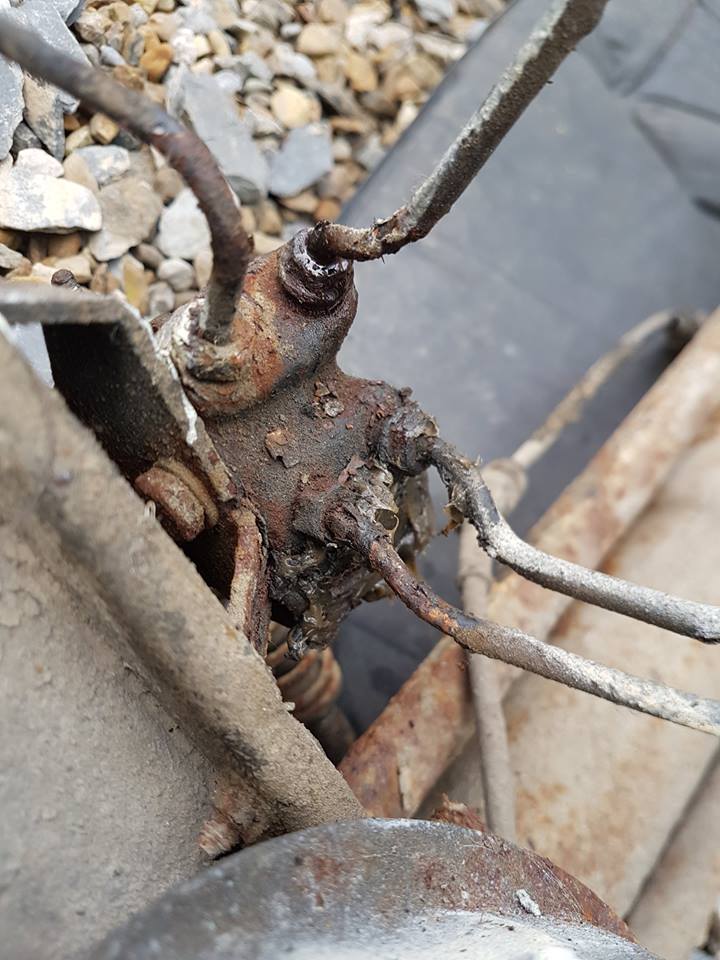

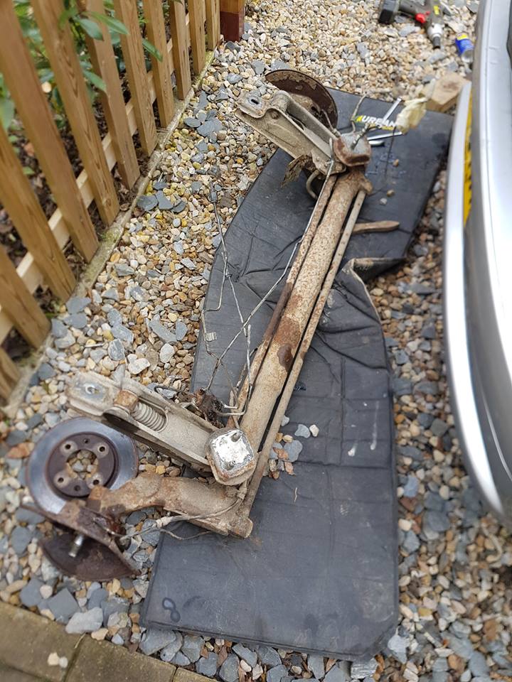

Quickly realised that the first thing that needed my attention was the rear beam - it was hanging (in both senses of the word). Pig of a job to do, every bolt was seized and rounded, so cut just about everything off, including the brake pipes which were about as porous as Spongebob Squarepants.
Had some fun removing the rear hub carriers...

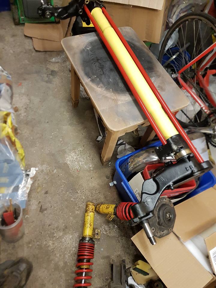

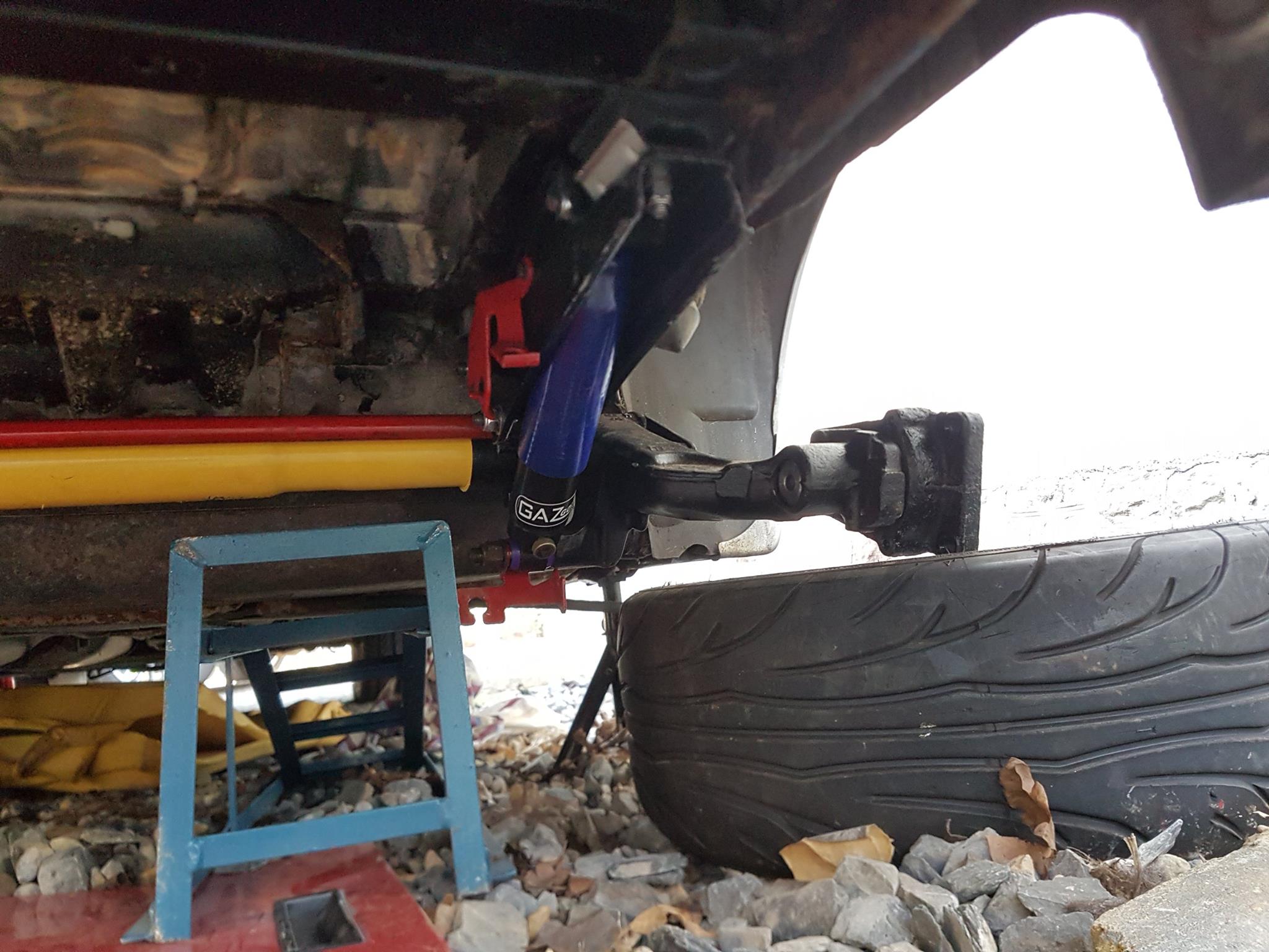

Looking at the state of the braking system next it was all awful too. I only have a handheld brake flaring tool, so didn't fancy making up hundreds of pipes - after a quick check of the regulations I started ripping out everything in the braking system - pipes, flexi, compensator, ABS, loom, the lot. Refurbished rear beam turned up along with some adjustable and firmer rear dampers.

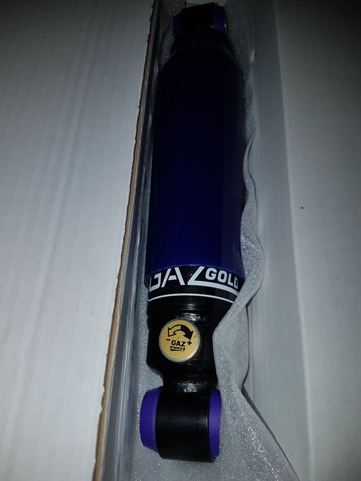

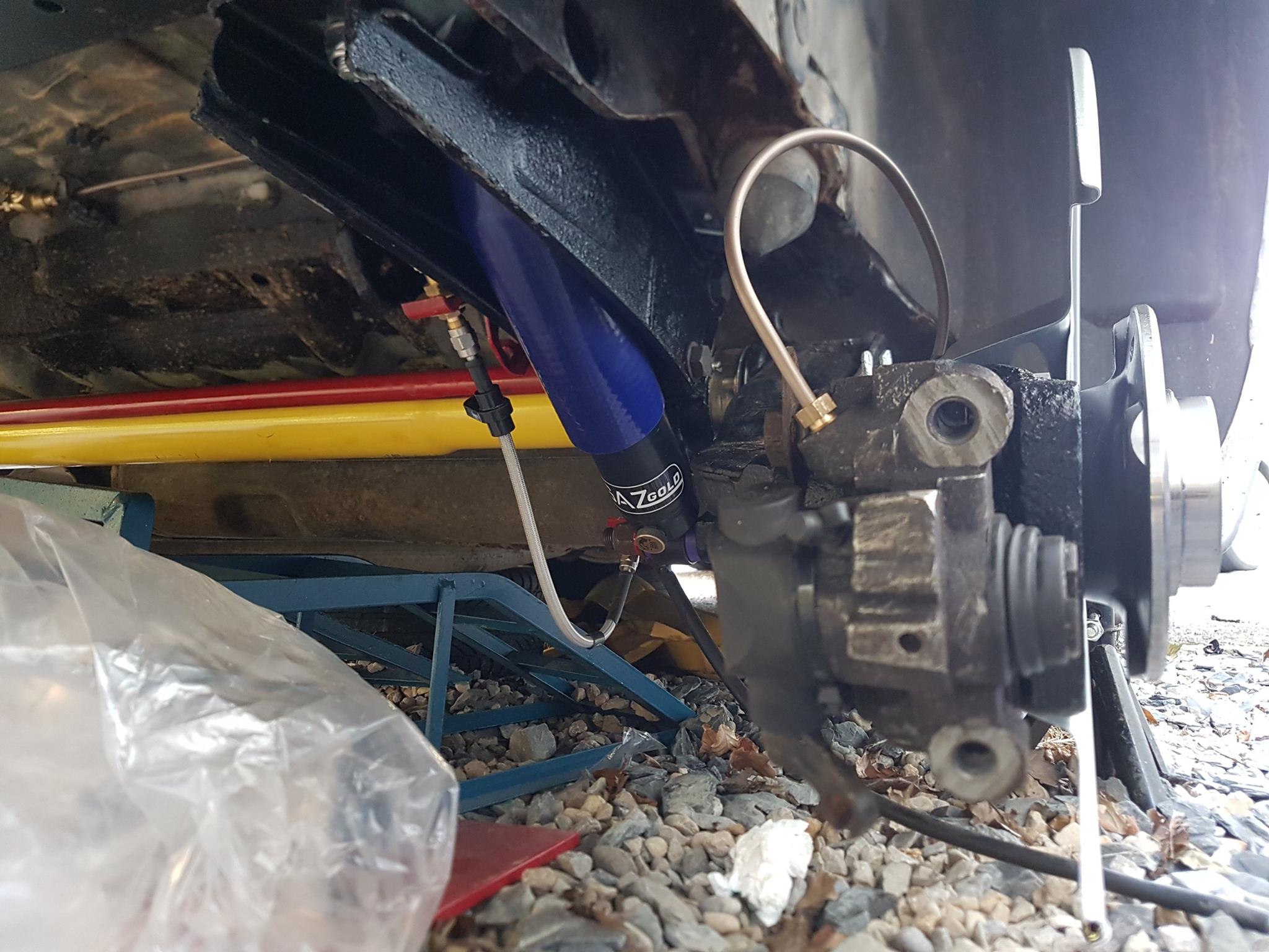

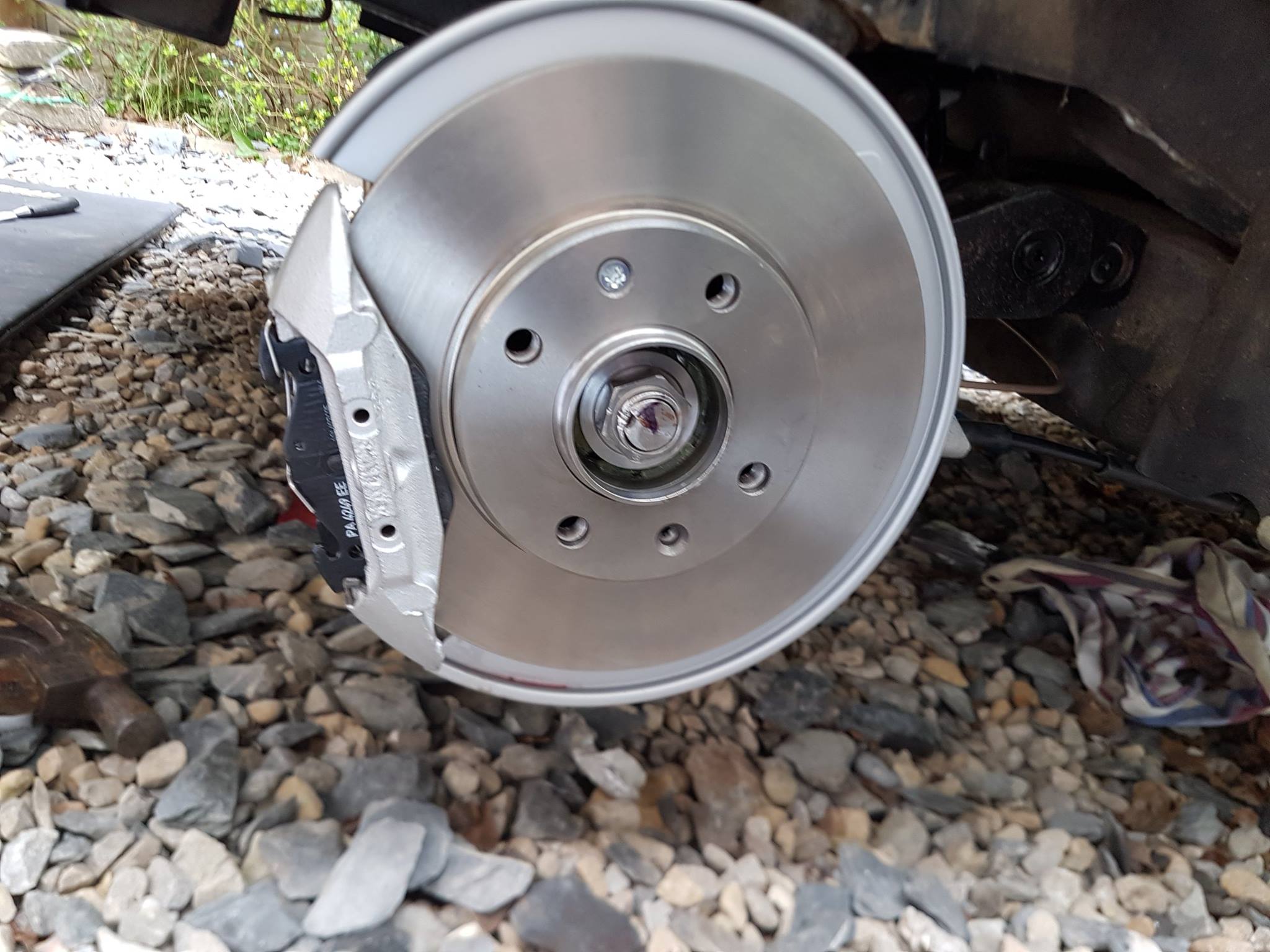

and got those installed which was easier than I thought considering I was on my own. Also added near rear hubs, discs & pads with some braided hoses..
Car now passed the shoe test..

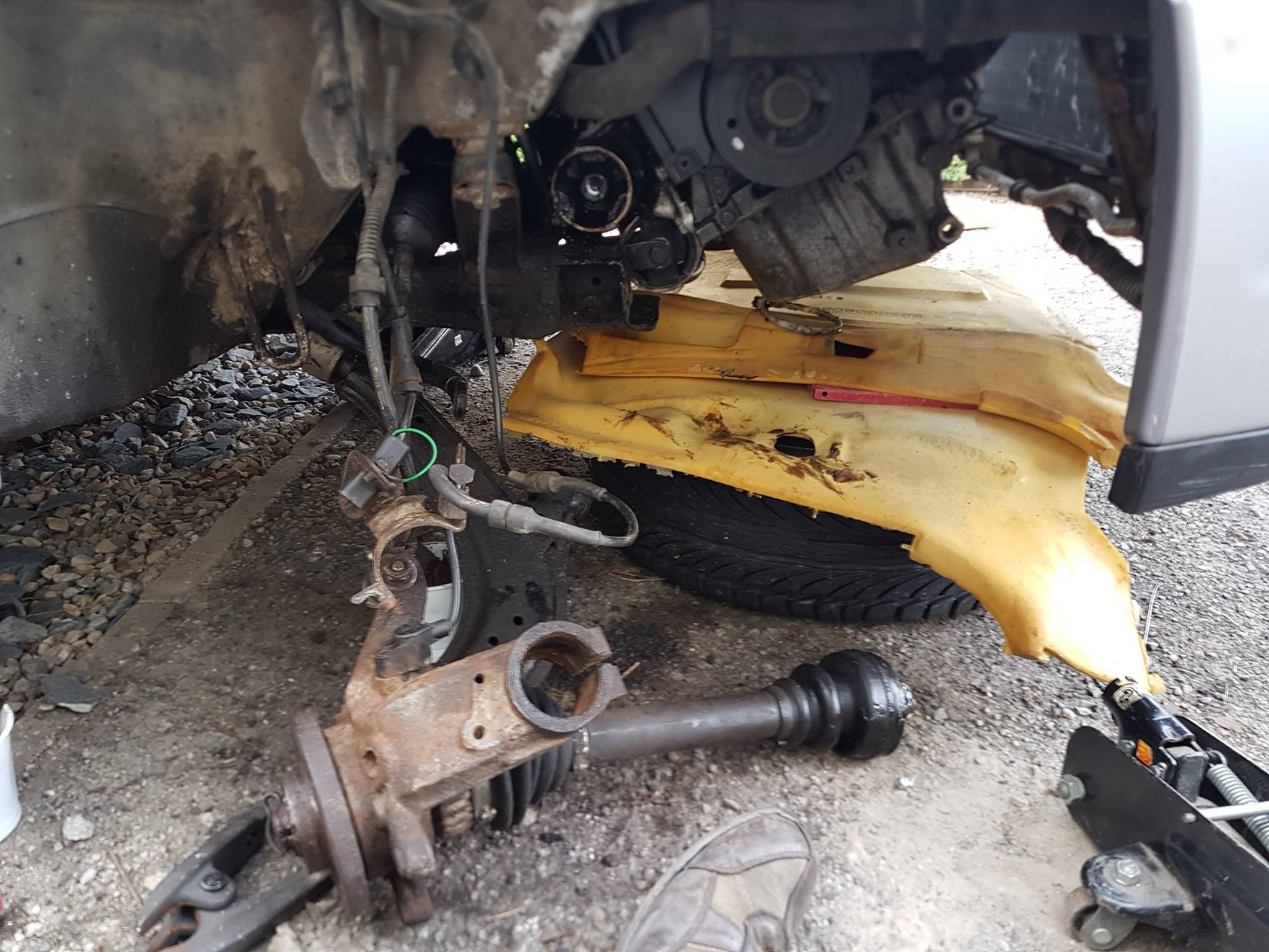

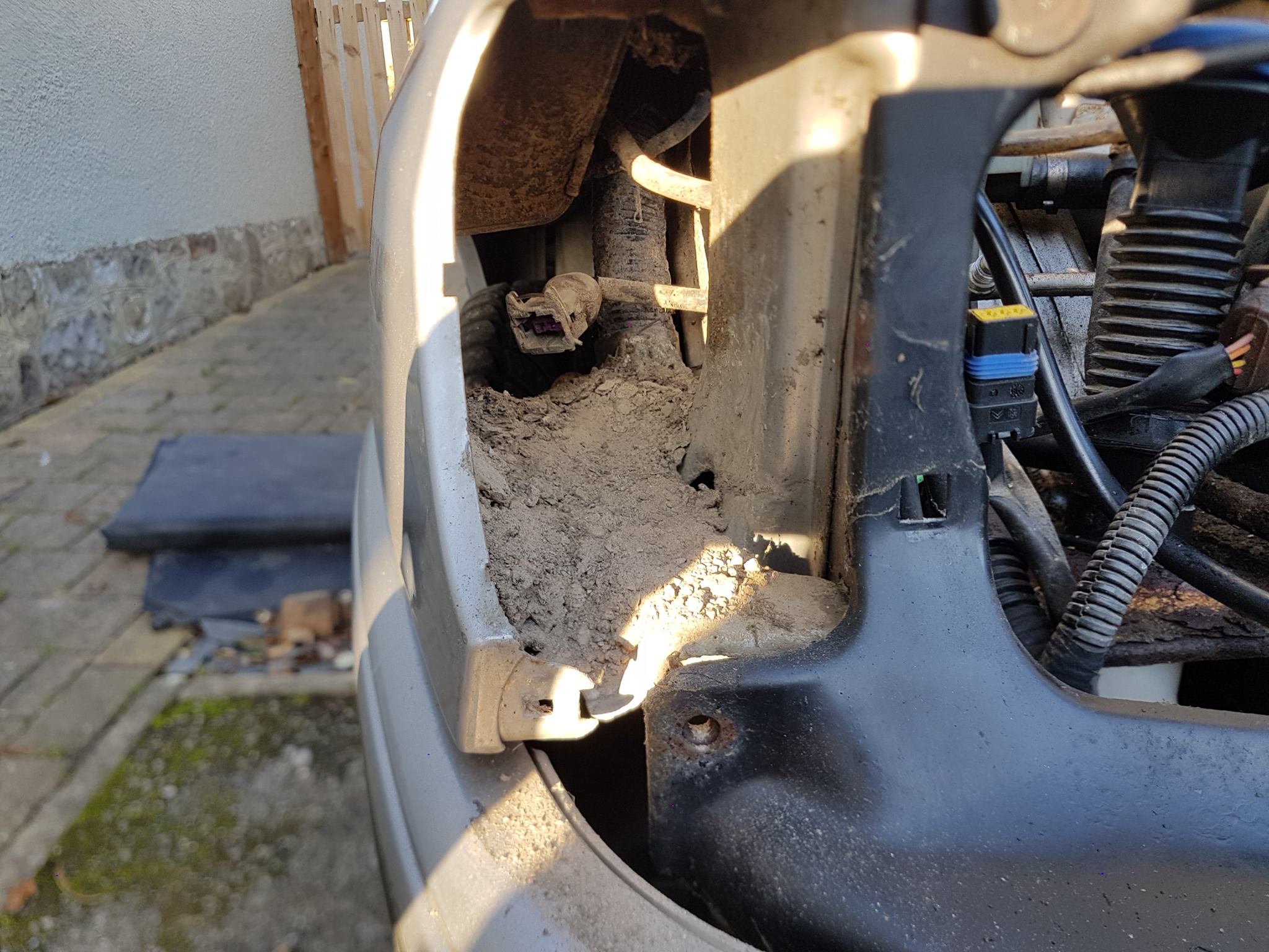

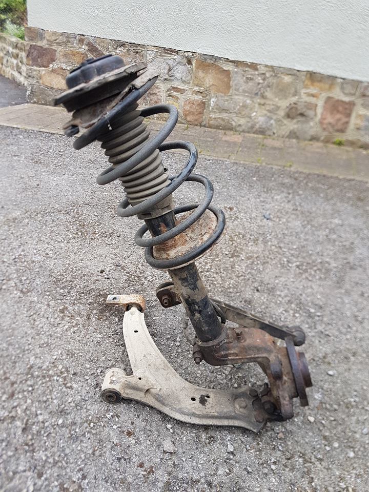

and it was time to start on the front - this is where things got interesting. I was sure that if every bolt at the rear was seized and rounded, then the front would be just as bad. I was wrong - every fastener at the front had been undone recently and was hand tight. After I jacked the front up, the damper near enough fell out of the hub. Had the front corner apart in no time to run the new brake pipes and fit some very second-hand Spax coilovers. I think these will be sprung too softly for hillclimbing, but I'm not sure, so going to run them for now and see - will probably upgrade to Gaz Gold fronts when I've got a few events / trackdays under my belt. The driveshaft fell out too when the front end disintegrated.
The nearside came off in one piece which was handy.

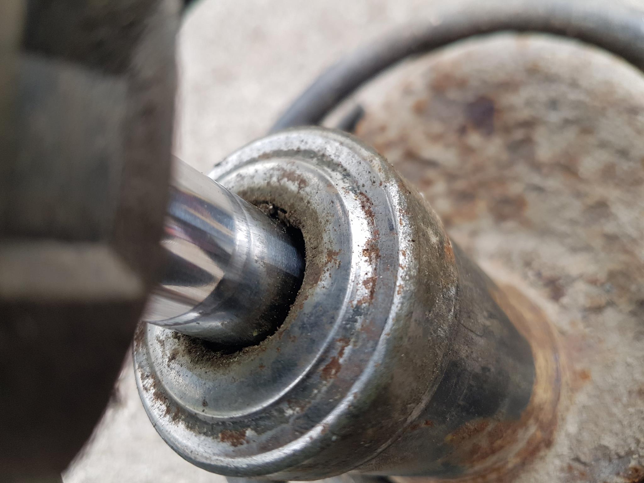

Dampers have seen better days..

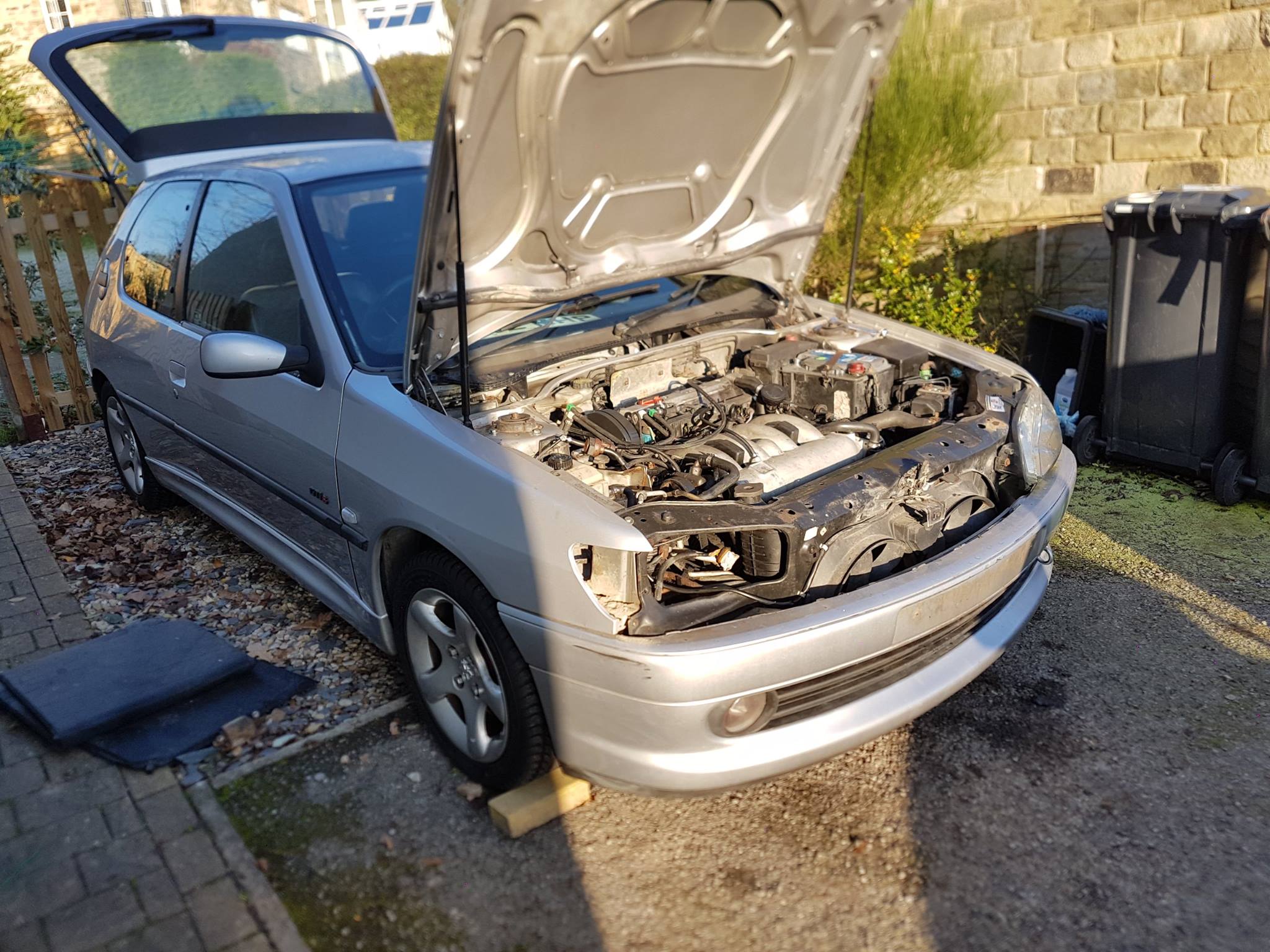

Set to work ripping the front end apart to treat some rust and attempt to do the timing belt in situ...
An idea which didn't last long...

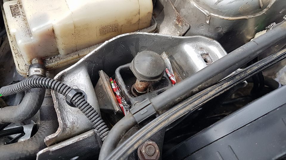

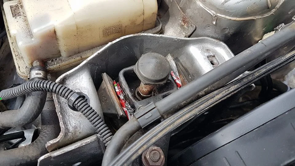

Had some running issues again in the afternoon, plus a wayward engine mount was causing the engine to move around far too much - bodge fixed with some folded up coke cans!

Pretty much a year later - since the above rounds fitted solid rubber engine mounts, Quaife ATB LSD and swapped the rank Spax RSXs for some Gaz Golds. The car feels a lot better setup now, just having some shifter issues which I'm hoping to sort in time for Round 2 in May.
