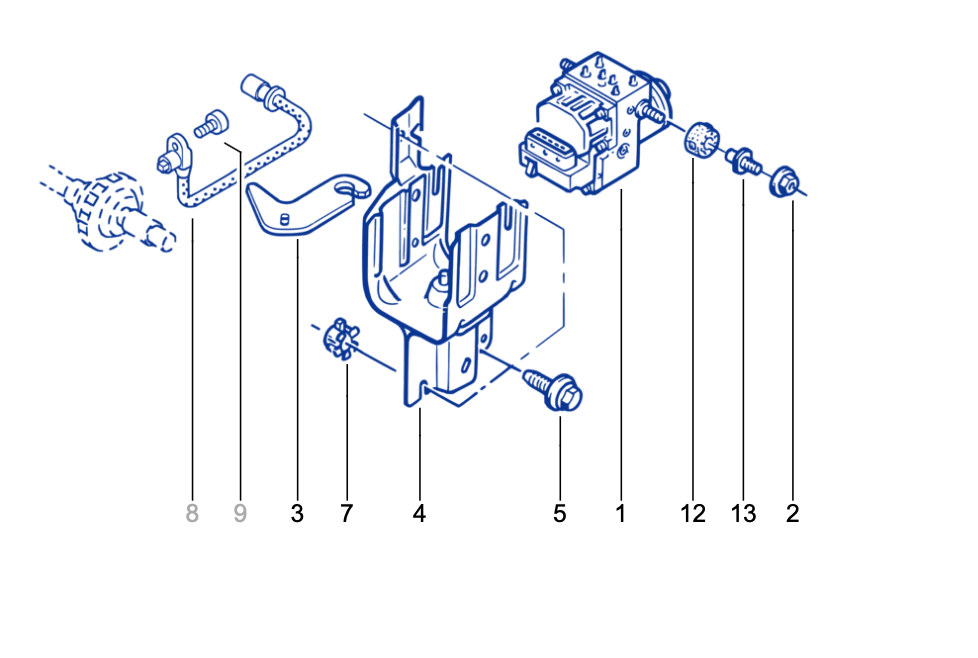

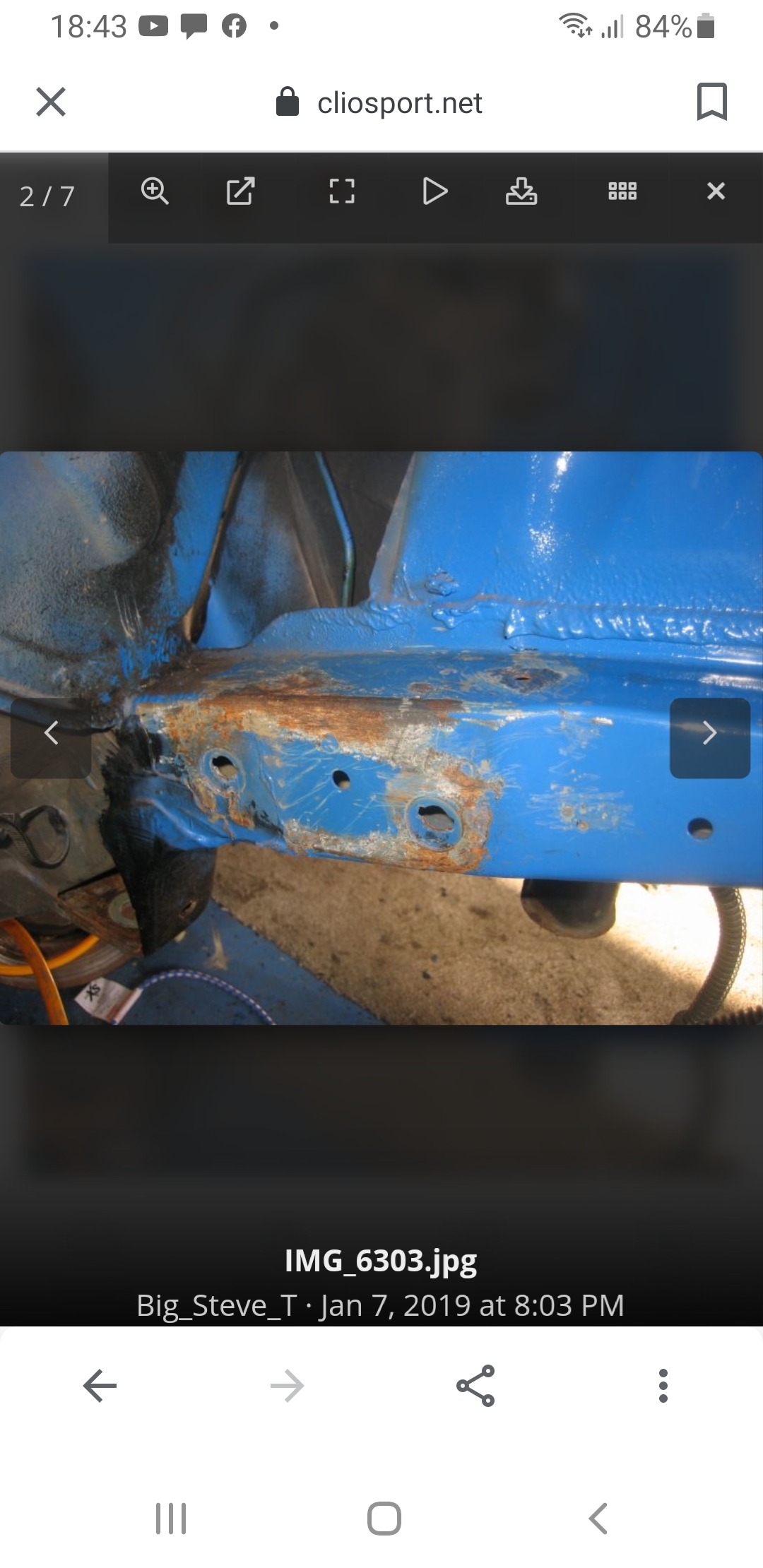

I need to fit ABS pump and it doesnt have the cage nuts in the body for the bolts. Any ideas what part number might be for these ?
Not my car but showing location
Im guessing you are looking for Item number 5 & 7
Item 5 - 7703602282 SHOULDERED STUD M8X125 8.8 - £1.81+vat Each
Item 7 - 7703044174 CPTV NUT M6x100 - £1.89+vat Each
