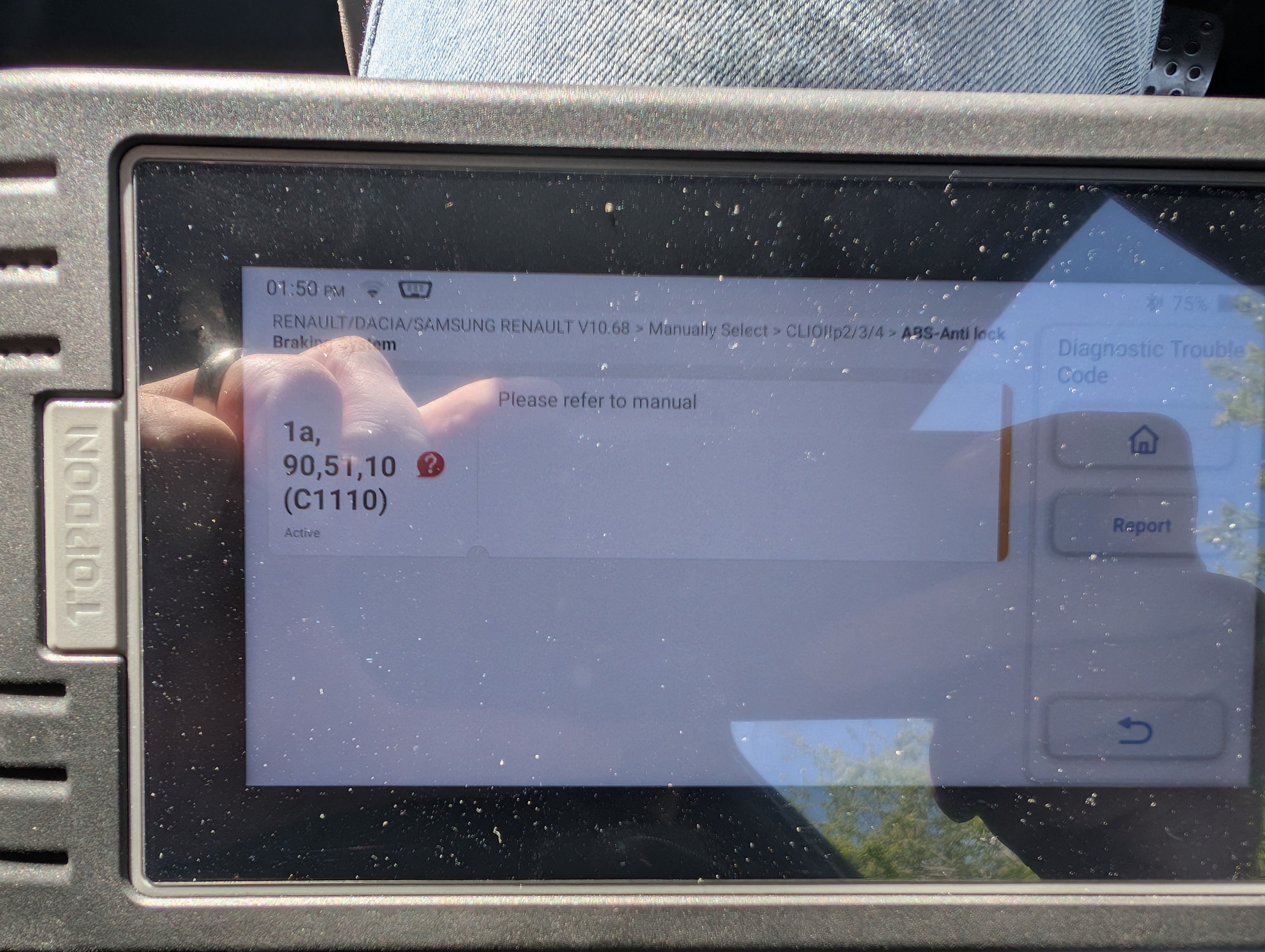

The RB I picked up about a month ago had a host of issues initially, which I've mostly sorted now.
The alternator cable snapped on the drive home, killing the battery, and causing a number of issues. But on inspection, the driver's front ABS ring was snapped, and the gaiter was split, so I installed a J&R drive shaft and fitted the wider ABS ring that came with the drive shaft.
This cleared a few issues related to the ABS system, but I still have the error code C1110, and there doesn't seem to be any record of this code coming up on the forum when I search for it.
I've read the live wheel speeds, and they seem to be working correctly, with small deviations in speed in each corner for cornering etc. Though I did notice the speed was registering 0.32kph at all 4 corners when stationary.
I've just checked the ABS fuse (location 10), and all looks fine there too. Though I swapped the fuse over with location 11 to double check
Has anyone come across this before?
