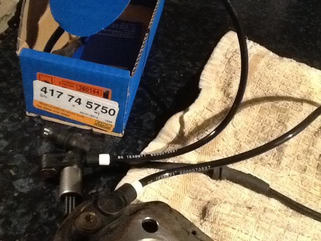

Renault only iirc, was told by MicKPM at Diamond Motors not to buy from eBay or anything as they arent the right ones...
  Renault Clio RS182
The euro car parts one (bosch) comes with a female electrical connector instead of a male, and cannot be secured into place as the connector only fits in upside down :-/ I'm not sure how they actually get away it tbh

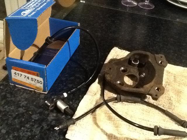

RUK part works perfectly (and lasts) or you can buy a complete used rear hub and swap that over (as the sensors never come out intact)

Just a quick update for people searching this, the eurocarparts one does fit, even has the same renault part number on it.
this is the near side rear:

Make sure you get the right sensor in the right hub because once they're in they ain't coming out again lol
Short length = NSR
Long length = OSR

Personally I use an impact wrench with a decent T30 but one I did yesterday didn't want to play and spun so I had to turn it into a T40 which worked.
Failing that use a grinder on the head and a stud remover on the rest and replace the screw (not that you actually need the screws cos it's a TIIIIIGHT fit)

Don't break the cast by hitting it hard... you won't get one anywhere for a day or three if you do.
