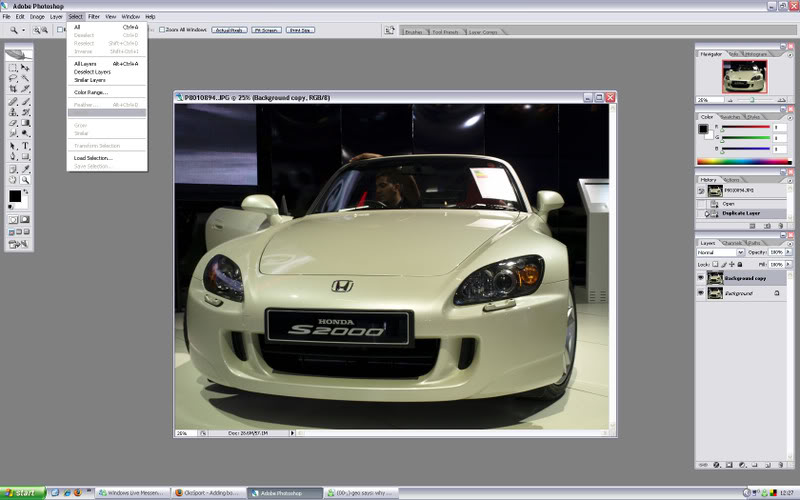

I've tried that, but the Modify option isn't highlighted so its not clickable... what am i doing wrong?
Have you got the layers box open? Generally if you just open a flat jpeg it will be a locked layer.
Right click the layer in the layers box, select "Duplicate Layer" and then try it, it should work now :)
