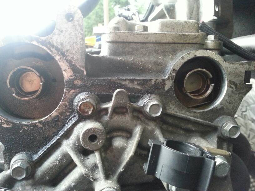

This is how the cams are sitting at TDC.
If someone can tell me that angle will definitely knacker the valves, then I'll skip straight to removing the head. Estimated at between 10-20 degrees out.
If not, I'm going to re-time with a new belt and crank it over (pending advice on below), if not I'll fit a new dephaser and see if it's any better. Probably compression test from here and move on to finally replacing head/engine.

Actually ignore that, it's the belt assembly that slips right, not the cams.
Does that mean your crank would have gone round a fair bit further before the belt stopped slipping for it to be out 'backwards'? Hence the damage to all 8 valves?

Think the best bet is to get the head off and check if all the valves are sitting flush. I did that as a precaution when my belt slipped on the 1.2, found 6 bent valves.
Yeah I think this is the best bet. I'm borrowing a endoscope to check out the pistons. Least that will tell me how bad the damage is if the valves are knackered.
you need to get a vac test done on the head, stems can also double bend so the valve will shut fully but not actually seal.
If you say it's because the aux belt has wound into the cam belt and caused it to jump the timing then strip the timing belt off, remove all signs of debris, get a new gates kit and reset the timing like you say, you may be very lucky!! You only need to assemble it as far as getting the crank pulley back on to test the engine, don't go pulling the head of before you have tried it. Fingers crossed for you :)
