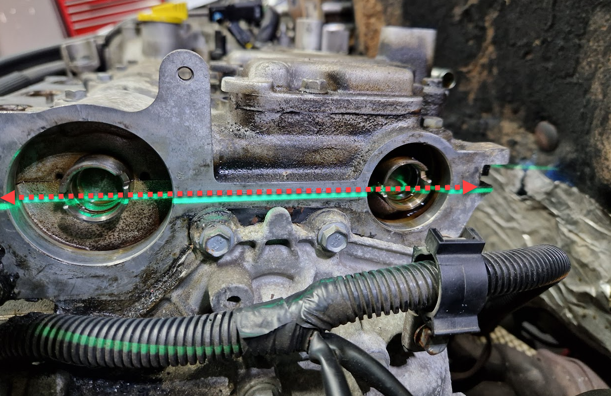

Crank locking pin is in, clearly the horseshoe tool isn't going in there :confused:. It runs but quite lumpy, then at 1700rpm when dephaser advances it sounds like a 1990 french derv, unplug the dephaser that symptom stops.
Assume the noise I hear when dephaser advances is the valves clipping the pistons and will have likely damaged bottom end, how much clearance is there in these engines?

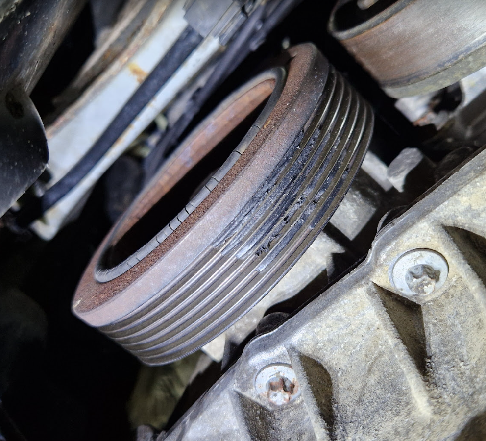

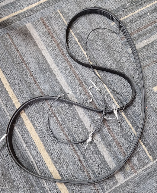

As to how it happened, Bedford track day on Monday breaking into hair pin just before the pits and hear gravel like sound, coast into pits. Aux belt less than 12 months old and all pulleys new also at same time
Looks like lump of tyre rubber bounced up through small hole in the lower wheel arch liner under valance

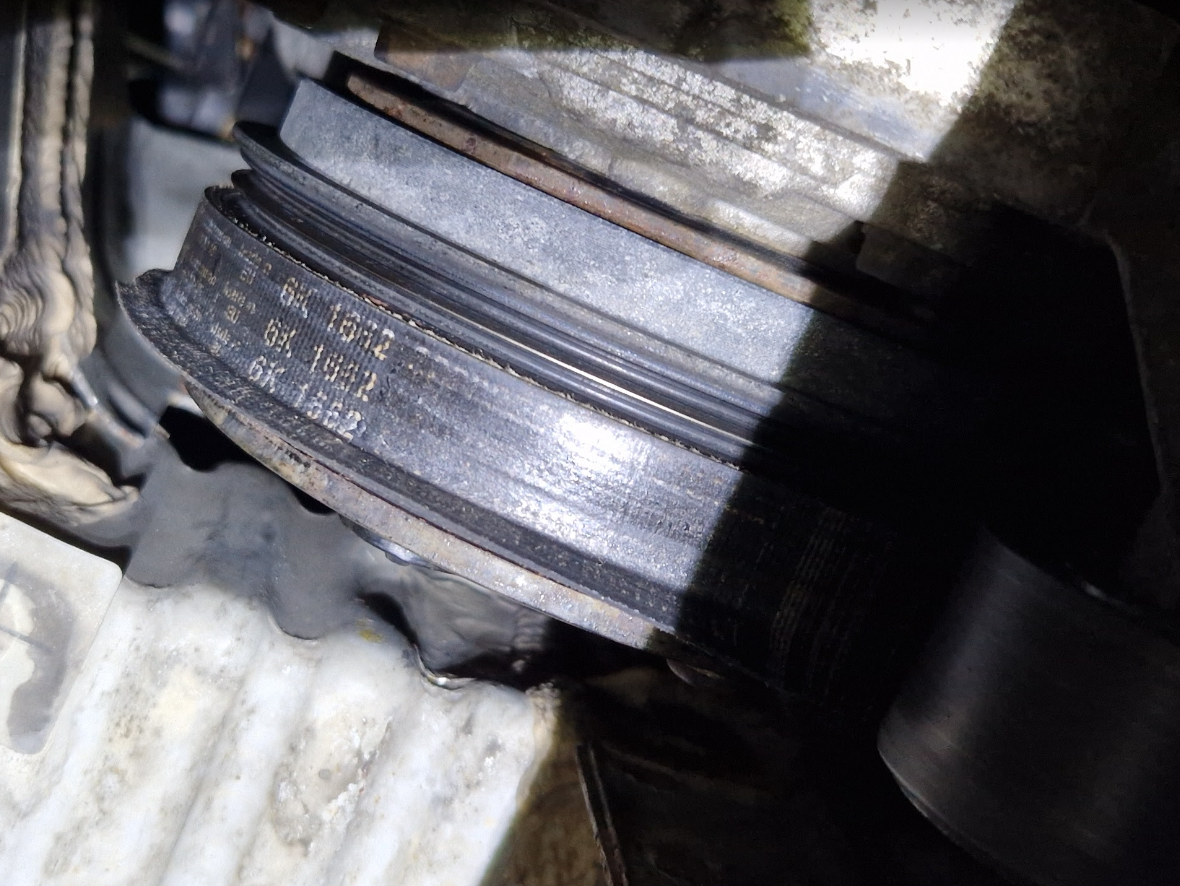

This jumped the aux belt that sliced on the AC compressor pulley
and then wrapped all the trimmings round the bottom pulley jumping the cam belt I suspect
The noise like gravel at about 3sec was the aux belt going, squeal is the CL6 pads
Advise on likely damage appreciated

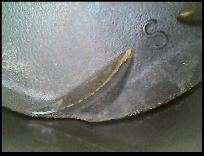

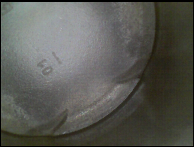

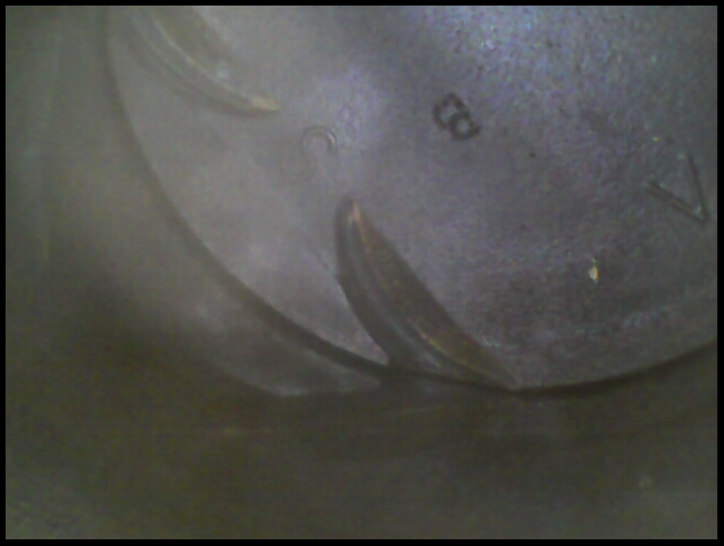

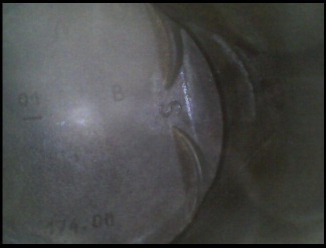

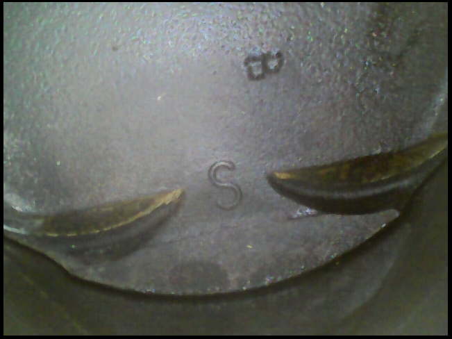

Borrowed a bore scope this afternoon and as follows
Exhaust side of pistons lovely and black, all look just like this
Inlet valves.... Cy4 & 3 have two small silver marks
Cy 4 seems to have the worst damage assuming the silver is a small clip on bottom left valve cut in piston to

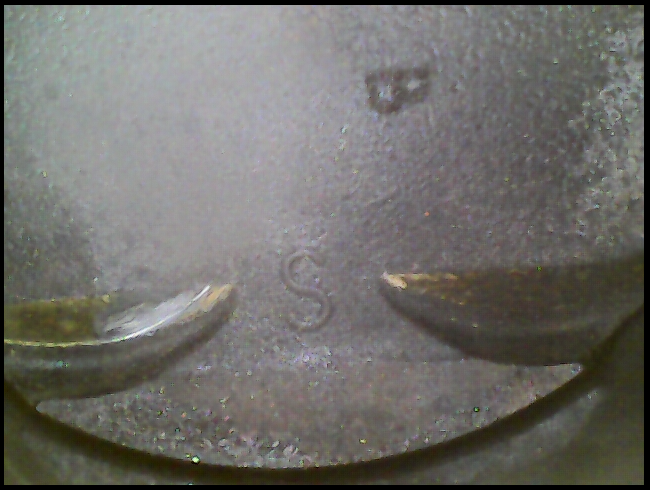

Cy3
Small hit bottom left valve again but to right edge
Cy 1 and 2 dont have sliver but assume the slight yellow discolouration is the valves just glancing the surface of the pistons taking the carbon off?

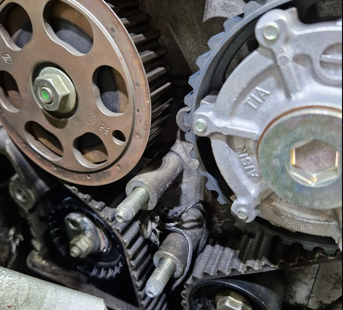

Update and found the real root cause... not track debris

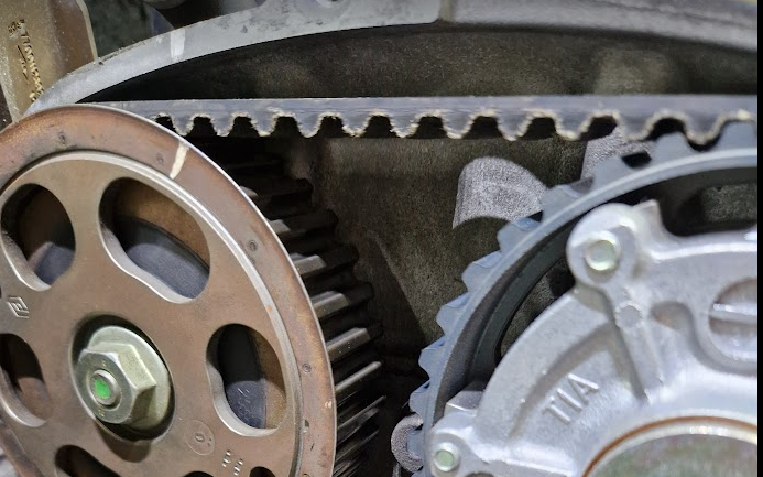

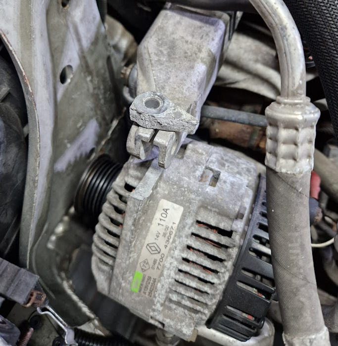

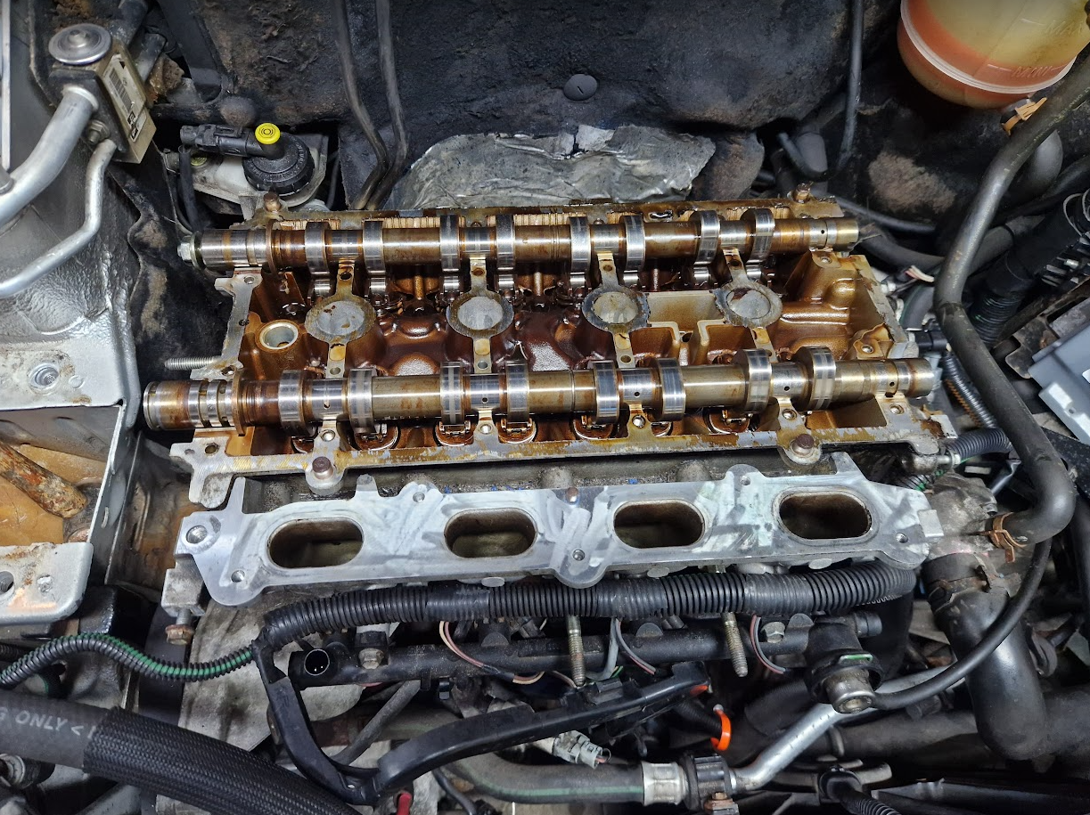

Got genuine Renault timing tools delivered and started the strip down, upon stripping cambelt covers off there was aux belt bits everywhere, they really do try and rip the cambelt off when they fail
Then found top alternator lug broken off, this is clearly what threw the belt, thought that breaking was odd. Then went to undo the bottom bolt to remove it and..... it wasn't there completely gone, just some nice witness marks where it had been bouncing around.

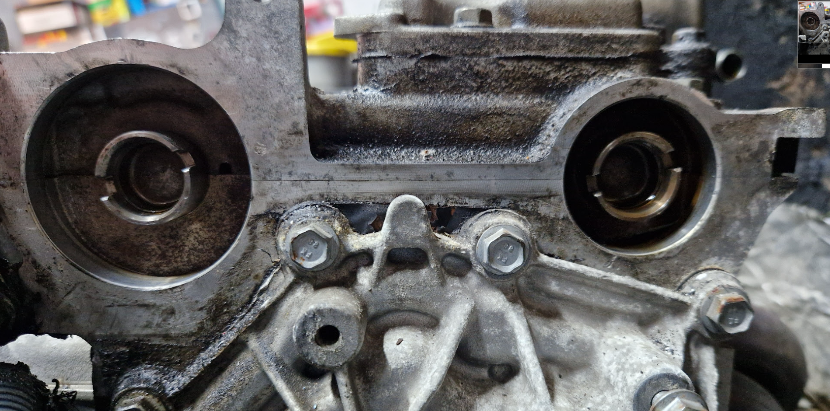

Also at some point it the past it has been timed up haphazardly as nice tipex marks :confused: on the exhaust pulley, I had cam belt done at Renault about 4 years ago then aux belt at a local indy last year due to noisy idler
On the hunt for an alternator and bottom bolt now, will continue to retime, all cambelt pulleys came off nicely. The timing tools are proper quality items, I now understand why cheap ones will bend as you need a breaker bar to undo the cam pulley bolts!
Theres always a chance it's been tip ex timed, but you have to remember that theres a sequence of rotations that need doing when settling the belt.
It's much easier if there's a dob of tip ex, as you're heads down in the wheel arch.
Always a chance its an absolute jobber tho.

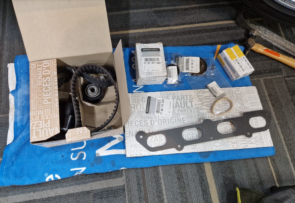

Now things are looking good will be ordering new timing belt kit and cam end seals for timing end and going to do the rocker cover reseal while in bits

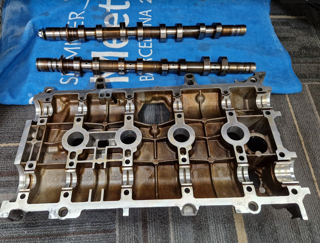

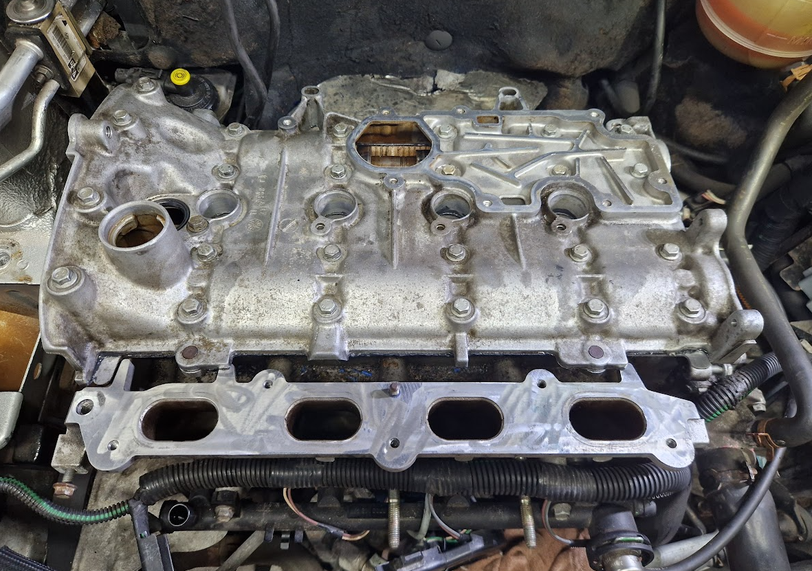

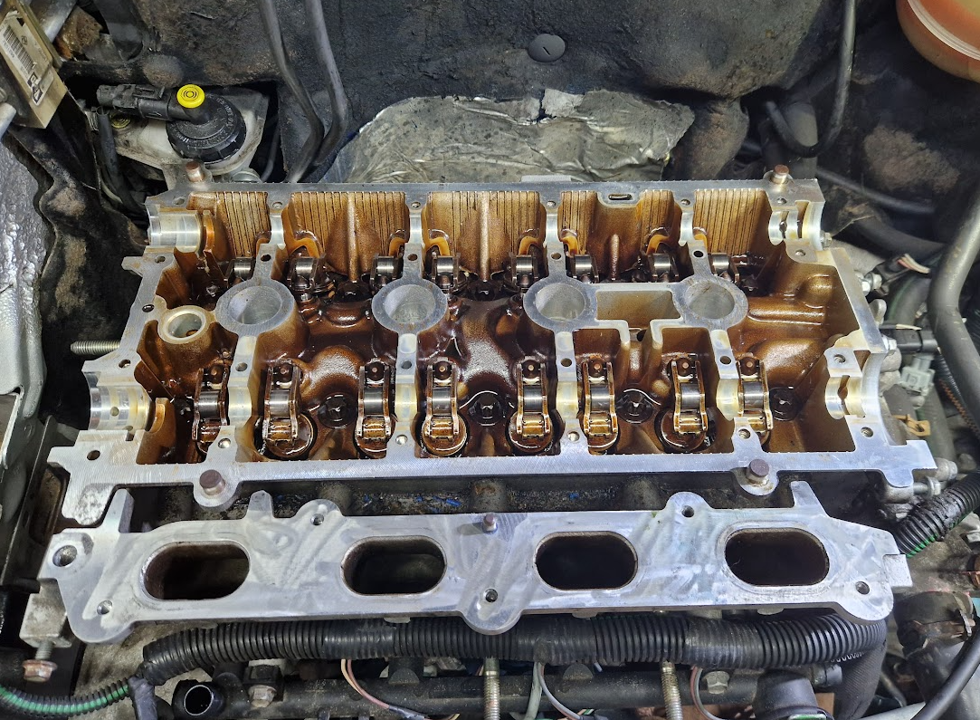

Spent a couple of hours tonight cleaning up and then resealing the rocker cover to stop the weep they all seem to get.
Timing belt kit and new seals on the way and hope to get all fitted and timed up again at the weekend
Well spotted, it was the special loctite si5980 oil flange sealant
Spotted this guy using and understand he was a race engine builder and stated lasts a bit longer than the Renault stuff
This is where I get told that is a disaster waiting to happen :-), please do tell me if so
As Brigsy alluded to earlier, the valves on these are a little weak, I believe the heads are friction welded onto the stems. My concern going forwards would be if the valves (the ones that touched pistons) have been slightly damaged which could mean they fail later. When they do fail the entire head comes off and utterly destroys the bottom end.
Depends how risk adverse you are, with the cams out you are 80% of the way to whipping the head off but suddenly you are into new inlet valves and relapping everything so time and money goes up a fair whack.
Id be tempted to use the proper anaerobic sealant as there is a chance any thats squidged out might block oilways in the head or end up in the sump blocking the oilpump strainer.
Ive never personally had to revisit a cam cover after sealed with loctite 518 or the renault equivalent blue anaerobic sealant, all have been fine. No need to worry if a little squishes out as it will mix with the oil.

Little update, all parts had arrived by yesterday so decided to have a few hours on this today
Removed and resealed rocker cover with Loctite 518, luckily silicone came off pretty easy and hadn't gone into any channels internally, I must have been pretty conservative with application
Fitted the new cam seals

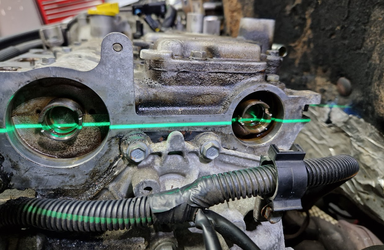

Timing went well and with the Renault tools, the Renault manual and the stone automotive YouTube video got it pretty good on first attempt, horseshoe loose at initial time up and then after the 6 or 7 turns over went back in nice and slack

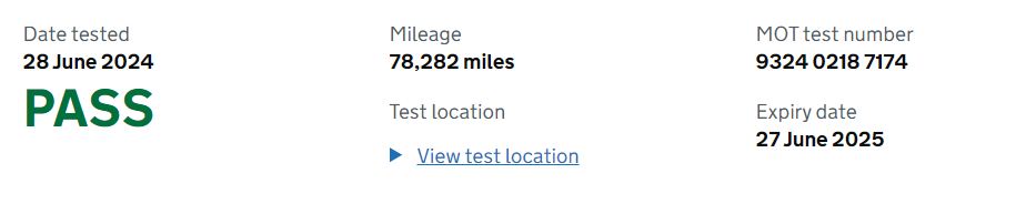

Final update...
With the MOT passed, extensive road test complete, I can confirm she has survived and is just a lively as ever!
