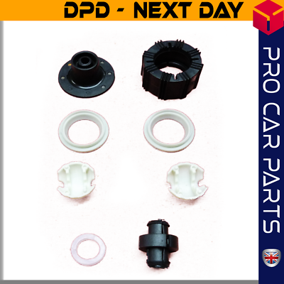

I know these gear shifters inside out now. Best way to stiffen them up for more precision is just to buy the scenic repair kit on ebay.
The plastic ball has grooves in and these wear with age. The full rubber casing also softens meaning it just slops around.
Equal to a yanoo v1 with all new components in stiffness. Use of orings between the two cups on the ball also improves things. Exactly how the BMS is stiffened.

I tried brass bushes and hated them. Just stiffen it up way too much imho, especially if just trying to adjust the linkage on the box end too. Makes it impossible to get any feel of the box.
Just Ebay search 'scenic repair kit shifter'.

Like use my own time and brain you mean lol. After I sent that I did think I would just type the words into eBay myself and not be such a chief.
This the kit?
https://www.ebay.co.uk/itm/Gear-Shi...100418?hash=item4b3aec2002:g:CCcAAOSw3HlamULe

Wrong one senòr
Think you did that just to get me to send you the link tbh.
