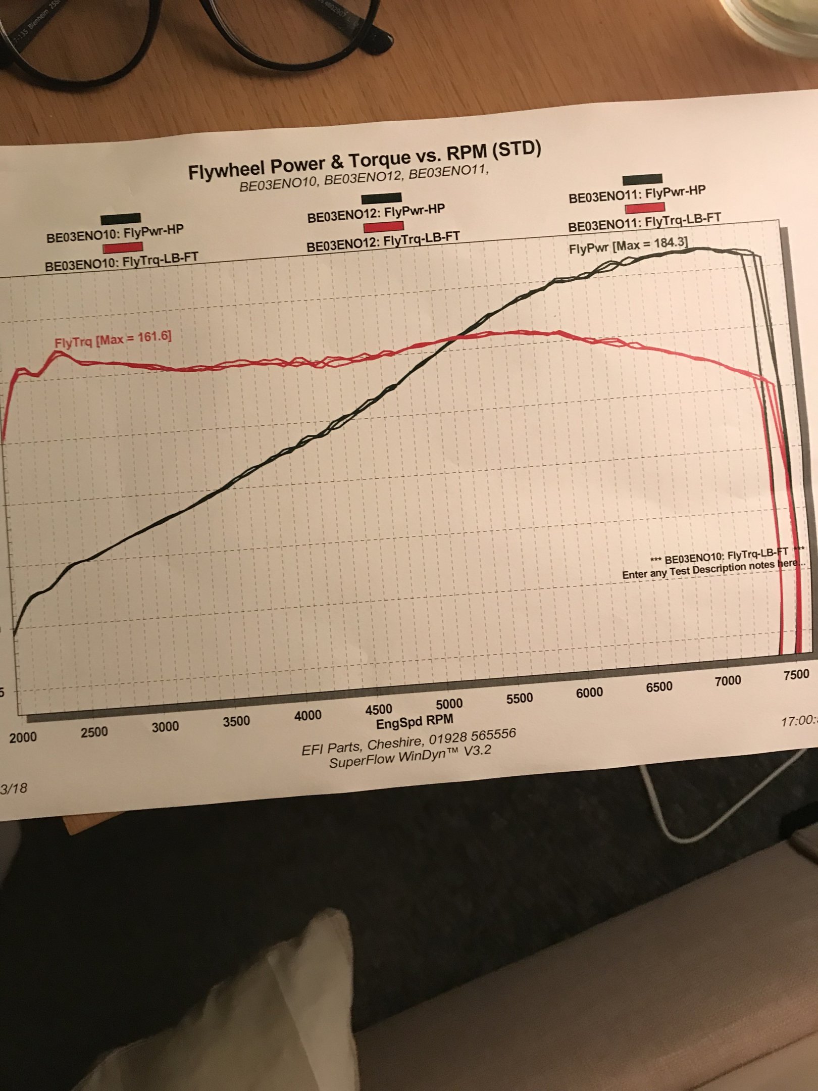

Had my car booked into efi yesterday and unfortunately Chris is saying something is holding the car back he’s had to pull back the vvt and lean it our after 6500k he’s suggesting it’s either the exhaust I.e damaged and restricting airflow or the timing but as the car is running perfectly up to 6500k he’s pretty sure it’s the exhaust. Anyone ever had a problem like this before?? Currently running a scorpion rs192 with de-cat with standard cams and sm inlet.

That looks like a nice torque curve to me!
Why has he had to pull back the vvt and lean it out after 6,500 rpm, what happens if leave the vvt advanced and keep the AFR optimised?
  clio 182
Or do you mean it made more power with vvt retarded after 6,500 rpm, and also by lean it out, do you just mean that the injector pulse width had to be reduced to keep AFR optimised? Do you have an AFR graph?
  clio sport 200
Yes it made more power with the VVT retarded and the fuel leaned out after 6500, I’m pretty clueless when your asking from AFR graphs. He said it’s not breathing right and something is holding it back
  clio 182
I understand, so if it’s losing air flow above 6,500 rpm, particularly with vvt advanced, high exhaust back pressure could cause this. I know that the RS192 (if it’s post 2014) has a 6” odd length of pipe upstream of the centre silencer that is only 2” diameter, so it’s possible that the exhaust is costing a bit.
You’re still making 184 bhp on I assume standard cams though, which doesn’t sound too far off, so even if the exhaust back pressure is costing you some airflow, it’s not costing a lot is it? What power were you expecting with this setup? What do others make?

I’d be expecting 190 with the inlet.
Mine made 183/163 after the efi map, standard cams/inlet.

Chris showed me the results of a car he mapped earlier in the week with the same setup as mine standard cams and sm inlet and our graphs are identical until 6500, his keeps on pulling to 200bhp and the torque line is even till the redline where my starts dropping off after 6 and the bhp does after 6500, Chris is 100% something is holding the car back quite a bit could this possibly be timing

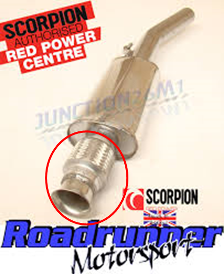

Any have you could show me a photo of the 6inch pipe your talking about pal

Yeah sure, if you look at the pic below, the bit I circled in red is only 2" diameter pipe. I know because I just bought one and it's currently on the work bench in my garage and I measured it. But like Bloke says, it'll not be worth a massive amount.

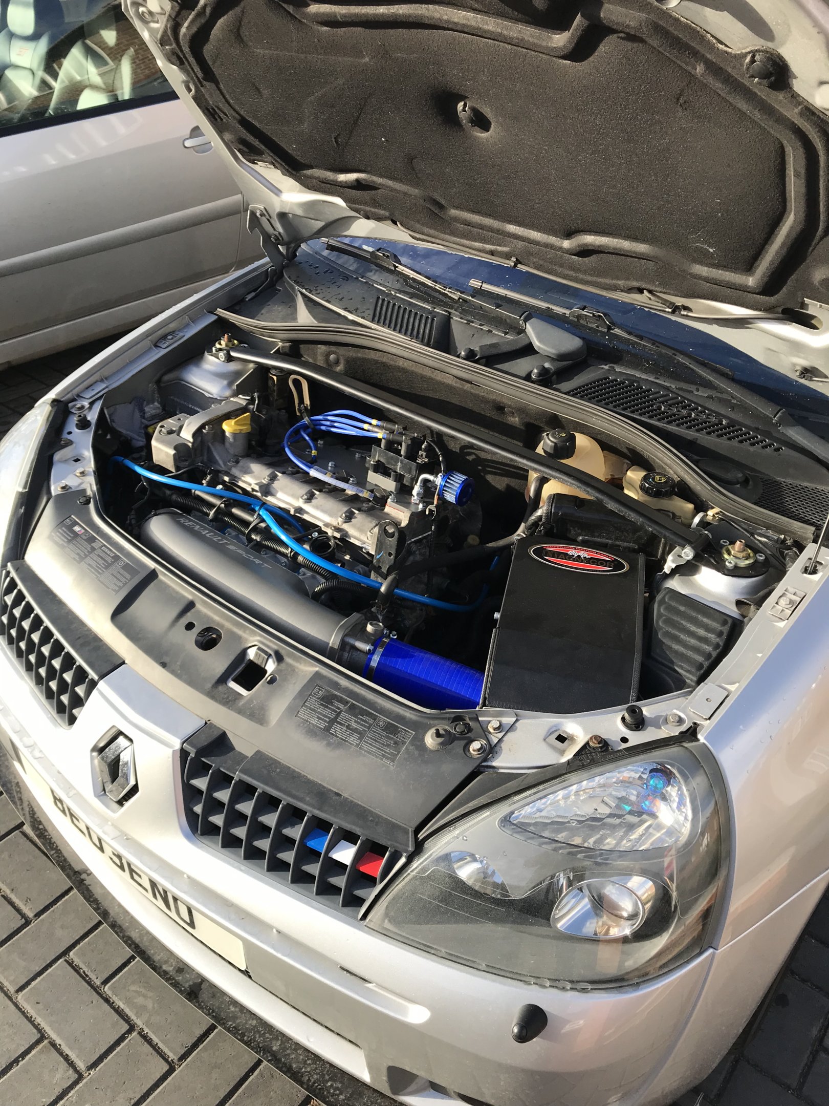

One thing that would be really interesting to compare between the engines that make really good power and ones that don't is the air filter setup and more importantly, the intake pipe between the air filter and the SM inlet. The dimensions of this intake pipe can really influence the performance of an engine - not saying it definitely is in this case, just saying it can do, so would be interesting to see if people are running different setups.
  clio sport 200
Do you think my battery cover could be causing any issues
