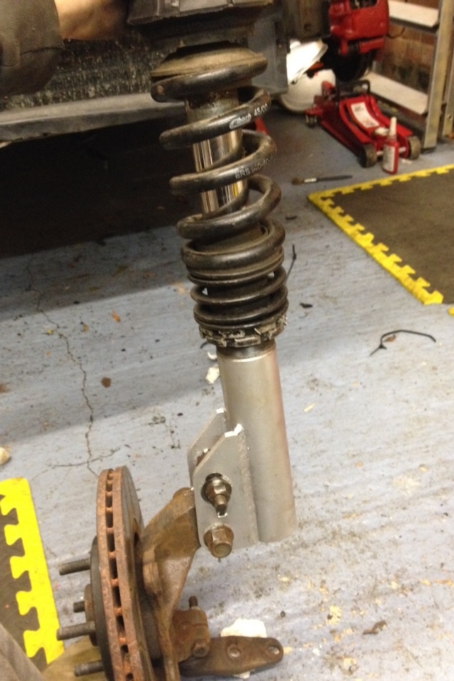

These, got told there clio cup ones?? Only height adjustable, can't adjust the shocks :/

How do you find the car to drive at the moment? Any issues with traction, locking up brakes, car very skittish on the limit and sudden to snap? By the look of your picture I think your spring rate is 140nm/mm which is pretty stiff for a car running list 1a/b tyres. Do you know if the bilsteins have been revalved?
