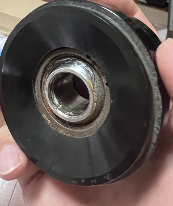

I am a friend from Taiwan. I ordered AVO shocks from the UK. The front springs are 550 IBS and the rear springs are 300 IBS. After that, the nightmare began:

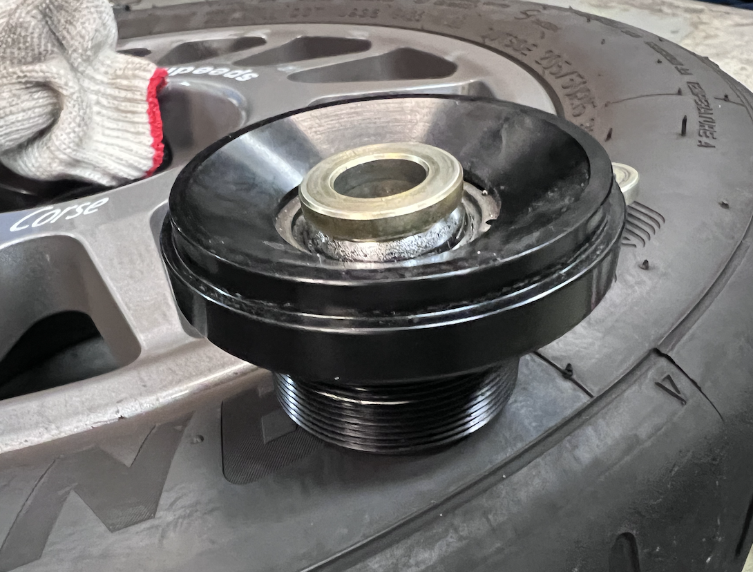

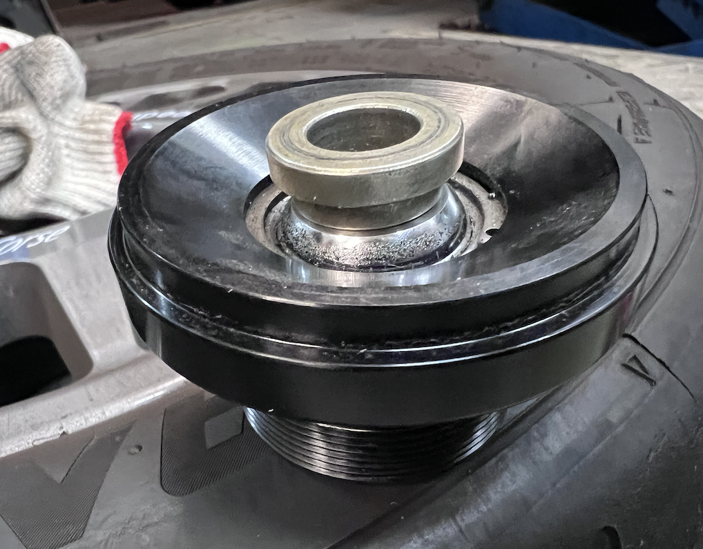

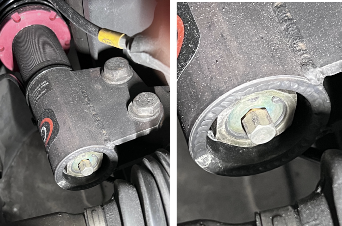

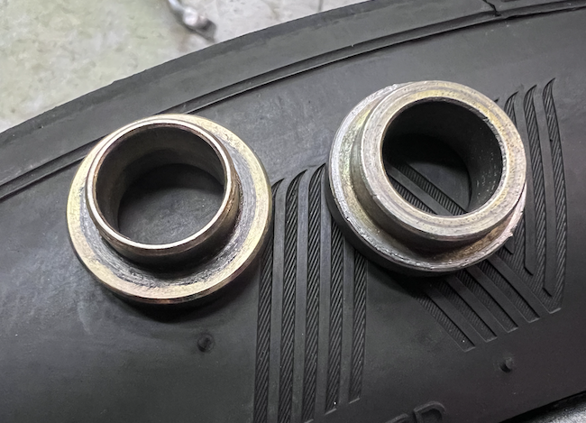

1. In February this year, after the installation was completed, there was a huge noise, but there were potholes, bridge cracks, and protrusions! The shock absorbers are badly infected on the body. After dismantling, it was found that it was an AVO product error (gasket and retaining bolt), which caused the head of the pillow ball to be damaged correctly. So I contacted the AVO team and they offered to send a set. Give it to me, I look forward to it.

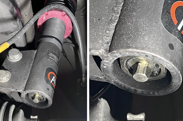

2. Due to a construction error, the screw on the rear shock broke, so I ordered two more rear shocks.
3. After 20 days, the product will be sent to Taiwan. At the same time, in order to ensure that the weight of the spring water will not be too high, I purchased spring water with 450 IBS in the front and 250 IBS in the rear. However, to my delight, I received a set of used pillow dome tops, full of rust spots, but the gaskets and bolts are indeed new, I still have the product on the car, tested it and it still emits a huge noise Noise, after dismantling the solution this time, a bad situation was found, the front shock absorber leaked oil in the lower right corner. (As of today, every inspection has found oil stains)

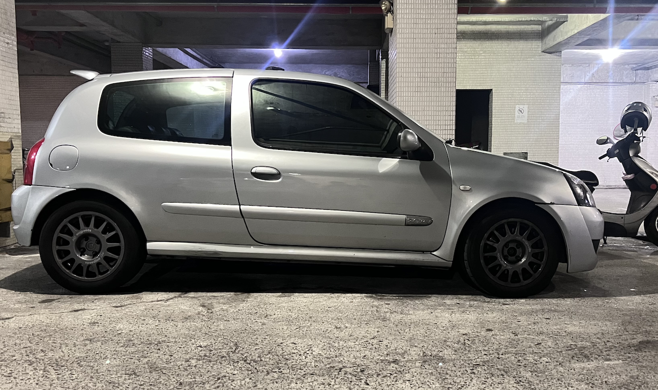

3. Later, another gentleman from the AVO team contacted me and he asked me: "Can you send us a picture of the side of your car? The car is on flat ground. This will help us see the riding condition of the car The height at which it is.
Also, can you tell us if you get the knocking noise over small bumps at low speeds below 10 mph?
and dips in the road (potholes and seams in the tarmac .)
from Manhattan or just one?".

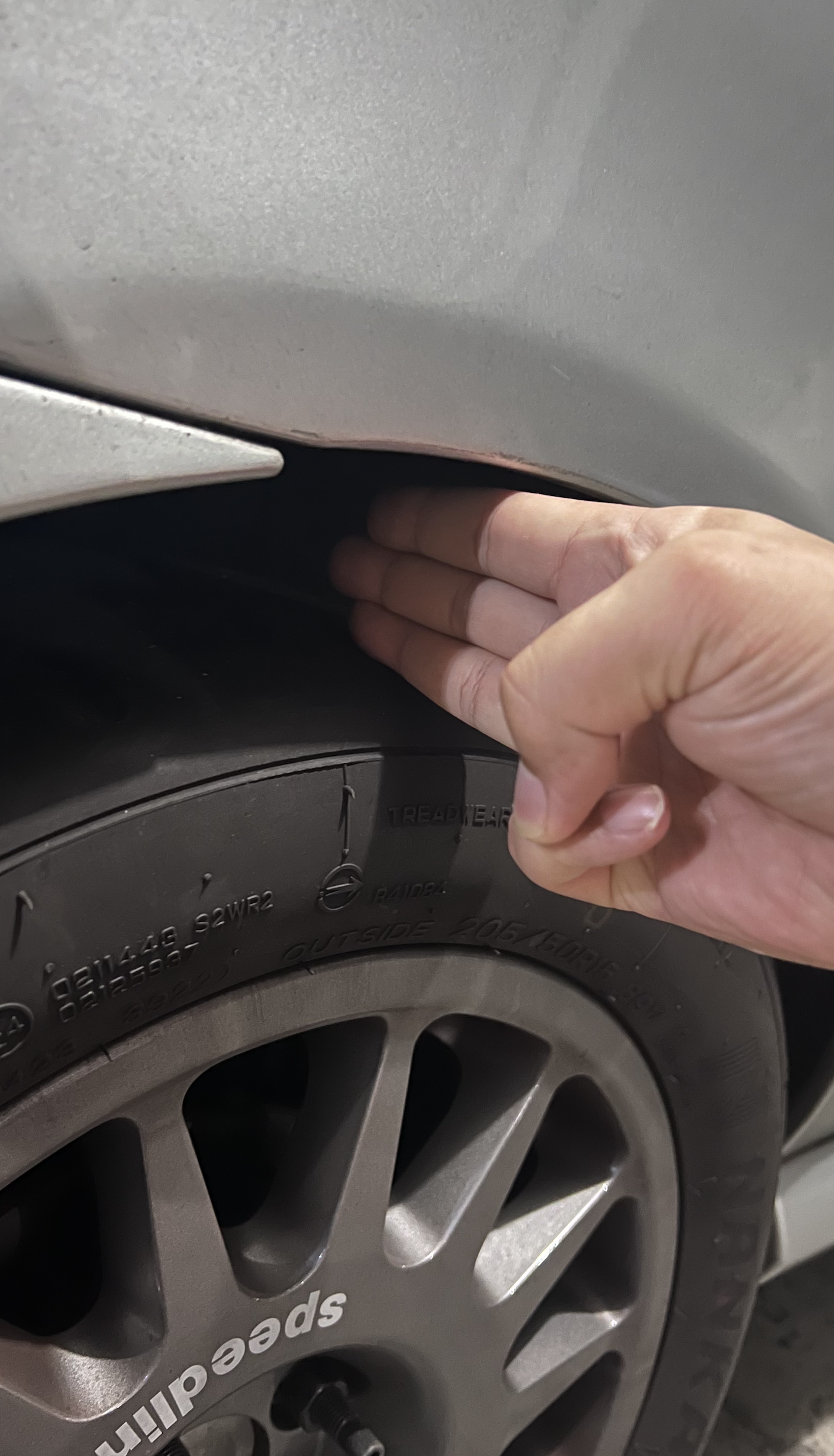

4. This is my current height

1、今年2月,安裝完成後,出現巨大噪音,但那坑洼、橋縫、突起!減震器嚴重嚴重地感染在身體上。拆解後發現是AVO產品錯誤(墊片和留置螺栓) ,導致枕球頭部正確損壞。於是我聯繫了AVO團隊,他們表示願意寄出一套產品。給我吧,我期待著。

2.由於施工偏差,後避震器上的螺絲斷了,所以我又訂購了兩個後避震。
3. 20天后,產品將被發送到台灣。同時,為了保證泉水重量不會太高,我又購買了前450 IBS、後250 IBS的泉水。不過,讓我高興的是,我收到了一套了二手枕球頂,滿是鏽斑,但是墊片和螺栓確實是新的,我仍然把產品放在車上,經過測試,它仍然發出巨大的噪音,拆掉這次解還發現了一個不好的情況,前減震器,右下角竟然漏油了。(直到今天,每次檢查都發現有油漬)

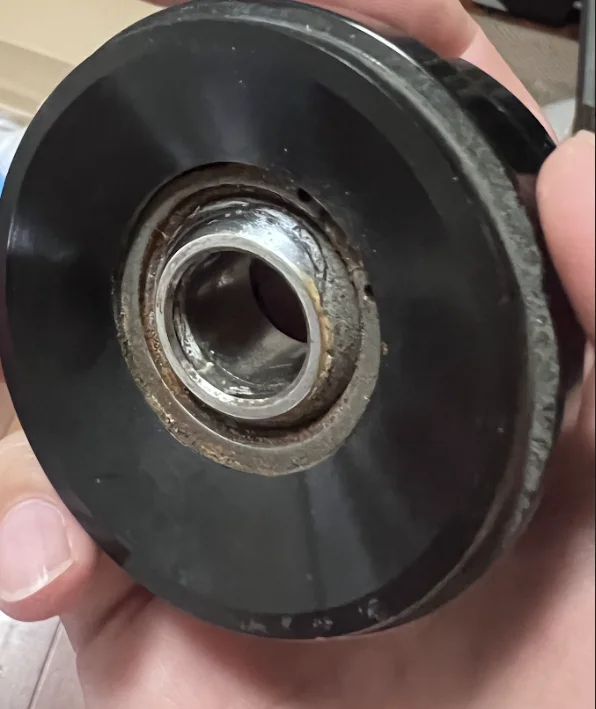

This is the pillow ball top seat they sent me, also damaged
