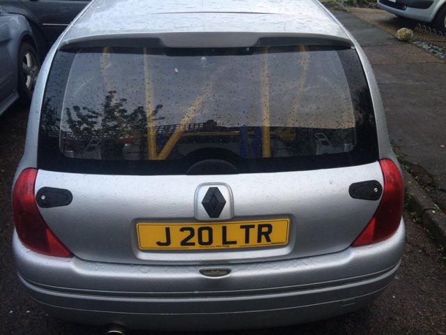

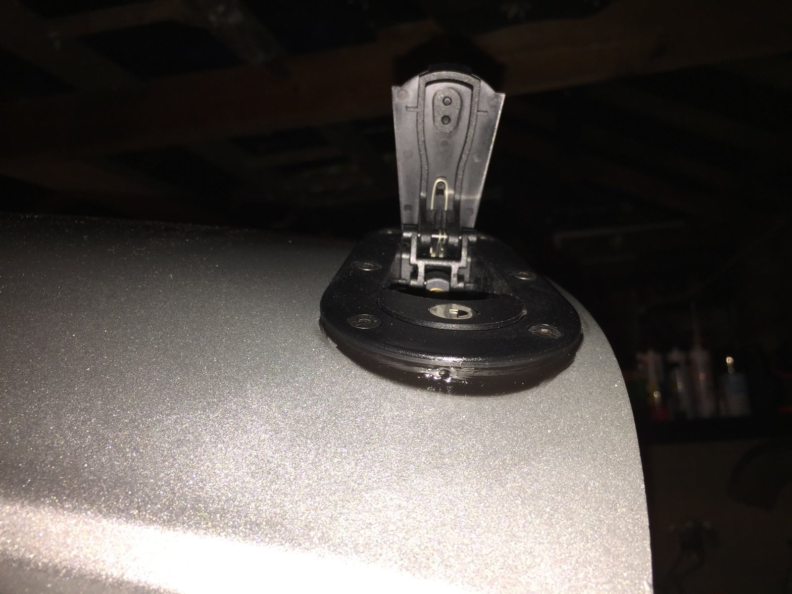

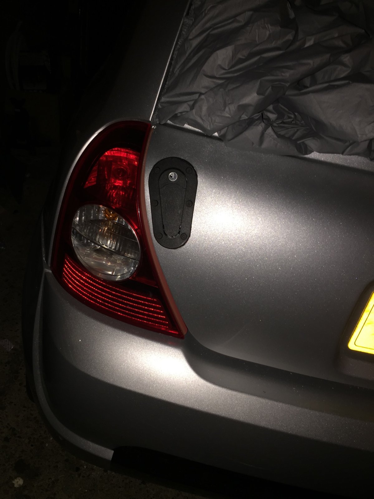

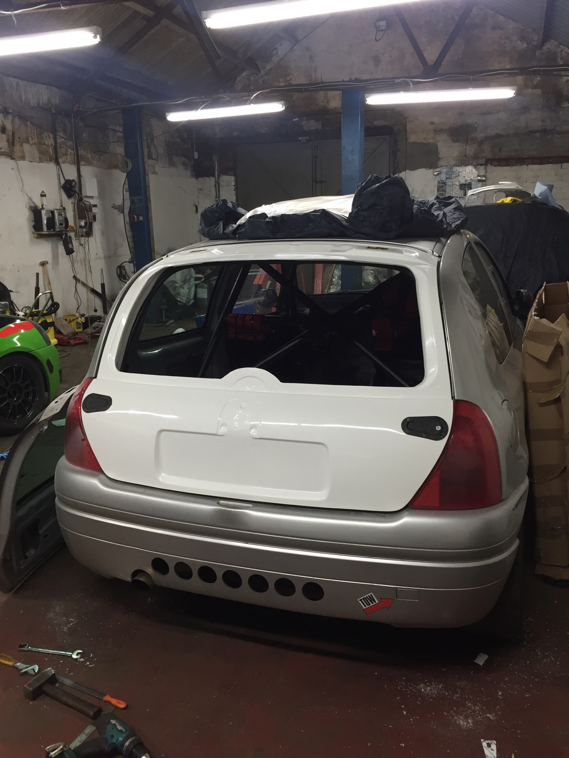

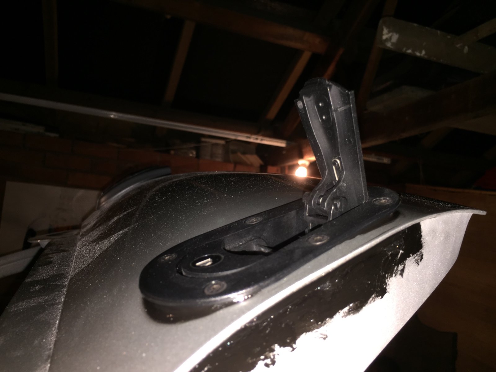

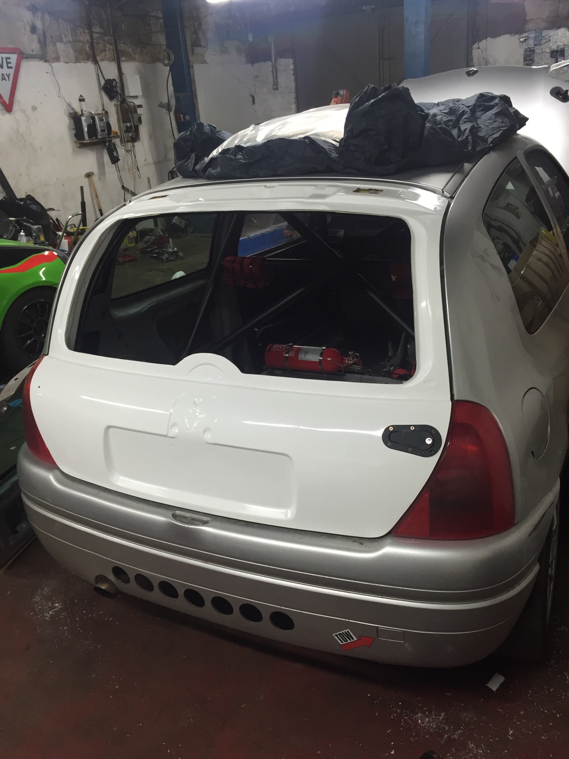

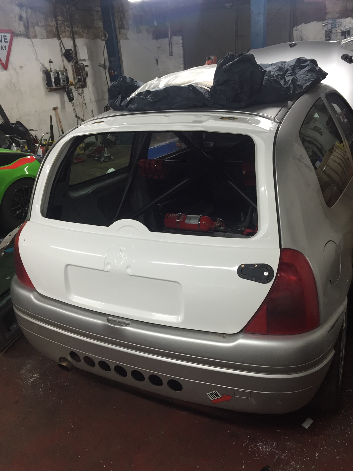

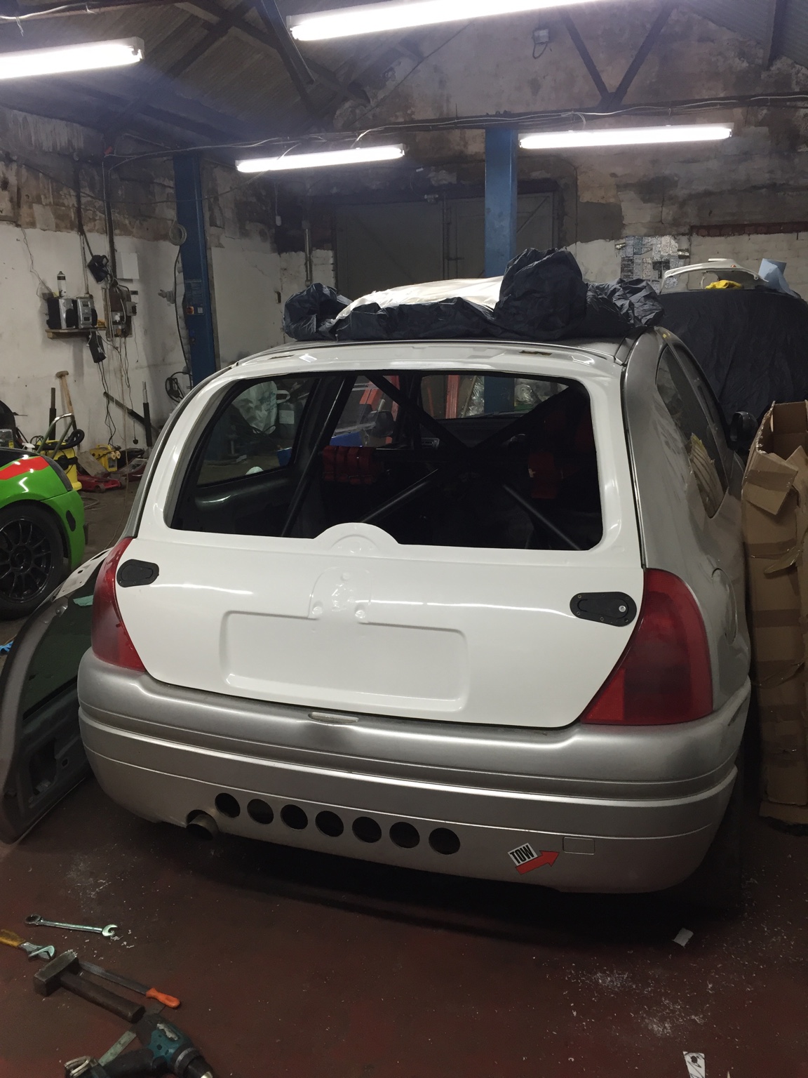

Sorry for the extremely long delay but I have finally got round to fitting the aero catch got some pictures for you.

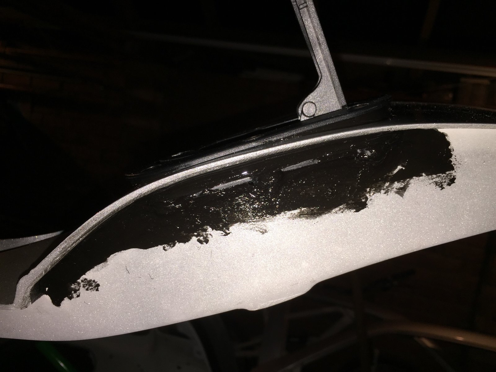

This is just to seal where we had to cut the edge of the boot to get the inner bracket in not the nicest looking bit but rather that then a leak into the boot
Got it a low as I could without damaging the fibre glass and the bits that were raised I have used black silicone to give it a more curved look I must admit it's come out really well.

I did the same , the raised curve of the lid I pumped a little bit of sealer around the edges. I did mine across rather than down as it kept the amount of coming through the side of the tailgate to a minimum.
The water still comes in . Every time I open the lid , water that's come in through where the pins come through the catch pours out . Some small drain holes in the lower part of the lid will help drain the water away like where the tube exits on the OE lid .

Yes when we first started doing it I was hoping it didn't break through but easily fixed with a lot of silicone lol.
Yes I was looking at it last night and thought it would come through the there
That's what I was going to do one both sides about a 4mm hole save the water trying to travel to the middle getting the whole boot lid wet
