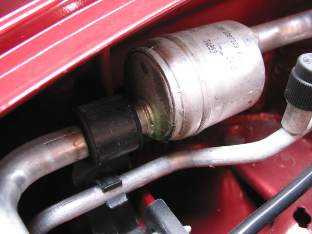

No clunk when engaging AC will probably indicate no gas, but from my experiance if it has no gas so soon its lost it for a reason, a gas with dye will show this up, the leaking component may be covered under warranty as mine was. Gas + dye, fault fixed and re gassed all under Renault warranty at the dealer.
The green is the dye showing the leak.
